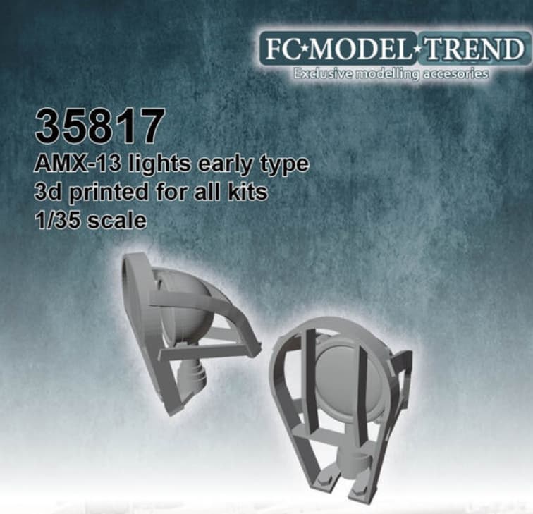

A possibilty?
I forgot this set. Why not?
Seems a promising solution. I wonder if I can manage to paint the lenses through the grid. I’ve found it in a online shop.
I’ll try to modify the guards of the kit as a first attempt, in case of failure I have the possibility to buy this.
I think the prints are in clear resin. You can paint the back with a chrome pen, then overpaint with sand. chrome show throught in the front.
Yes, it is possible, but painting the grid and the glass frame through it seems not too easy.
I used the FC Modeltrends set. Surprisingly they were very nice, and the resin was properly cured and not brittle. If they were at all fragile I would have broken them, trust me.
