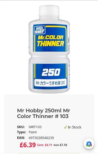

I find mr hobby colour thinner cleans up my dried paints well. Let it soak for a minute.
And this destroys.if not careful

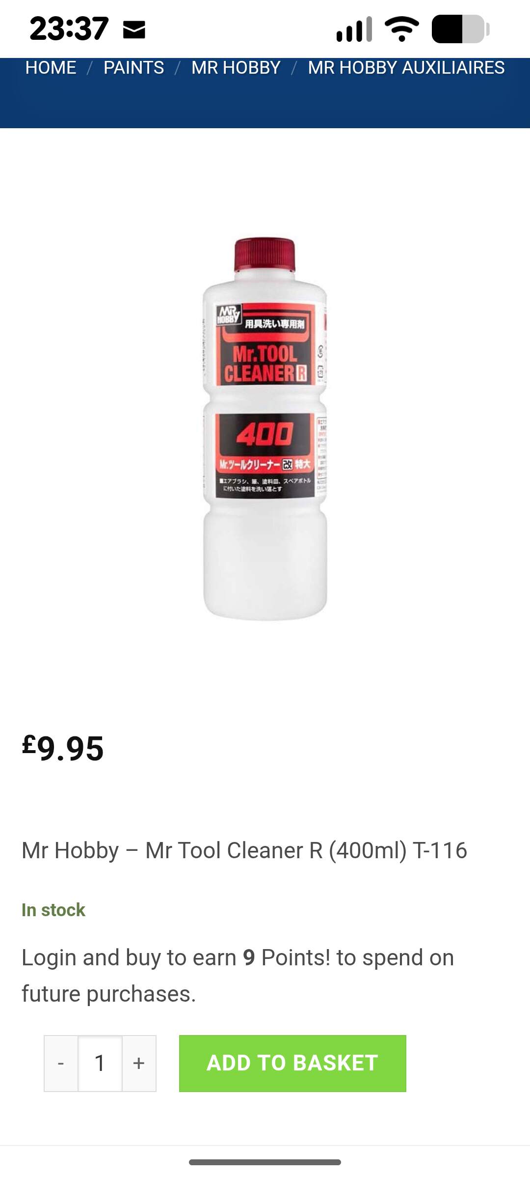

My go to.

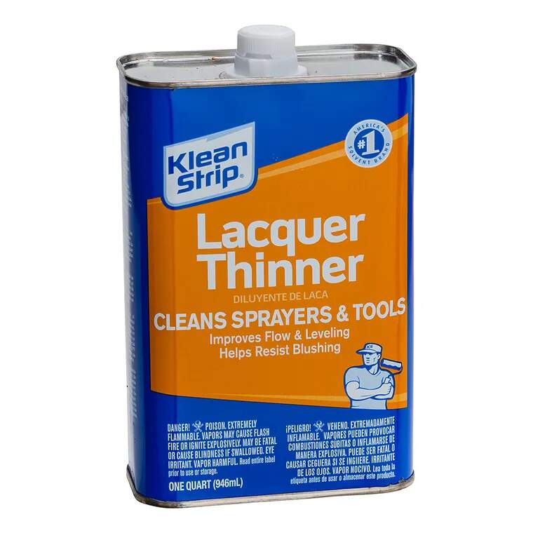

I put my airbrush parts into a small jar. I fill with lacquer thinner and place the jar into my ultrasonic cleaner and run it through a couple of cycles. Clean as new.

Yes I use Mr. Color Thinner too- works a treat to clean the airbrush- and the One Shot primer too. I also use Injection Site Swabs- the little square wipes with alcohol- they work great to clean the airbrush.
I have a Grex airbrush that uses Teflon seals throughout which are impervious to acetone. As a last resort I use acetone for cleaning everything. I have yet to come across a paint that can resist it. Bad side is acetone highly flammable and toxic so adequate precautions need to be taken. I only use it outdoors, wear gloves, eye protection and a respirator with a organic vapor filter. Since I tend to paint with lacquers my first go to is lacquer thinner.

I’m with TopSmith on using Klean Strip lacquer thinner as my preferred cleaner for the airbrush as well.
