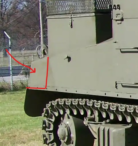

Ugh: I hate to point this out but the M7B1’s hull was longer than that of the M7.
It’s perfectly okay Roy, I’m well aware of the longer hull and I’m going to scratch build the remaining hull extension. I was just using what I could of the Italeri hull and parts as it made it easier to build.
Chris
