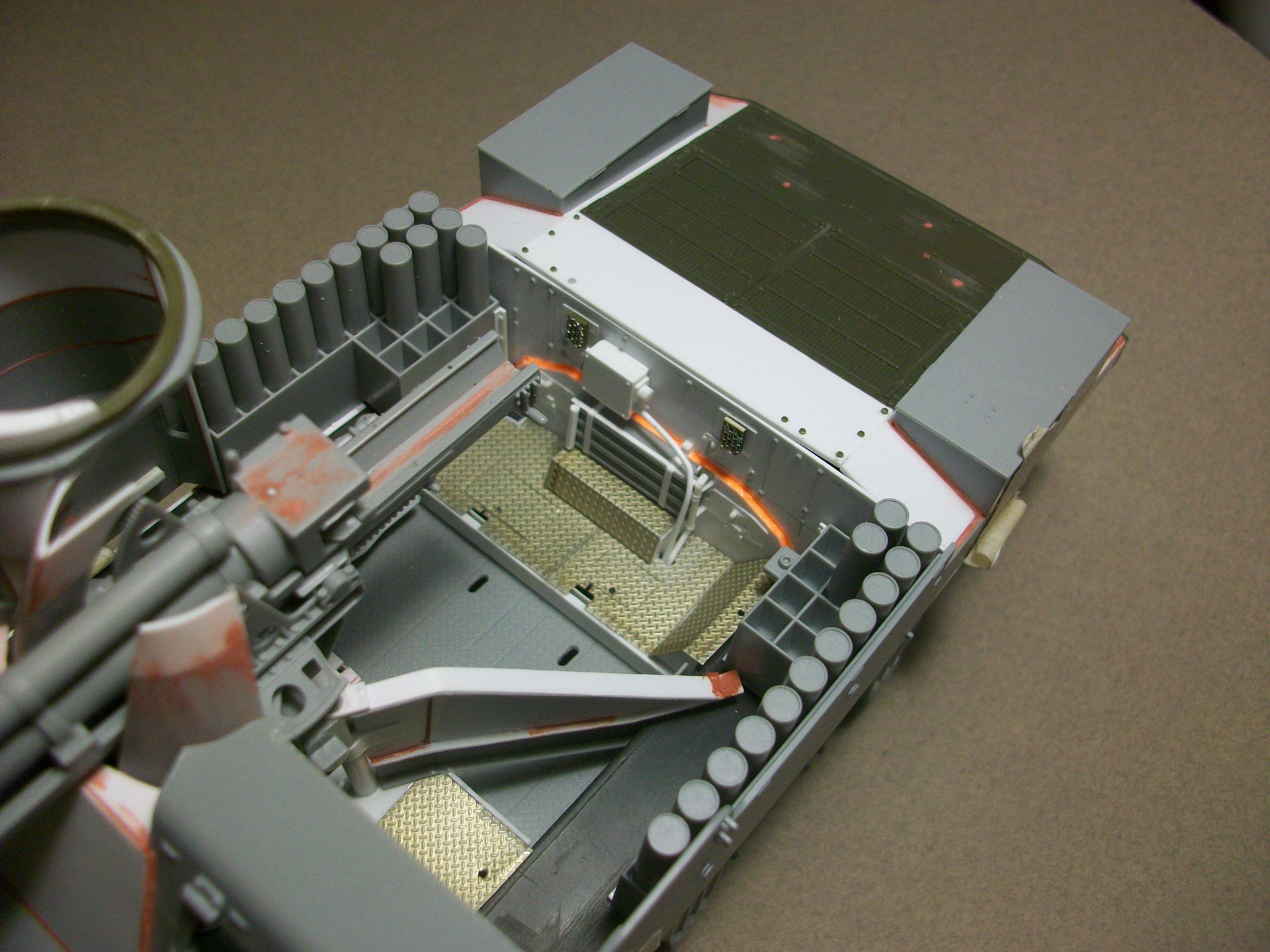

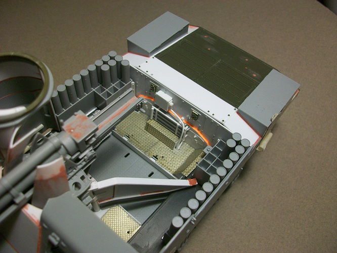

Remember that the firewall needs to be changed. This is a pic from my M7B2 conversion
Hi Roy, thanks for the info! I had already come to the conclusion it would need modifying as it’s a M4A3 hull so the firewall would be different from the M3. I just need to find the relevant info to duplicate it.

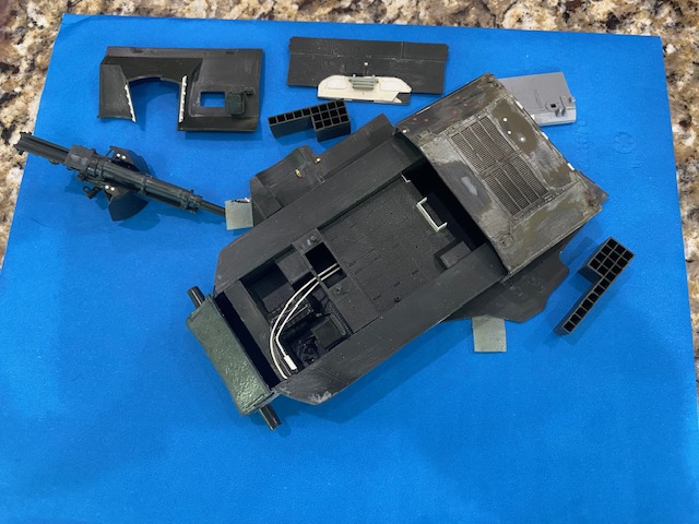

Progress continues to be made, though I do like making things harder for myself lol. Got the interior assembled and painted though I’ll need to tidy it up a little. I’m using the 50 cal and mount from the Academy M12 kit as it’s way better detailed. I’ve also discovered that the Academy M36 has the correct engine deck and rear end I need to finish the conversion and have purchased a copy as my Dragon M4 is currently in limbo awaiting dispatch from the suppliers warehouse! As I erroneously thought I was buying shop stock. So while I wait for it to come in there may be a slight halt in progress, though I still have to attach the drive sprockets. The idlers will have to wait till I’ve received the Academy kit. I’m also looking to buy a set of metal track links to avoid the tight rubber band track issue. I’ll show you what I’ve got once I get them, I’m going for a set that has the duckbill built in (hopefully). Any who here’s where I’m at right now.
