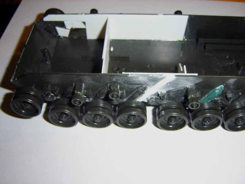

I’m not too sure that your sanity will be assuaged by tackling the Tamiya version; I haven’t got one, even in the stash - though I do dabble in Air Defence model: I recall that the stash contains a Chaparral, a Vulcan, an M24 (Tamiya original of course) a ZSU-23-4, an AMX 13/DCA, and the Panda Tunguska - all naturally crying out to be built; there’s the gap in the wheel spacing although here’s how one modeller dealt with it:
