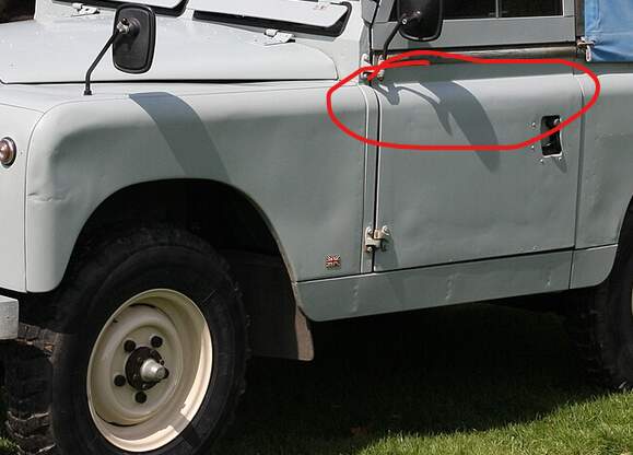

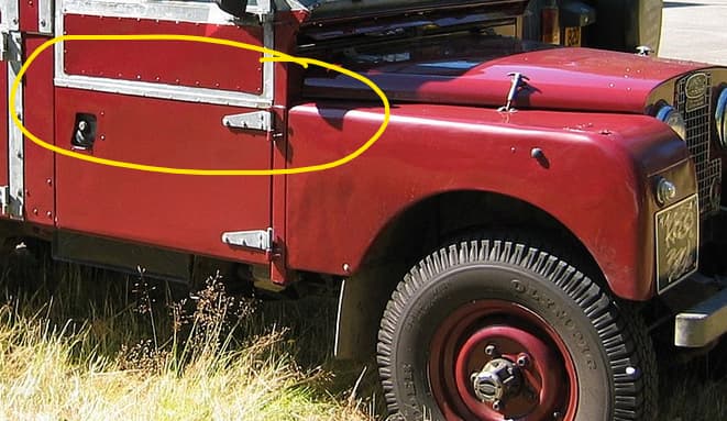

" The successor to the successful Series I was the Series II, which saw a production run from 1958 to 1961. It came in 88 in (2.24 m) and 109 in (2.77 m) wheelbases (normally referred to as the ‘SWB’ and ‘LWB’). This was the first Land Rover to receive the attention of Rover’s styling department. Chief Stylist David Bache produced the familiar ‘barrel side’ waistline, with a 5 in (12.7 cm) greater width to cover the vehicle’s wider tracks, as well as the improved design of the truck cab variant, introducing the curved side windows and rounded roof still used on current Land Rovers."
Series I
Series II (1958 to 1961, the Korean war “ended” 1953, still no peace though)
There were other differences as well, way beyond my knowledge.
The rounding of the sides is a rather visible difference.
The AK Interactive kits are Series II.
