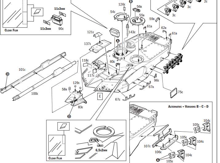

Below is the instructions showing parts 67 to be applied to the front of the hull.
Whaaaaaaaat, am I missing and has anyone ever came across either a A5 or A6 with the handles mounted there?

The A4 kit has those handles on its slab sided (vertical) front
It is from a pretty old release, it has many inaccuracies, not only the front hand rails. It was not labeled 2A6 but Leopard II Improved/KWS version. White box if I recall correctly
Nailed it! You cant find anything telling you which model this is. Also notice part 91. Also WTHHHH! yeah already glued long ago. But I guess I break them off and fix it. Italeri your lucky you build a fury tank, otherwise middle finger.
@1994 built.
kit 280

Whats funny is the only way you can do them is by cutting out a bit of the middle of the bars and making them smaller to fit on the front.

Use some withe paint to paint over the c67-parts in the instructions
yes, but which ones? four parts are 67 on the sprue with two separate sizes. :upside_down_face:
c67 is not the same as b67
b67
c67
yes, but were back to the same issue. Neither of the 67’s will fit the front mounting squares.
and I think you should forget about the handles on the front (wedge) armour.
Put them in the spares box, they might come in handy for some other project.
I think they were simply carried over from Italeris 2 A4 kits
Or let me phrase it another way. None of the parts given will fit the front. Whatever number they are, or whatever parts supplied.
They were glued on along time ago.
Its going to be a Afrika Korp tank. fantasy land anyway.
