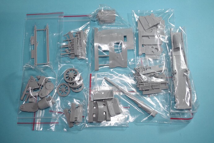

What’s insde the box?
Well cast resin parts. No bubbles or blemishes. No warpage. Only one part was broken - the long driveshaft protruding from the rear transmission. Looking very good in the box, indeed!
Regards
