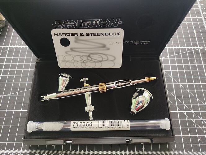

My Evo 2024 arrived, I like the feel at first look, looks like quality tool :slightly_smiling_face:
The trigger is truly different from the old Infinity, like more “stiff” ( I don’t know if it is the right word) and responsive. Feels like the Eclipse trigger, but kind of different in the same time. Probably will get used to it with the time, but is much better now. Also the airflow is softer than on the Eclipse.

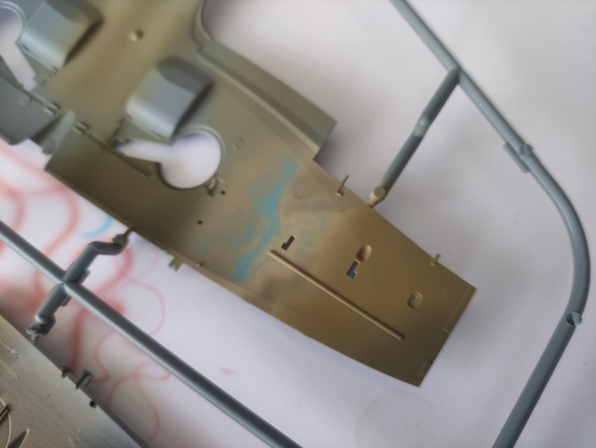

I made a quick test with both 0.28 and 0.45, but I think for general work will use the bigger nozzle which is also capable for fine detail. I even managed to do some mottling with AK 3rd gen acrylics which are the hardest to airbrush from my paint collection.
I will see how it will hold with the time, but it is great airbrush I feel.
