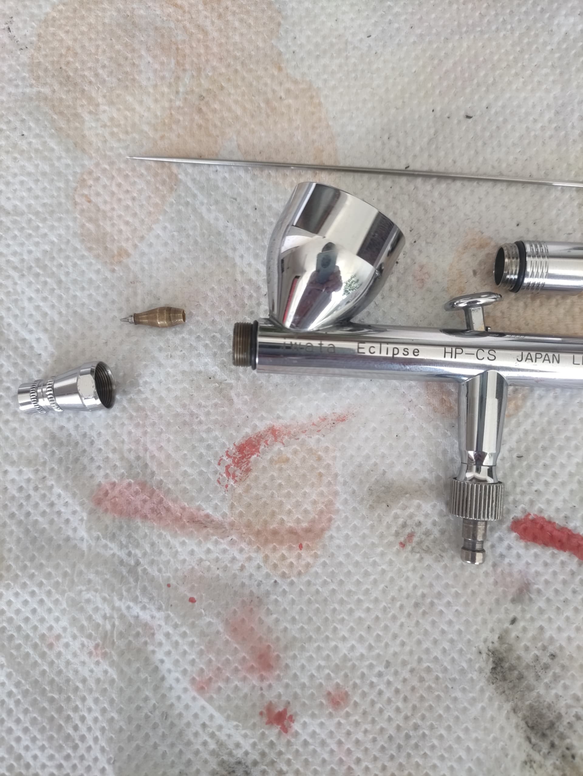

Hi,
The nozzle of my Iwata Eclipse HP-CS is probably damaged, so I’m searching for replacement. The problem is here in Europe they are very expensive, like 50eur for a nozzle plus they ask 15-20eur for shipping and they are hard to find in stock (still way too much), probably will cost like 100eur for nozzle and needle. I noticed in the US they are like twice cheaper, but usually they ship only domestic.
Probably I will have to get a needle too, but the old seems not damaged.

Also I think Eclipse has, how to say, stronger airflow than the H&S which may be an issue for fine detail. I couldn’t get used to it. But for general work is ok.
One thing I could do with the Eclipse now is to swap for 0.5mm nozzle and needle (plus cap), looks like the 0.5mm nozzle is like 12$, much cheaper than the 0.35mm. The whole setup will cost like 30$ and I can use the Eclipse for primers and varnishes etc. and the Evo for detail work.

The set up I have is the Iwata Eclipse with a .5 nozzle and needle for base coats etc… and an Iwata Highline HP- CH for detail. Very happy with the results. I got the conversion parts from the Merri Artist. Just a note. I was very impressed with the people at the Merri Artist. Very knowledgeable and knew exactly what I needed. I will use them again. Recommended without reservation.
Yeah, I think the .5 nozzle will be the better setup, the price is much lower than the .35mm spares. That shop has the best prices I could find.
So probably you need also to change the nozzle cap for the .5 setup?
The nozzle and the needle must match.
