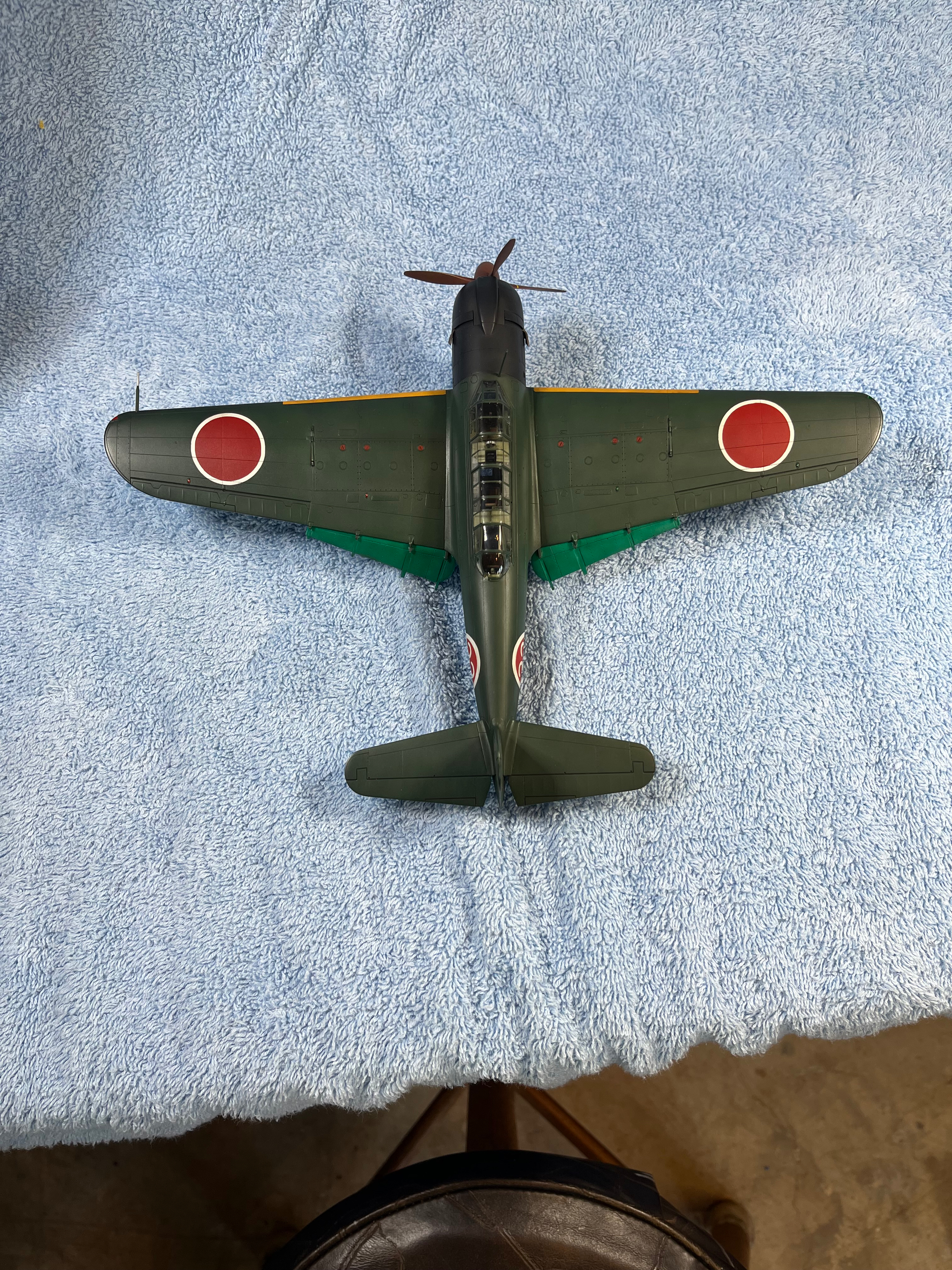

From research I did for B6N and Ki-84 both were somewhere between an olive and cockpit green, a very strange shade that took me a while to mix. Both were Nakajima aircraft though so colors may vary
Very similar to the shade linked above, almost like a grayish olive

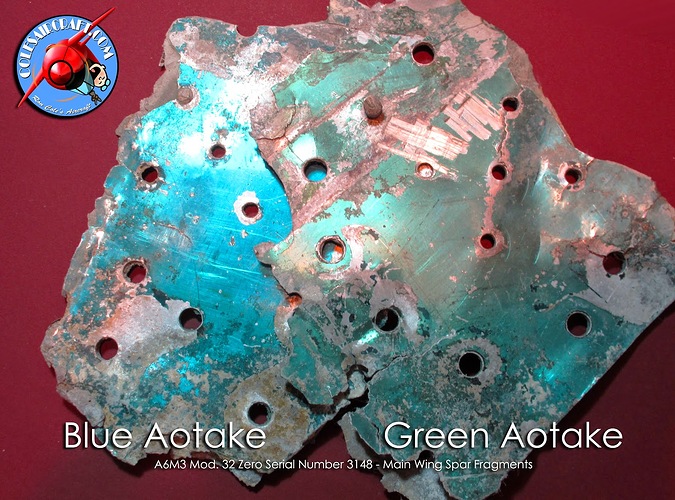

Wait until you start looking for the “right” color for aotake, the metal protection coating widely used on non-cockpit interior surfaces. Literally “green bamboo”, the coating compound itself is clear, but various pigments were mixed in to ensure even coverage; the problem was that there was no standard pigment formula, so it was produced in a wide range of colors, blue and green being the most common:
The NASM’s restored Nakajima J1N Gekko has the interior sidewalls and major structural elements in the cockpit painted with aotake, which for their restoration can be modeled by applying silver, then a clear blue-green on top. Other museums have Zeroes with a bright metallic blue appearance for their aotake-coated areas.

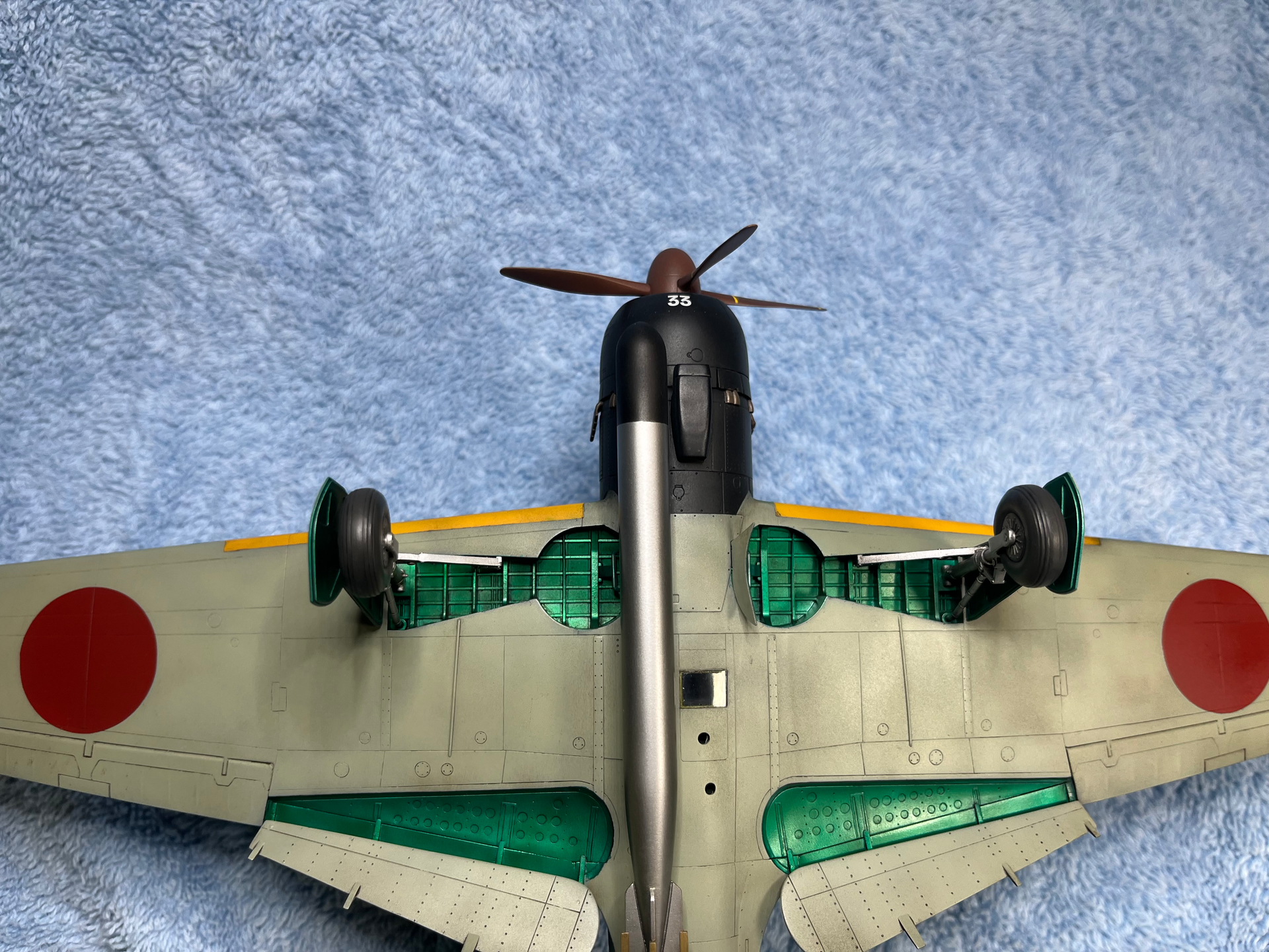

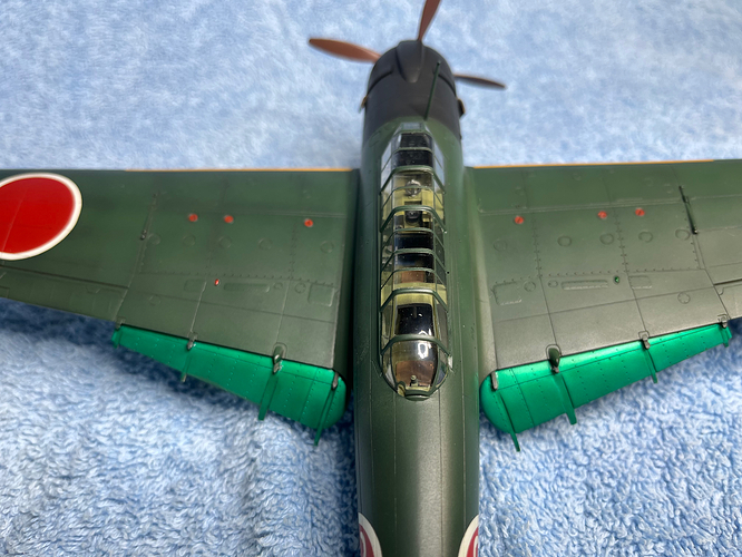

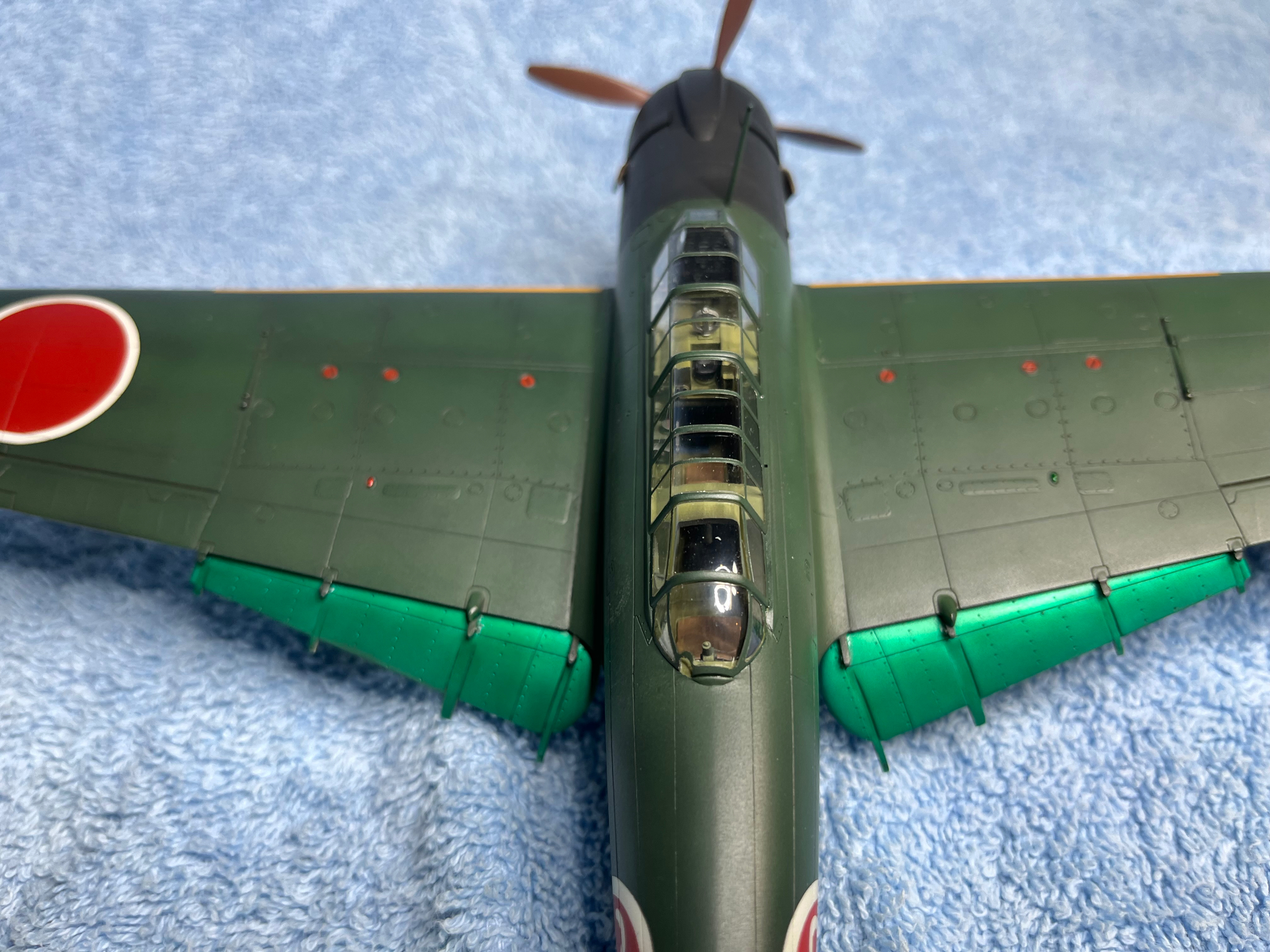

Yes that is a rabbit hole for sure! I actually made a mix for my B6N! I did as you say, laid down some silver, then made a mix of tamiya clear blue and clear green. Getting a good shade was tricky, this is where I ended up

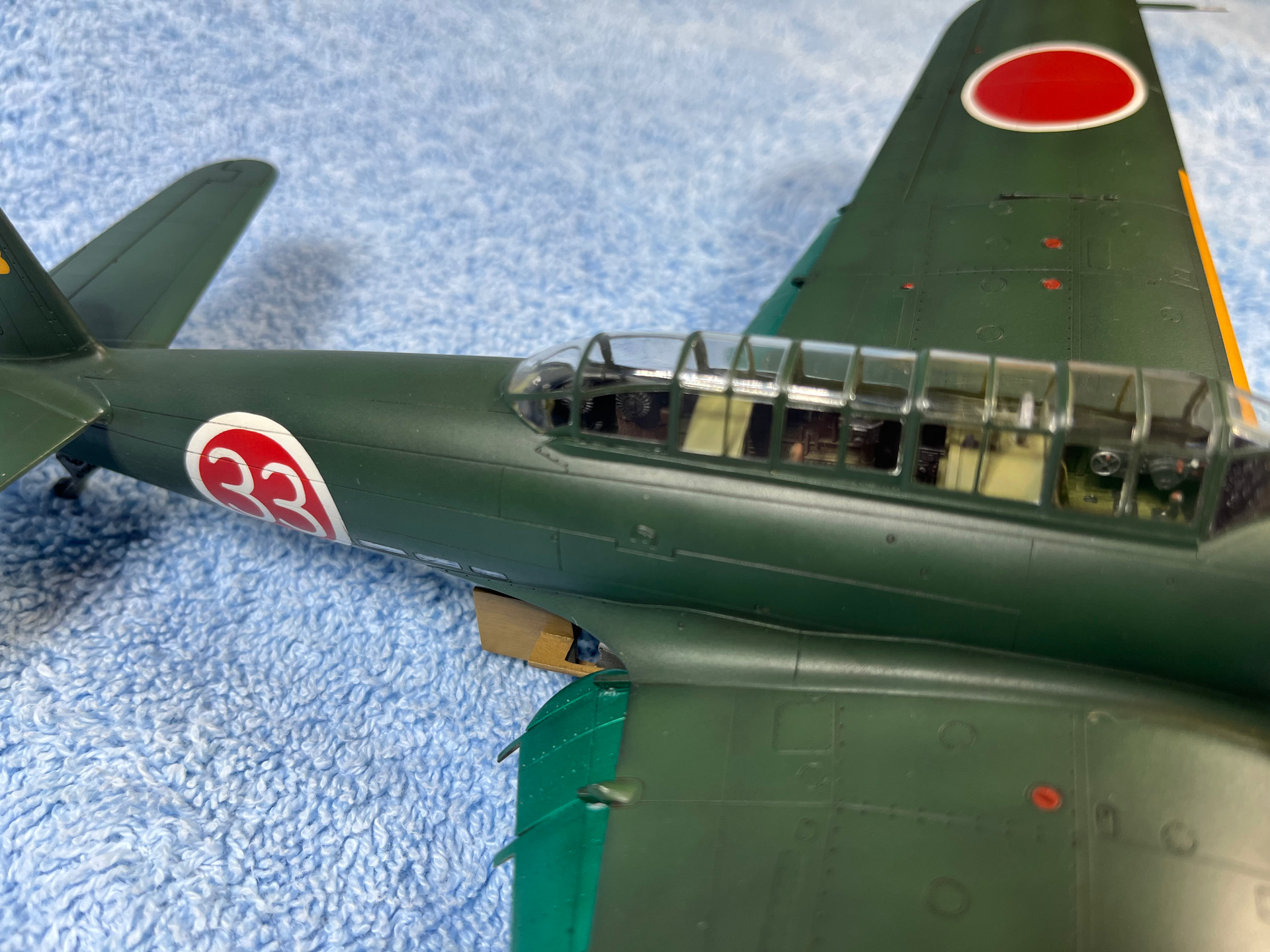

It looks a little more green in the photos than actually it is. @TopSmith can kinda make out then interior color through the canopy
