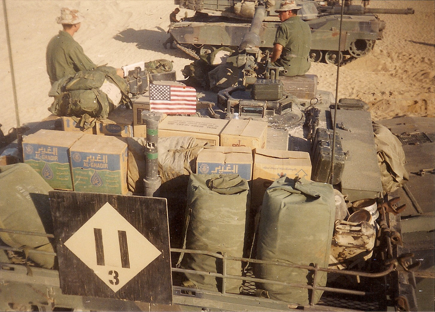

I know we were still using steel fuel/oil cans into the 1990s, and even the occasional water can. They took a hell of a beating, but I never saw one leak from a bad or busted seam.
