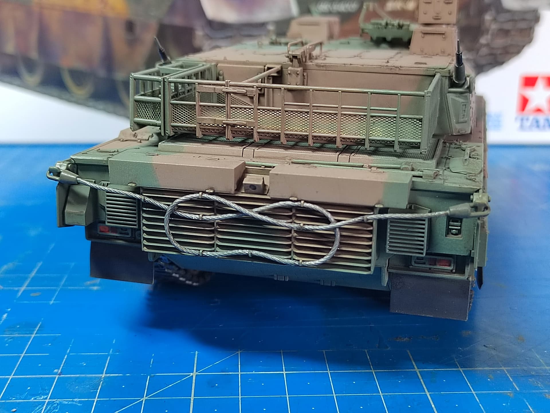

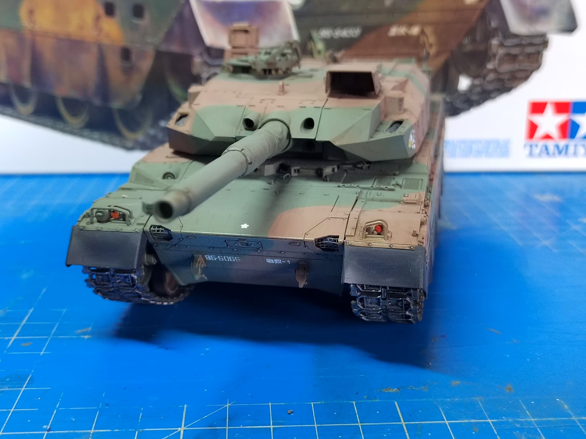

Right Robin. I’ve started to wash my Type 10. I used some brown all over the tank then I applied a pinwash with a darker brown.
Next steps are the water pencils application and the pigments.

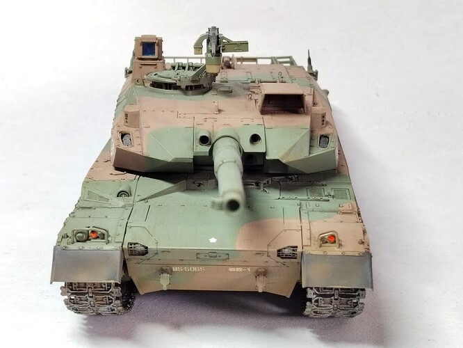

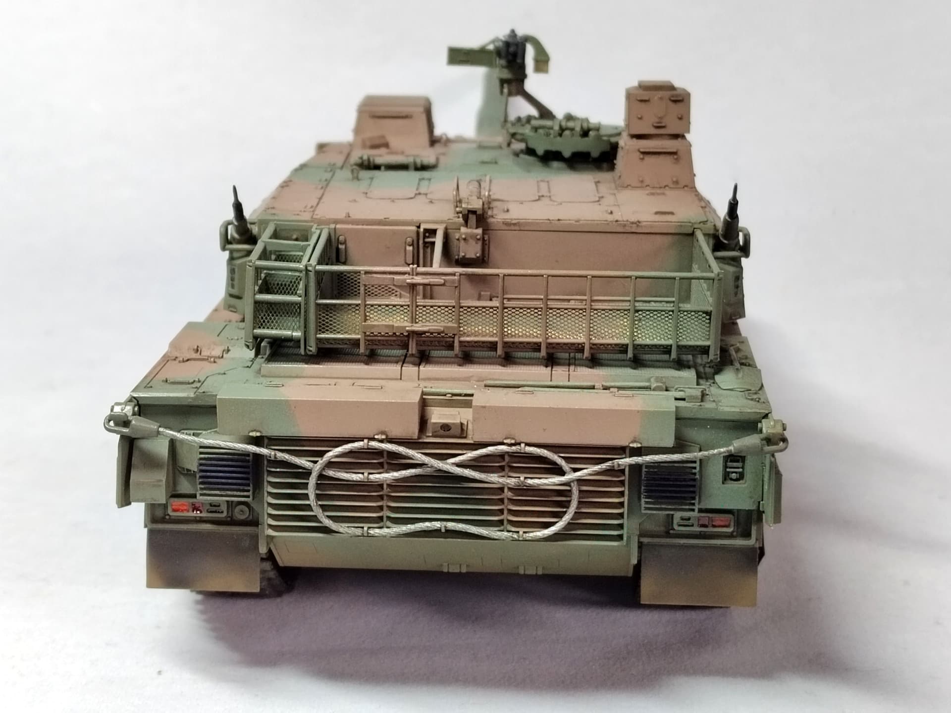

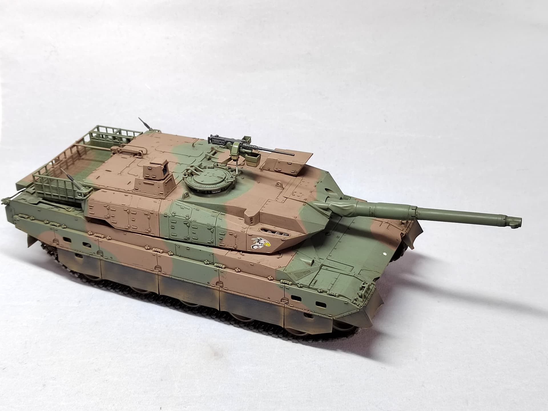

I put the final touch on this beast with spraying some pigments diluted with Tamiya acrylic thinner. I just wanted a slightly dusted lower hull and running gear.
I’m calling this one done.
Olivier
