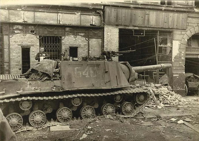

As with the KV tank, the tracks with alternating links are the so-called split-link tracks, as the links without guidehorn consist of two parts each. Starting with the KV-1S, the width was reduced from 700mm to 650mm.
These tracks were also used on the KV-85, the SU-152, the IS-1, and the early IS-2 and ISU-152.
Later in the war, they were gradually replaced by the track without split links.
Another type was experimented with:
It’s sometimes seen on Berlin pictures of the IS-2. The picture above of the ISU-152 also has these tracks, as can be seen even from the side.
That said the RFM tracks are not wrong, it’s only that they were less common in late 1944 / 1945. The tracks that I’ve showed are non-standard, but an alternative design.
