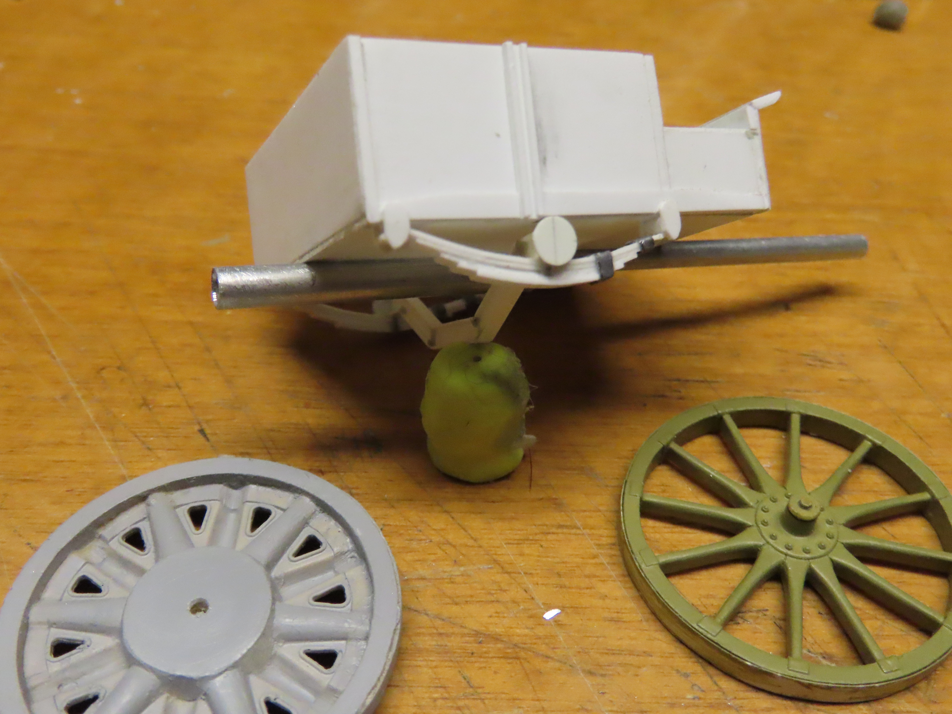

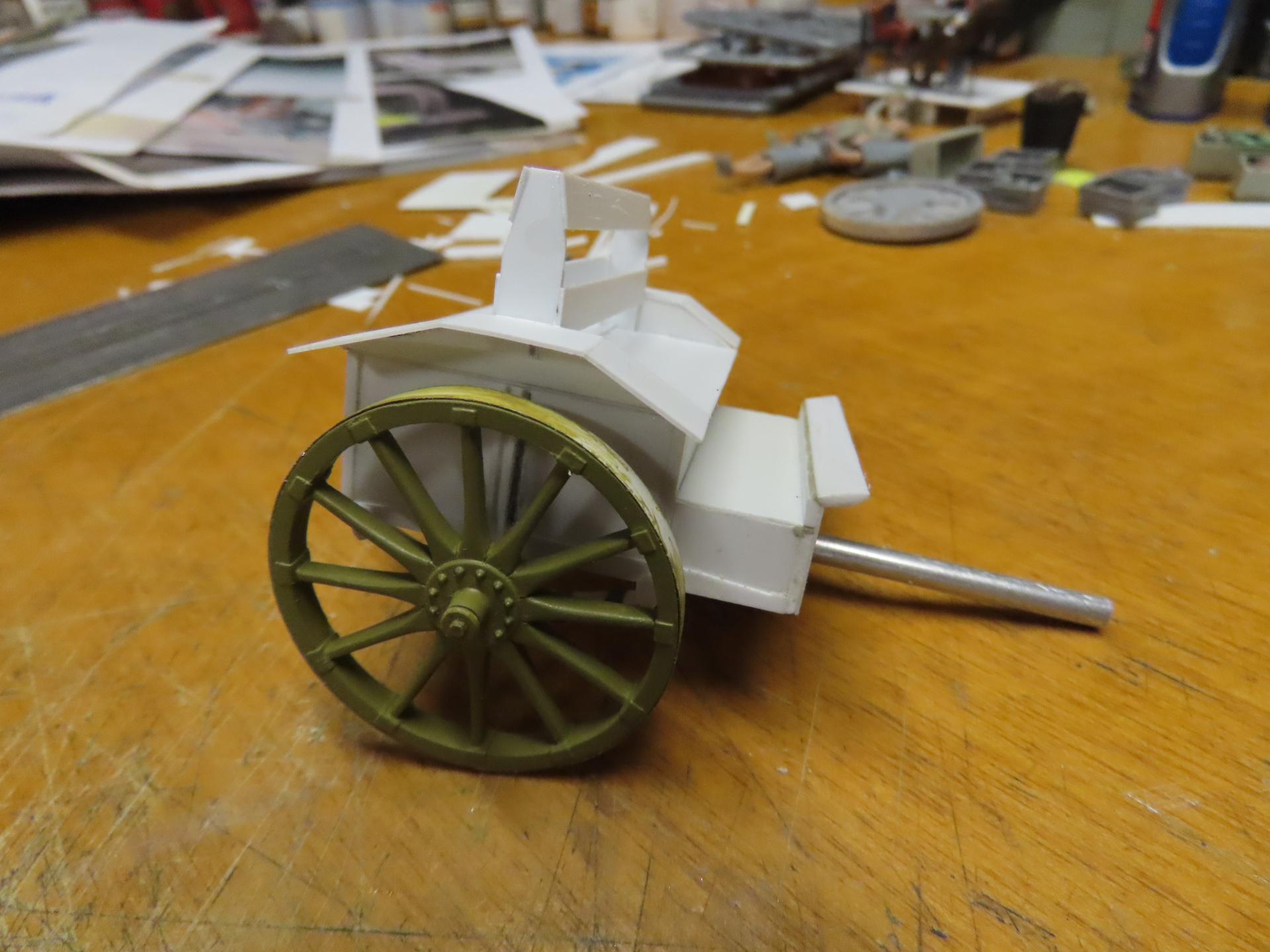

I built a prototype wheel the first time and I still have the master pattern. I will have to cast more wheels. Hopefully my resin is still good after all this time ! I have a lot more good references this time which made the build a bit easier and eliminated some guessing. Basic shapes came first,followed by layers of detail
I will be using the wooden wheel lighter version for this build as all the late war limbers I see are using it.

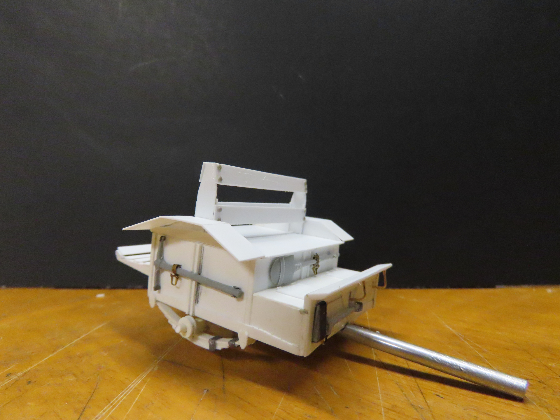

Layers of details added.

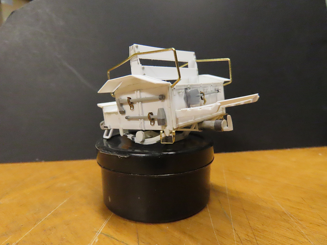

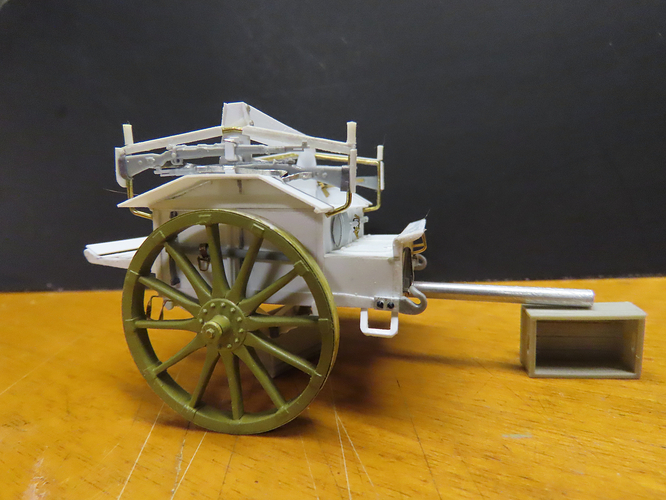

Last nights’ additions. I will remake the handrails though. Kinda screwed the pooch there.
I really like your use of multiple construction materials. Looking good.

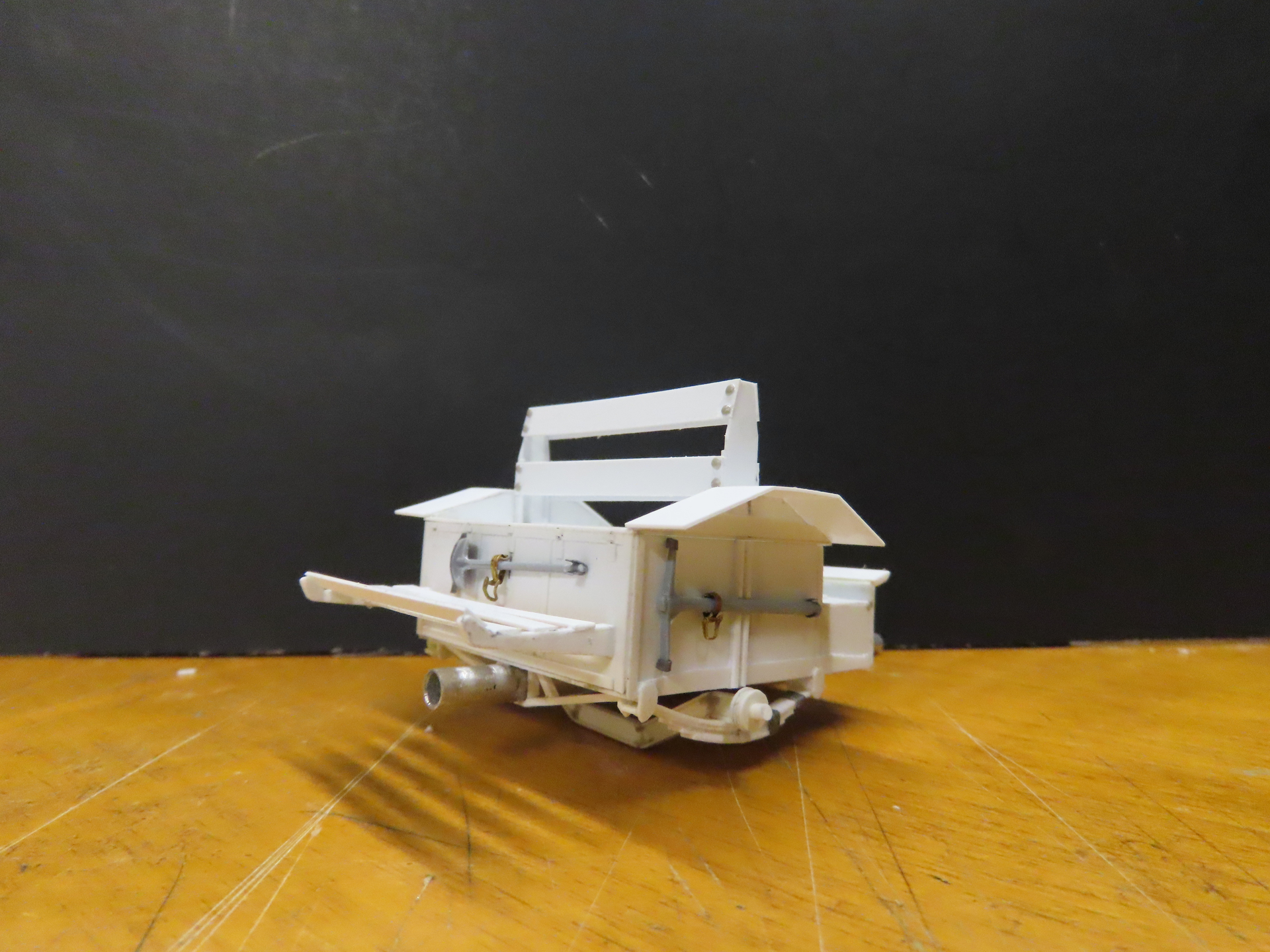

All done except the front tongue. I need that as a handhold while I paint. Then those details will be added.
Veeery nicely done!
Outstanding as usual Jerry!!
Gorgeous looking limber J, 10/10!

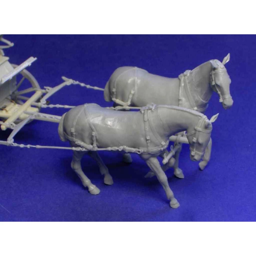

These are very nice by Resicast . (But pricey)

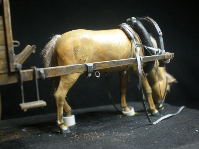

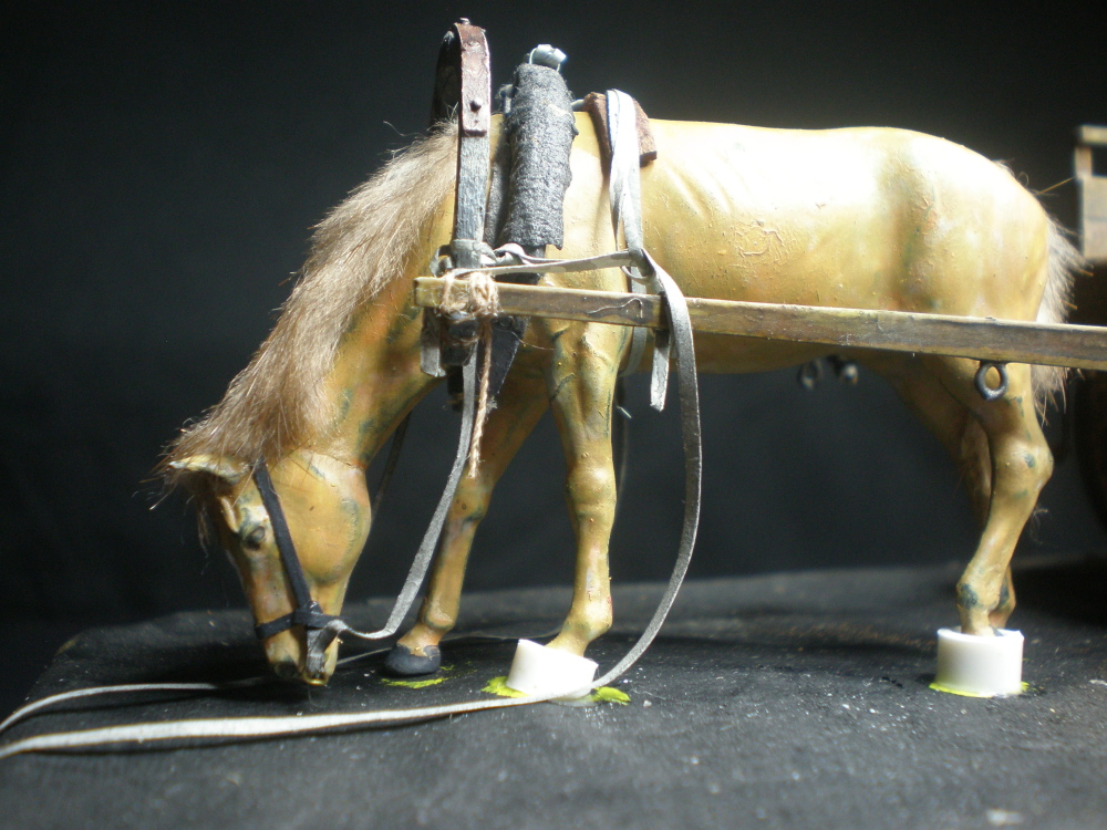

The last horse I built.

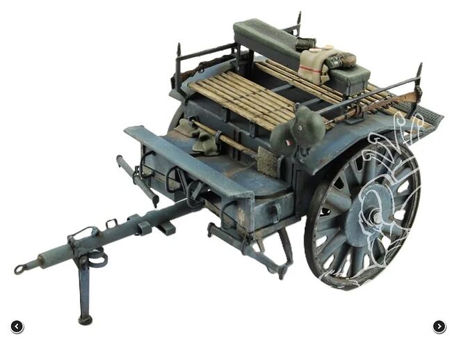

Jerry again with horse drawn Protze for Le FH18 ! I remember you job years ago !
This is still one of my favourite topic !

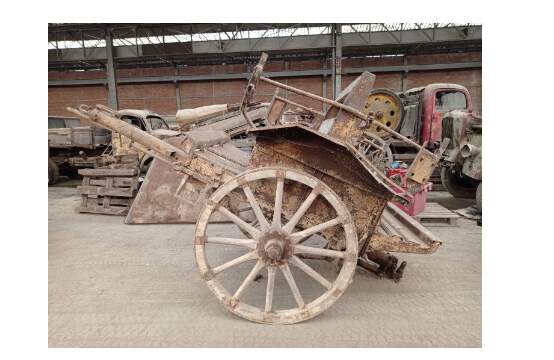

I’m not pleased with the kit because it misses one important feature : the mudguard is not symmetrical. Because the axle is not symmetrical with the body ( axle is here missing but would be between the triangles at the bottom). So I finally gave up… Here an Af12 as an example :

What did you use to create the mane and tail of the horse? I like!
From something SWMBO inherited from her mother (or originally her grandmother), the (fake) fur edging really did need trimming…but only you and I know that…:wink:
