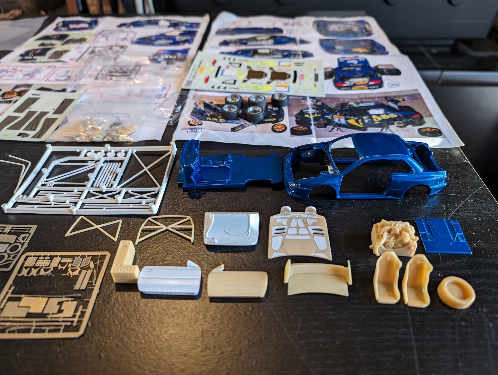

Was sorting through my workbench due to ongoing renovations and came across this. This is a kit that I started in 1998…it’s absolute garbage and quite possibly unbuildable. For some unknown reason I don’t toss it. I don’t even build cars anymore, but it bugs me that this kit got the best of me. Part of me wants to finish it but every time I do I remember why I put it away.
You can win over this kit.
You know, deep inside, that you can beat it into submission.
Bad kits are there to test our abilities
Go for it!
Yes I’m sure that I can. That’s probably why I haven’t thrown it away over the years. The resin is full of air bubbles which makes it a real chore to look halfway decent. It also requires a ton of scratch building for the interior and suspension which is okay. The hundreds of air bubbles are what really hold me back.
Darren, Go for it!
Sorting this 25 year old shelf queen proved very satisfying. It got the best of me in 1998. Not finished but it’s pretty close.
That kit looks awesome, you’d never know it’s been giving you problems…well done. I think I’ll take another run at it in the near future. What kit are you working on exactly?
Darren, sweet, happy to hear you’ll take at shot the old rascal! Looks like a cool car build.
Hopefully there’s a good technique and filler for air bubbles. Maybe something like Mr Surfacer wiped flush with a Q-tip dampened with Mr Color Leveling Thinner or Perfect Plastic Putty wiped with water or alcohol etc.
It’s the old1990’s era Tamiya Panther G kit. Supported with 1990’s era aftermarket like Verliden engine, Cavalier Zimmerit, On the Mark PE, Tamiya PE, Jaguar resin interior, Tank Work Shop Radiators & fans, Tamiya ammo and some scratchbuilt fiddle bits. The Sector35 pre assembled tracks are from ~2020.
Started in 1998, but after a few weeks, I got overwhelmed with fit issues between the radiators & interior and fixing damaged resin parts with tear out. Wasn’t brave enough in 1998 to chop & modify expensive (to me) aftermarket resin parts to make it work etc.
