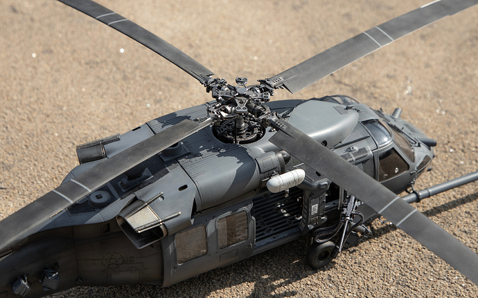

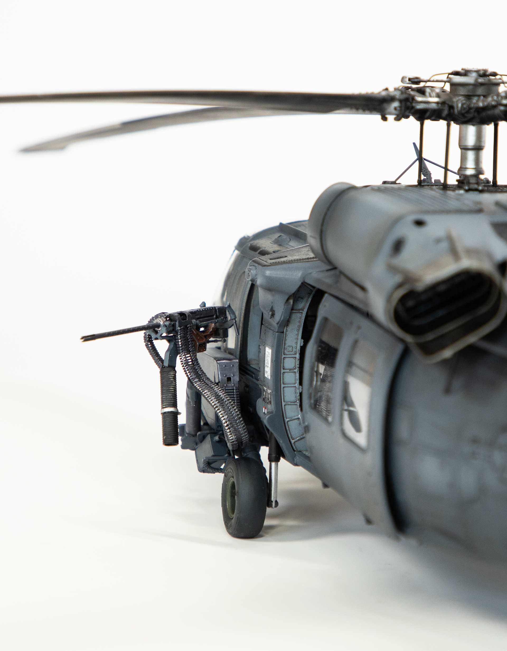

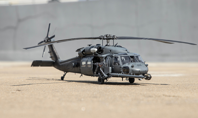

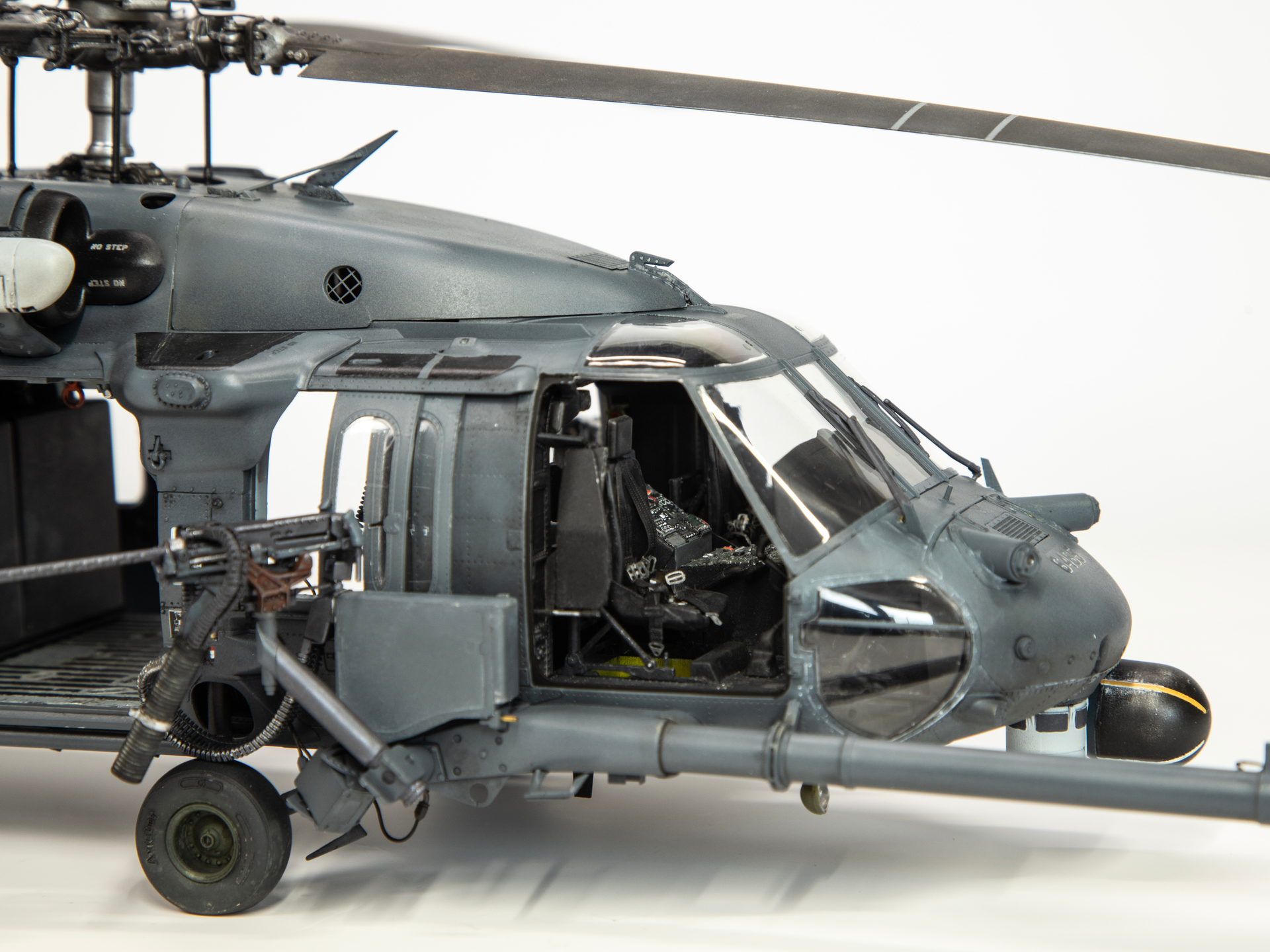

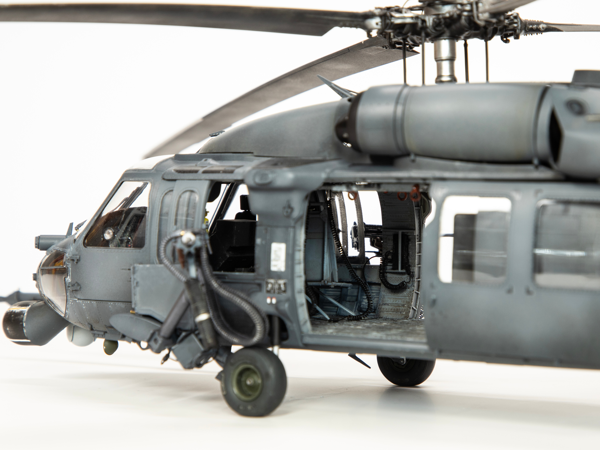

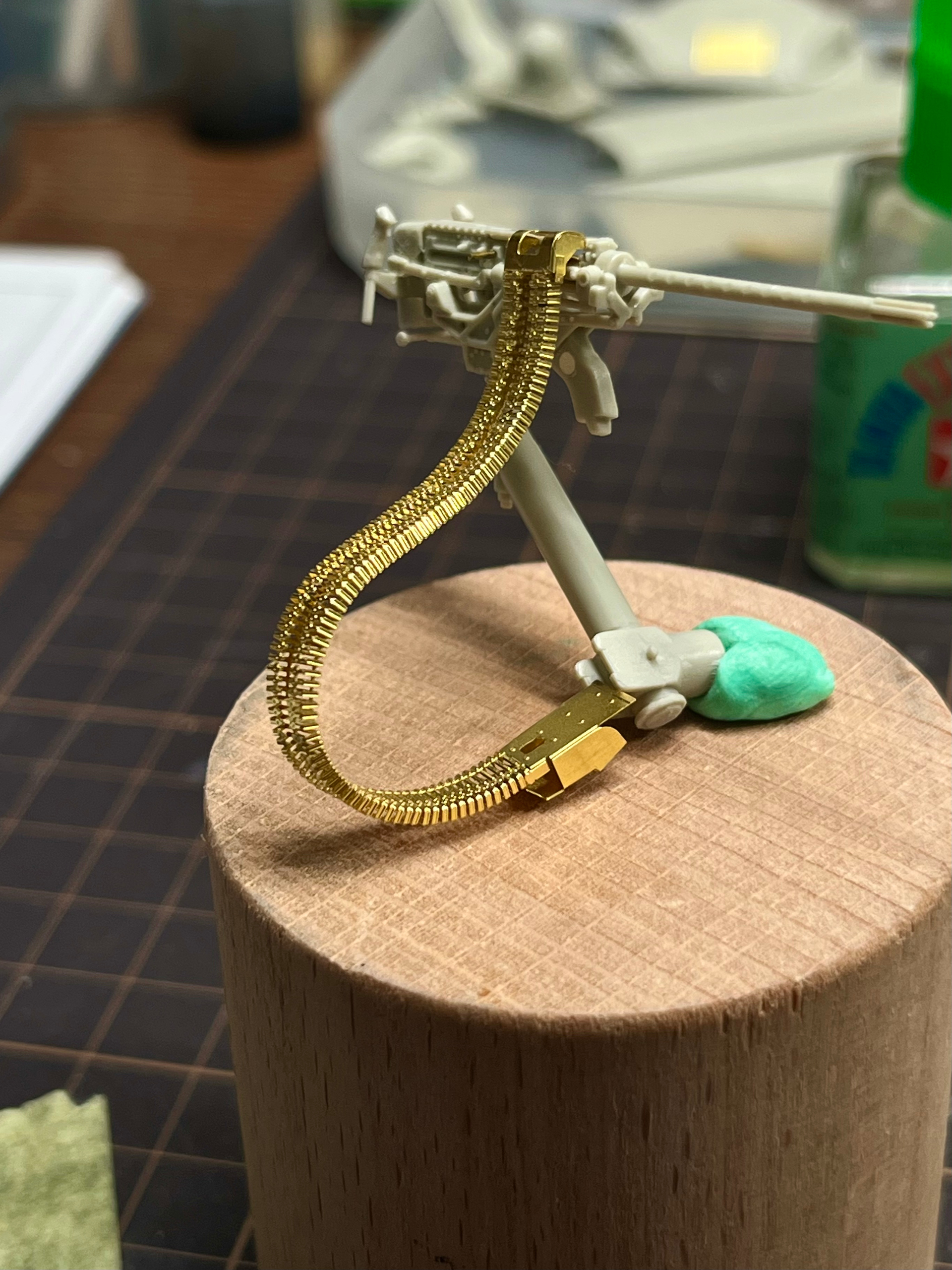

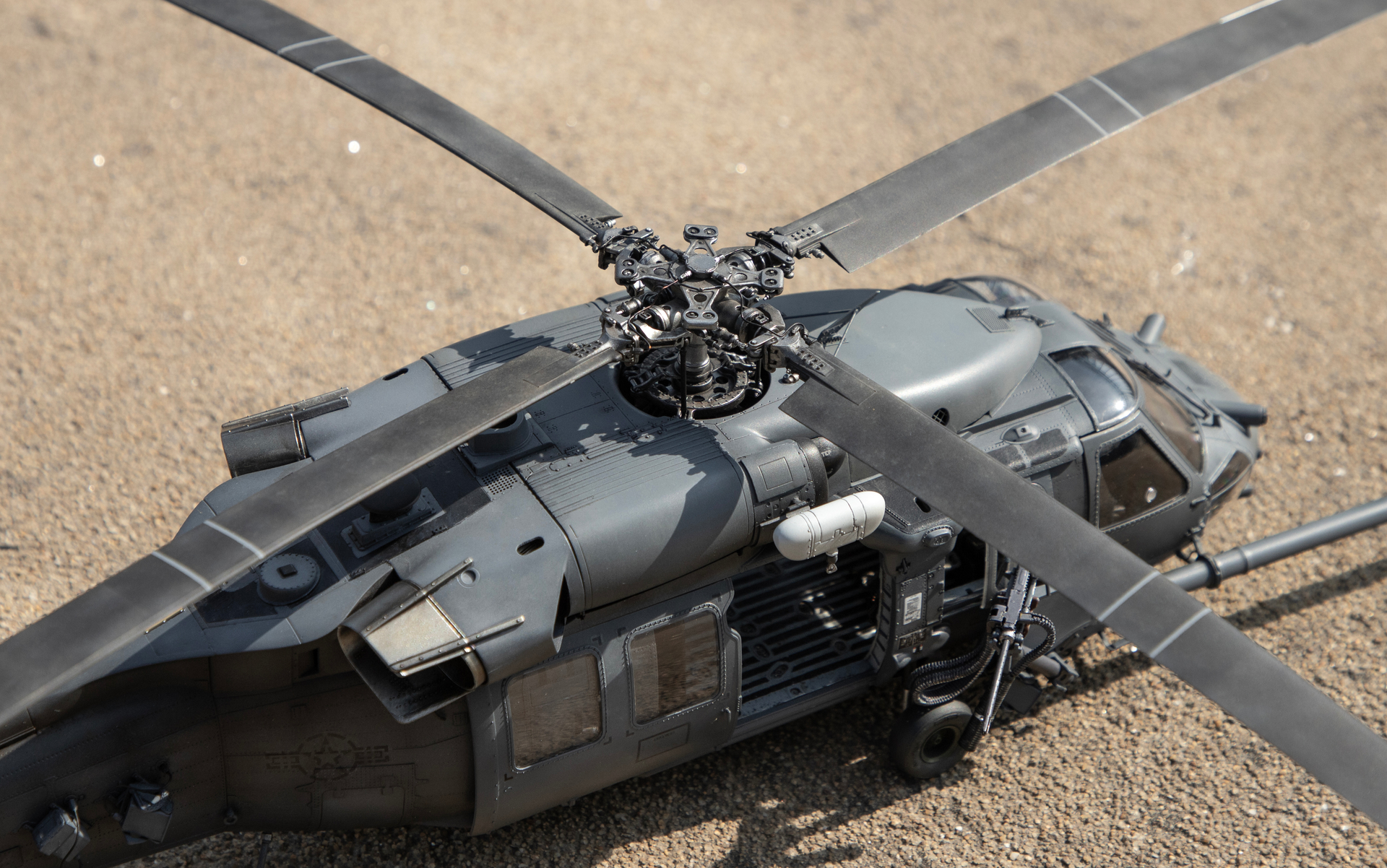

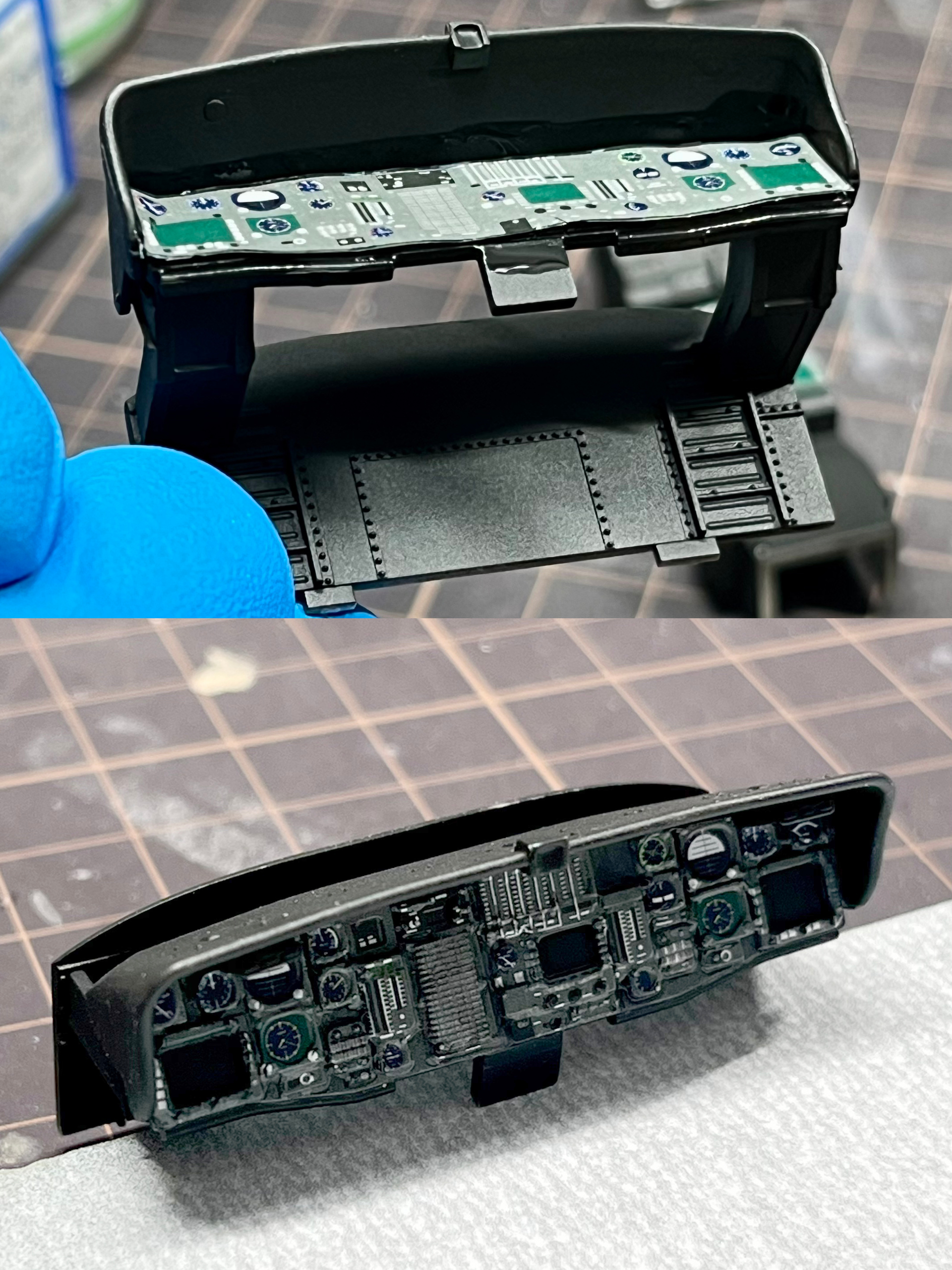

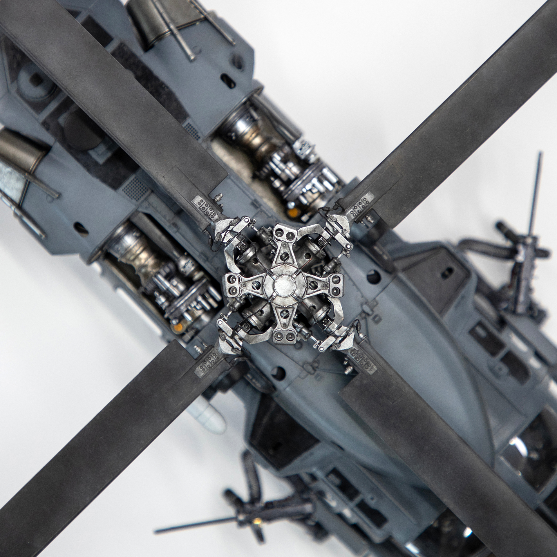

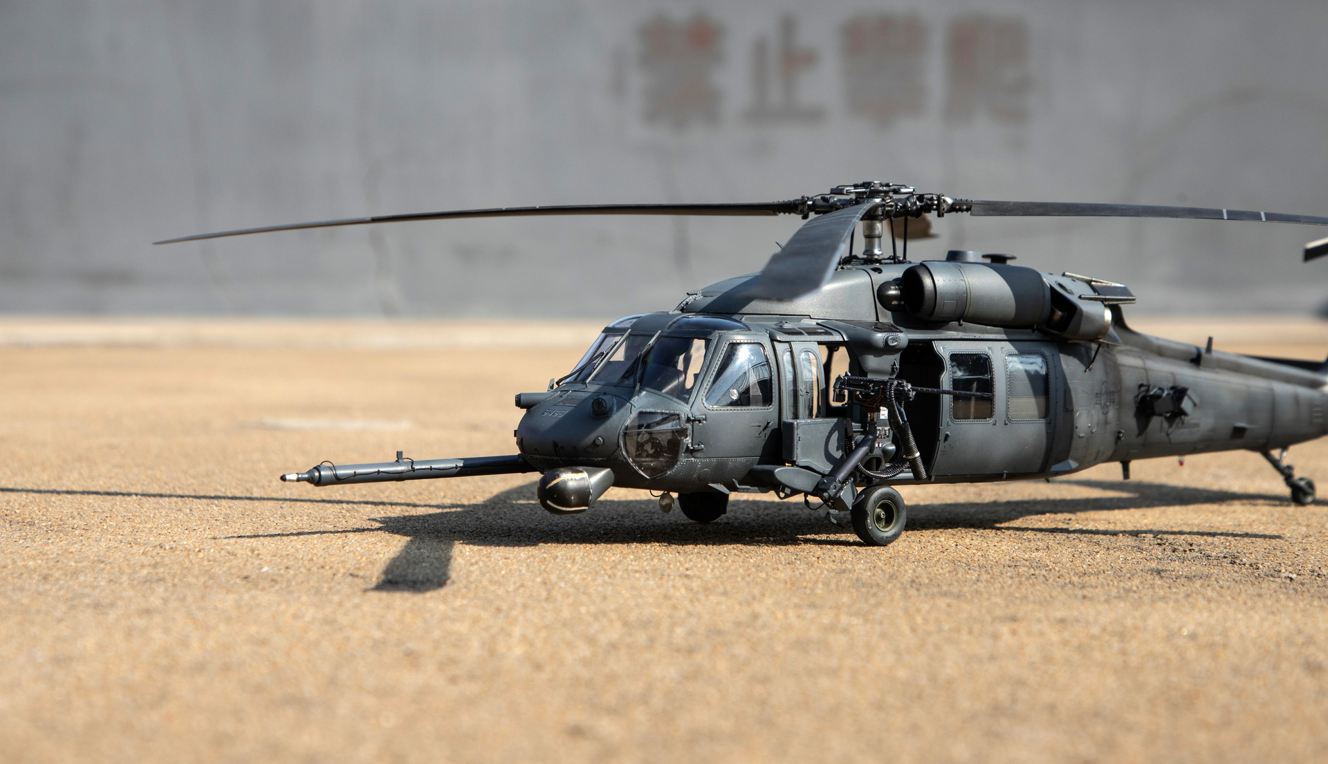

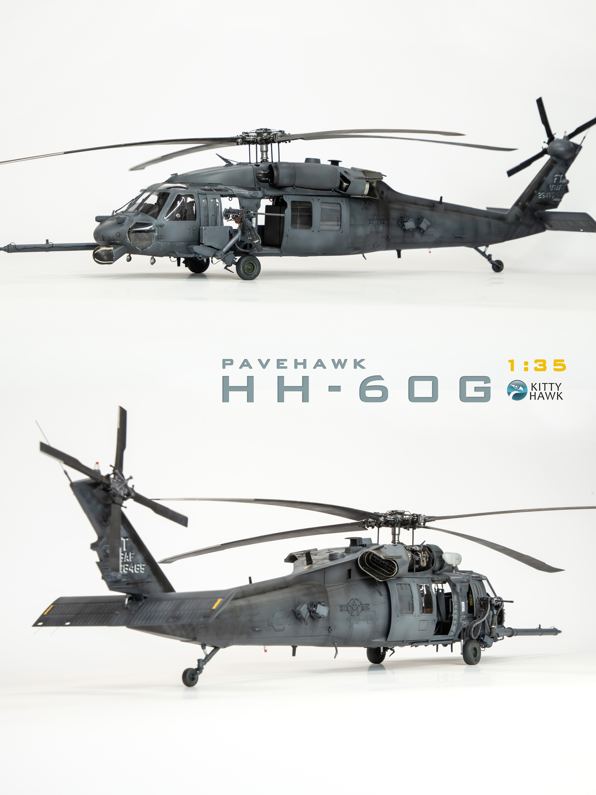

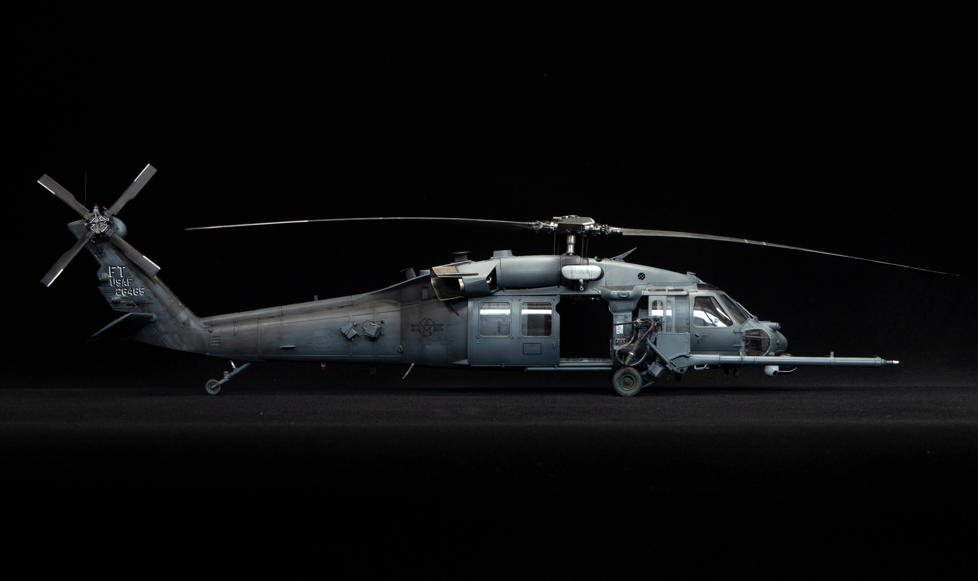

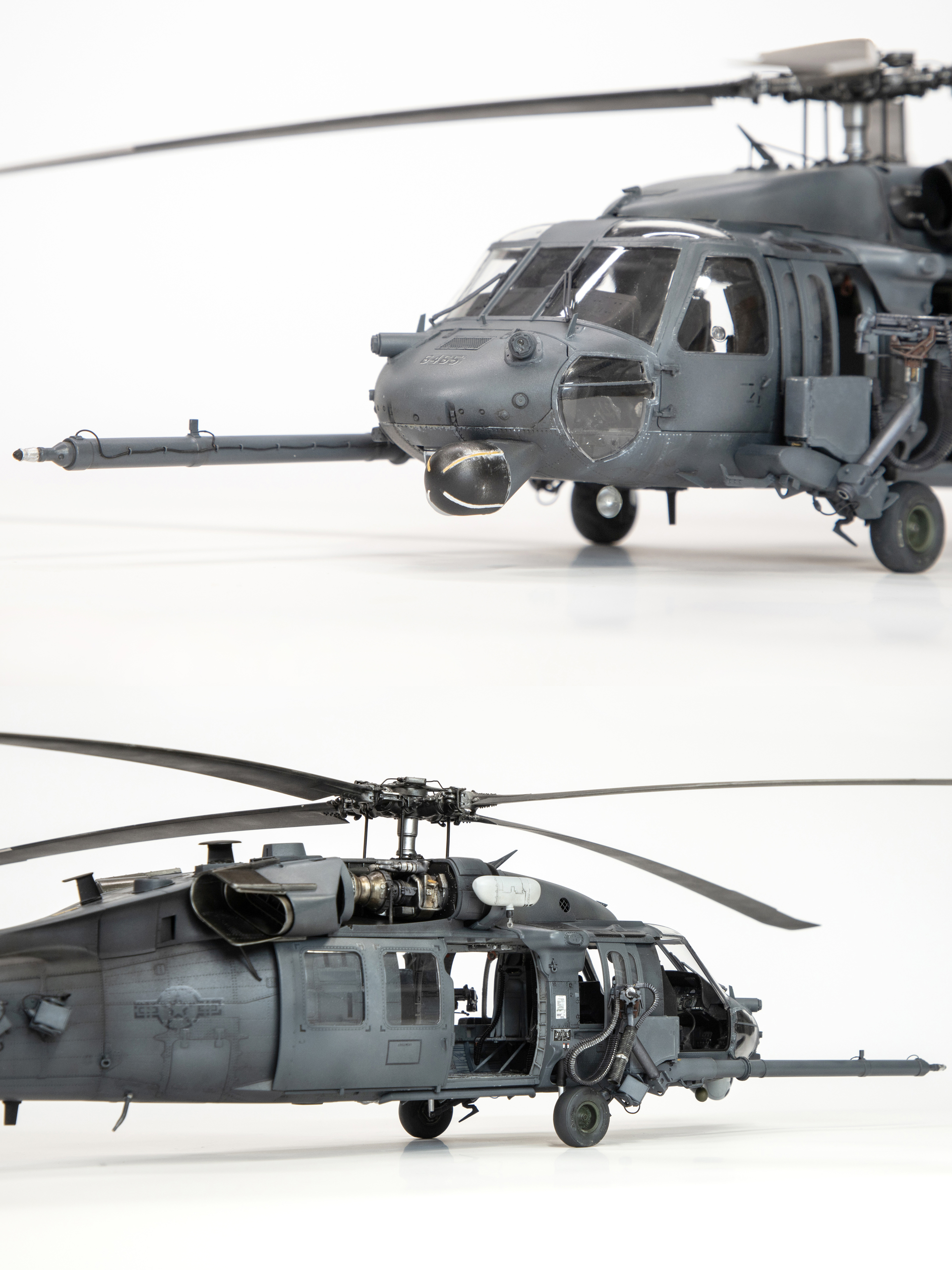

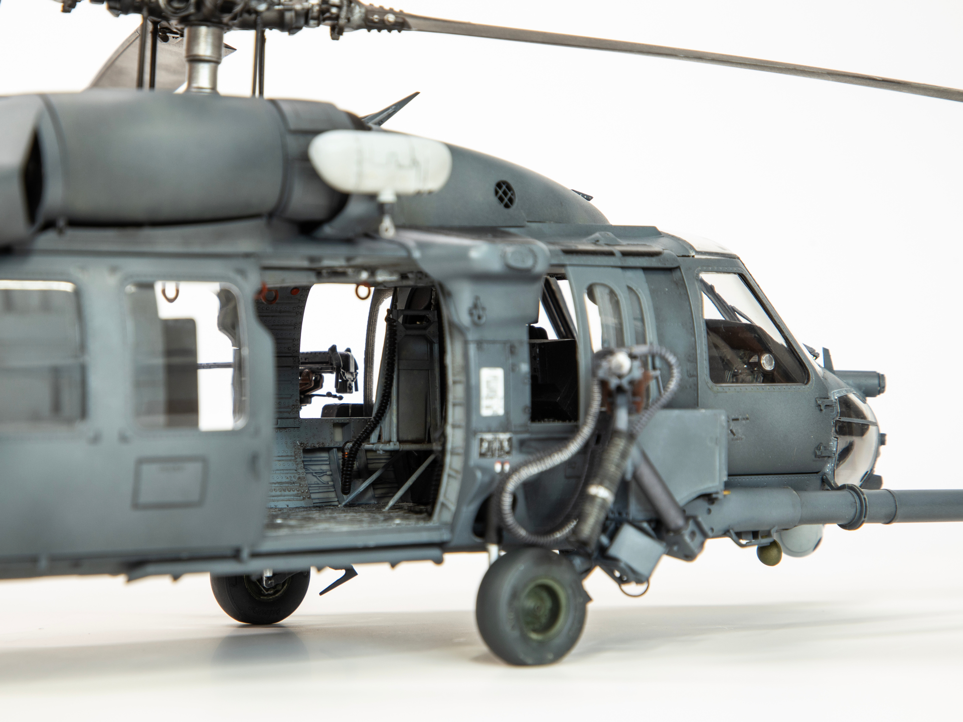

Hi, my name is Wang, I’m from China. This is a 1/35 HH-60G Pave Hawk helicopter that I recently completed. I made some modifications, such as adding a refueling probe, chaff, and machine gun ammunition belts. The decals that came with the kit weren’t very good, but I solved it by using a hot air gun.Thank you for watching!

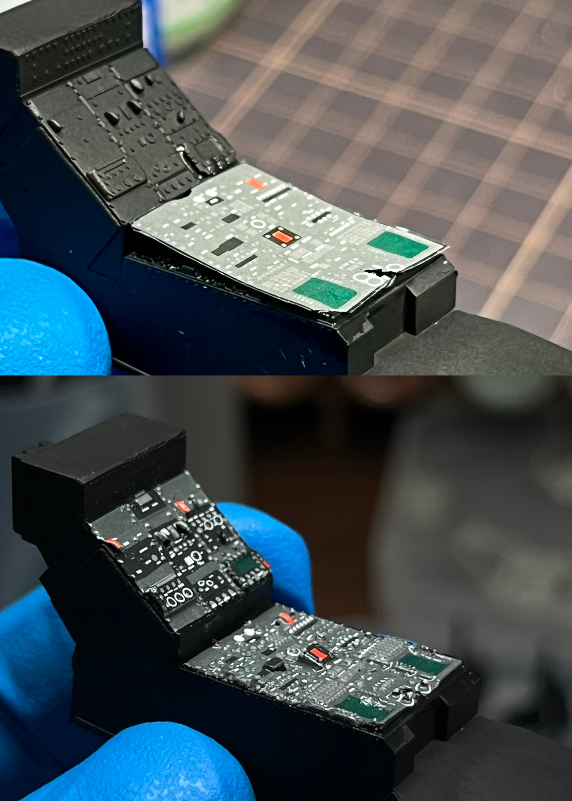

Welcome aboard and great looking build. :+1:
Thank you very much
Looks pretty nice. Good job on it.
Excellent build.
That is a fabulous helicopter build. Using a hot air gun on the decals is a trick I’ve not heard of, thanks for sharing that. Again that is a first rate build and welcome aboard!

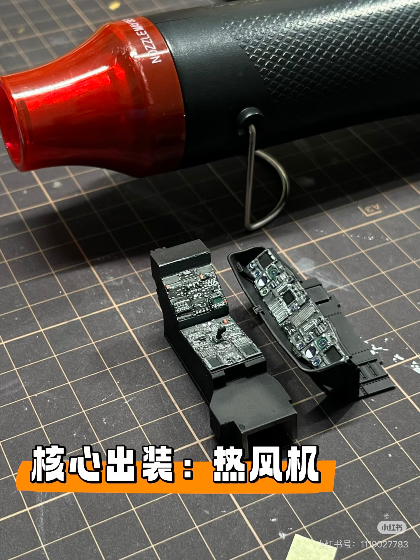

This is the heat gun I mentioned. I’m not sure if that’s what it’s called where you are. When using it, be careful not to blow continuously for more than 2 seconds, otherwise the plastic parts will deform due to the high temperature. You can blow in small amounts multiple times. Before blowing, make sure to place the decals in the correct position. Alternatively, you can soften the decals with heat and soak them in water before applying them. This will protect the plastic parts, but the decals will be very soft.
Well first of all, welcome along to the forum. That is a superb looking helicopter and like @Wig41 I have also not heard of using a hot air gun for the decals- but the results are top class. Thank you for sharing both that technique and your build with us.
