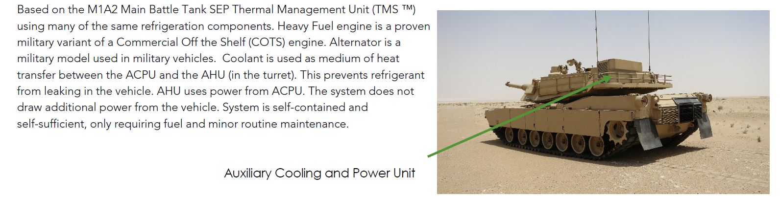

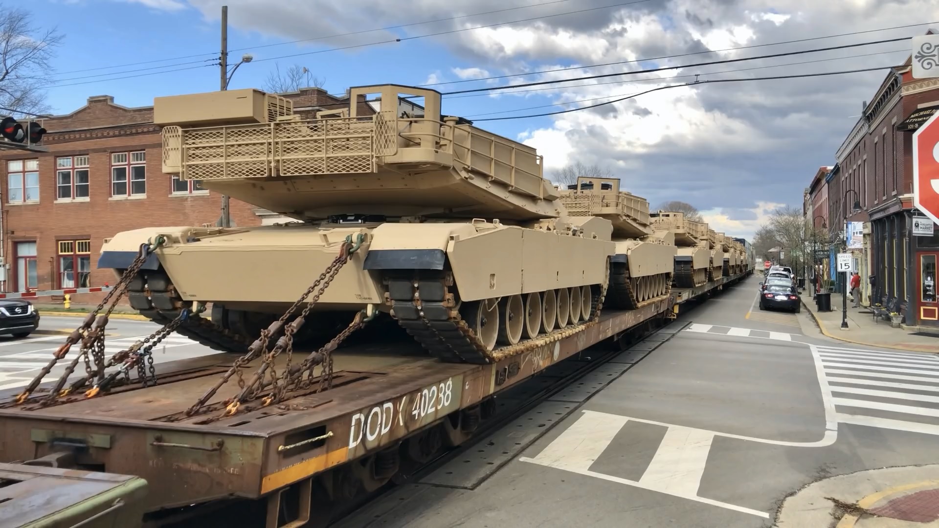

“The train with M1A2K Abrams tanks is in LaGrange, KY on the Short Line from Cincinnati, OH. The M1A2K ordered by Kuwait can be identified from the Auxiliary Cooling and Power System, the Counter Sniper Anti Meterial Mount for a barrel mounted and turret serial number w/ suffix Ē.”
So its combination airconditioner and APU?
The M1A2K is equivalent to a US M1A2 SEP v2, but with a new/different VCU/APU combo unit. The CROWS II makes them v2s.
They are not M1A2 SEP v3. The main external differences are around the left rear where the Under Armor APU has been reinstalled, added attachment points for the armored tiles around the cargo rails and smoke launchers on the turret, the extended rear mud flaps, new tow cable ends, and larger clevis attachment points. Also, the turret face armor has been extended outwards with an added layer of armor. Low-Profile CROWS is another indicator.
