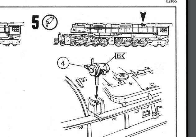

I am looking for Part #4 for the Revell Big Boy locomotive. I think it’s the whistle, but I’m not exactly sure. I contacted Revell, but they don’t have the kit or the spare parts anymore. :confused: Any help will be greatly appreciated.

@RDT1953 I’ll give that a try. No idea what it is, though.
@Frenchy Yes, that’s the part. Any idea what that is?

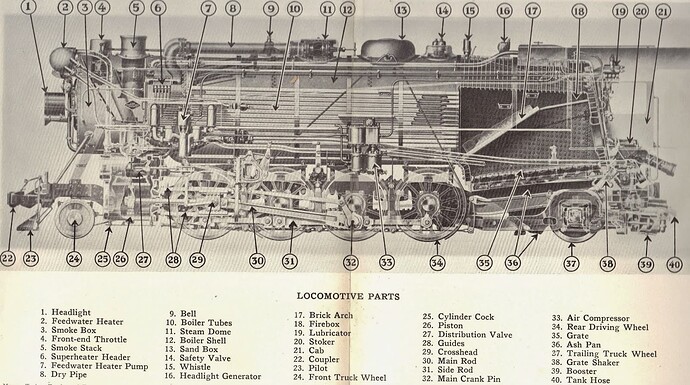

My guess is one of parts 14-16, maybe?

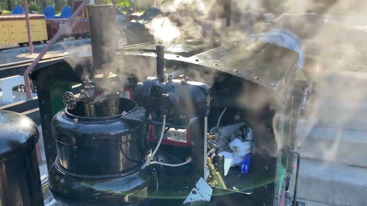

Based on the video clip provide by @Frenchy where that part is letting out steam the whole time (not a safety valve) and the diagram provided by @HeavyArty I say it is the headlight generator or dynamo (nr 16 in Ginos diagram).
A safety valve would only be letting off steam until the pressure has been reduced to safe levels.
A dynamo will be running as long as the electric headlights need power.
It isn’t the whistle either …

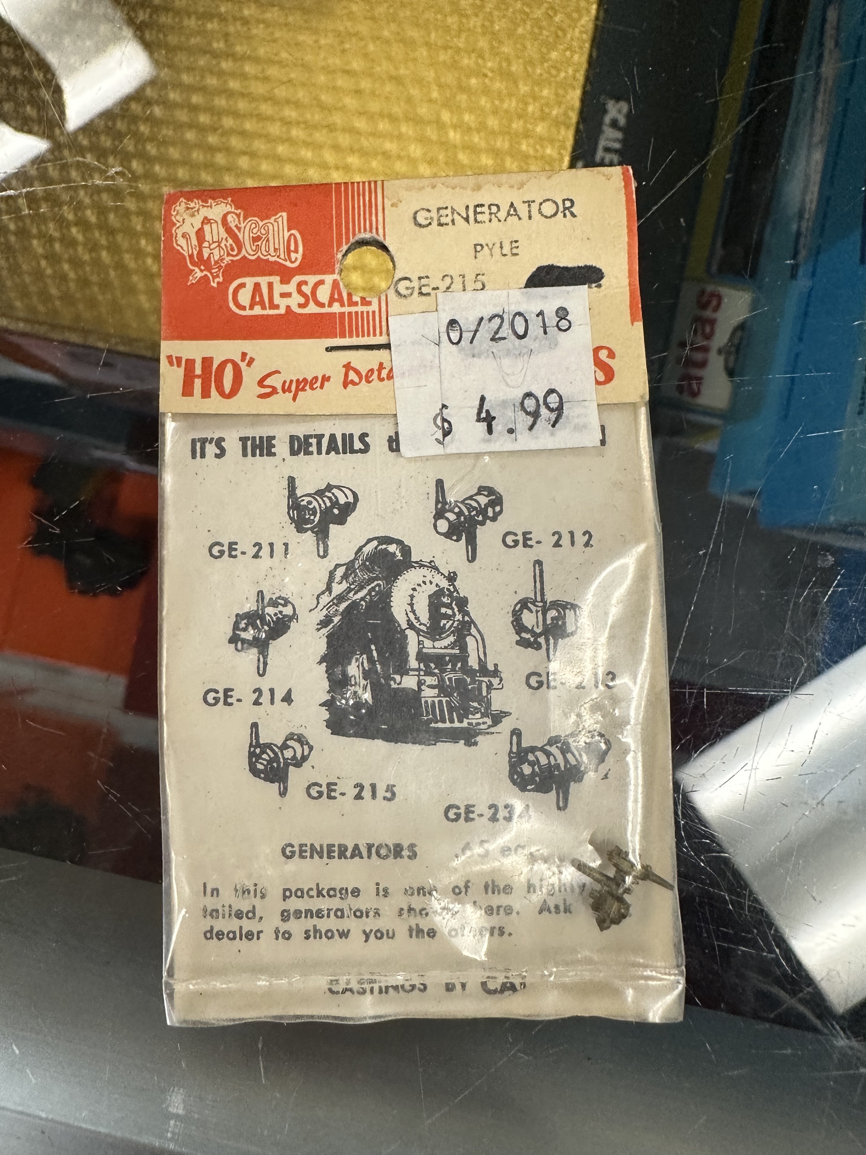

Agree w/Uncle. Generator, which should be available in the Cal-Scale line or Precision Scale.

@Buckeye & @Uncle-Heavy Thanks for the insight, Robin. Tim, I’ll look into those companies to see what they have.

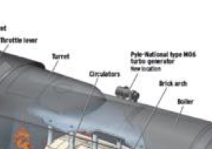

Pyle National MO-6 turbo generator

Thanks, H.P. I appreciate that. Now I know what to look for.
Jim
Found it. Couldn’t reach you so picking it up anyway.
