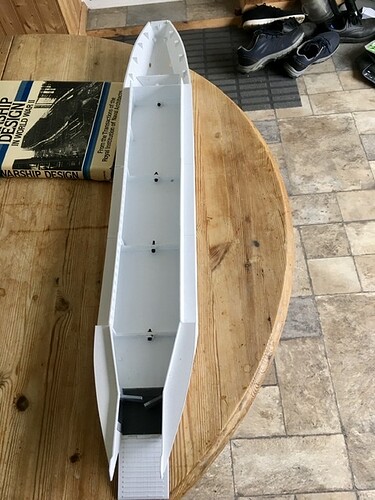

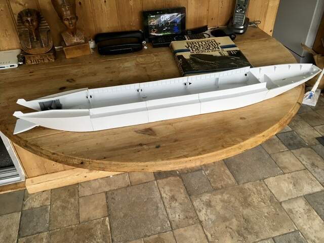

Couple of shots of the LCT(3) hull. I have a quarterdeck and superstructure as well but not accessible right now, anyway I suspect the superstructure is more LCT2 than LCT3*. Yes, I can send .stl files, they are mine to send on the condition they are not passed on to anybody. Need your email address.
Perfect, the book is now on order. Understood with regards to not passing them on and totally agree. The hull looks great, what did you 3D print them on and do you have any tips.
All the structural prints were done on a Creality Ender 3 Pro. I need to make a small change to the bulwarks to improve print quality, the other change I am considering isn’t necessary for an LCG. The superstructure shown in the book is similar to the 3* but the decking forward is wrong for LCG16 and indeed I’m not sure what the foredeck should look like

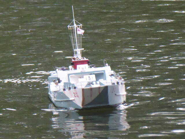

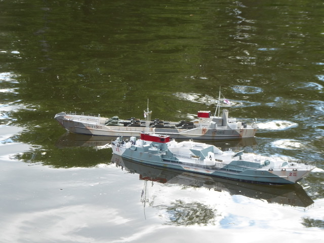

Finally a successful sailing session with the two LCT4 types

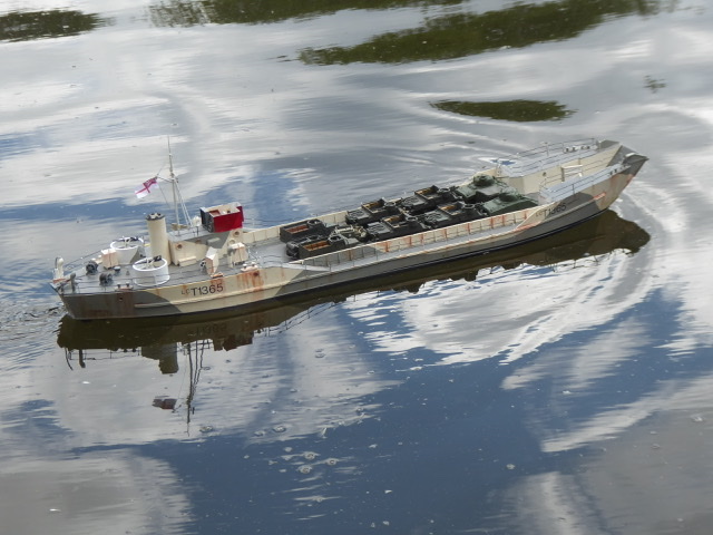

LCT1365
LCG939
LCG939
Both together
LCG939

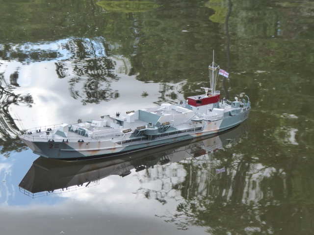

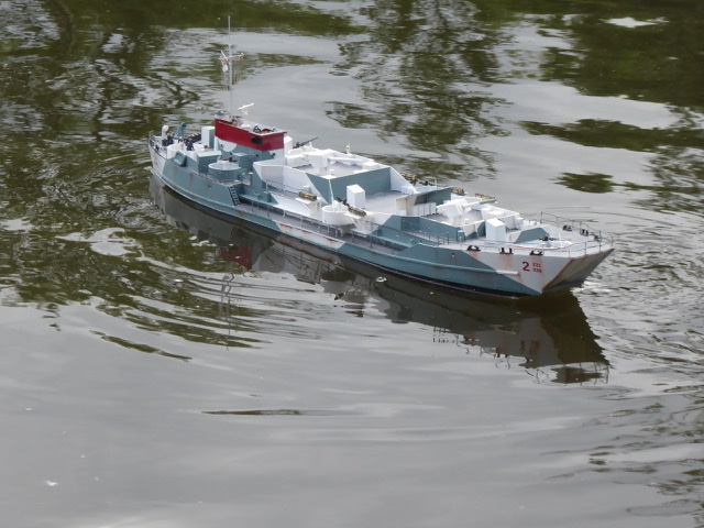

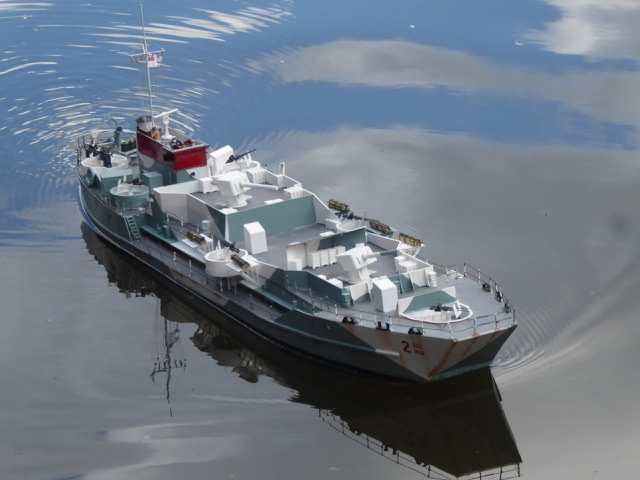

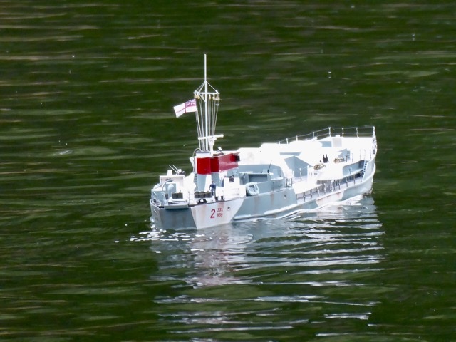

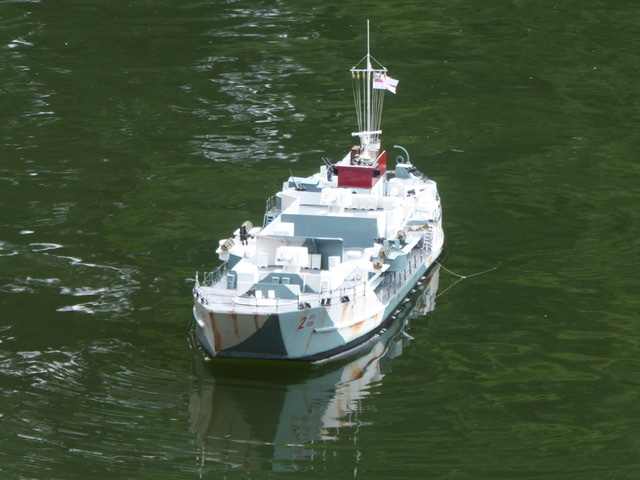

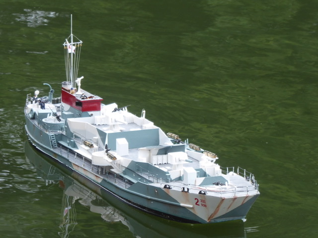

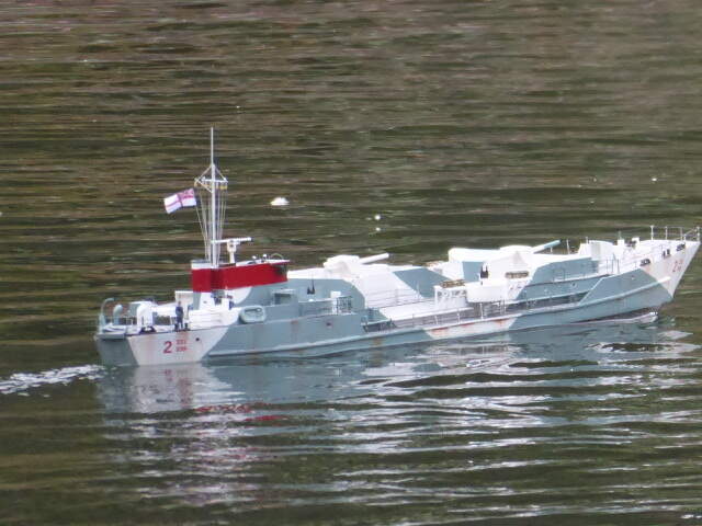

Last pics for now for LCGL939. Sailed her for an hour and a half with no problems apart from a slight leak into the stbd aft compartment that slowly upset the trim. Handling is generally fair, rudders ok, will turn on the screws with rudder. Moderate gust of wind sends her leeward and turns her stern to the wind, not surprising given the windage forward. Will turn into the fairly light wind using rudder and full power on the leeward shaft. A few odd views of a very odd boat.

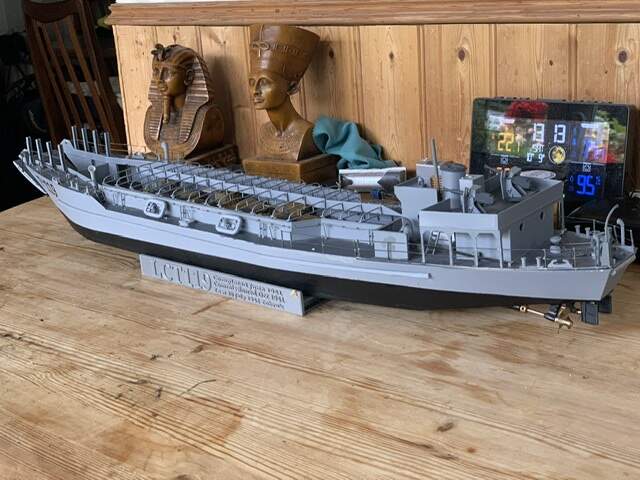

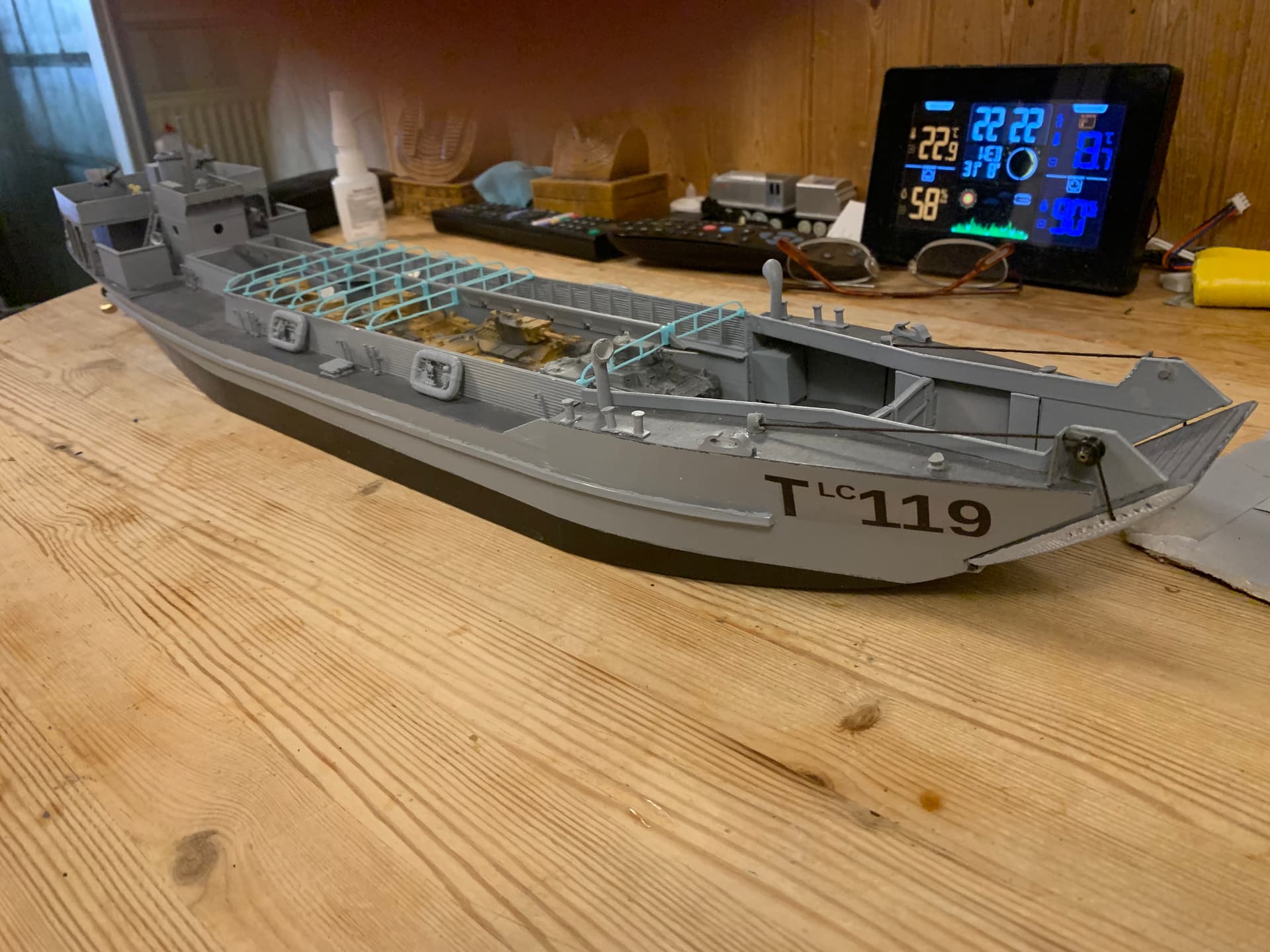

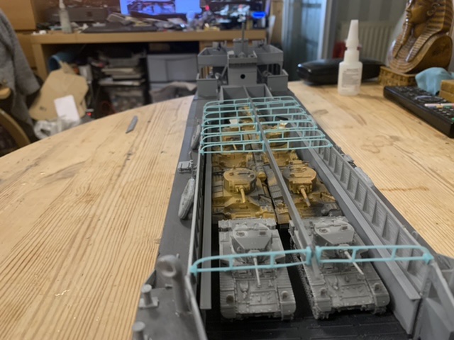

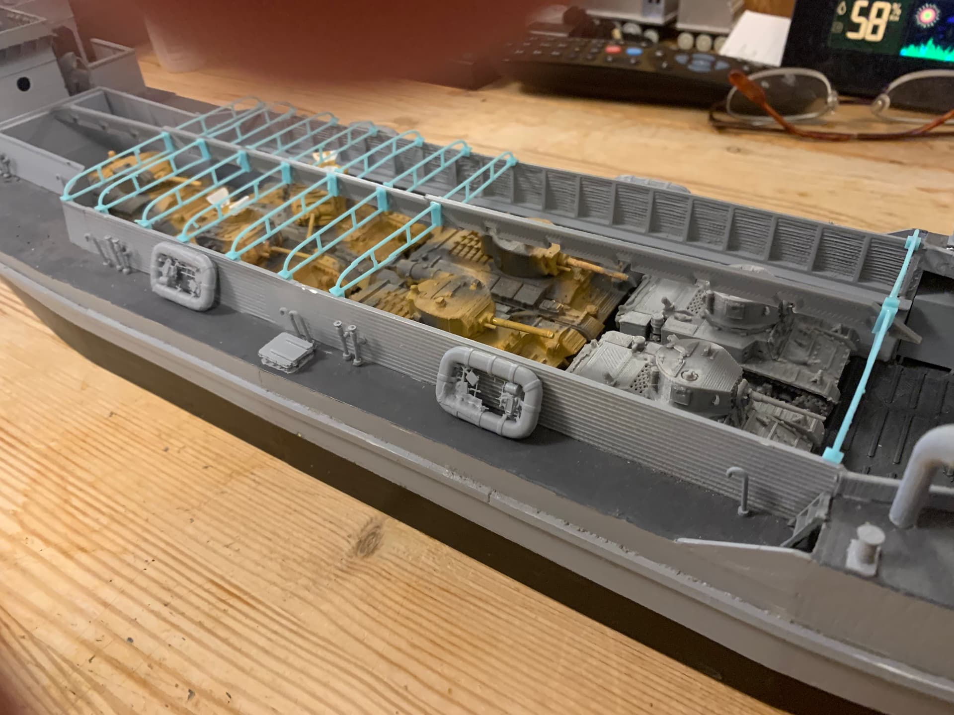

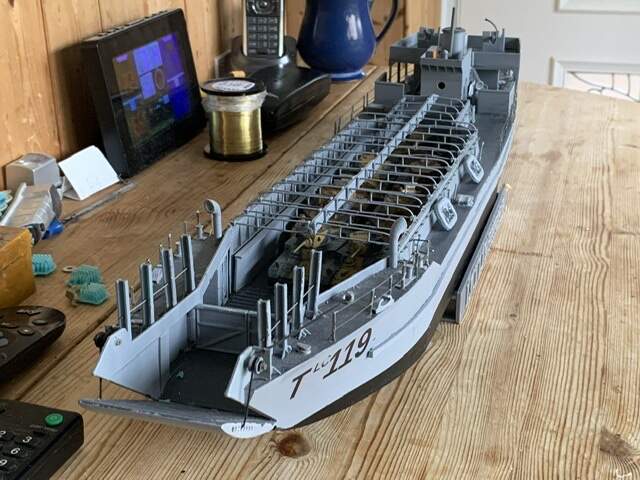

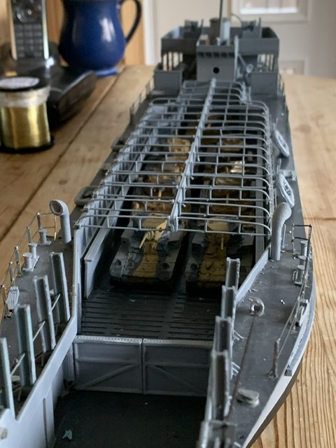

Back to LCT119. The tank deck is very low down in the hull in these ships so a canvas cover was fitted supported by portable tubular rafters. Most photos of LCT Mk2 and 3 in the Med have the rafters but not usually the cover (too hot!) Experimenting with resin printed rafters, removable for access. Might be a bit delicate for sailing. I like the used look the rafters have acquired in getting them out of the supports. Need 5 more long rafters and 3 short ones.

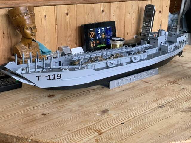

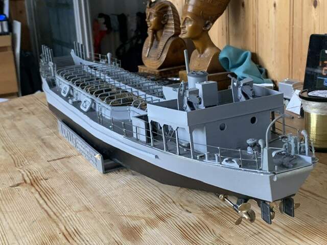

Another week and LCT119 feels almost done. Handrails, storm cover frames, 2 new Honey tanks and a stand added this week.
Bow posts support the cover that closed the tank deck. Some LCT(2) had 4 posts a side, some 6. With no evidence I have given my LCT119 4
Port side is more complete than starboard. The stands puts the waterline parallel with the table and 30mm above it. Will do some for the LCT(4) as well so they can be shown together in a meaningful way
Stern needs crew and rigging for the anchor davit
From the bow showing the posts
From the bow looking into the tank deck and the new Honey tanks in Caunter style camo. A ganyway will go across above the doors. Rafters over the tank deck need stabilising. Yard a rigging needs adding and the ship needs some light weathering

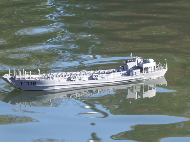

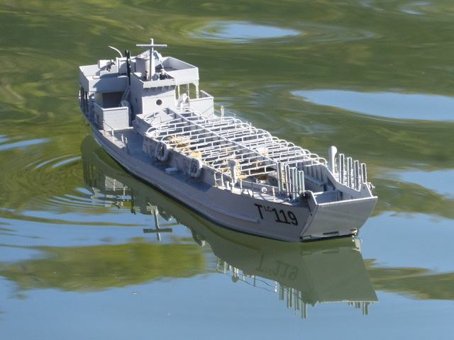

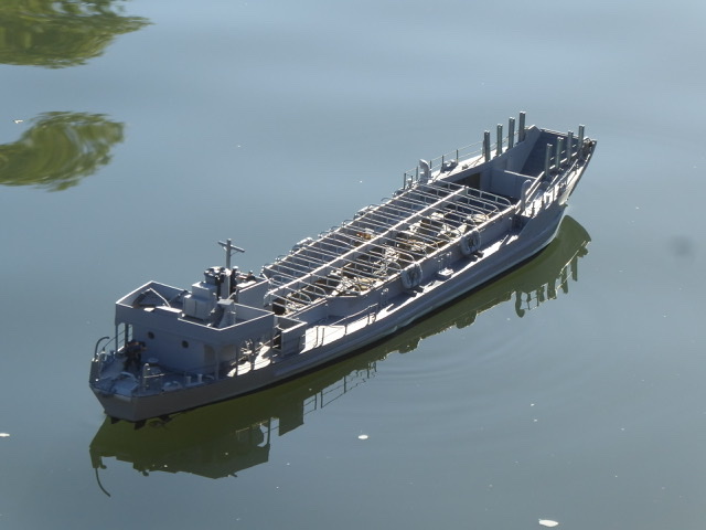

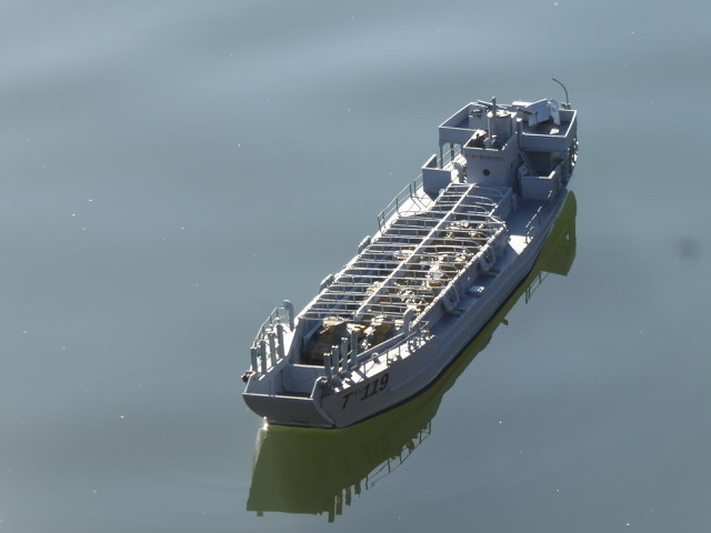

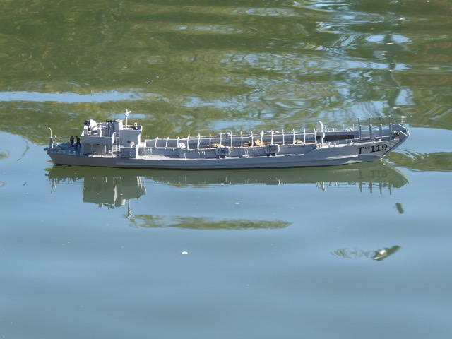

Sea trials at last! LCT119 gets here bottom wet and moves under power.
imageshe floats and her trim is pretty good
image. She is a little underpowered, need to think about that, do I add a third motor, or look for better motors.
Turning circle is large, need to refine rudder geometry, but the stern is narrow and that limits options. Turns well using differential thrust.
Needs some weathering and has a small leak on the midships hull join. Only about 20cc water after about 1/2 an hour
imageShe forms a bow wave at speed where the LCT4 types don’t
Not bad for a 3D printed boat!

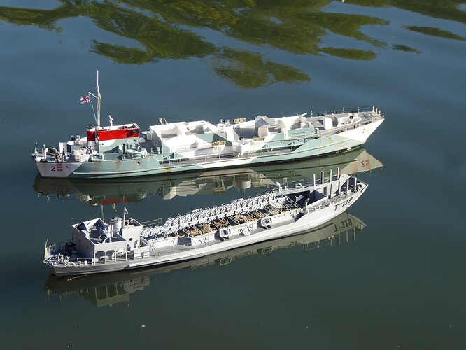

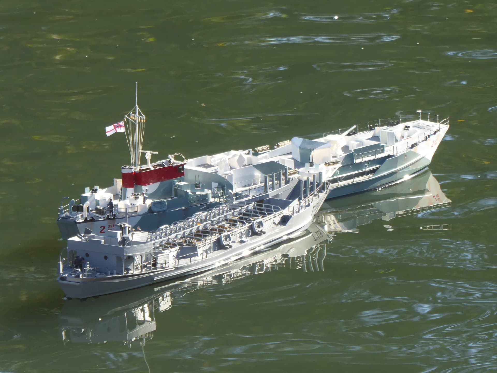

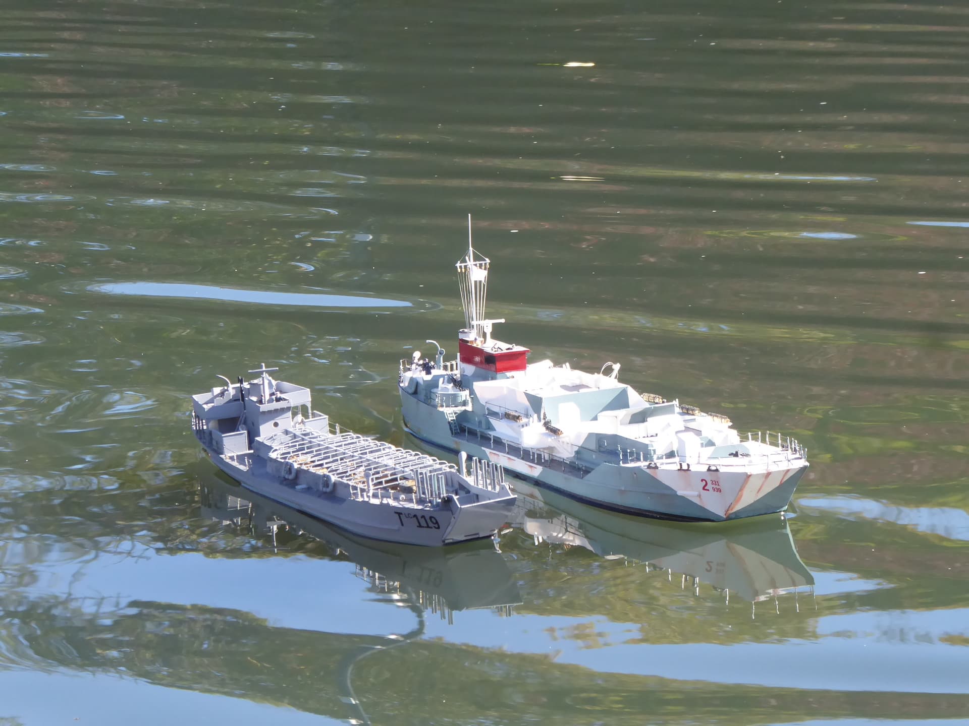

A few with LCG939 that I was sailing at the same time
The two would never meet, LCT119 was lost in 1942, LCG939 wasn’t completed till Feb 1944
Shows the development between the LCT2 type and the LCT4 26ft longer, 6 ft wider, 2.7ft shallower
