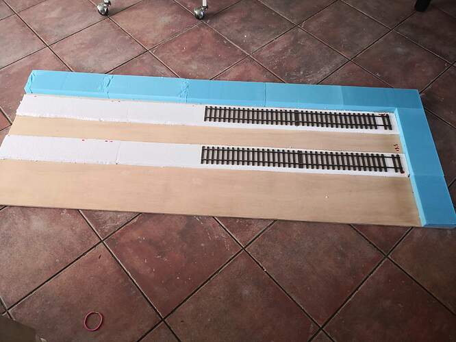

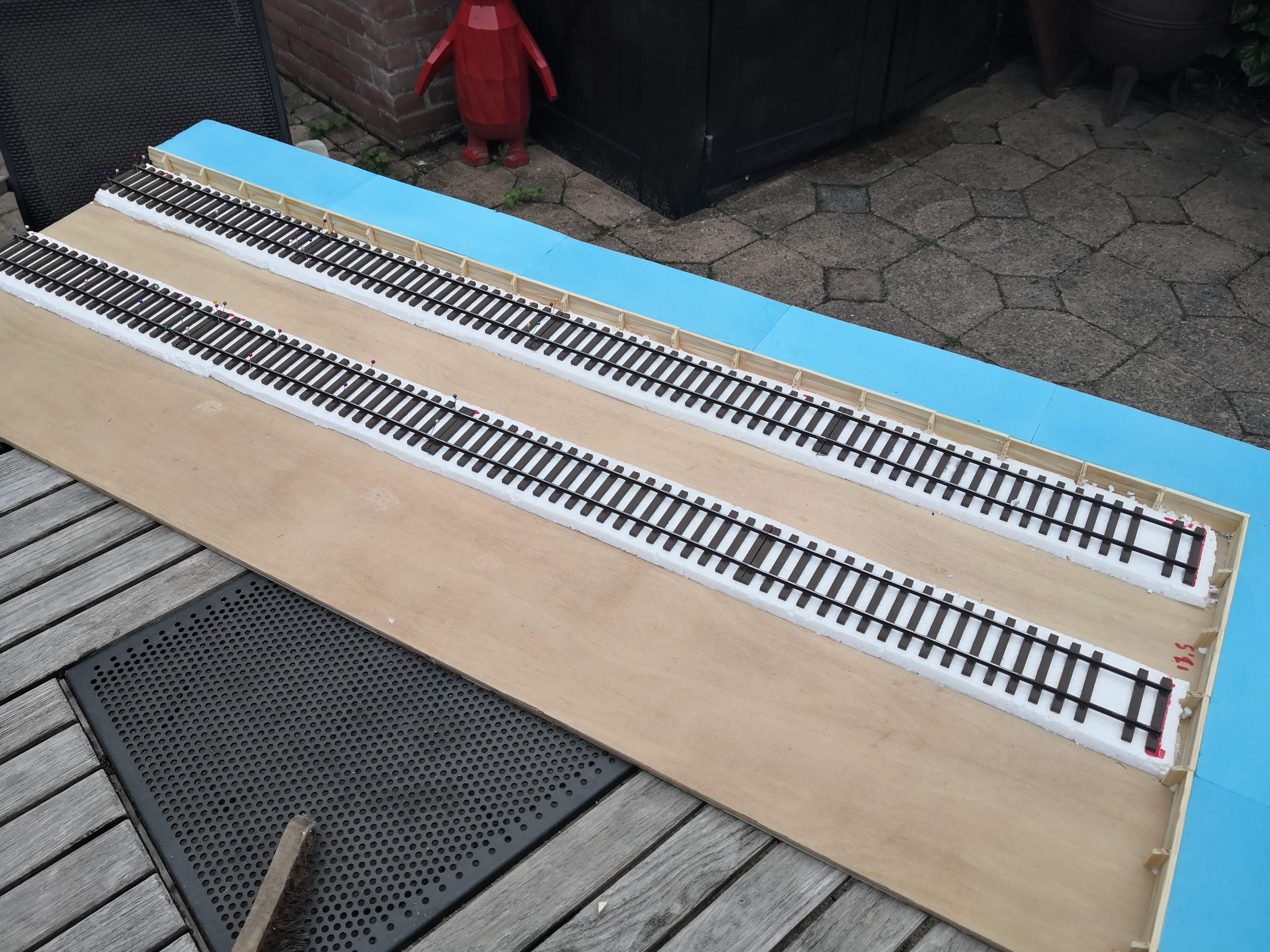

Somehow this project got on a slow burner… But! Not all hope is lost…!!! Last weekend I finaly got a suitable pice of 9mm plywood and started adding some foam blocks on it. Styrofoam for the rail bedding and blue foam for the plattform. And rails ofcourse… So, the dice are cast and the size is clear now… Need to do some messy sanding to get the steps out of the plattform blocks, and decide how to make the sheeting… I was thinking about making sleepers from wood and using those…
Aha glad to see this is um back on the rails so to speak, amazing how motivating the wail of approaching sirens can be Sleepers from balsa or “real” wood?

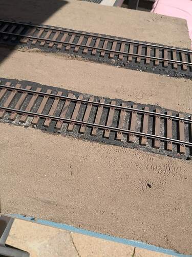

Yes it does, the first try was a layer of pva with sand sprinkled on is and pushed in afterwards. Not a big success.
The second try made me feel like a mason: the same sand, mixed with water and again a fair amount of pva (luckily my wife bought 2 bottles), and applied with a putty knife.
Next will be the touching up of the rails. Then the ballast…

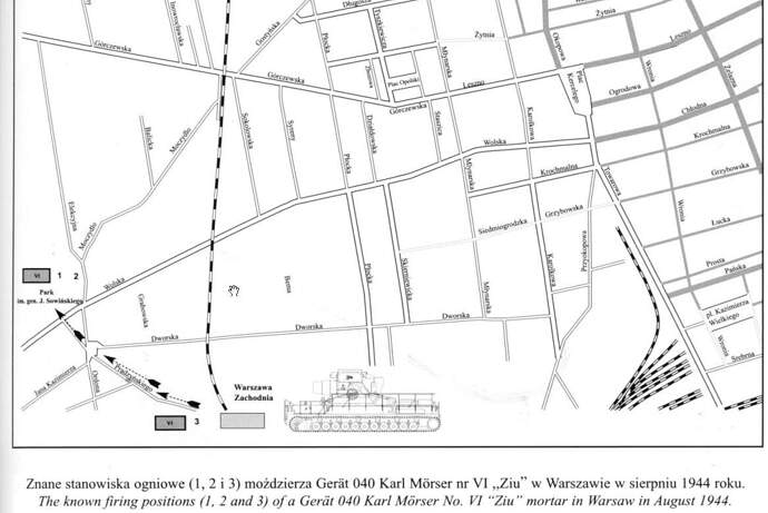

Currently my major headache is what to do with the area Karl will be in…
From old pictures it seems as if those areas were kept squeaky clean… Which is rather boring…
I seem to recall reading that they usually had to build new track where they deployed this giant gun. Several tracks laid side by side. So it would then appear squeaky clean.

@JRutman , I think you mixed up Karl with Dora (what kind of child would come of that!!! )
Karl could be unloaded on a single track, and since there was a railway station near the area of operations in Warsaw, it would be logical they would use that:
