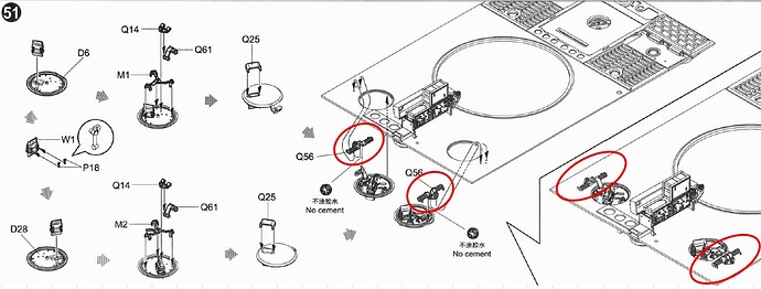

Happy to learn every day … In the instructions of the 1/16 Trumpeter 0945 ( so called) LATE Tiger I , in step 51 they ask you to install these 2 red circled items that have to be added to the hull deck.

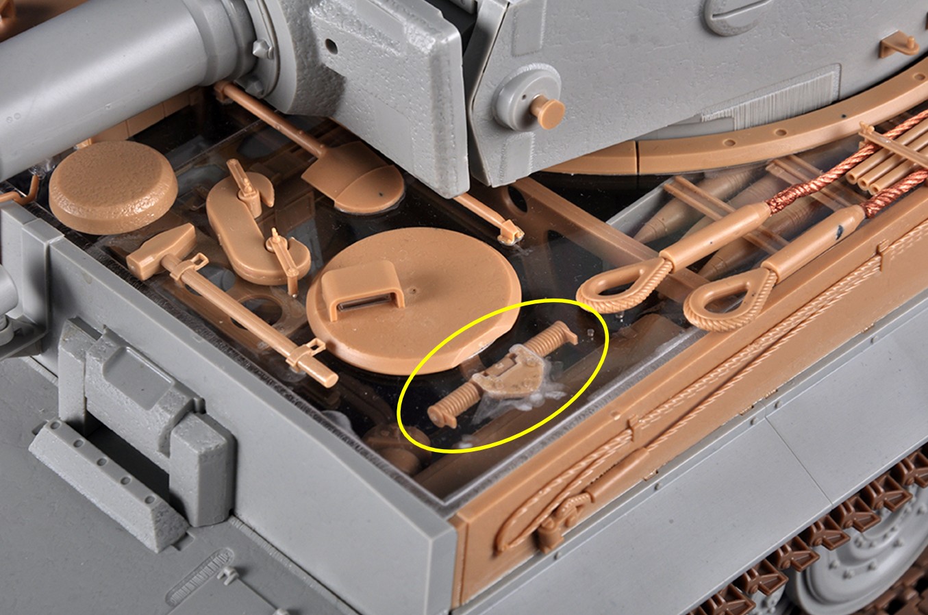

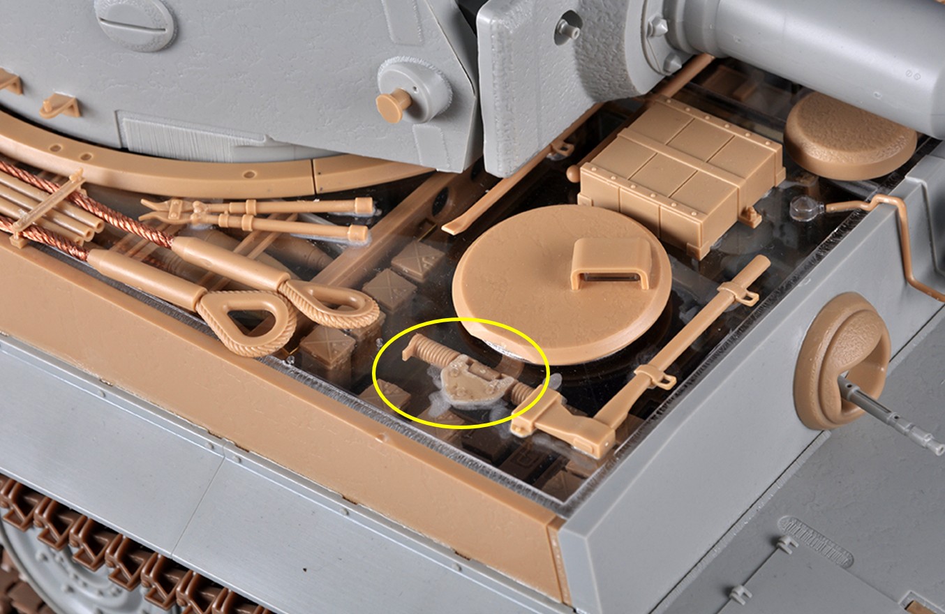

And pictures of the kit show the installed items (highlited with yellow circles).
Never seen this before. Maybe I should know. But I don’t…
After reading all the justifiable comments on the TRUMP 0945 kit I have the tendency to NOT believe anymore everything that is shown in their instructions (or available in the 0945 kit).
Which leads me to this question : Anybody knows what these 2 devices are ?
I think you made a mistake. These are the mounting for the hatches swing mounts. If you look closer, you can see that the parts are installed on the INSIDE.
Thanks for responding. Now I get it : The pictures show the hatch hinges UNDER the Hull deck. Because it’s transparent I had the impression that they are installed ON the deck. That’s why the hinge contact faces make such a blurry impression on the underside of the deck. Have to get new inspiration to look at a tank with a transparent hull deck. Or in my case : “not at all” because I never bought the 0945 kit. Nor will I do that in the future…
Ouch, I can see why it was misleading - those parallel dotted-line arrows should’ve been drawn going under the plate, not seemingly on top of it. And if there were locating holes underneath, probably semi-invisible because it’s a transparent plate.
Potentially evidence that the manufacturer didn’t employ a competent test-builder before release to iron out glitches like that. Don’t get me started :enraged_face: :upside_down_face:
They have flipped the top deck over for the fitting directions as the radio equipment appears on top of the deck. I feel your pain it is very misleading thank you for highlighting it. I have one in my stash so would of scratched my head too.
Thanks guys, I’m glad I’m not the only person who has a wrong perspective on the instructions versus the pictures of the Hull Deck.
