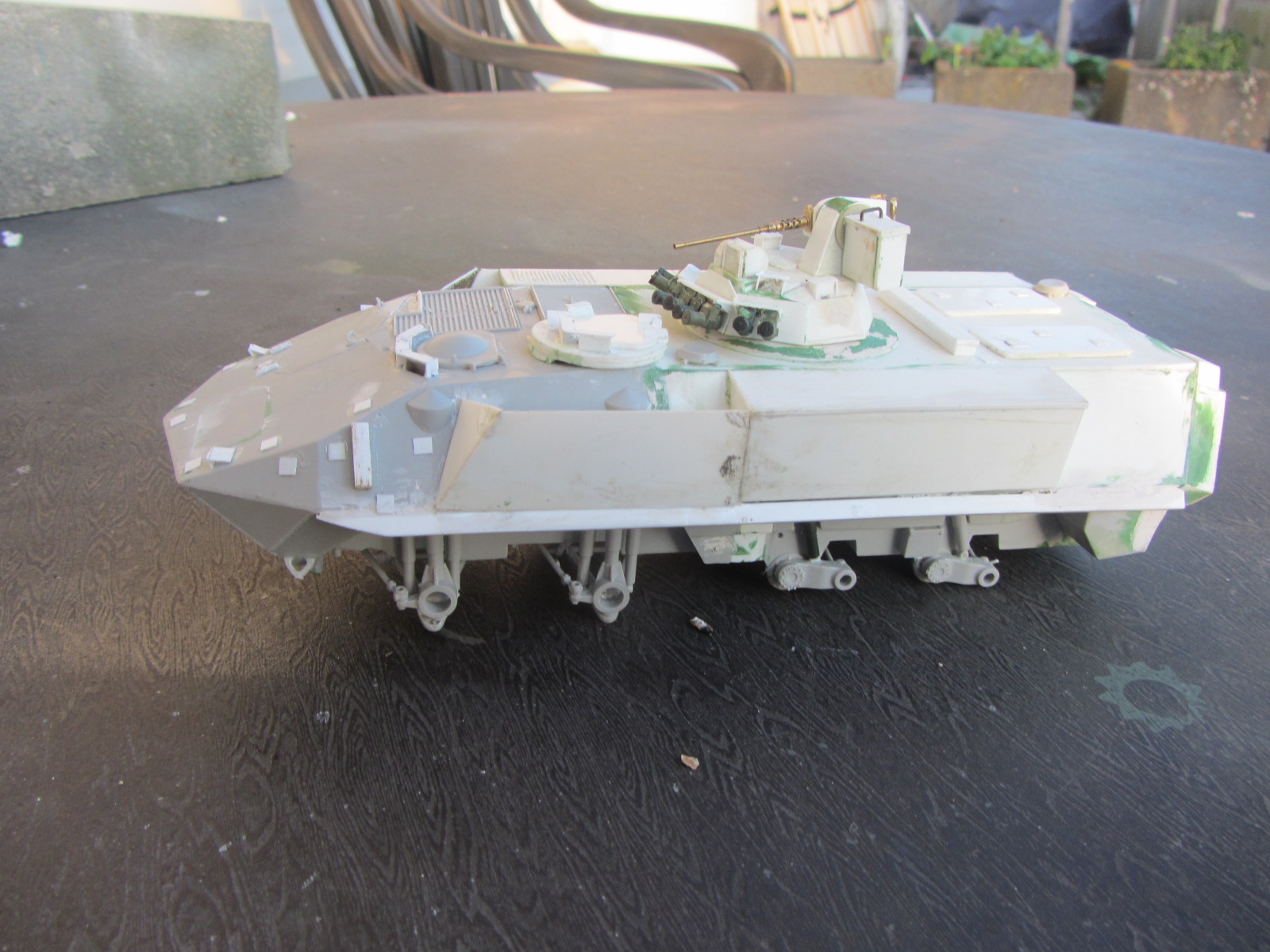

I’m not us vehicles specialist- is it possible to convert trumpeters lav 25 (00349) to swiss piranha? What chanches are needed?
It depends what you mean with Swiss Piranha? Swiss Army usage? Swiss Army had only Piranha 6x6 in the role of an ATGM carrier.
More infos here.
www.militaerfahrzeuge.ch
There is the Piranha II 8x8
But you need to build the turret.
For a 6x6 there was a Resin Conversion set, I think to build the Canadian Husky… The 6x6 was first build as a TOW vehicle, now it is rebuild to be used as Ambulance or Command Vehicle
Normally, Swiss made, means a lot of changes
Rabbits
Both vehicles, Panzerjäger 90/Kommandopanzer 6x6 Piranha and Radschützenpanzer 93 need a lot of work and the right references.

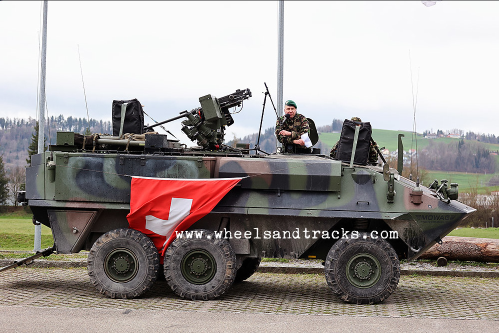

Thanks guys :slight_smile: Hermann, do You have more photos/ work relation?
Panzerjäger 90 AKA Pzj 90
From both vehicles?
San Version
And some of mine at warwheels the Command Version

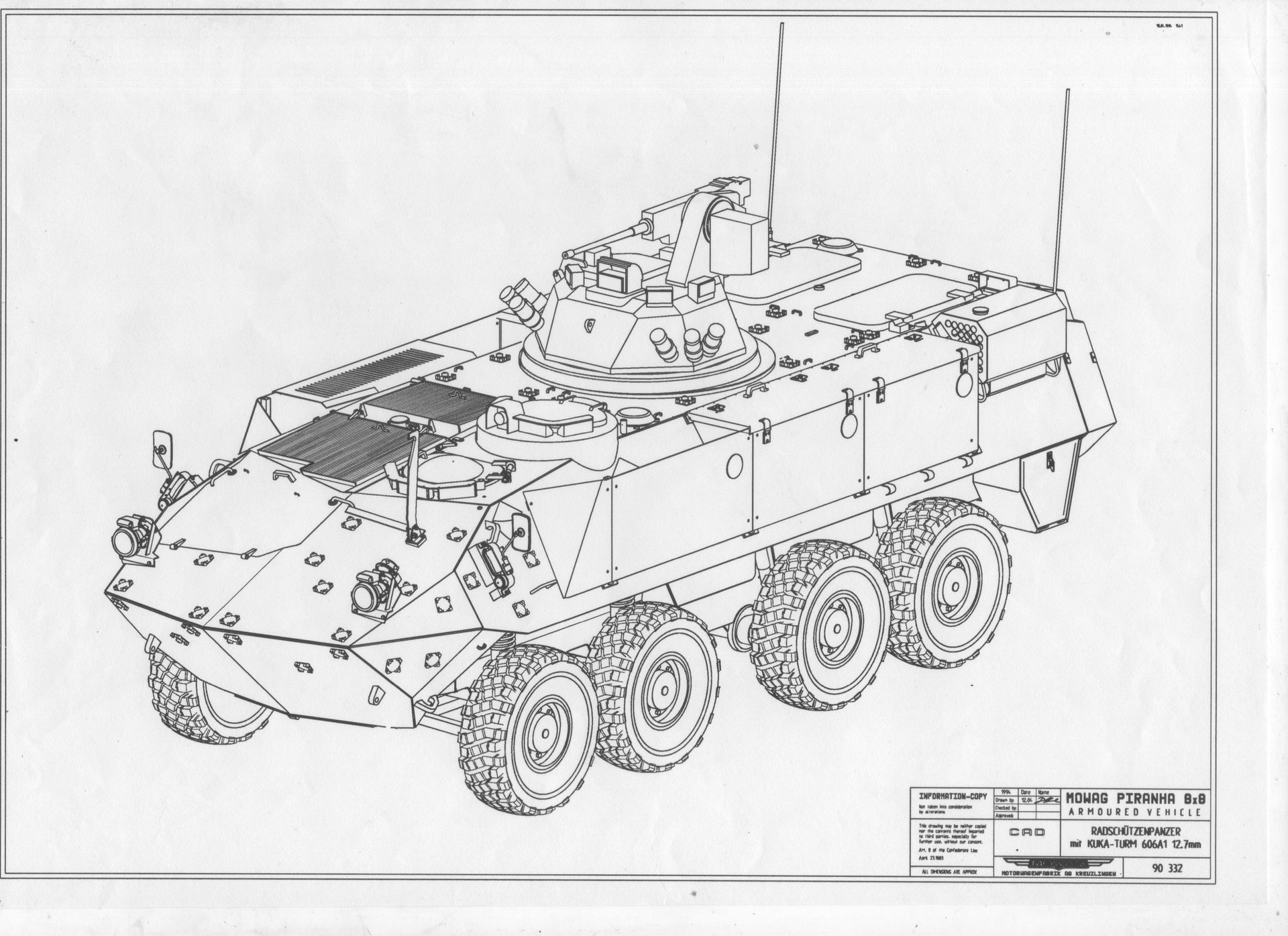

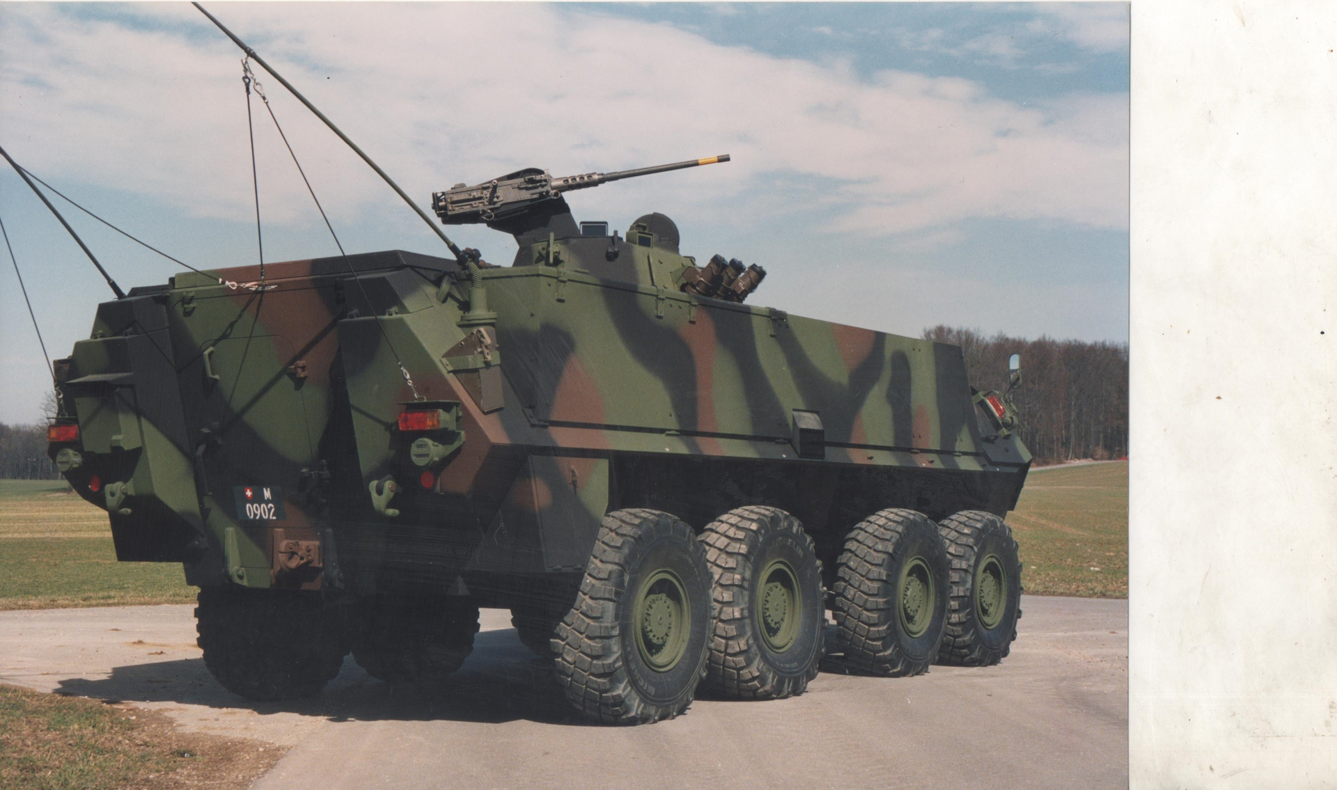

Of Radschützenpanzer 93 :slight_smile:

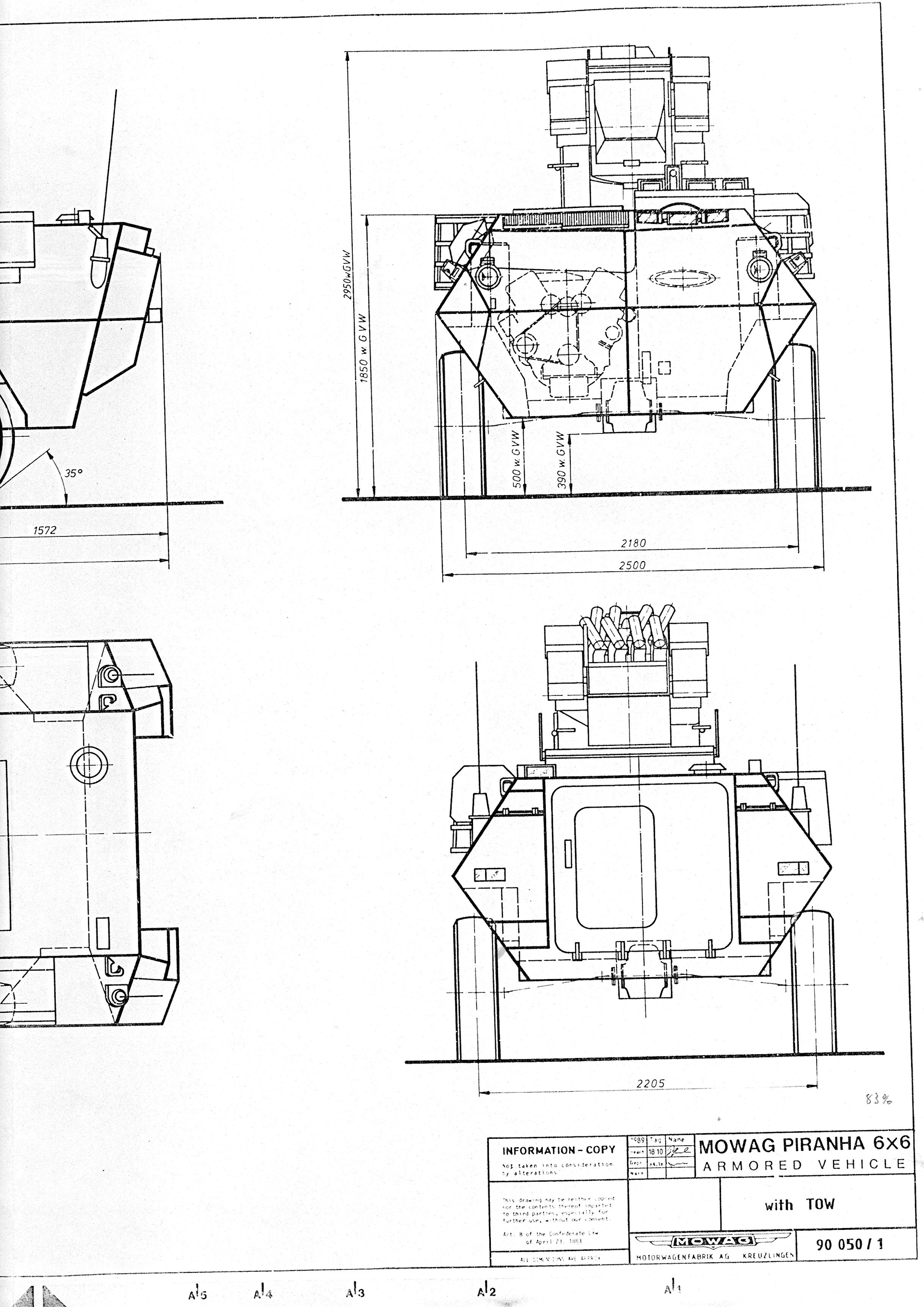

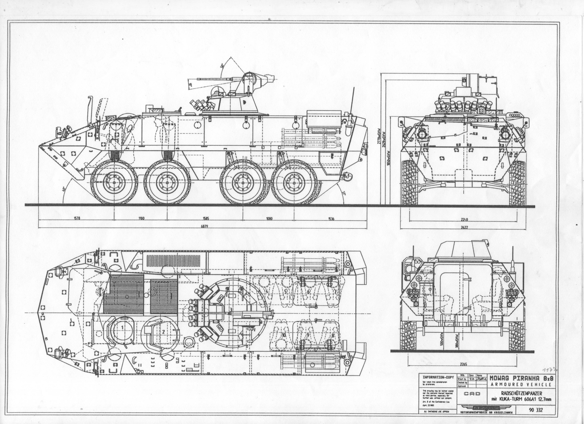

Here we go. Official MOWAG drawing of Radschützenpanzer 93

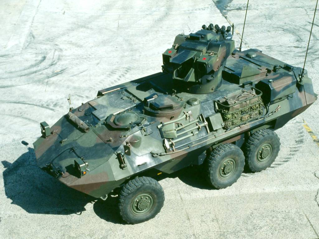

The problem is that the basic LAV-25 is 7.62mm armor protection whereas later versions of the LAV, depending on the variant, has up-armored the protection rating to 14.5mm AP and even more (the U.S. Marines’ LAV-25A2, hence “A2 variant.” That means huge changes to the suspension, body armor, bolt-on armor bolt heads, etc. Thus, it may not be as easy to make a Piranha II, III, or later.
Thank You Hermann, big help!

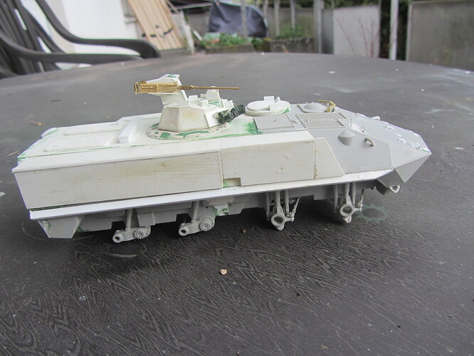

Hmm, I’ll compare what I have wit photos/ drawings of original swiss vehicles..

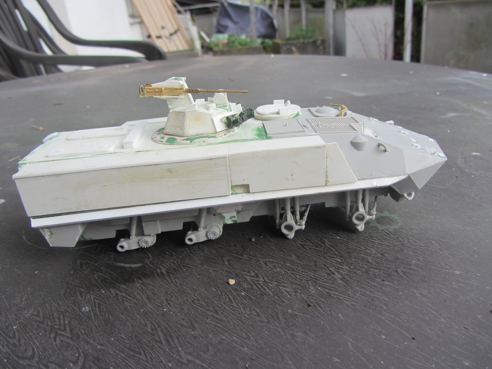

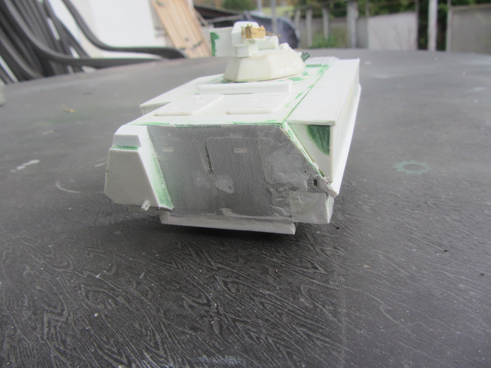

Nice scratch building.
