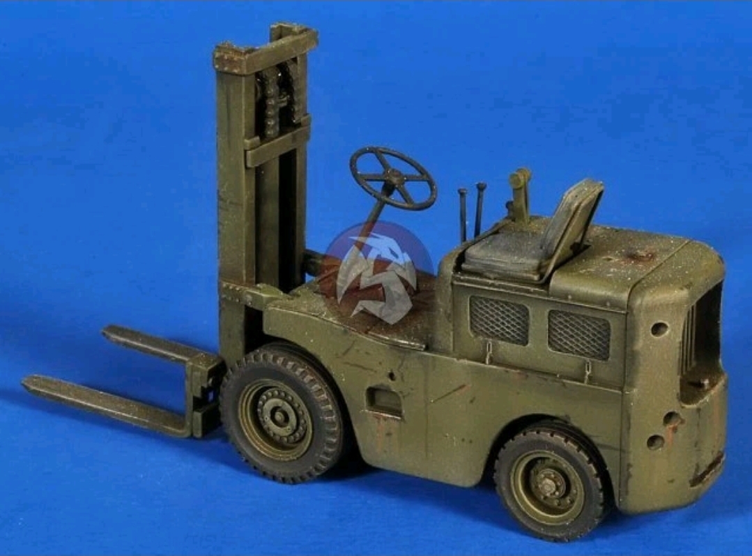

I’m starting a project titled “leftovers” inspired by this neat picture found on Reddit. It seemed a good fit for what I already had in my stash: the 1/35 Verlinden C19 Clark forklift and the 1/32 MicroAce Honda T360. I’ll also add a 3d-printed miniature raccoon looking into a trash bin, found on Etsy. Hope you’ll like it!

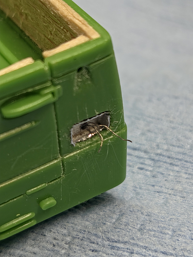

I’m finally making some progress on this project. I’ll show more shortly, but for now I wanted to share my broken back light! Folded tin foil from food packaging (thanks cats!) with some thin wire taken from the protective case of an old jack cable. 4×2 mm space is tough to work with.

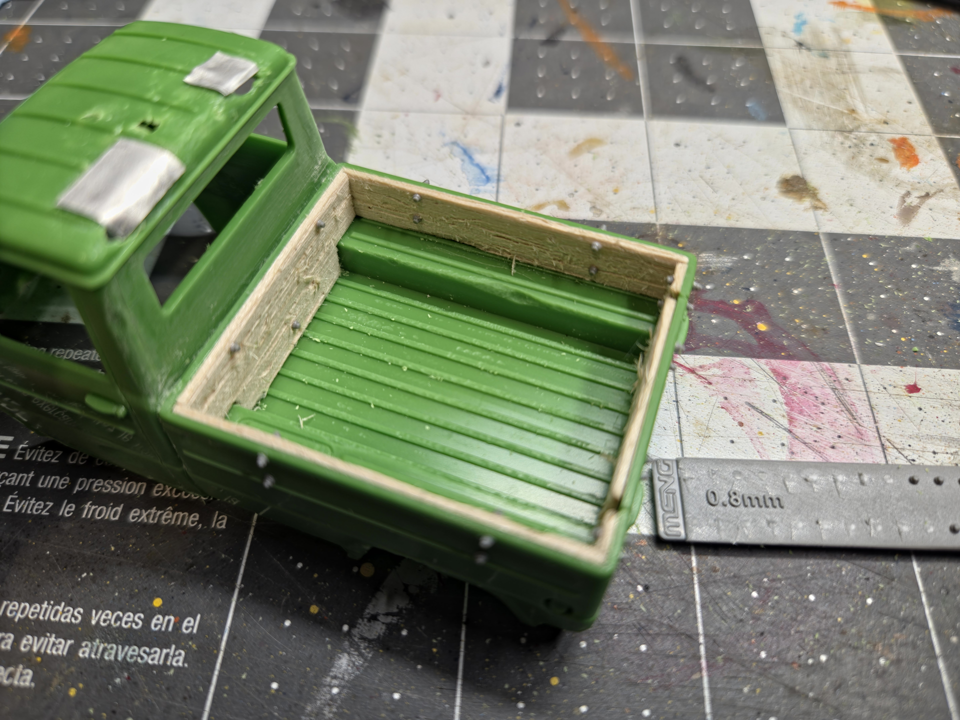

I had a vague memory (a made-up one?) of a truck whose box had been protected with planks, and decided to roll with it. I cut and glued balsa thin balsa wood, then used my X-Acto knife to add damages. I also needed nuts and bolts to hold those planks, and Meng 0.8mm ones worked just fine, although many flew into The Nothing…

I went a bit heavy on the roof, so I covered the damages with some tin foil and used stretched sprue melted with plastic cement to reproduce the weld seams.

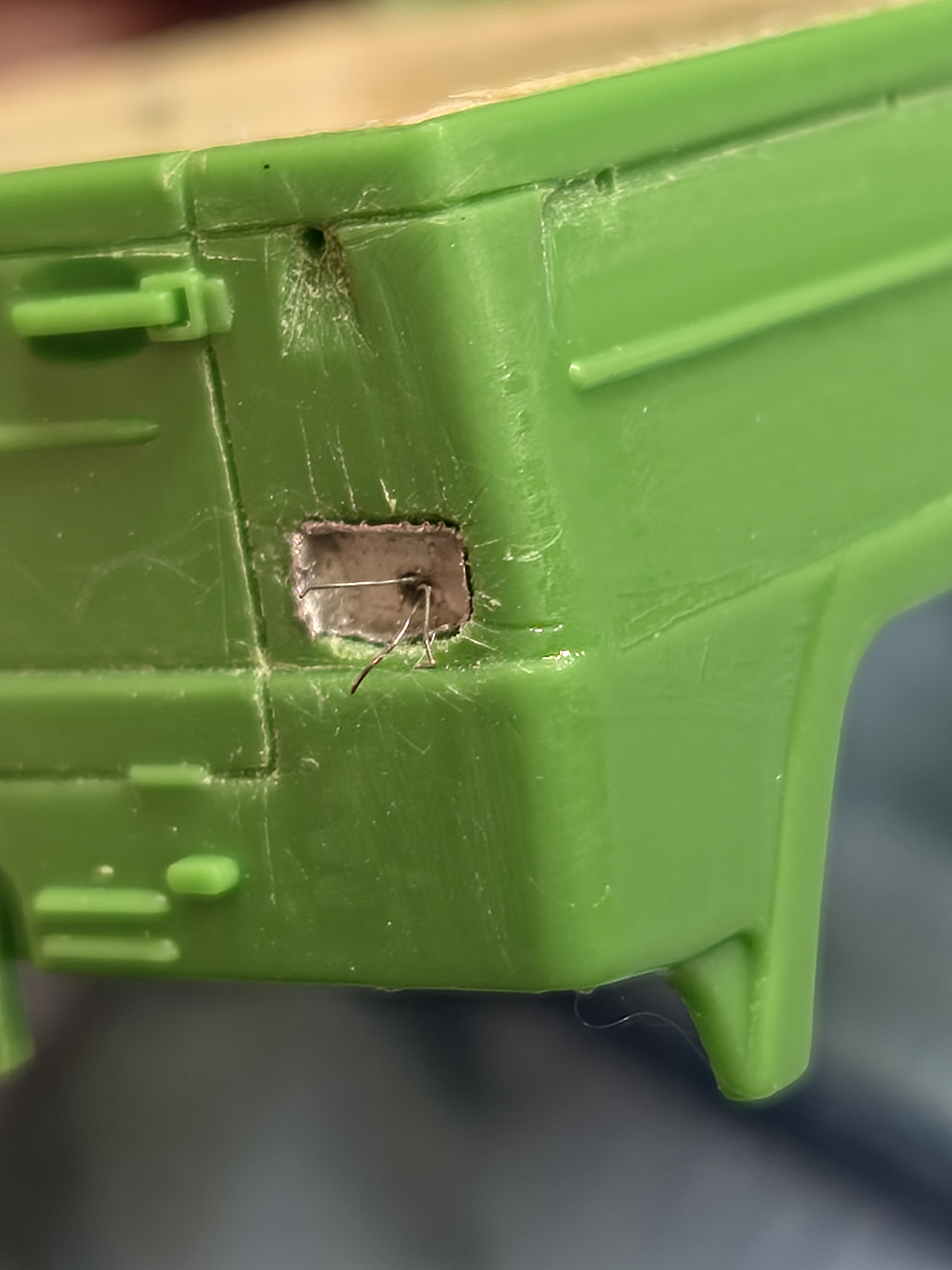

For the damaged light at the back, I drilled a hole, cleaned it up so a nice rectangle, and folded some tin foil to fit. I drilled a small hole into the foil and added three thin wires (0.25mm) that, I hope, look like the cables powering a light. A bit of a rough job, but I’m happy for first attempt at this kind of detailing.
