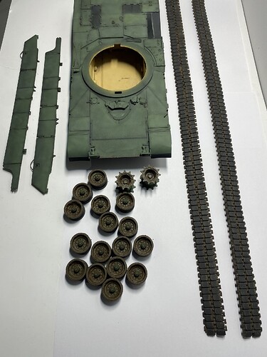

you assemble everything before painting? I prefer topaint before assembling my leopardparts (I intend to open some of my ukrainian 2a6 parts since the kit allow it).
I assemble as much as possible, usually the entire tank, before painting anything. Model kits are engineered to be assembled unpainted. Pre-painting parts can lead to fit errors and parts gaps. Then there’s putty on top of paint, a situation you never want.
I always assamble the whole model, I just leave parts like side skirts, wheels, tracks unglued and before painting I take them off. This is an example
@sgeorges4
As Mateusz & Matt mentioned, in my experience it works best to assemble as much as possible before painting for all the same reasons.
I’ll brush paint or airbrush areas that are difficult to reach and paint after assemble if there’s a risk of exposed unpainted plastic being visible. For example where the screens go on the engine deck or a Panther or Tiger etc. I like to spray those areas black or red oxide from the under side and above before the PE screens are attached.
Otherwise, painting is done with the whole model build for the various subassemblies.
HTH
I prefer to paint some because my airbrush can’t access everythign and I’ve already made the msitake of assembling parts to the point I can’t access them wit a brush
I also assemble as much as possible and usually only leave off roadwheels and tracks when painting. I find if the airbrush can’t get into an area, and you can’t brush paint it, it won’t be seen anyways, so don’t worry about it.
