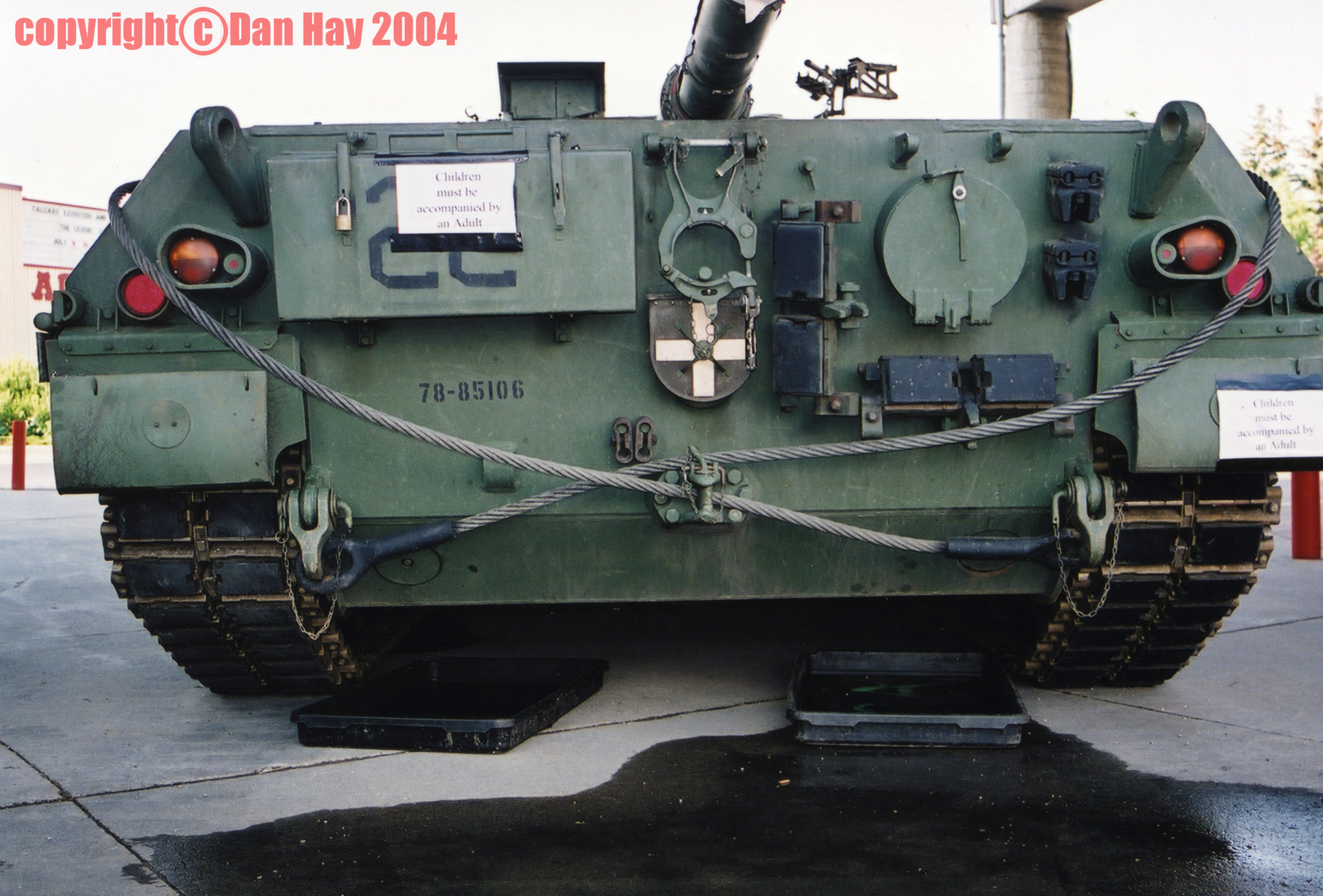

I’m not sure but I think the CFR number might be off. I thought the C2’s CFR’s started with 8 and 9? @AD_Sewards would have better knowledge than me.
Then again, they sometimes blocked out some of the numbers in Afghanistan with squares?

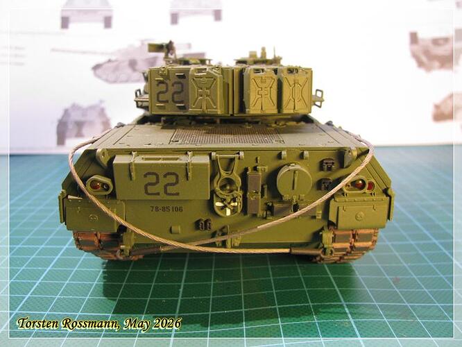

I went for this photo, which shows exactly the tank I’m building. Decals are all from the box.

The Leopard C1 hulls…converted to Leopard C2 hulls…were all had 78 as a precursor for the CFR.
The Canadian Leopard 2s…2A4 CAN, 2A4M CAN, and 2A6M CAN…all have 85 as a precursor for the CFR.

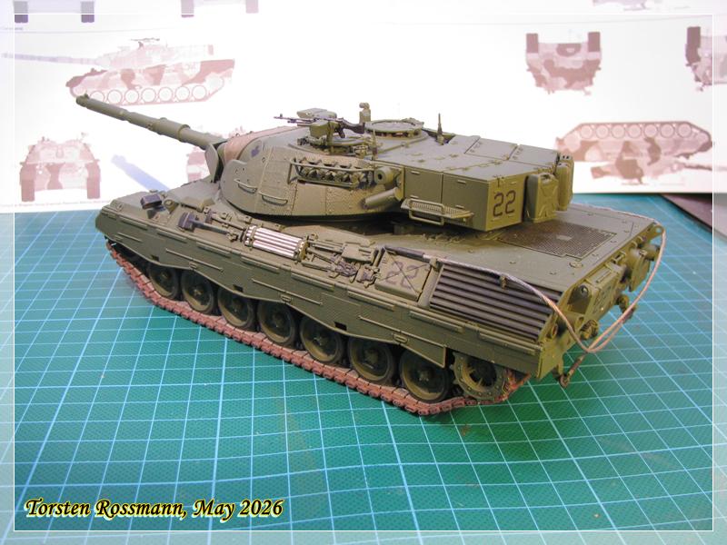

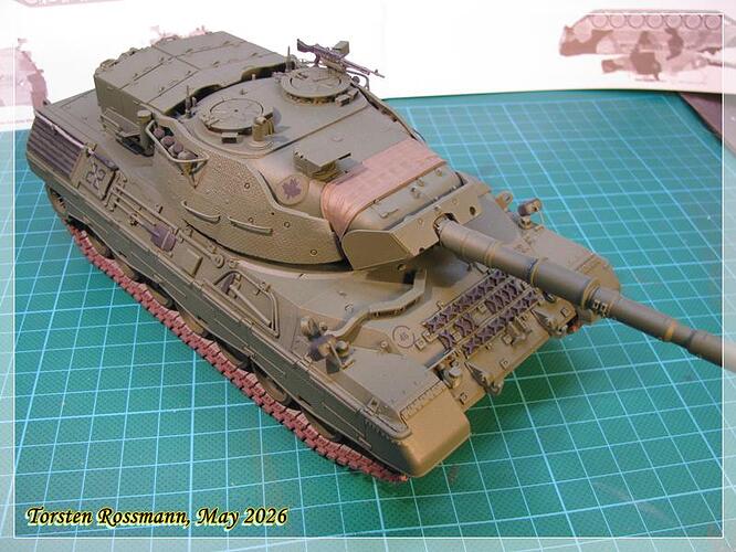

By now I call this build finally finished. Took me longer than I thought and had planned. Later I will add some dust from with pastel chalk and the antennas. Final parts to add were the towing cables and the clear parts for the head lights. Mainly I used Vallejo 71250 Bronze Green for the camo, all other paints come from Revell Aqua. This is my fourth Leopard 1 and the seventh Leo in total. First show for this Leo will be in August in Andelfingen/Switzerland.
I want to thank everone here who has followed the build and supported me with comments and/or likes and I hope you enjoyed this build blog. It was much appreciated! A special thanks goes to Anthony and Jason for their invaluable help. Thanky you guys! ![]()
Happy modelling!
Torsten

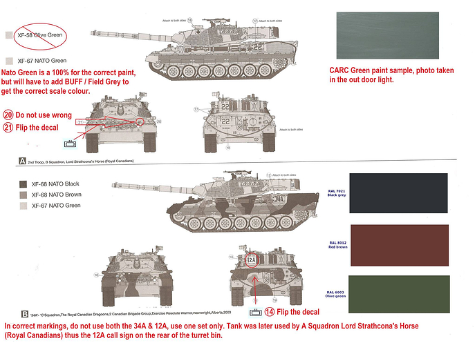

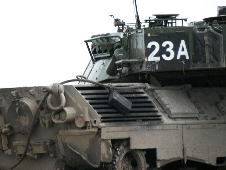

Sorry, I don’t check this site that often, busy doing a few projects for Model Companies to bring out detailed kits, Modern Canadian AFV reference sets, and a few books in the works……. The kit decals have some issues, this one should not be used as it actually shows Mechanized Infantry , TAKOM was sent corrections for the C2 kits decals, but they have not done the corrections, and has caused quite a few modellers to be quite pissed for the incorrect information. Plus we stopped paining call signs onto the tanks in the early 2000’s, we used sign boards as the main reason was the tanks often changed troops or were swapped out due to breakdowns . If anyone is looking to track me down for questions, and if you are on Facebook, reach out 100% and I will help you out with your builds. Also, if you are on Facebook and are looking for the best collection of info on our Leopard 1 & 2 fleet, check out the Canadian Military Modellers Association page, there you will find everything that you will need in regards to Canadian armour reference and massive photo albums.
Cheers Anthony Sewards
This should actually read LdSH not LJSH, and the XI is in the wrong position, here is an actual vehicle stencil showing the correct Armoured tactical sign
Example of actual sign boards that we used , mainly black with white lettering, but we used Green coloured metal boards with yellow lettering . You can see no extra markings were added to the hull sides/rear.

Before I added the decals I had a look again at the remarks you made already in post 14 in this thread. Jason came up with some photos I had questions about in post 86. The tank on these photos is exactly the one I built (call sign 22). And the unit sign (see yellow arrow) looks very much like the one on the Takom decal sheet. I guess they had the same photos …
But you’re right, it should read LdSH and not LJSH. On the other side, it’s just a tiny decal and I believe we have not many experts of canadian armor here in Germany. Most people won’t even notice it when they look at the model … ![]()

Here is a close up pic of the tactical marking on the Leopard C2, callsign ‘22’ that Takom based some of their decals on.
As you can see, the decals in the kit are actually correctly depicted. It was the tank crew that applied the incorrect tactical marking on the real Leopard C2.
Also, if you look at the LdSH lettering in the image below, the ‘d’ is very weak and could easily be mistaken for a ‘j’ by Takom.
You are correct Torsten, that these are very minor details and hardly anyone will notice.
Thanks for the clarification and the photo, Jason! Much appreciated! So Takom didn’t do wrong here. That’s good to know.
