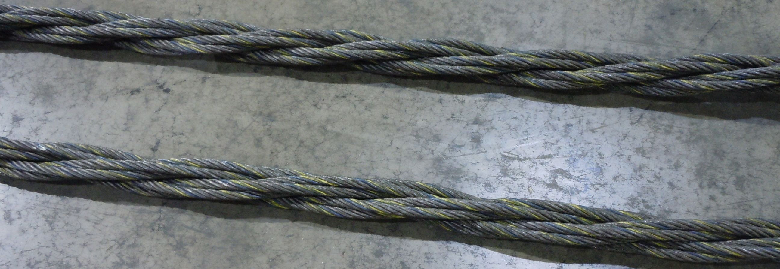

You don’t want “braided” wire, you want “wire rope”. If you look online you will get better results with the correct term.
This is braided: https://www.johnsakash.com/sites/default/files/product-images/braided%20rope%20pic%201.jpg
This is wire rope:
