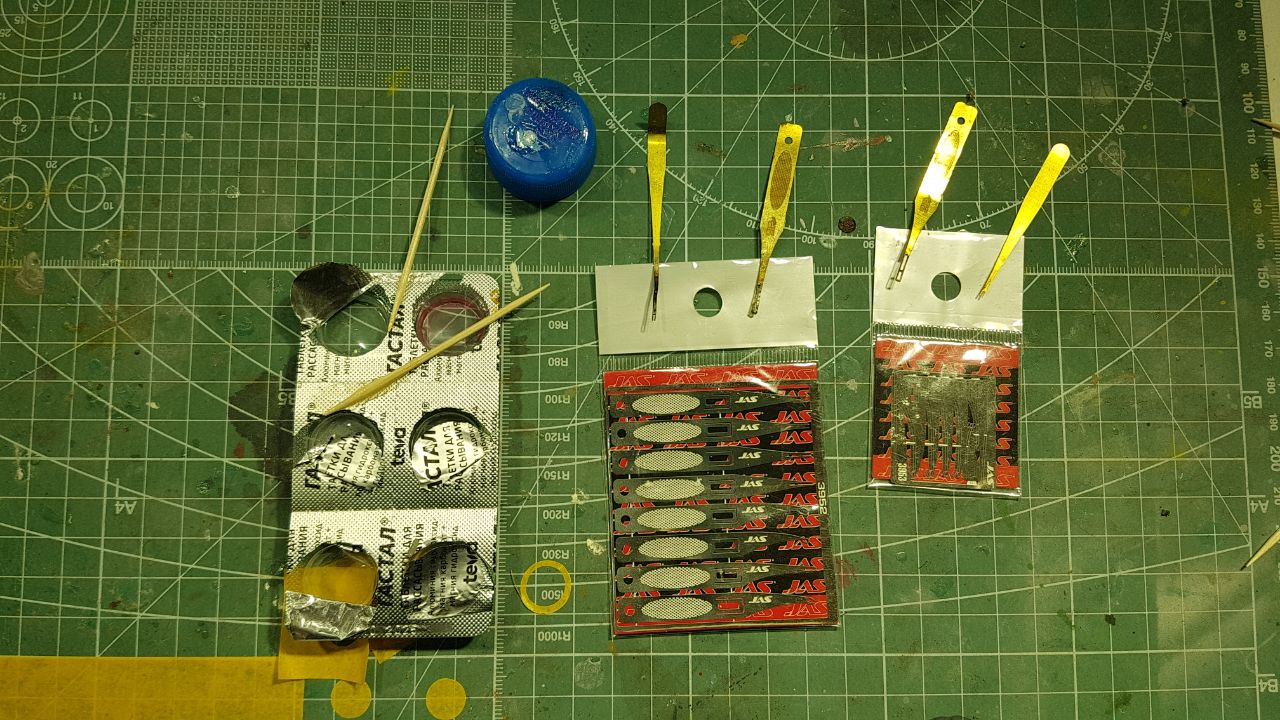

I use photo-etched applicators. And I also bought a bunch of different ones. After use, I anneal it with a lighter. I apply a drop of glue to plastic bottle caps (if you need a little) or to medicine blisters, of which I have a lot.
