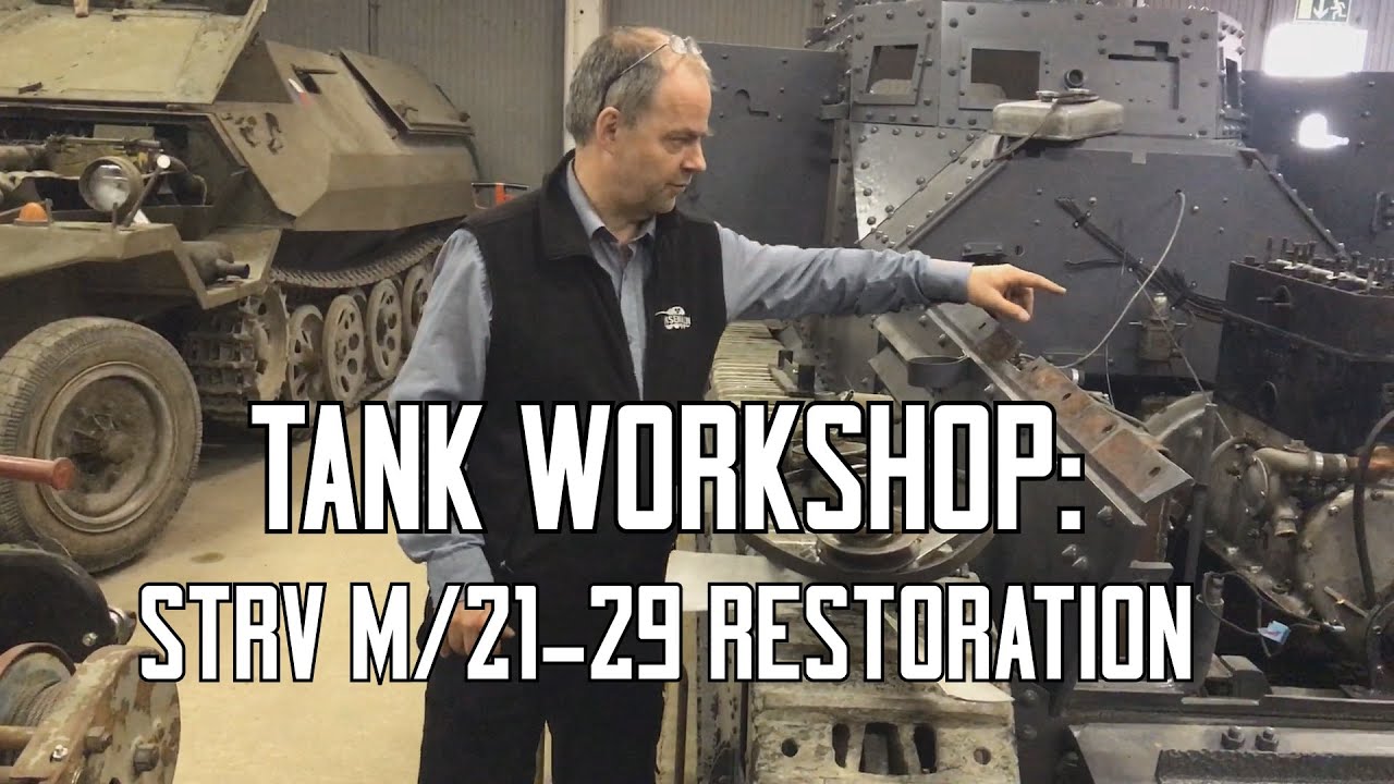

Could there be something useful in this video?

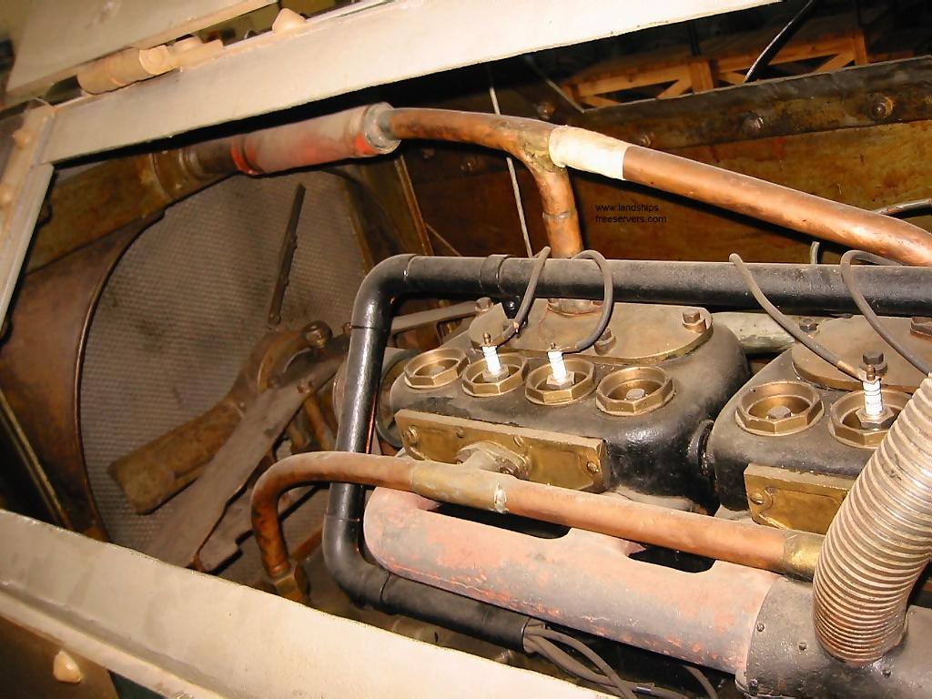

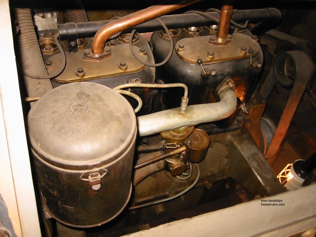

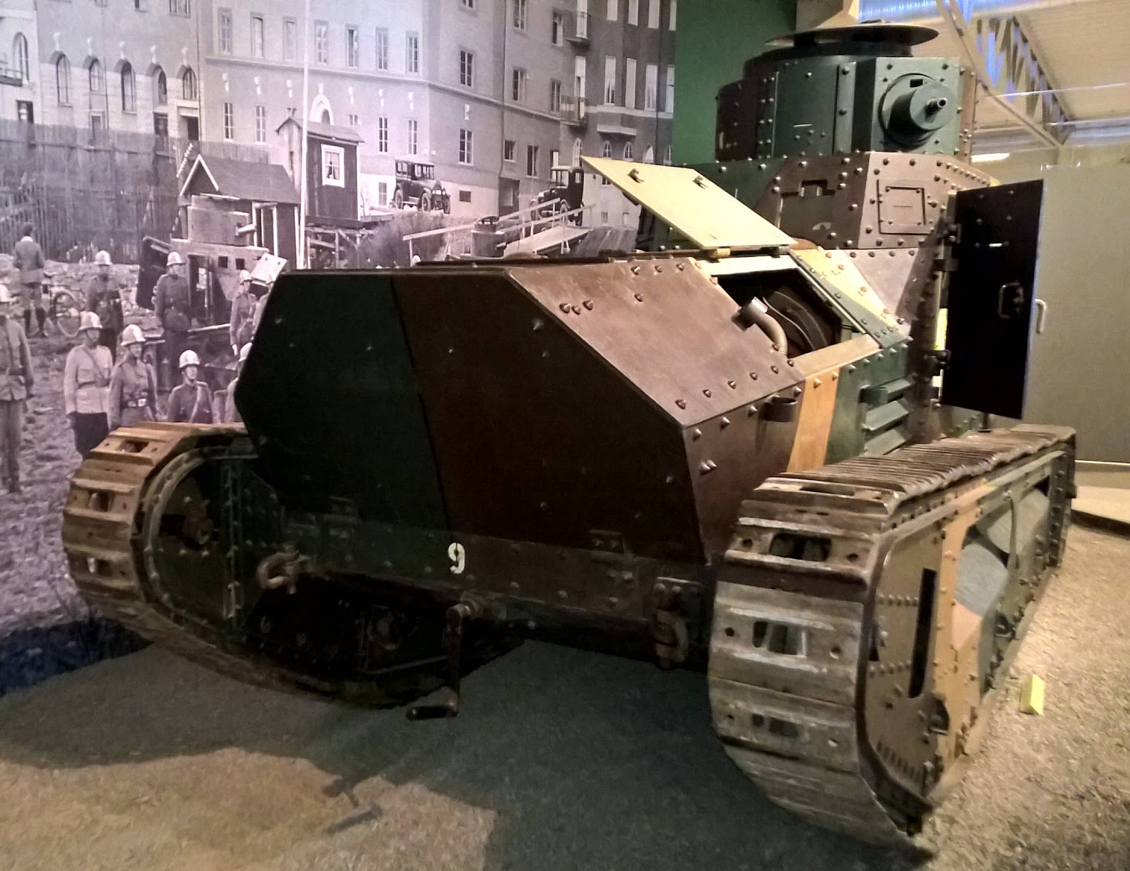

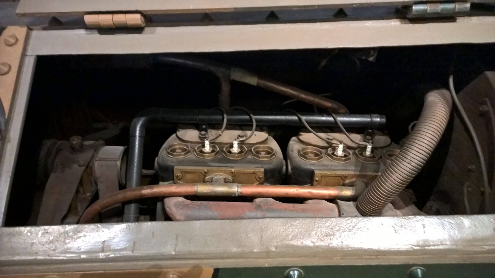

Thanks. I know this video, I have made several screenshots. But it’s good only for structural elements. Unfortunately the m/21-29 had Scania engine and it was rebuilt making even most of the structural parts different from the LK-II. Luckily I have tons of photos where I can see the parts and sections needed. What I have basicly no good photo is the engine and the engine bay. I attach the ones I have. These are taken on the m/21 in the Arsenal that still has the original Daimler 1910M engine.
There are some other parts I need some photos as well, like behind the plates at the tracks.
