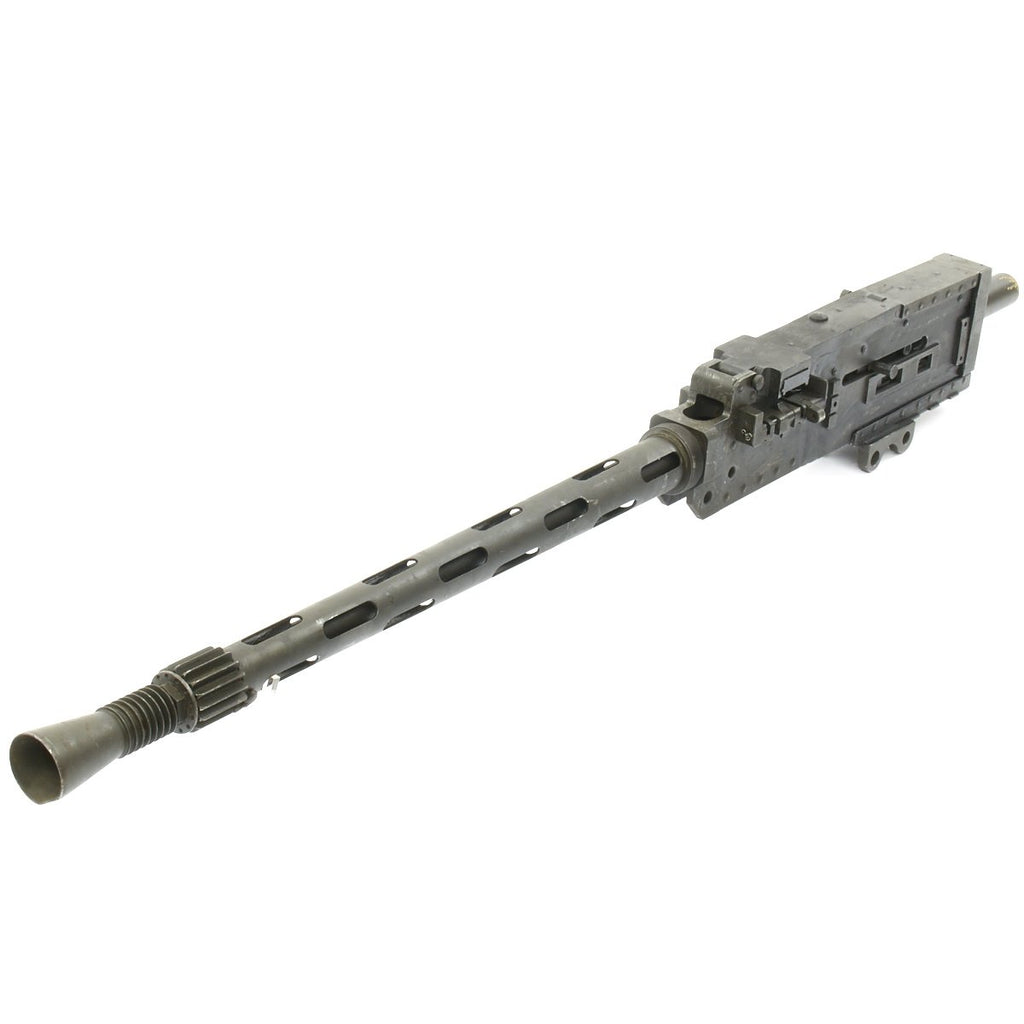

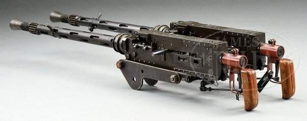

Do you have a barrel for the Browning? The British 303 Browning had a different jacket with rectangular cooling holes instead of the circular on the US built guns. Usually conical flash suppressors too.
Not sure how noticeable this will be in 1/35 though.
I know all this. I have searched for for a British Browning in.303 British, but it seems like no company makes one in 1/35 scale. I will make do with the one I have. I think it will look «good enough» with a spade grip. Not many people will notice the difference in the barrel jacket.

I have the correct .50 cal from the Dragon SAS desert raider kit. It is the barrel jacket on the .30 that is in question. The barrel jacket looks lik this.

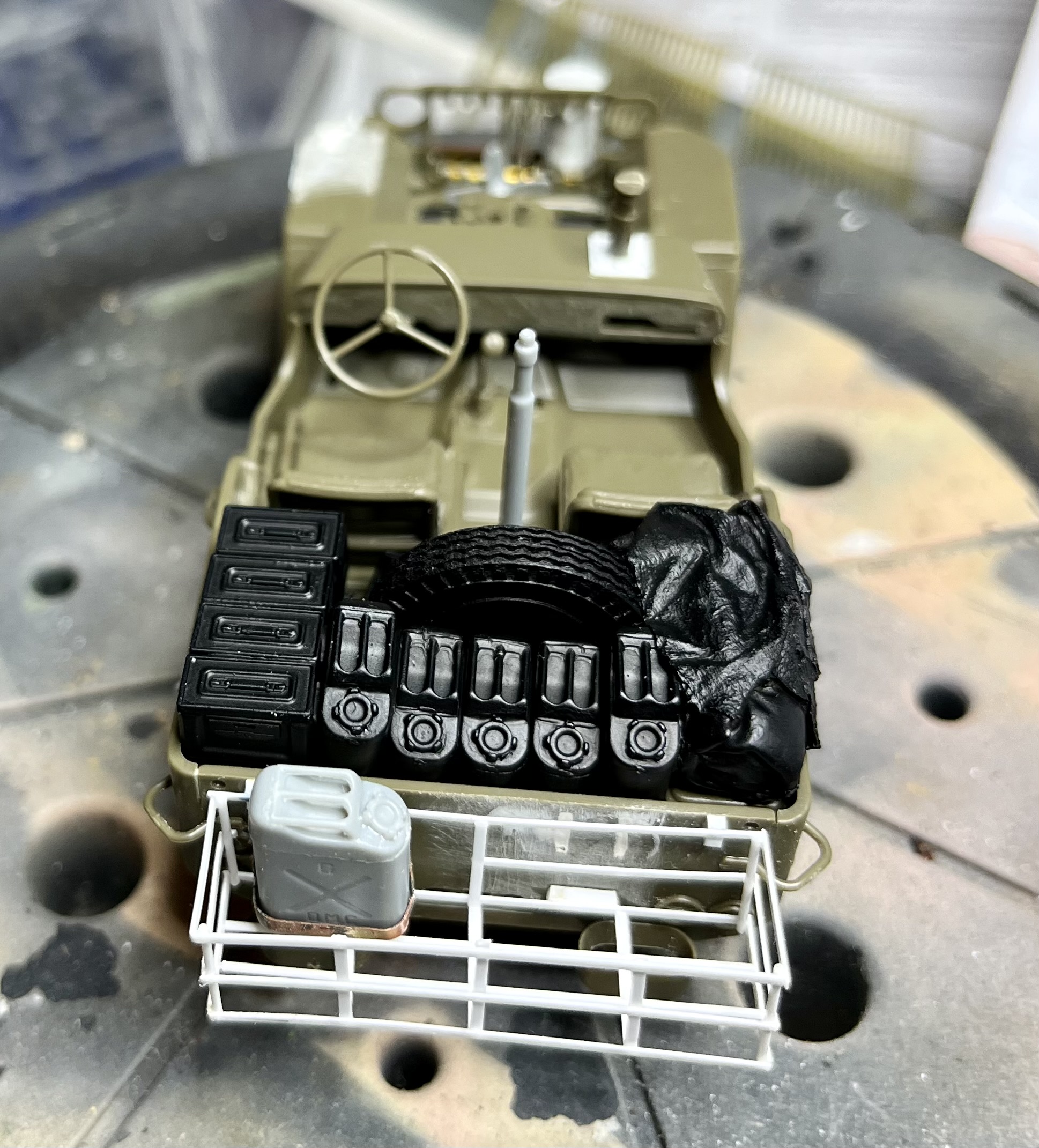

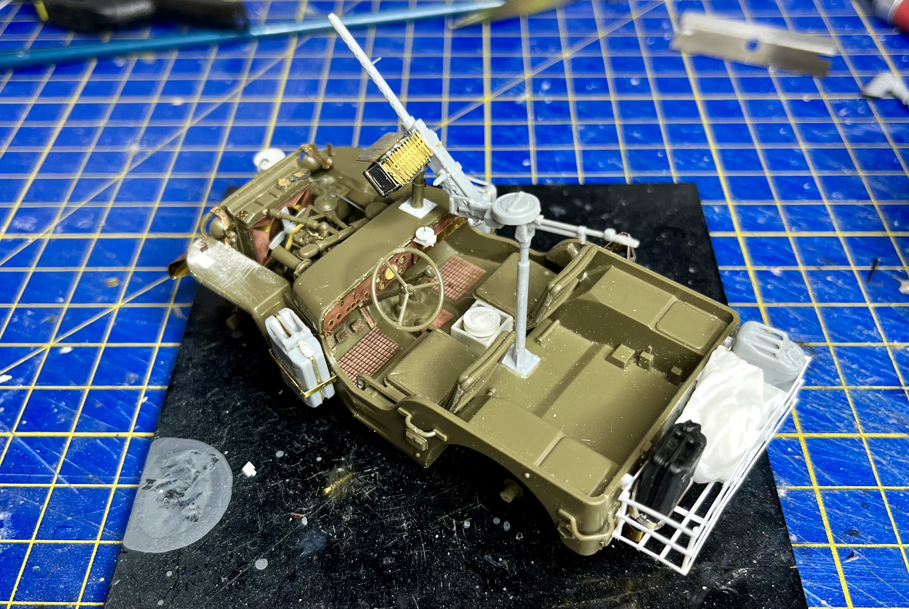

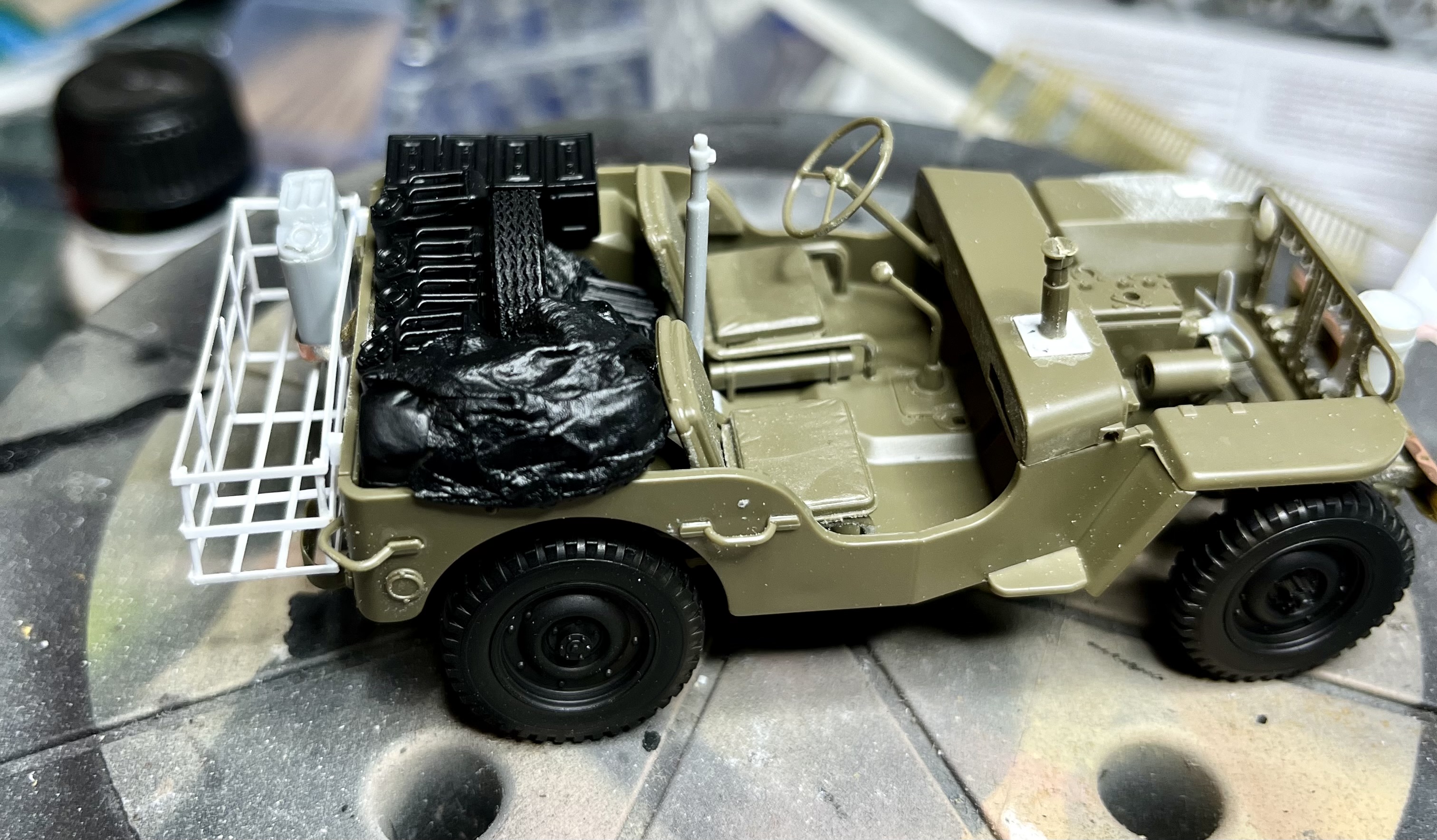

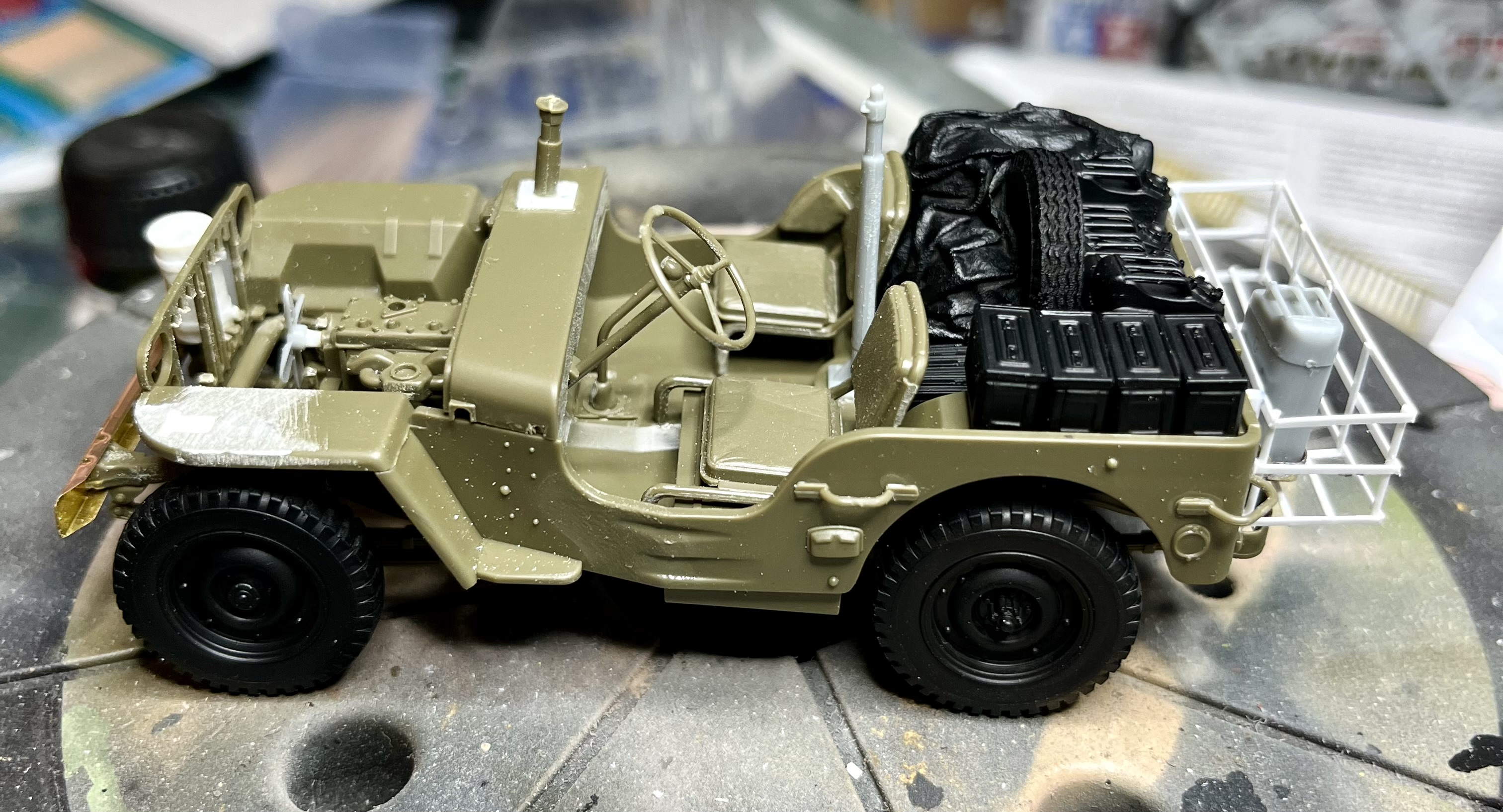

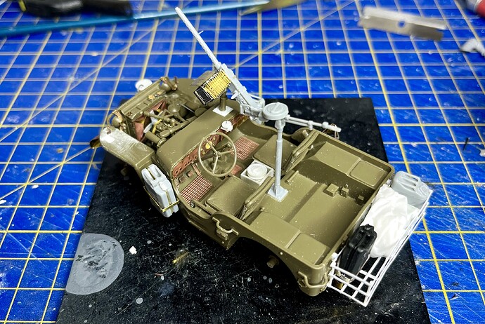

No matter how interesting it is to discuss machine guns (I actually ordered a couple at work today, true story) the build must go on. I glued on the rear stowage rack, and I´m pretty happy how it turned out. As earlier mentioned this is an assumption on my part. The rear stowage rack is mentioned both online and in books, but finding a proper picture has been difficult, hence my assumption.

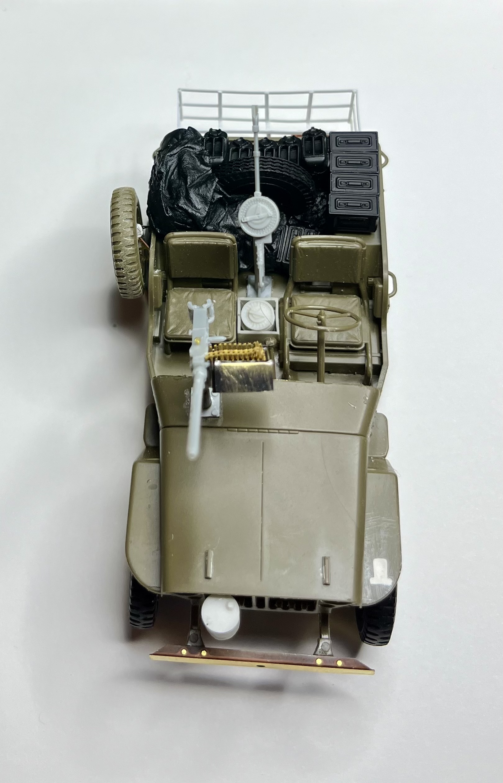

It starts to look like a proper jeep now, but everything is just tacked together. Never mind the wheels, I know what goes on the front- and rear axel. :wink:
Your Jeep is shaping up nicely Erik. Nice job on the rear rack and the addition of the extra gear.

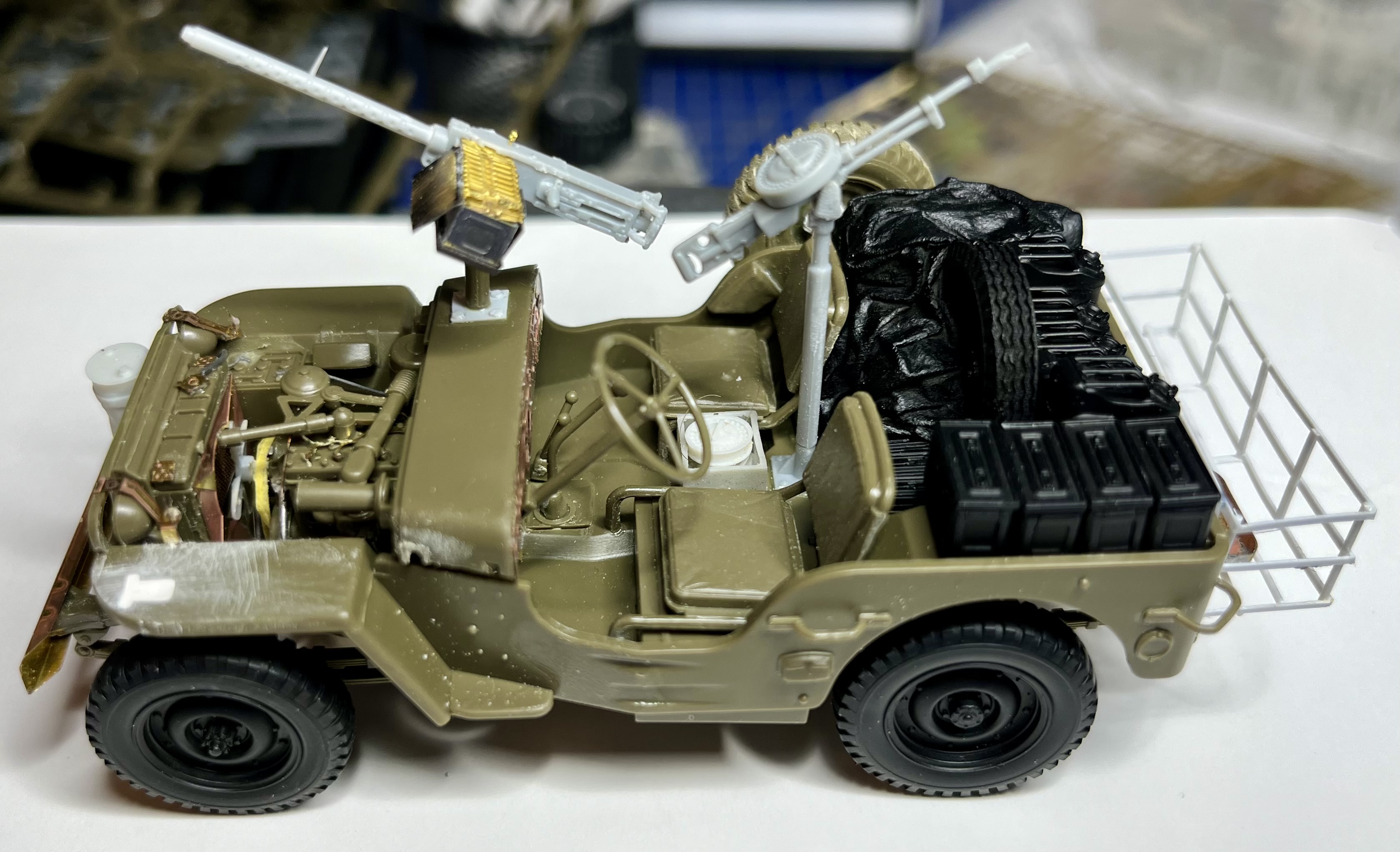

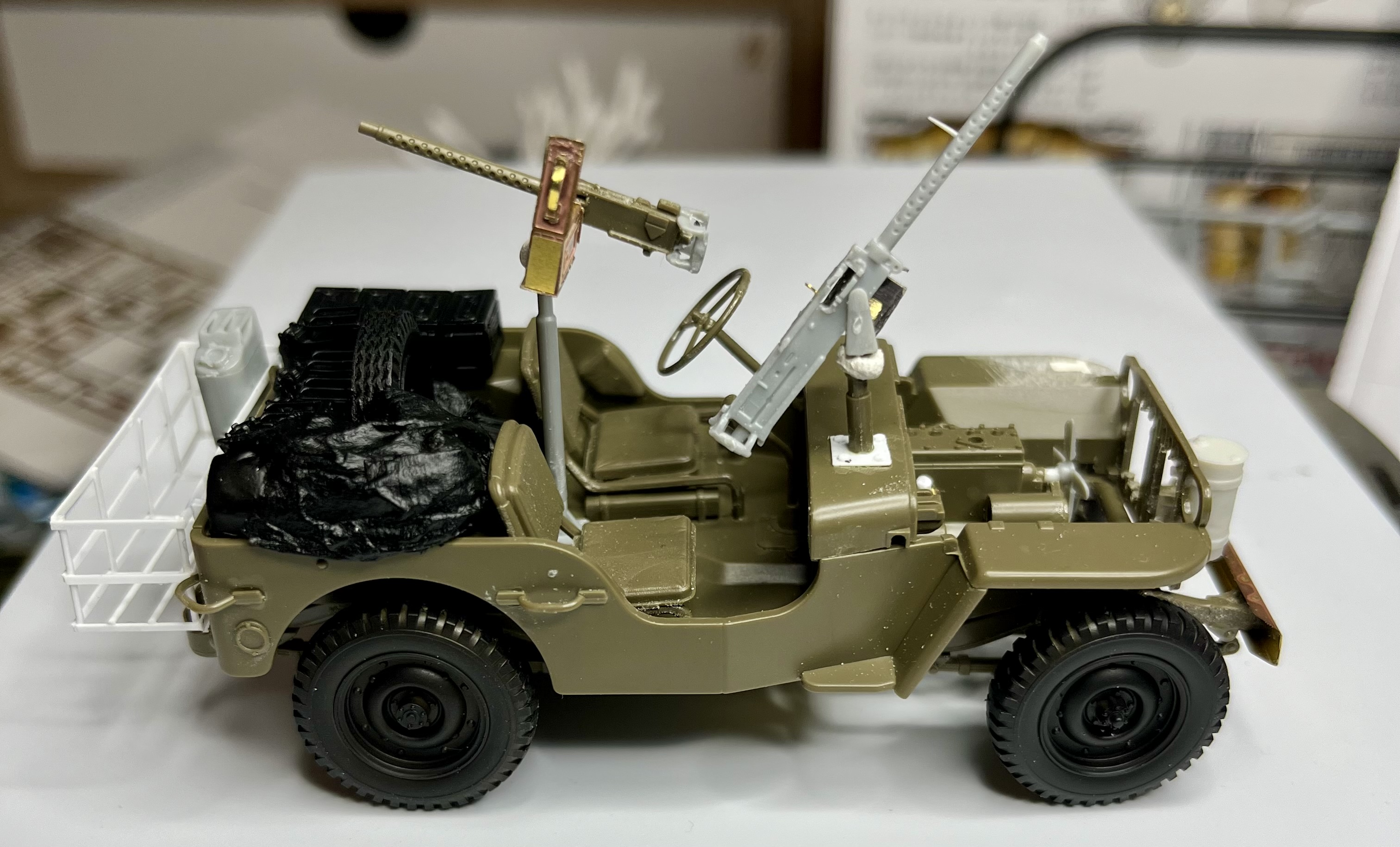

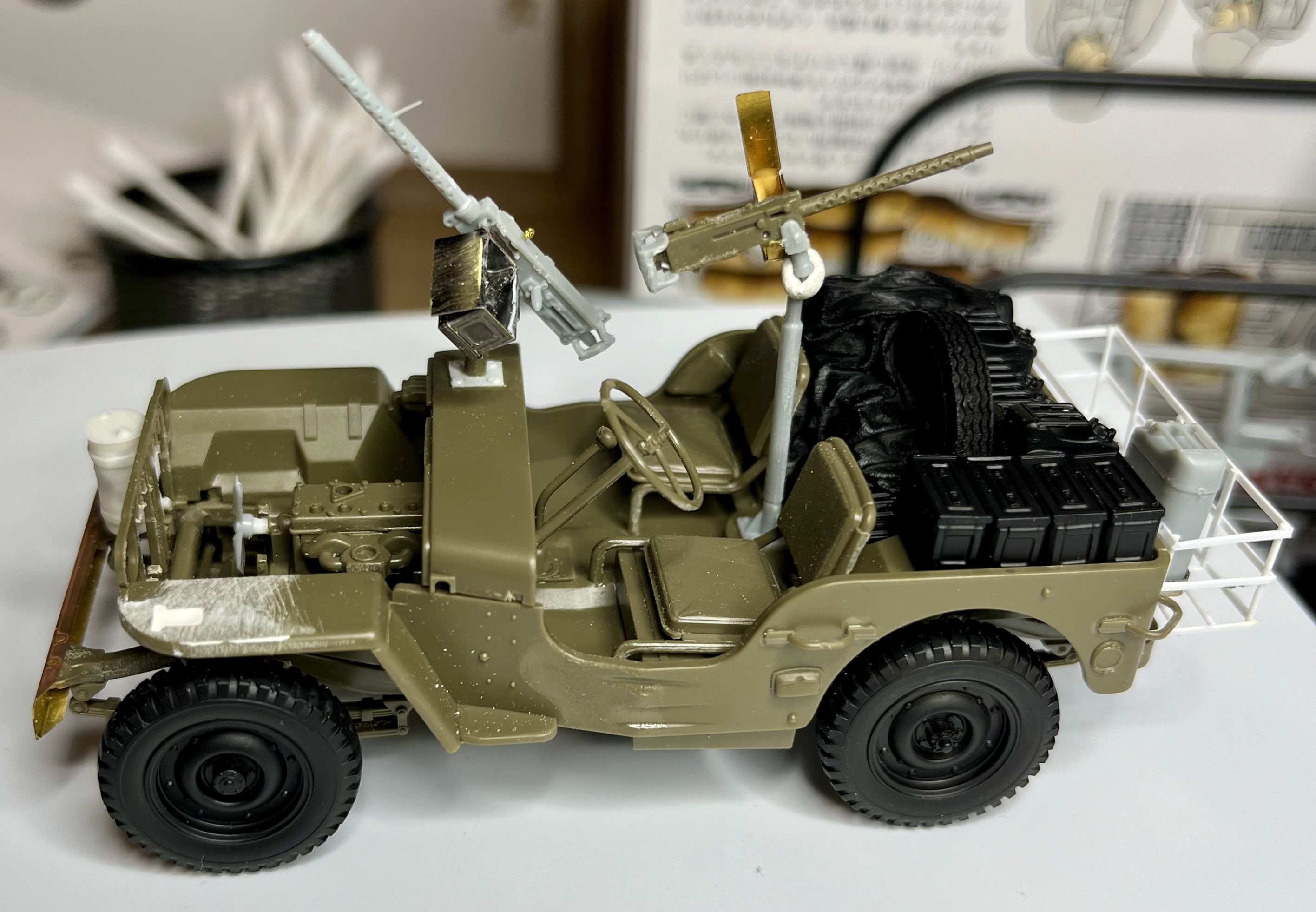

This is the current state of the armament. Some adjustments will be needed, but overall I´m happy.
And before anyone starts a discussion about the slide handle being on the wrong side of the .50…
These are aircraft mount guns, the location of the charging handle varied depending on where they were mounted in the plane. Same with the ammo feed belt.
Ken

It has two sprues of machine guns, giving you three spare Vickers-K. So the Browning m1919 has been swapped out with a proper Vickers :hugs:

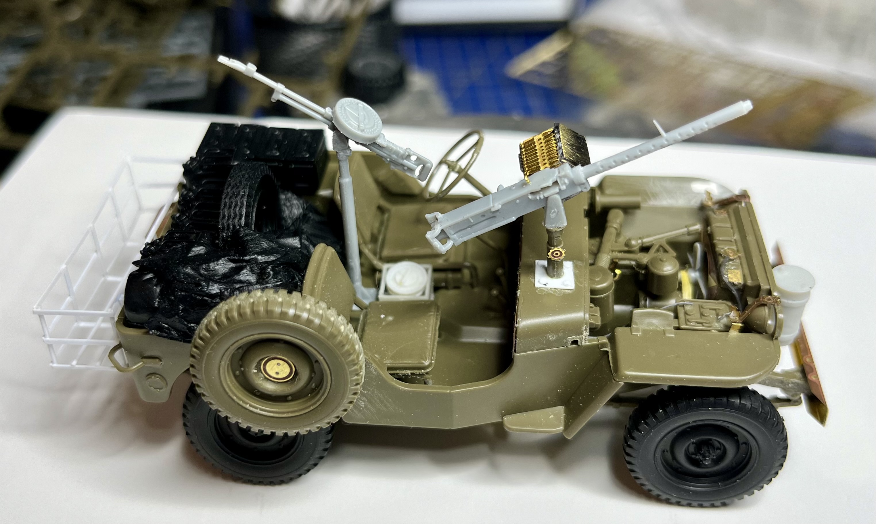

As mentioned I swapped the M1919 with a Vickers K. The jeep is allmost ready for some paint. There are some PE missing and some Jerry cans which will be painted off the vehicle. A little stowage in the bumper rack and we are there. The jeep is just tacked together since I will paint it in parts (frame, engine, body, etc.)
