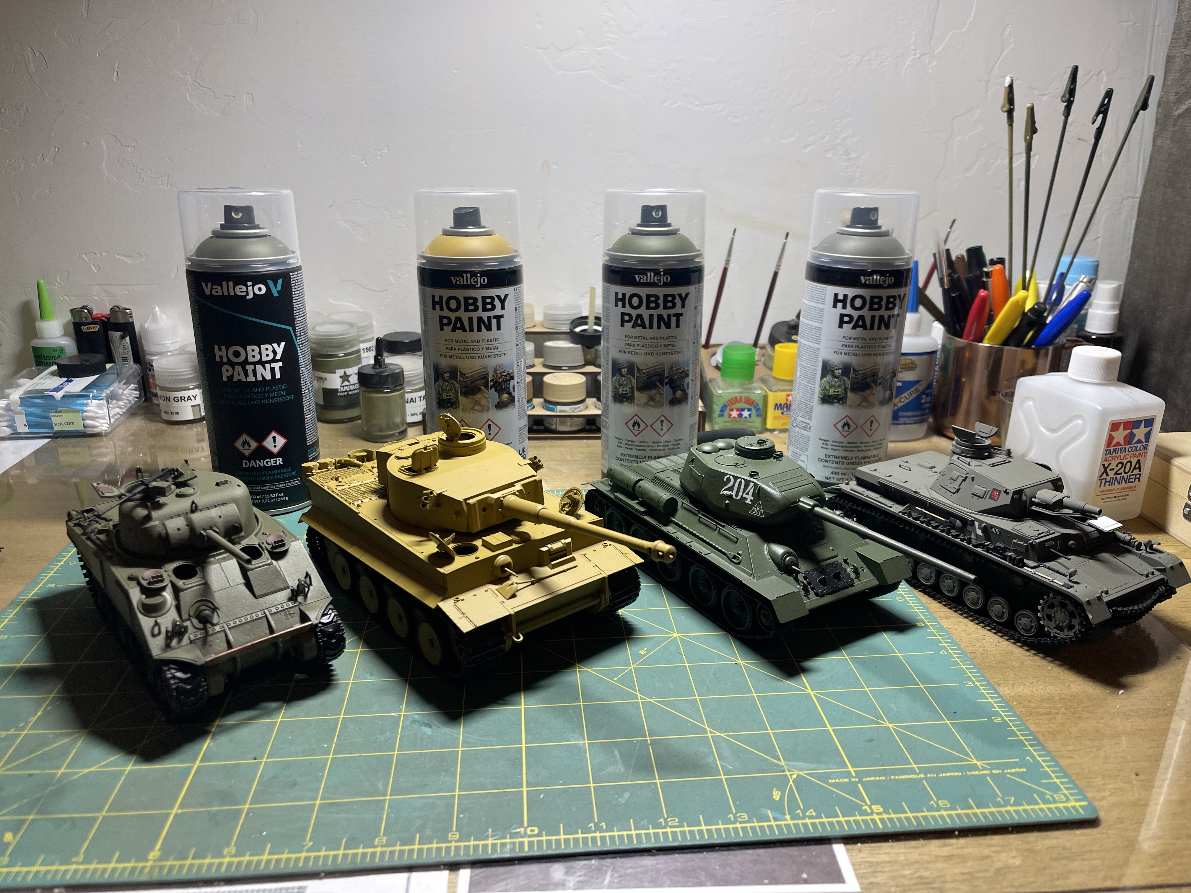

I discovered that the Olive Drab is a beautiful shade that works perfectly with WW2 armor, better than TS-5; The Desert Yellow is a real deep shade of yellowish that would be better suited for terrain, rather than armor, but it’s still a very nice shade, the Dunkelgelb they offer is too greenish IMO. I still think that Tamiya TS-3 is slightly better. The Russian Green 4BO is great for WW2 Soviet Armor; I liked it the most out of all the paints offered in spray can form. Last, but not least, the Feldgrau paint is a good overall paint, but it lacks the slight olive tinge that Tamiya TS-78 offers.
Still, the Vallejo offering provide a real good option for painting vehicles. YMMV.
I received my order of spray cans. I will try them out later this week and see how they compare to the Tamiya spray cans. The desert sand looks like a good match. The dark green maybe a little too dark but the vechicles will still look good on my O-Gauge military flat cars. I also bought the German gray for when I start working on my 1/35 scale German early war armor. VBG.
