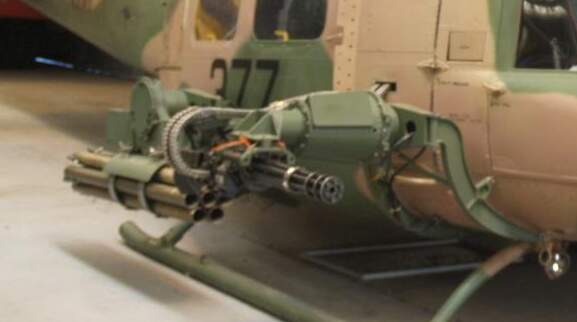

I am trying to Build an Aussie 1/48 UH-1D with rocket pods and minigun fitout as per these images:
I have located suitable rocket pods and miniguns in the correct scale, but I have not had any luck finding the mounts to attach them to the aircraft.

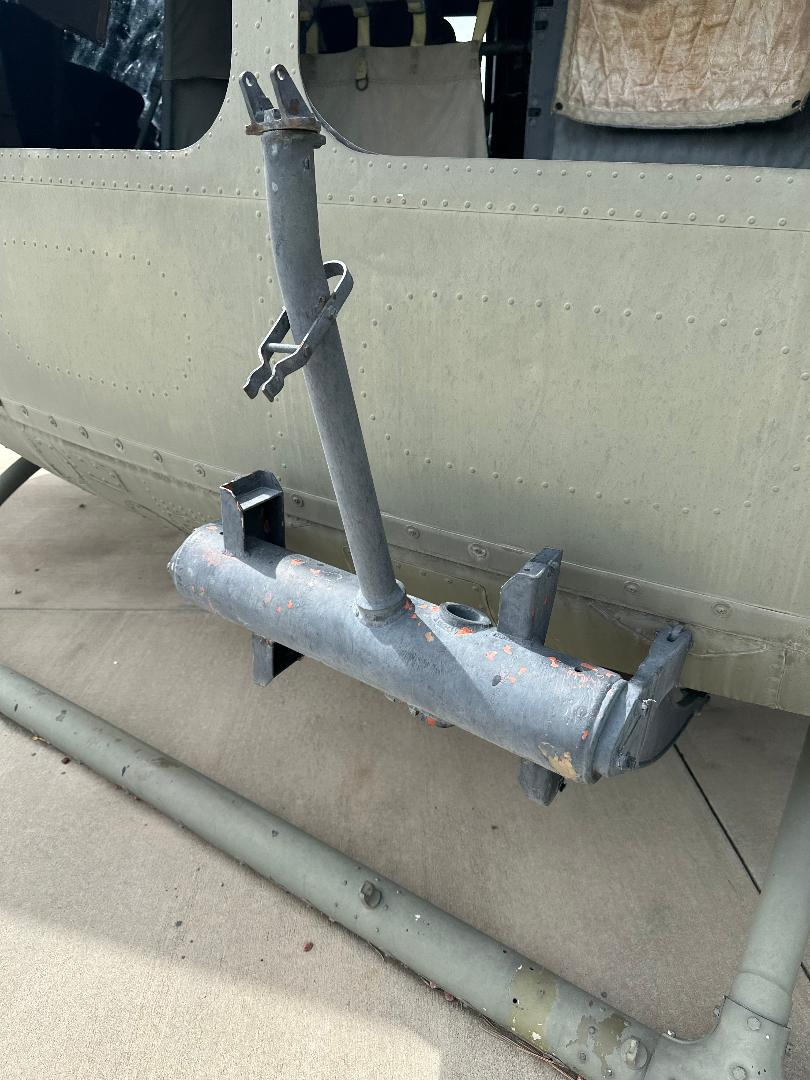

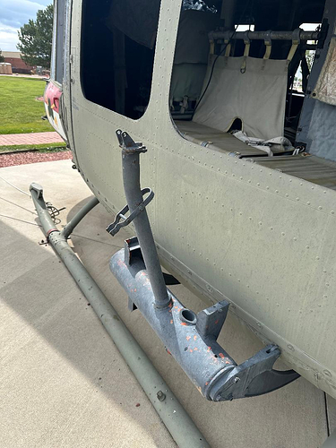

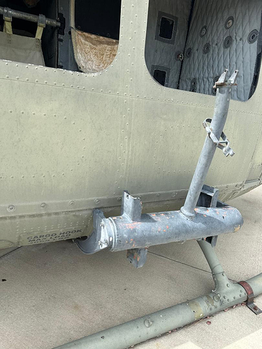

Can’t help much here, but I did take these last week for anyone wanting to scratch this mount:
I guess the OP is looking for the gun mount used with the M21 armament subsystem :
Yep, that’s the Mount I am looking for.

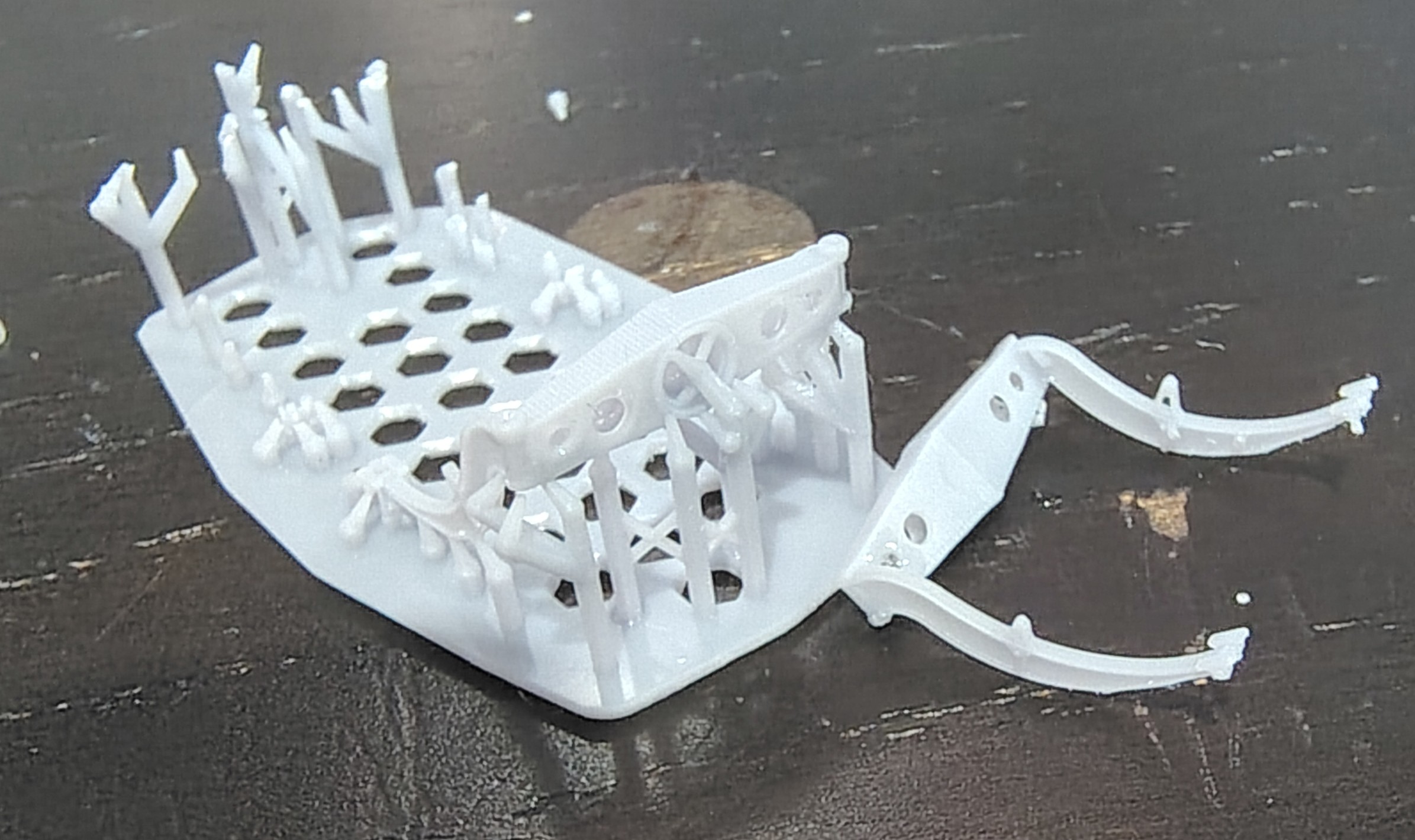

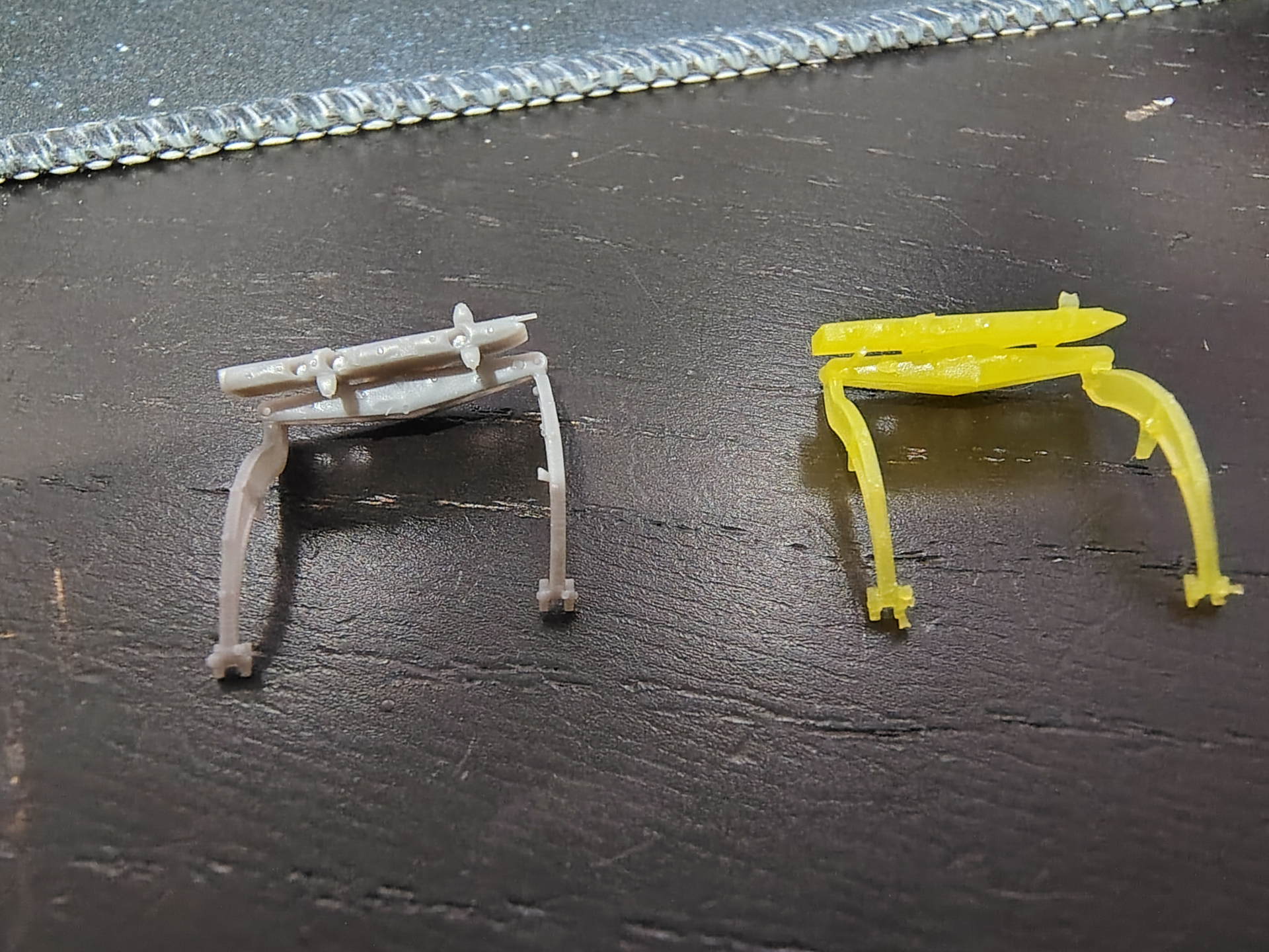

So I got the models from Cults3D, and the detail on them in the models looks really good.
My biggest gripe with this is that all the parts are modelled as separate tiny items that I would have no hope of assembling if they even managed to print correctly. I had to import them all simultaneously into Orca slicer to get them aligned and export as a single stl to slice in my SLA software.

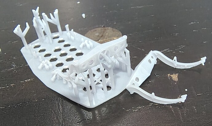

So far after one attempt printing them is a fail.
First attempt was with ABS-Like Resin from Sunlu, and the mounting arms are just way too delicate. Two of them broke before I even got a chance to try removing them from the supports. I have some eSun PLA-like Resin (which I know is quite brittle), and some Elegoo Standard resin to try.
Failing that I will have to import in to fusion and try and thicken the arms to strengthen them.
The other thing I didn’t realise is that there are two types of minigun mount, I am assuming period dependant.
I have imported that mount in to Fusion and begun modifying it via the old TLAR (That Looks About Right) method, since I don’t have dimensions.

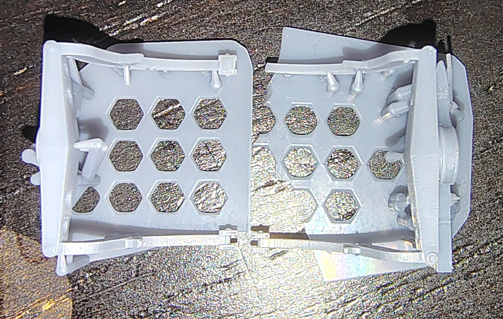

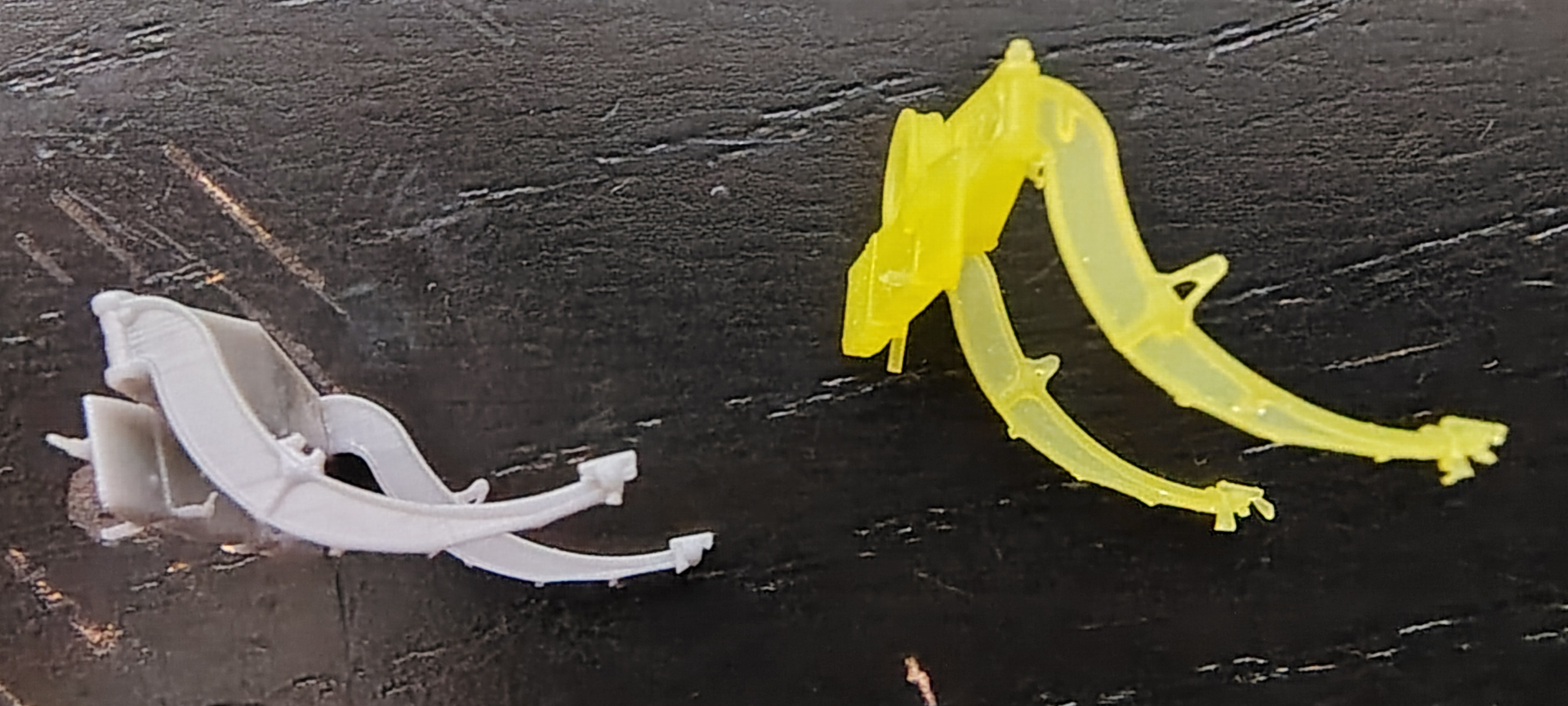

Photos. The grey is abs like resin, and the yellow is pla like resin. Bit hard to see in yellow but it’s the only colour i had in that resin. My standard resin prints are still awaiting removal and cleanup
I will definitely have to thicken the arms, the mounting points either broke off or didn’t print correctly.
The sway braces for the rocket pods also are way too delicate and broke while trying to remove supports. Will need to play with print orientation to see if i can get then to survive better, and will print the rocket mounts as a separate part.
Looking pretty good for initial prints. I can see where they would be a pain in 1/48. They would probably print up well in 1/35 though.

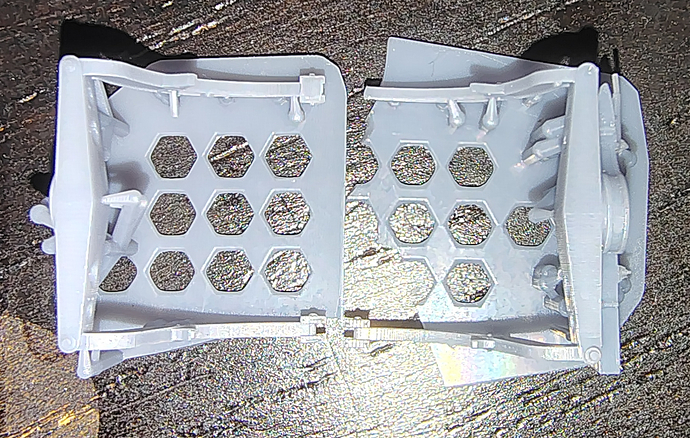

The standard resin actually feels a bit stiffer than the other two, but still don’t think i trust it this thin even with limited handling.
Will definitely be seeing if i can thicken those arms somehow in fusion. Currently they are about 0.7-0.8mm thick. I think 1.2-1.5 should suffice without making them appear comically oversized

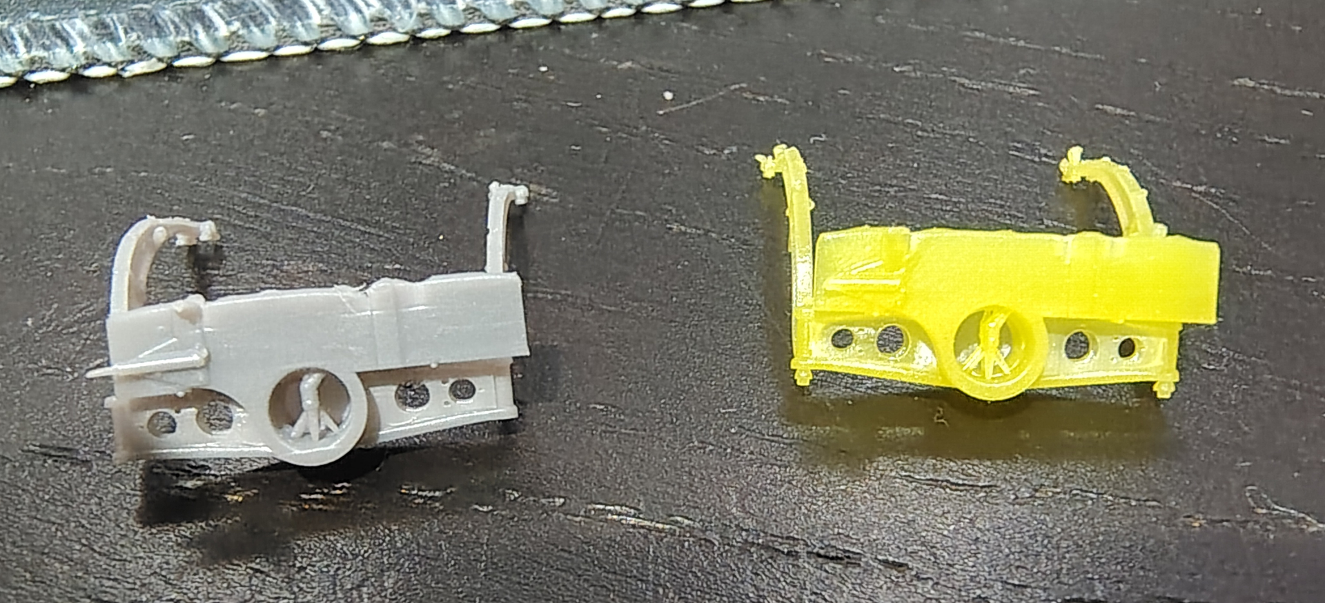

Don’t know how much it will help, and for the amount of effort required i don’t think it was really worth it, but on the left is the modified version with the thickened arms and on the right is the original.
Only ended making them about 1mm thick so about 0.2mm thicker, and they are stiffer, though i can still flex them inwards to touch each other.
I will probably end up leaving them on the support material when i try and mount them on the helicopter so that i don’t accidentally bend an arm.
