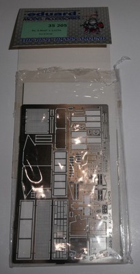

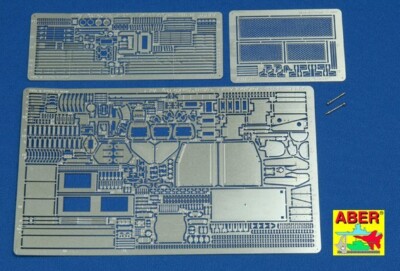

Aber and Eduard think that it belongs on the Luchs.

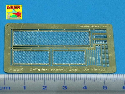

I have the big Aber set. It includes the mesh, but alternatively also includes more louvers for the exhaust grille as an alternative.
