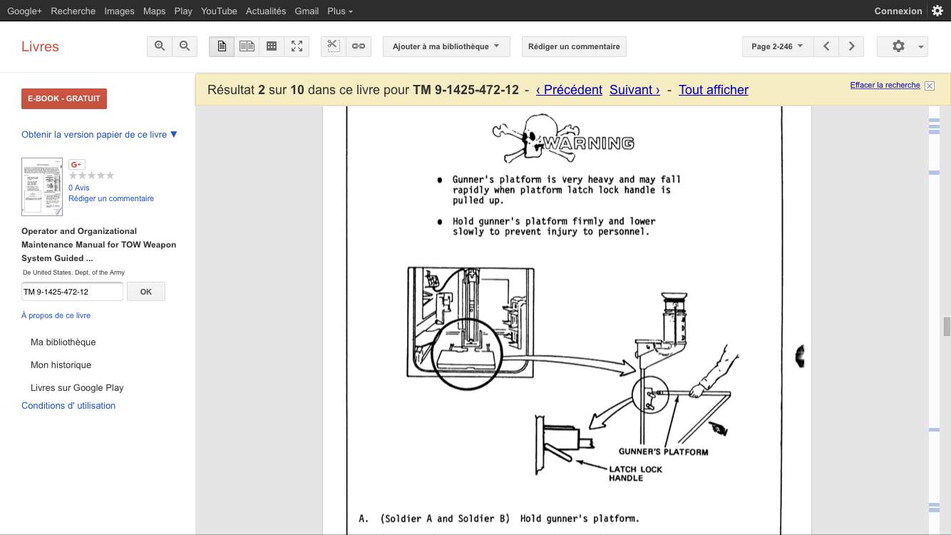

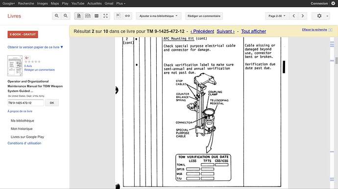

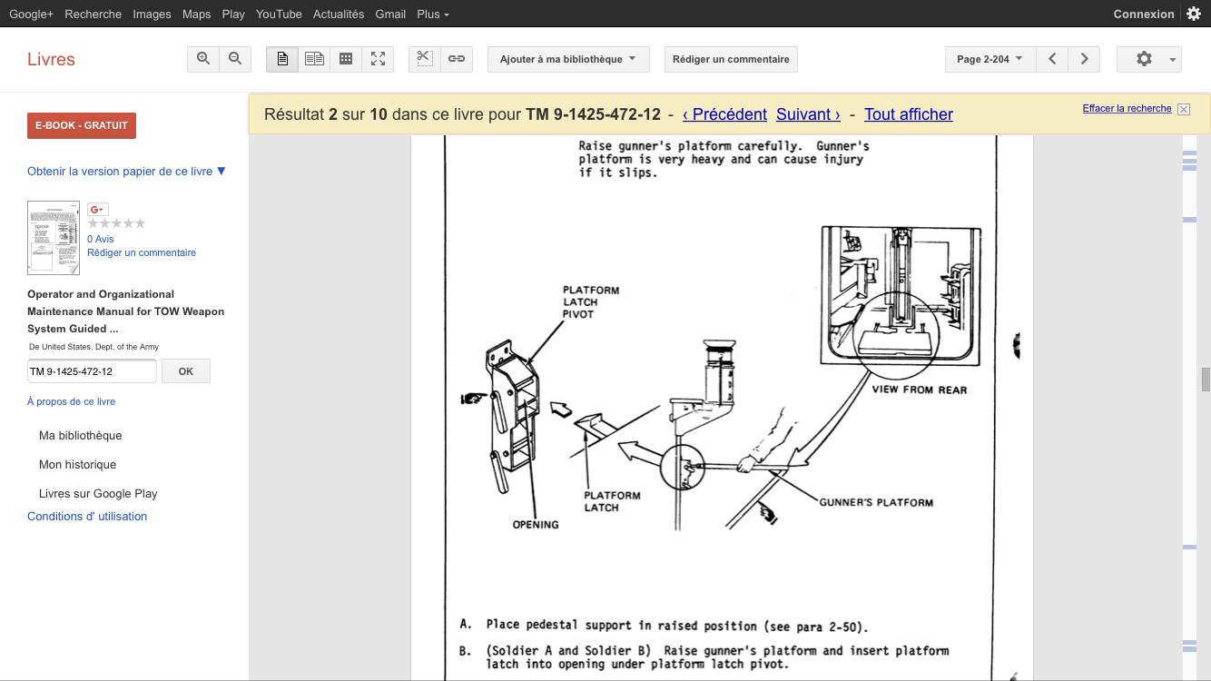

Here are a few pages from the vehicle manual

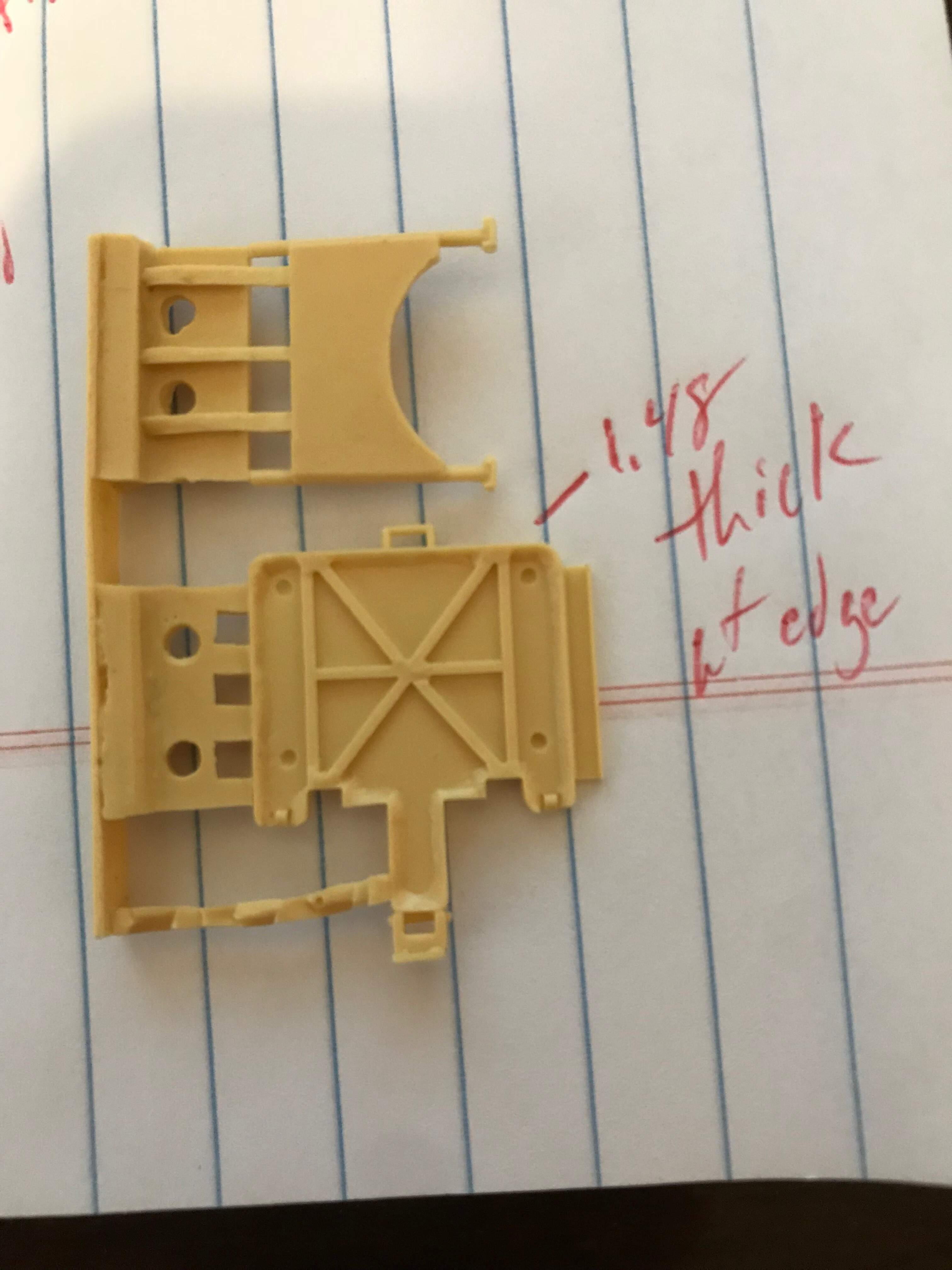

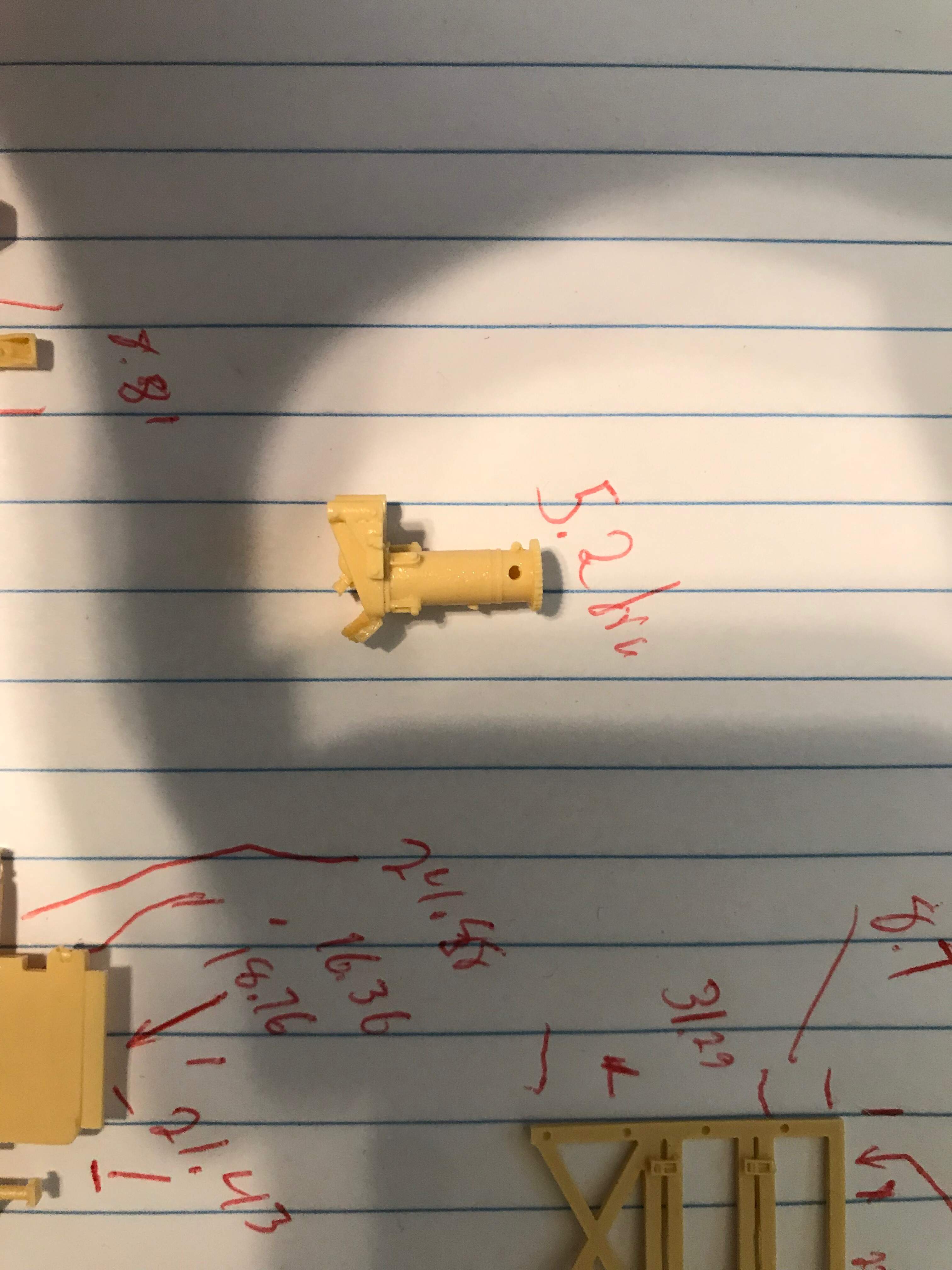

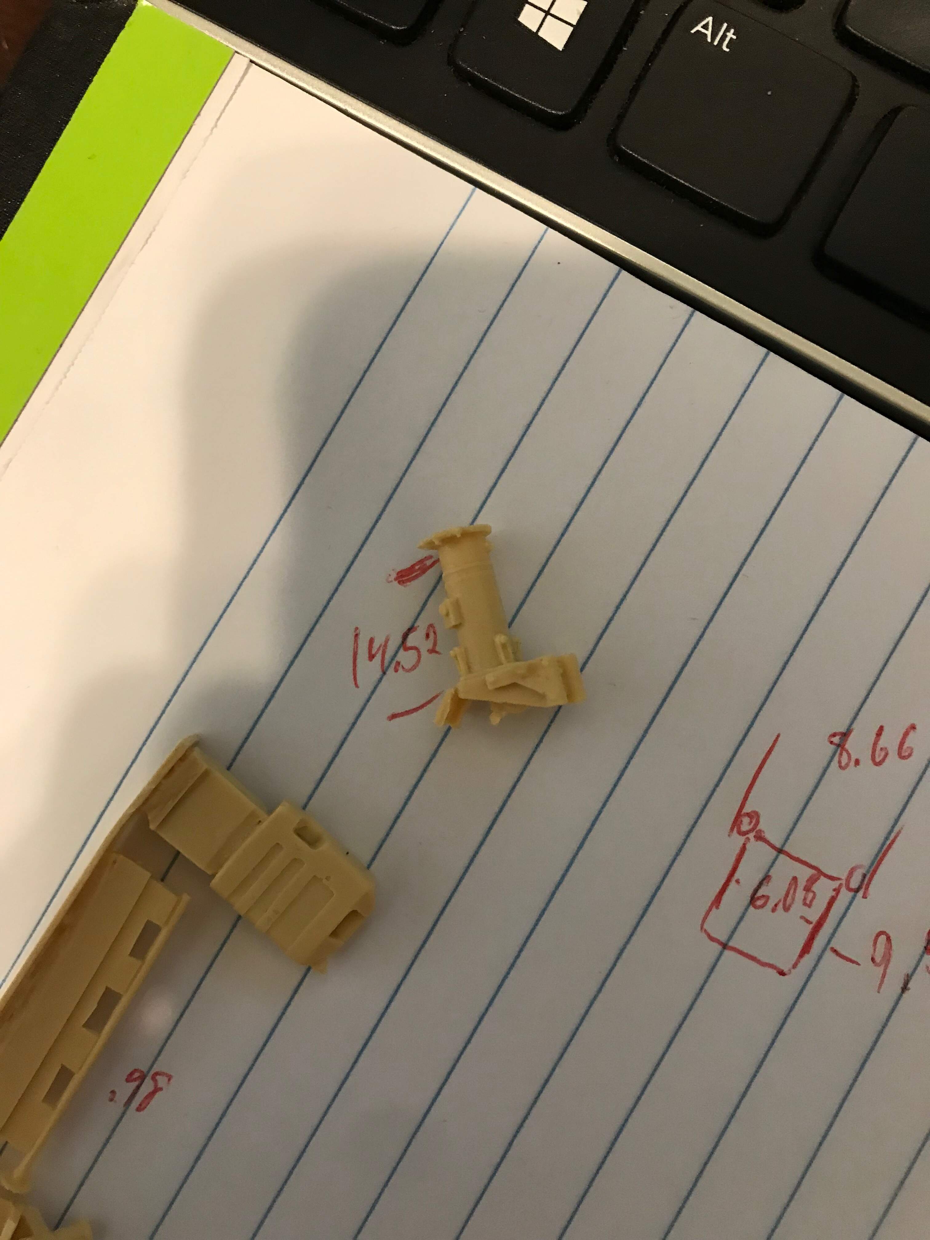

The parts from the Hobby Fan kit before I sold it. The sprue in the kis is from the AFV Club TOW Wiesel.

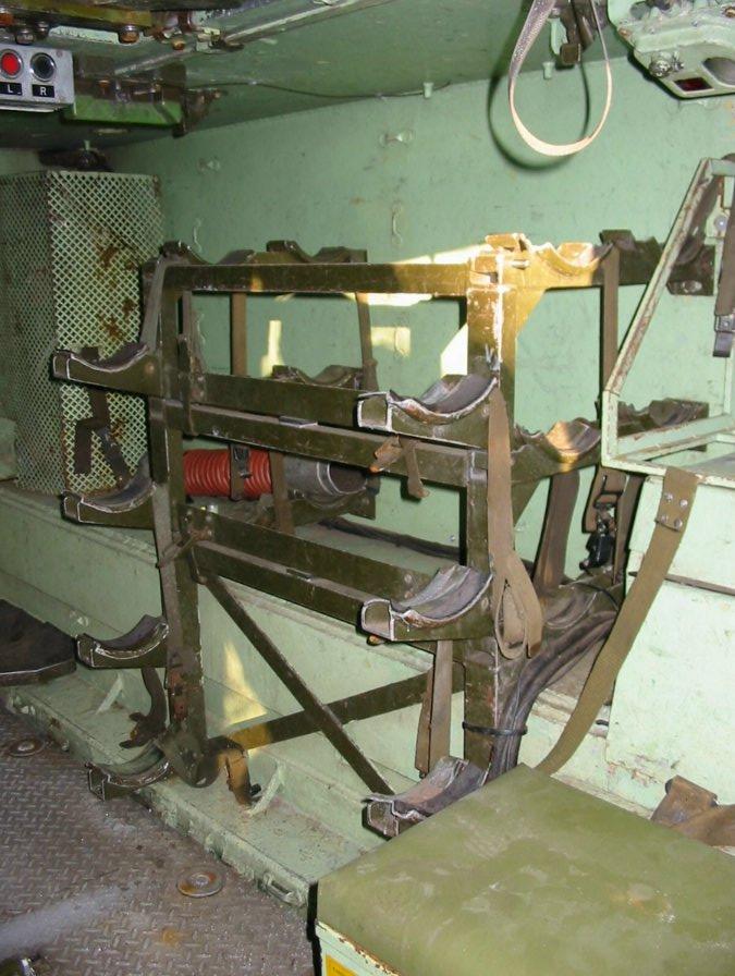

I’ve got interior pictures of the Danish version. That’s it. Very close to the Tank magazine drawings I posted.

Here is the TM for the TOW system, including ground mounts and various vehicle mounts such as the M113. Lots of drawings and just about anything you need to know.
http://www.towgunner.com/Operator_and_Organizational_Maintenance_TOW.pdf

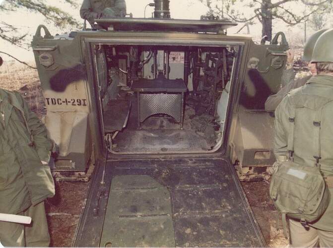

I don’t remember where I got these from. Might have been the old Tanx Heaven site.
The rest
Gerät, thanks alot :star_struck:
Excellent photos! Man that looks as crammed in there as the ITV was… I can only image when it was combat loaded…
