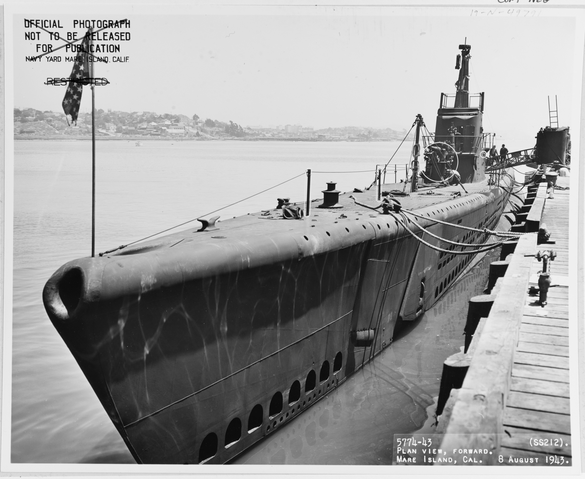

Here you can download hi-res views of the Gato in 1943.
https://www.history.navy.mil/our-collections/photography/numerical-list-of-images/nhhc-series/nh-series/19-N-49000/19-N-49791.html
https://www.history.navy.mil/our-collections/photography/numerical-list-of-images/nhhc-series/nh-series/19-N-49000/19-N-49790.html
https://www.history.navy.mil/our-collections/photography/numerical-list-of-images/nhhc-series/nh-series/19-N-49000/19-N-49789.html

Depending on the boat, weathering can vary wildly. I’d recommend checking out www.navsource.net. It’s a very good site and features photos every type of Navy vessel, including all of the Gatos. I used it when detailing my 1/144th Gato.

Thank you for your help. Not many photo’s of subs returning from patrol. The Navsource.net was very helpful!
