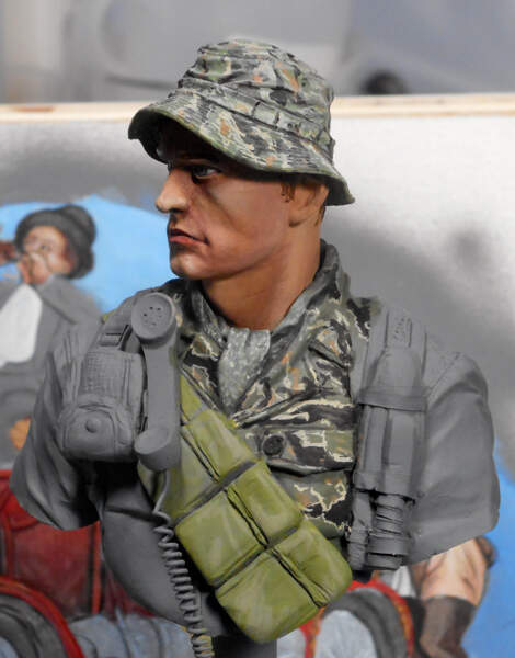

LRRP Vietnam scale 1/10 converted
Not always satisfied with the result of some bust, but everything is a learning process.
The original bust is from Young miniatures, I just did some conversion on the front of the figure.
Cutting of the life vest and re sculpting some gear.

The bust looks great. :+1:
I like it! I congratulate you on the courage to cut up such a magnificent bust and convert it to your preferences. You did a great job with resculpting garb and gear.
The tiger stripe camo looks very cool. What did you use for the whip antenna?
Mario
Mario, mostly I use for something like this a strip of foil cut out of a mustard tube.
the small straps around the antenna are made from loid foil.
It’s strong enough and flexible, you can also use some thin plastic card strip cut in the right proportions.

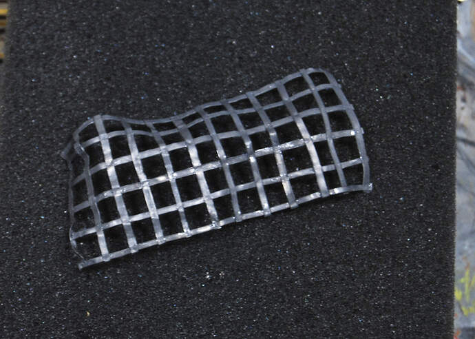

the typical things I use for straps, antennas, belts and other small parts.
Aluminium Foil, recovered from the kitchen of my wife
lowensenf tube
After use cutting it open, clean it
thickness, between 0.2 and 0.3 mm, flexible and robust, not always easy to fold.
lead foil, I have brought mine to a jewellery, thickness wat the jewellery wont to do.
You don’t have to by a roll, search for a remainder by a plumber or roof builder.
you can use it for almost everything straps, belts, tarp
