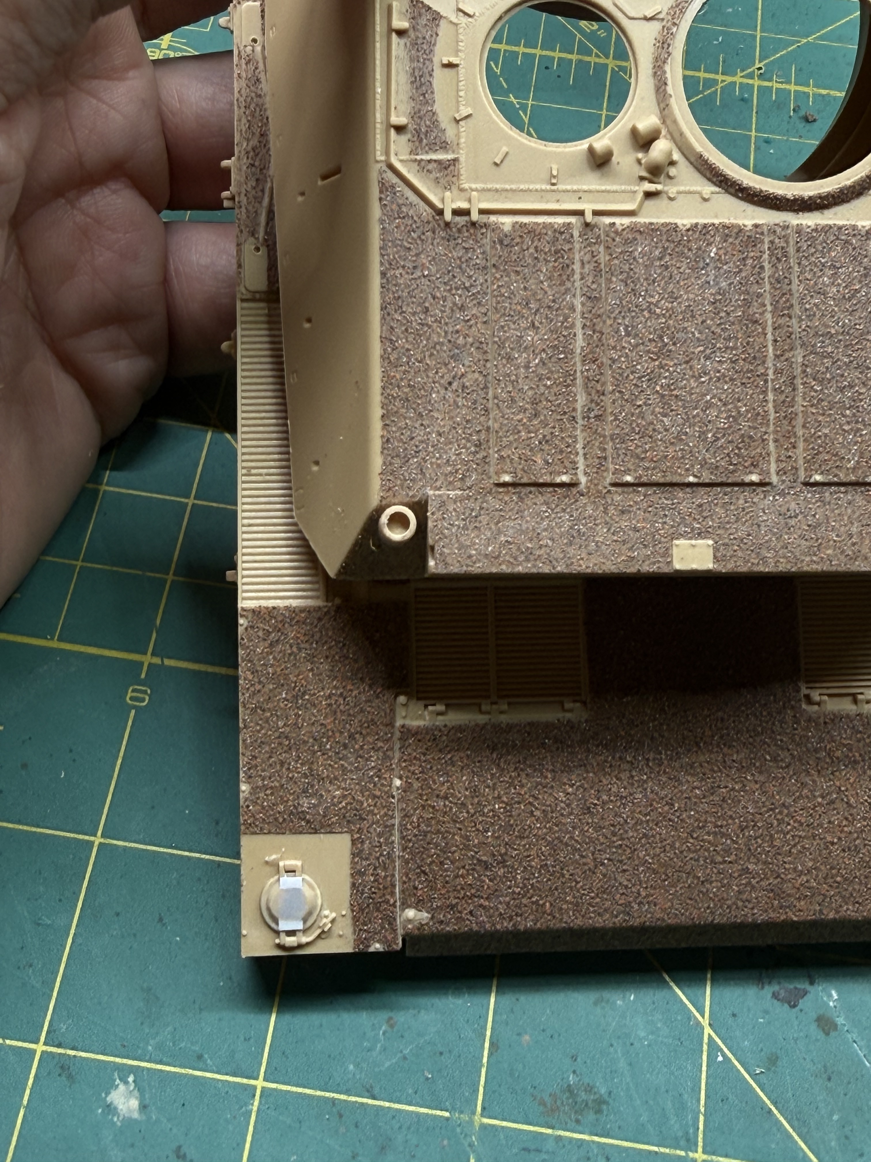

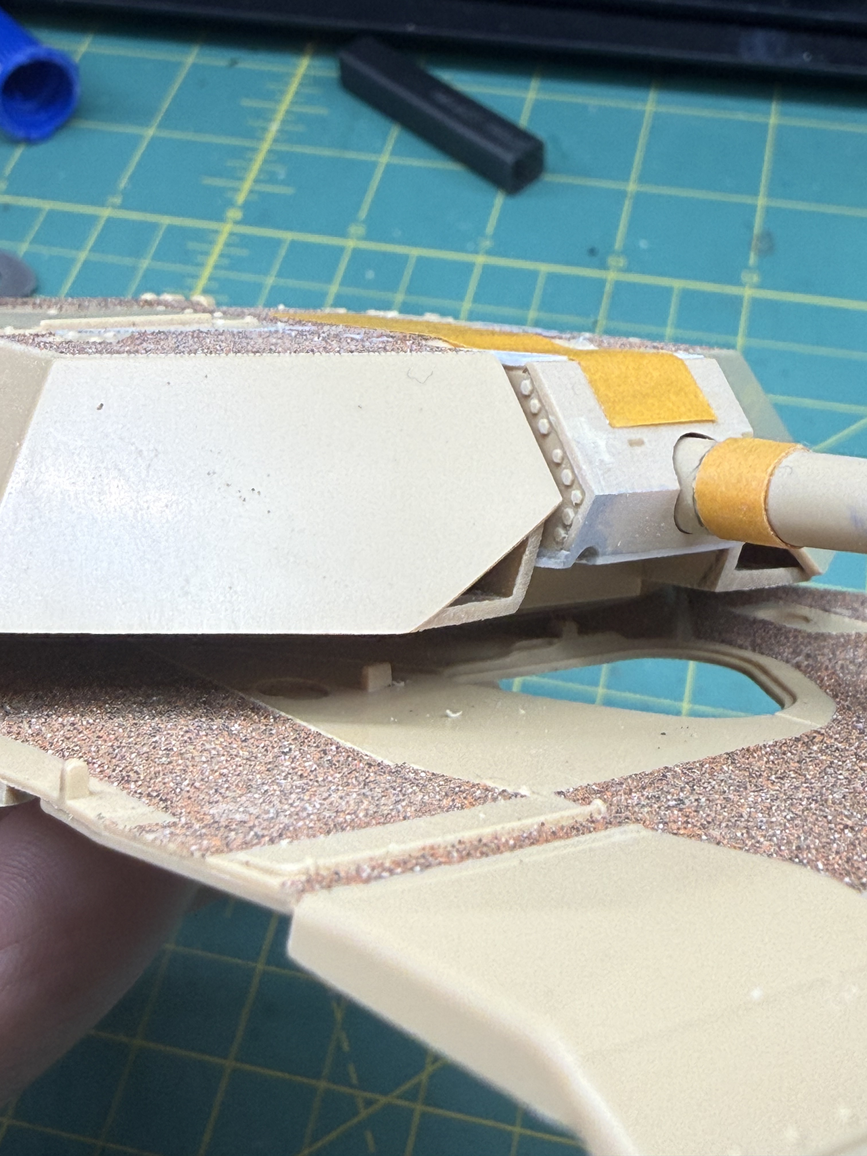

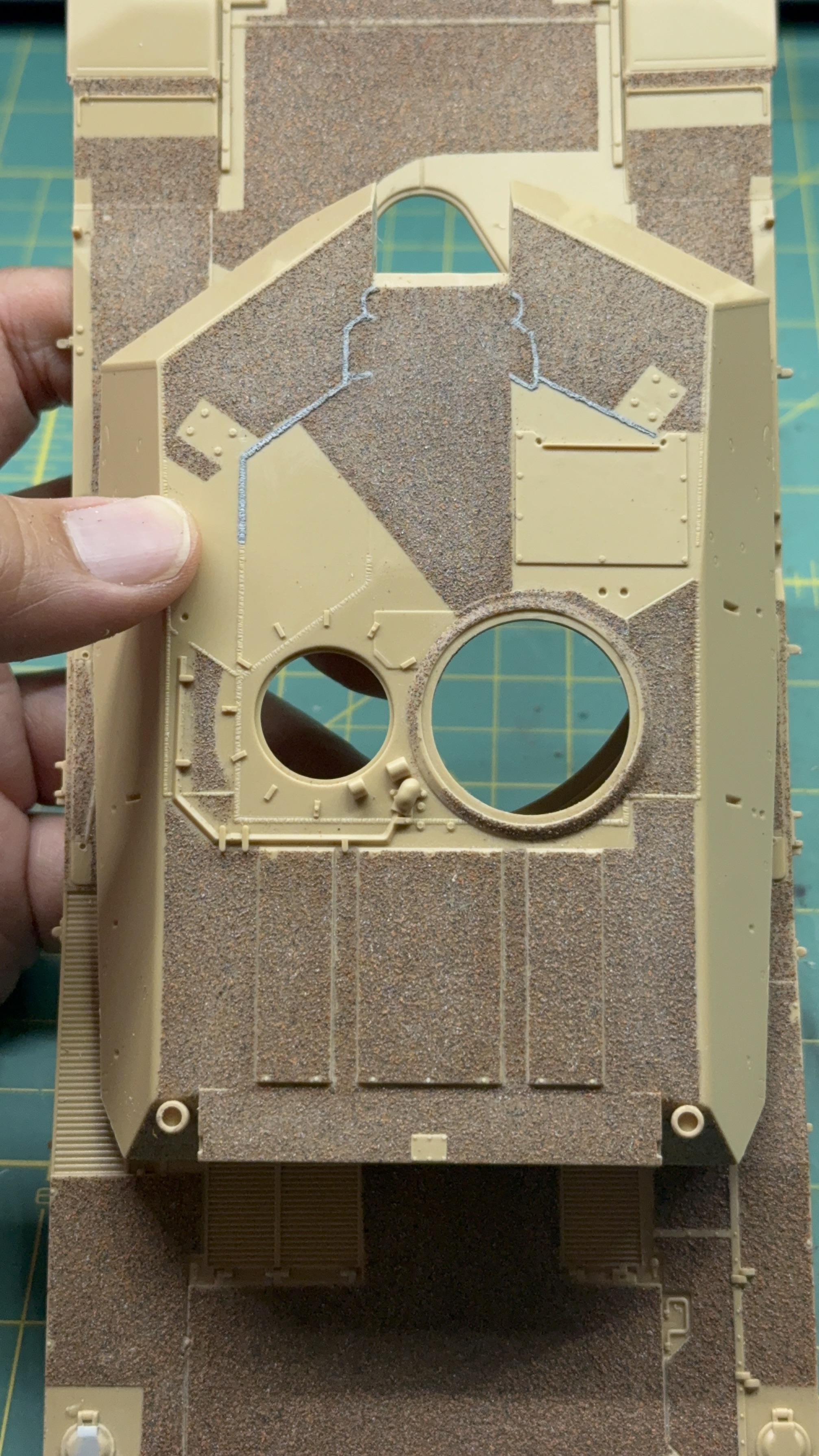

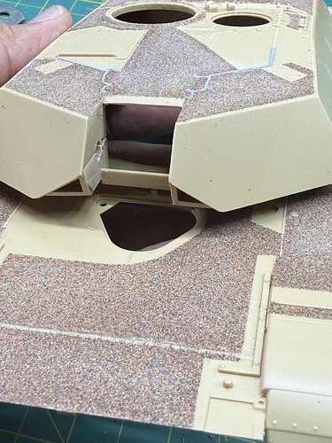

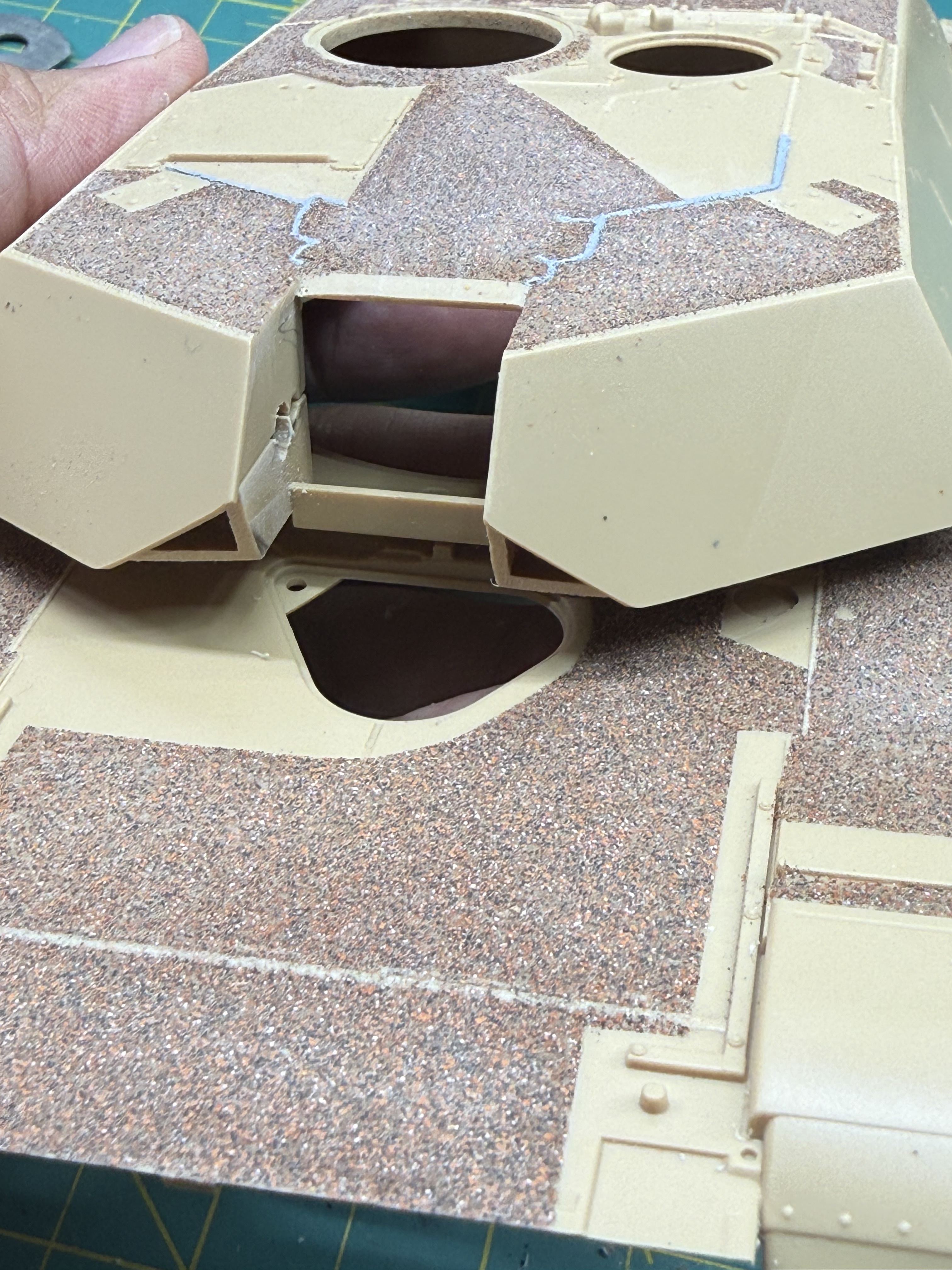

I’ve started a Panda M1 IP kit. It doesn’t feel as bad as some reviews said it is, definitely not Tamiya/ newer Academy quality though. I’ve just done some of the major corrections of the kit according to research of this forum, including deepening the mantlet, modifying the mantlet, redoing the weld lines in the new position, turning the fuel filler cap in the correct orientation, and adding anti-slip. For the main gun, I used the front section from a Tamiya M60A1 kit, but it is a tiny bit small in diameter, will try to add a sheet of brass if I can roll it smoothly, otherwise just going to leave it until better aftermarket solution arrives.
The anti slip was pretty weak on these tanks.
I’ve never done anti-slip before, only cast texture using Mr Surfacer 500 brushed on, so I took it as an opportunity to to try a new skill. Once it’s primed, I might sand it down a touch if it’s too strong.
