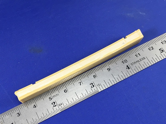

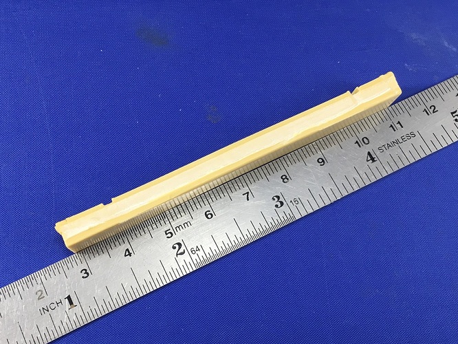

Either use hot water or a hair dryer to warm up the part — make sure to heat it from both sides and enough that it penetrates into the material rather than only heating up the outside. Then press it flat against a surface (a stone kitchen countertop is very good for this, if you have one) and leave it to cool; you may want to apply some cold water while you keep it pressed flat.
This will get you from this:

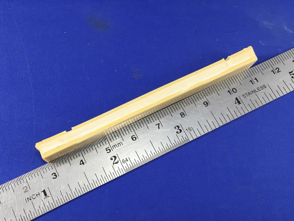

to this:
(That’s part of the ancient Verlinden conversion kit to turn an M107 or M110 SP gun into an M578 ARV, BTW.)
