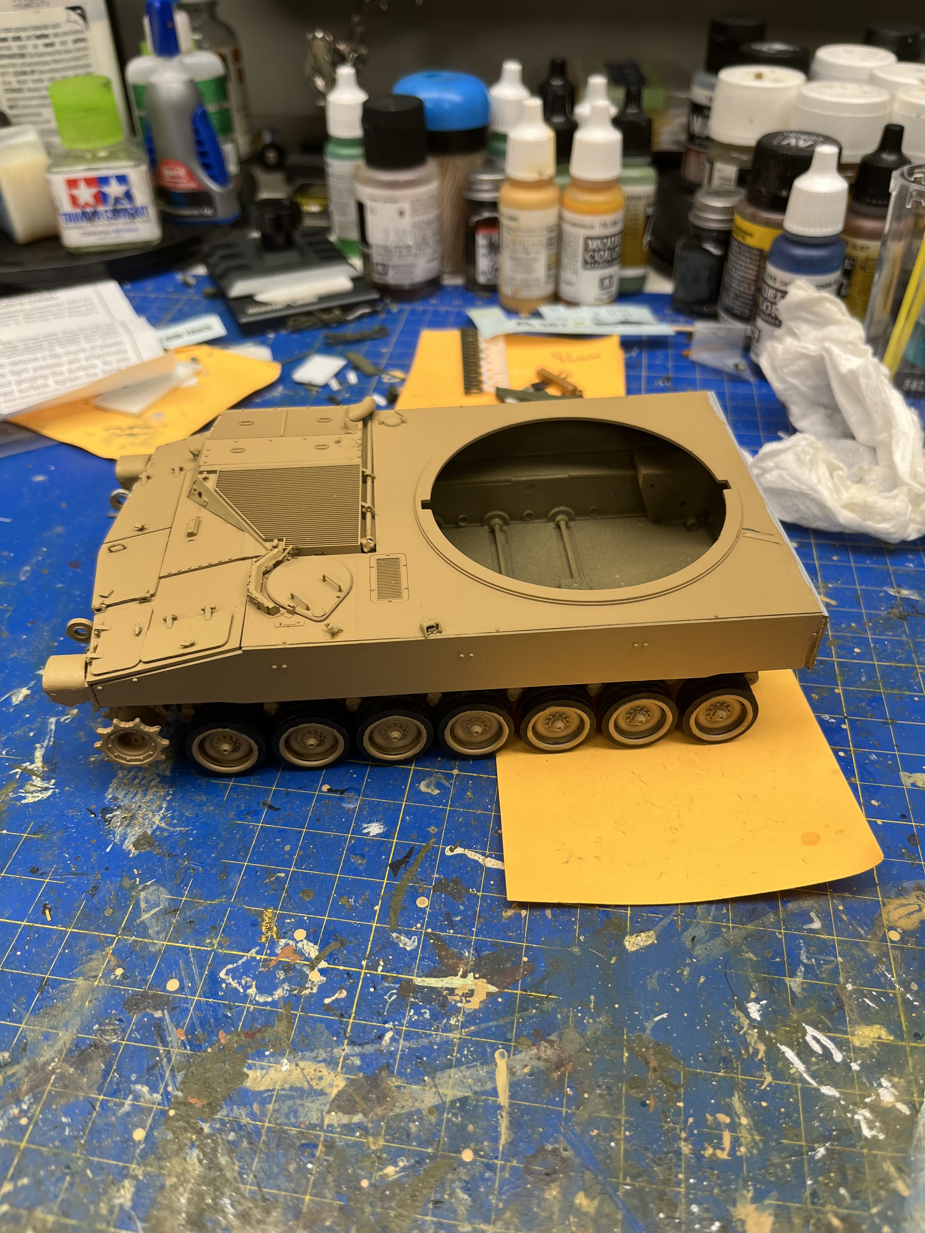

Thanks for that. I’m also have a paint issue; my ODS-era M109A2 is wearing a lightened coat of Tamiya Desert Yellow. My question is, is it still too dark a shade? The box art on the Tamiya M109A6 shows a similar shade on the later vehicle but I want to keep it as accurate as possible for an ODS vehicle.
Any comments or recommendations would be appreciated.
TIA
It is a bit dark. Tamiya does not have a like color. The dark yellow with some Buff to lighten it may be closer. Or Buff with some dark yellow.
Or AK RC CARC Tan.
Thanks guys. I see what you mean about Tamiya Buff and I have a few bottles. Regrettably I’ve only got two small bottles of AK CARC tan and I’m guessing there’s too much plastic to cover on the M109…….(I’d love to try it though).
ETA Ive checked re the AK CARC tan and it looks much more of a grey tint than pics I’ve seen. There’s some discussion on the old site which seems to support this, so Im going to try Tamiya Buff and mix in some Dark Yellow.
As stated above, the AFV Club tracks are spaced out on the sprues where all you do is add the end connectors (also spaced on their sprues) and you are done. They are very easy to work with and need no jig to make them.
As to color, the best I have found is Testors Model Master Sand (FS33531), unfortunately, Rustoleum bought out Testors and discontinued the Model Master line. For single colored sand vehicles, I have also found the Krylon Khaki in a spray can is a pretty a good match. Initially it is a little light, but after weathering looks great and matches CARC Tan well.
Also remember, for ODS you can paint them just about any sand color you want as most vehicles were painted in Saudi Arabia with non-FS paint that was bought locally. The sand/tan colors varied widely and faded badly. Some vehicles had the paint chipping off all over from wear and cheap paint by the end of the conflict too.

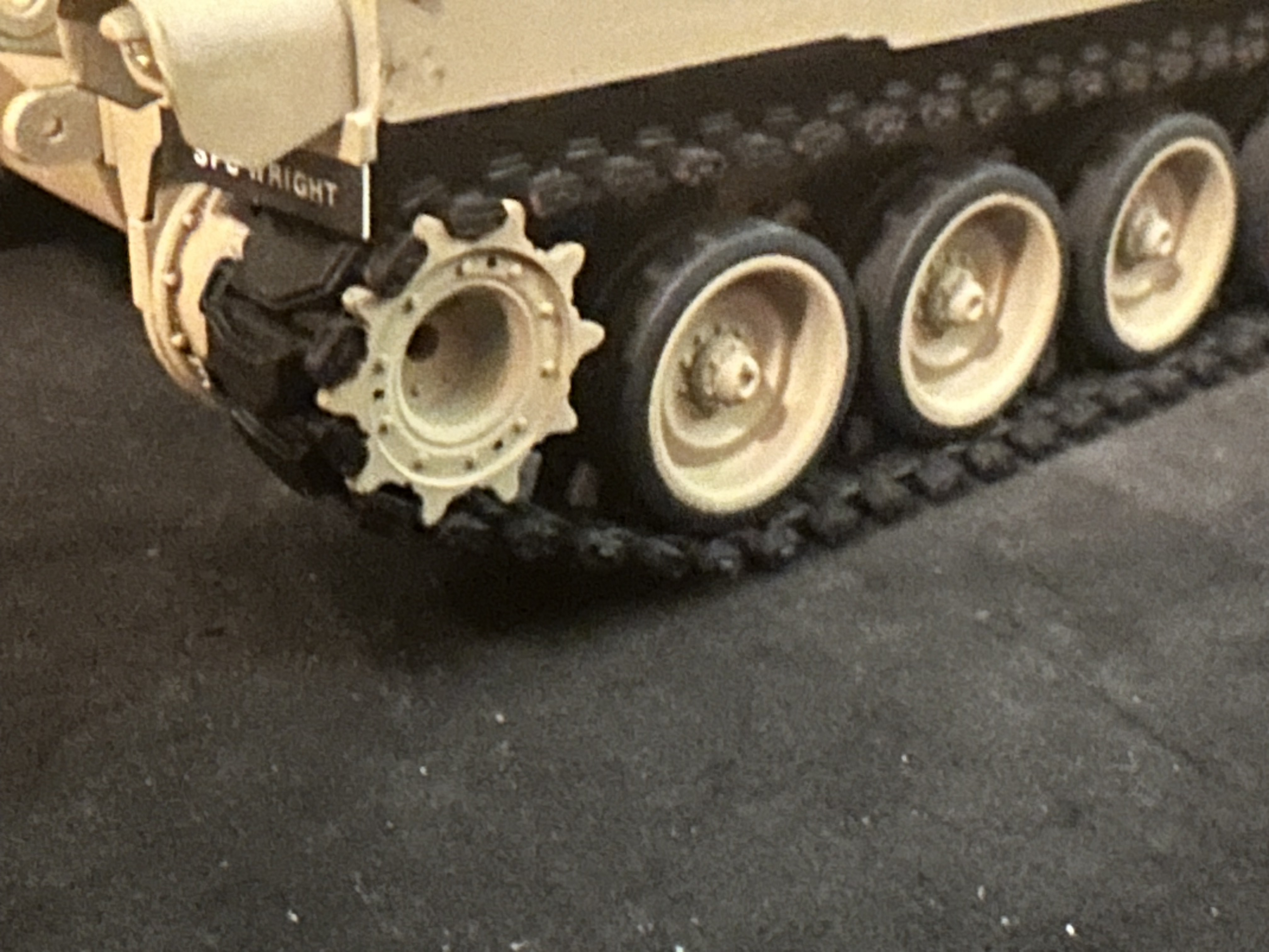

Thanks Gino. Is the lightened Desert Yellow pictured above credible as a Saudi-painted vehicle?
I’ve spent the last while mixing something closer to last of the MM Sand I have left. I’ll respray over the Desert Yellow if I have to🤔
