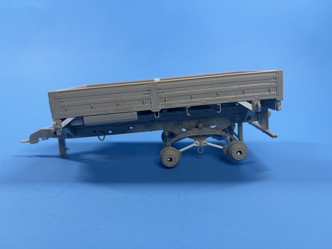

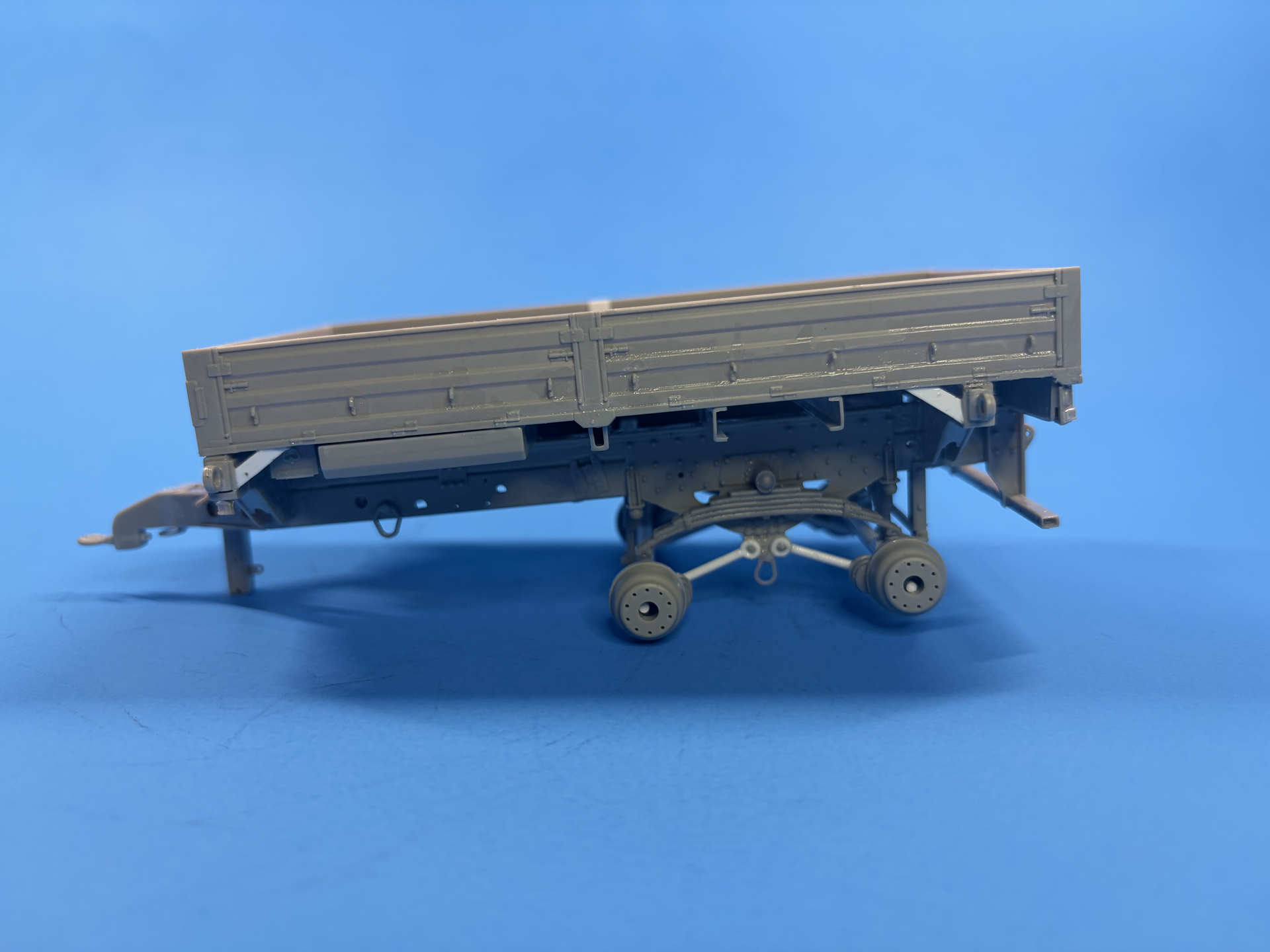

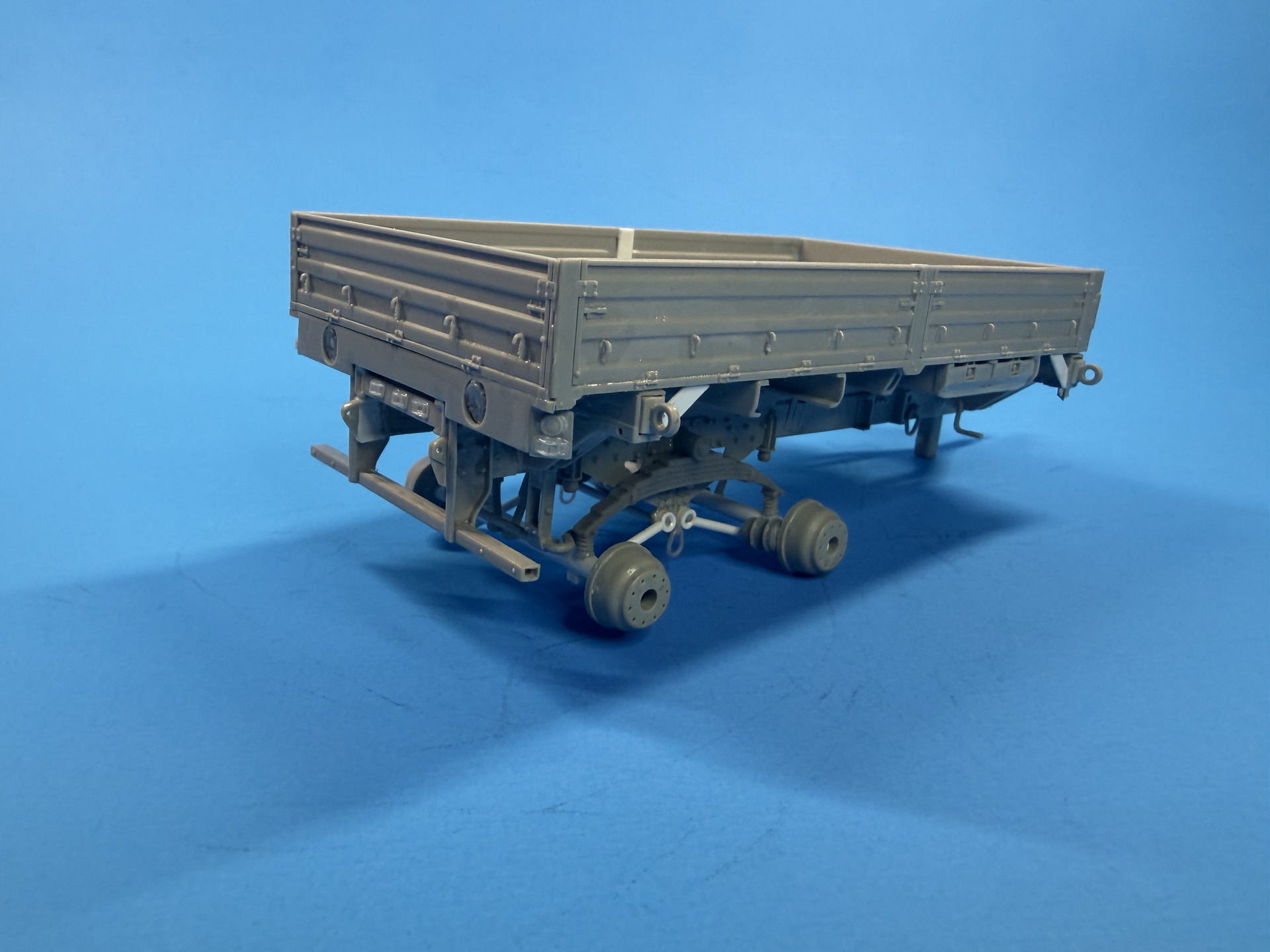

This is a little side project I have wanted to attempt for a while. I wanted to build the 5-ton M1095 FMTVT (trailer) to go along w/an M1083 FMTV 5-ton truck.
Trumpeter makes a kit of the 2 1/2 ton M1082 LMTVT which is a lighter-weight trailer with a single axle.

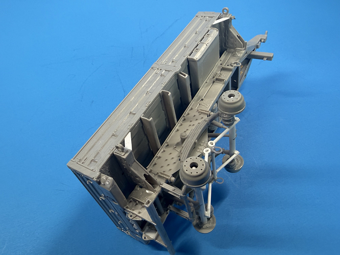

I had the idea to take some parts from the M1082 and a left over 5-ton FMTV frame (left over as extra from the M142 HIMARS kit), and left over FMTV bed to make an M1095.

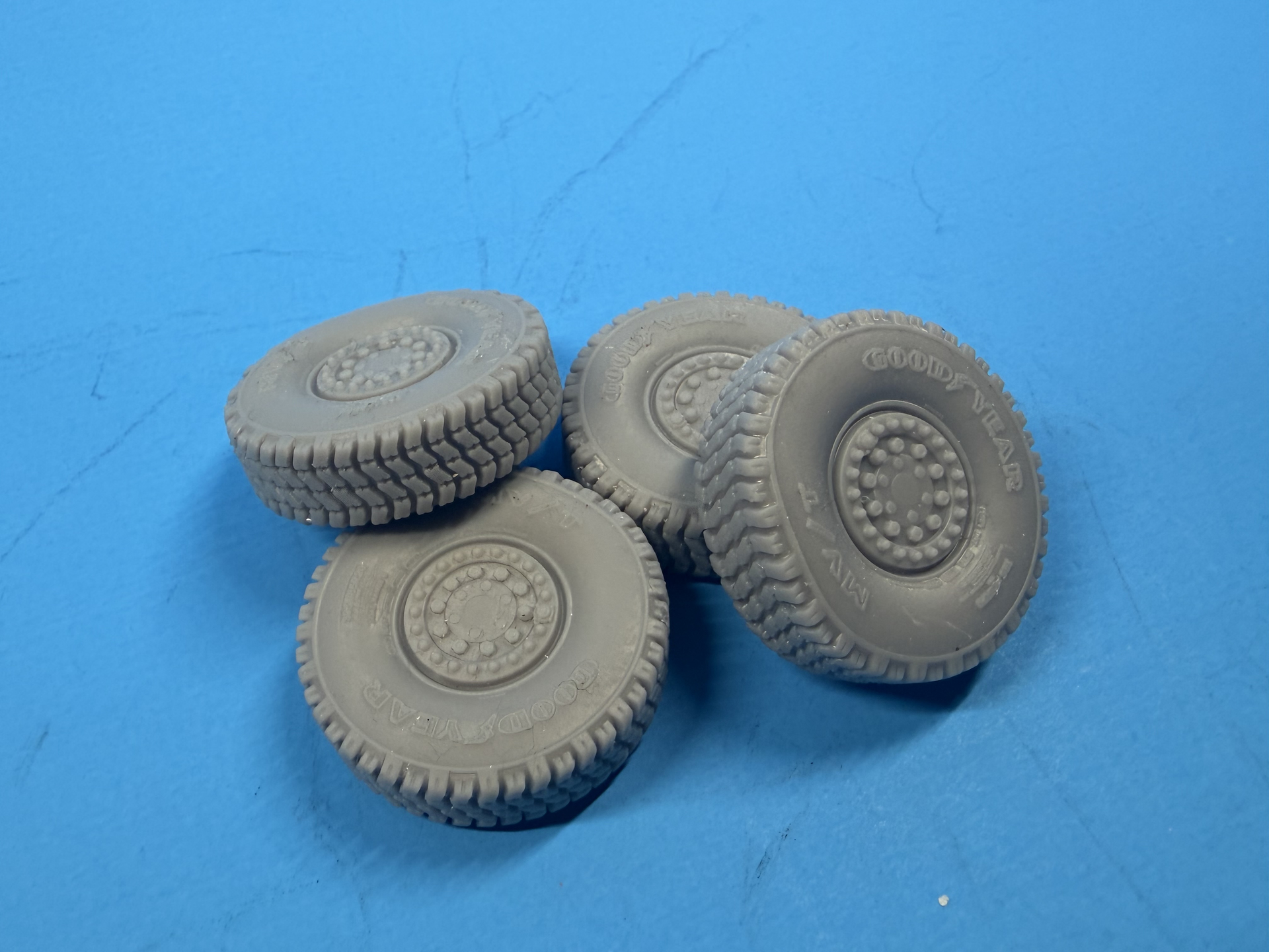

I cut the frame to the appropriate length and added the M1082 trailer parts to it. As with the actual FMTV vehicles, they all use most of the same parts, as do the trailers. To build the dual rear wheels, I 3D printed the springs and shocks, and made the axles and smaller parts from styrene shapes.
Here are the results.
The wheels will be 3D printed ones as well.
Now to the paint booth.

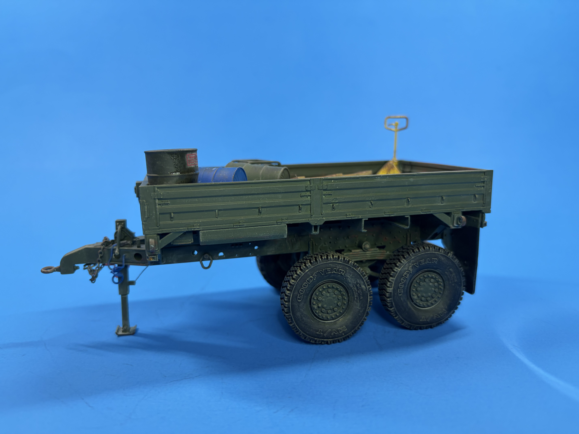

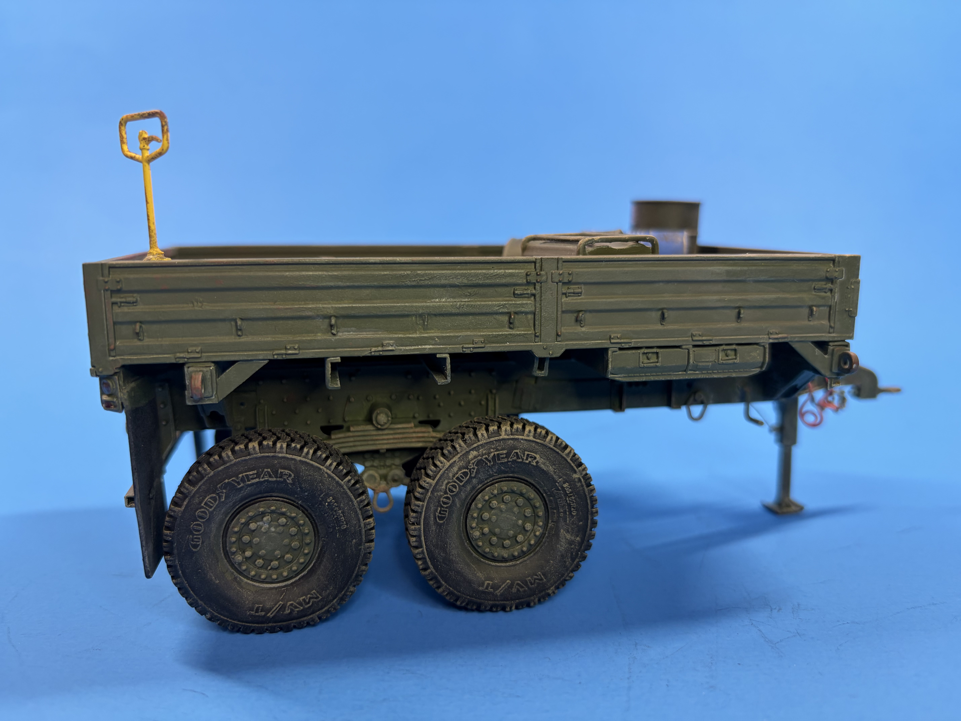

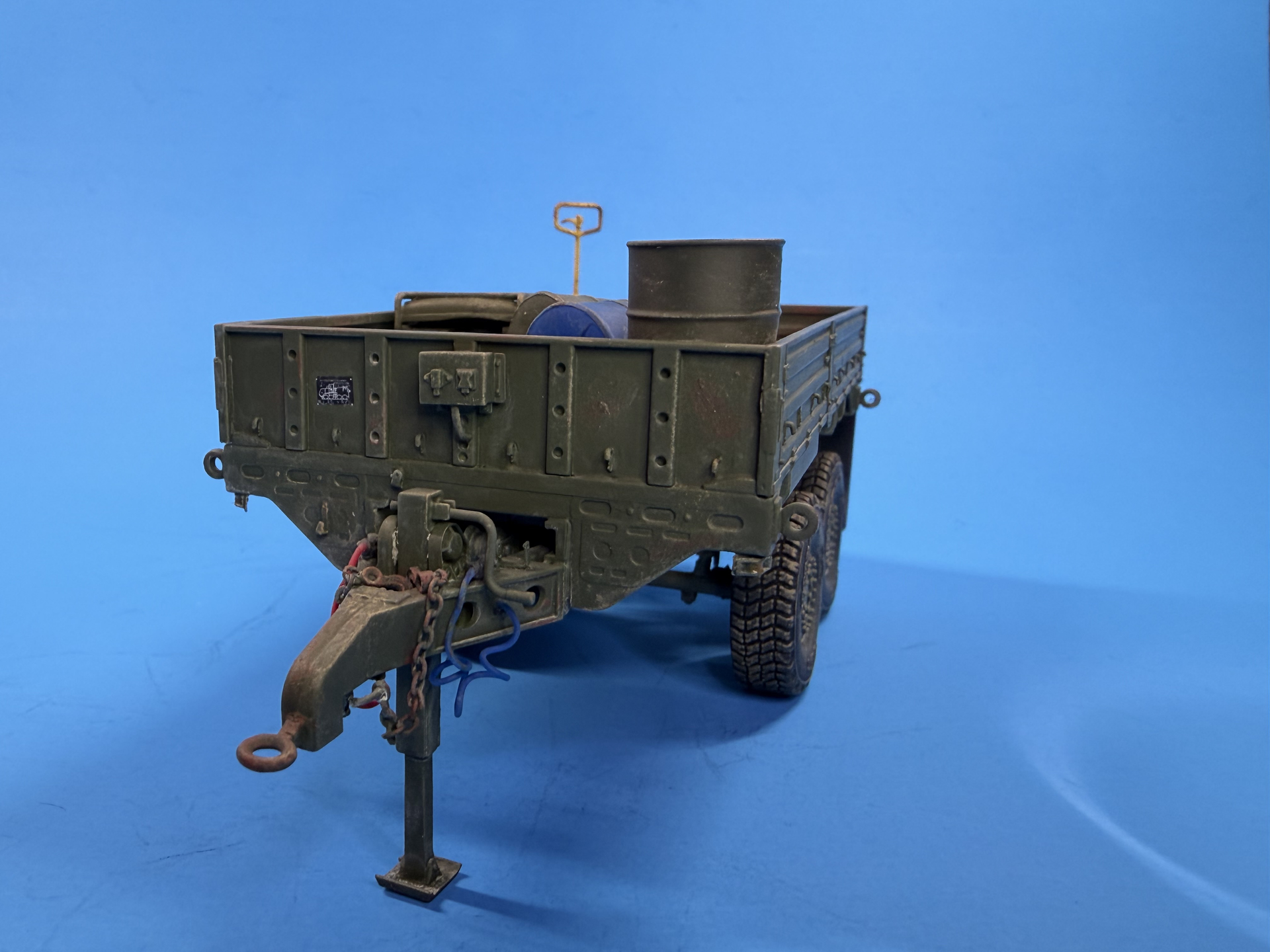

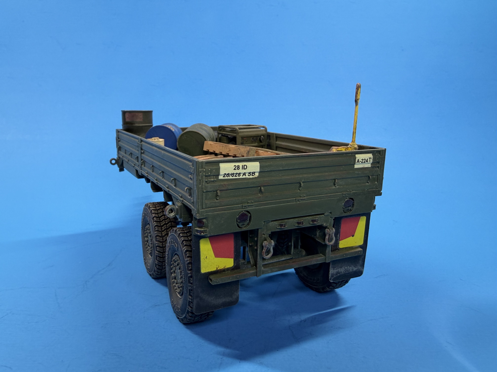

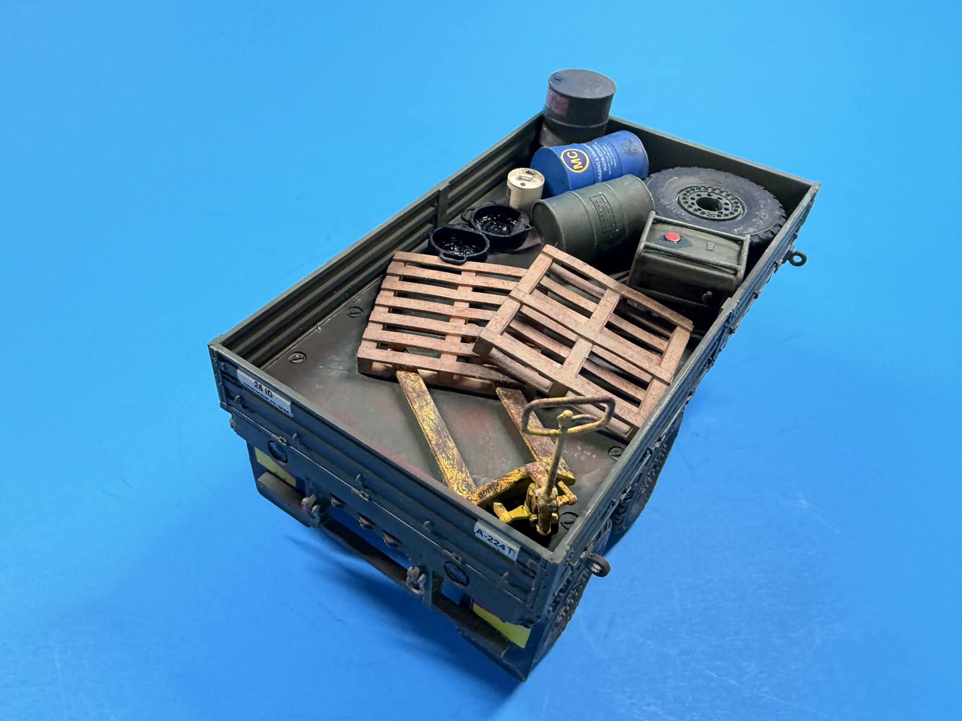

I finished up the M1095 FMTVT today. I painted it overall NATO Green and lightly weathered it with some sandy colors. I added 3D printed air line connectors and hoses for the brakes, and safety chains w/3D printed hooks on them.

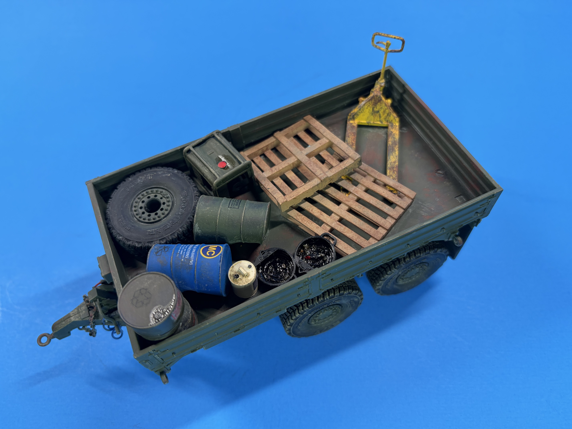

I loaded it up with various gear and stuff in the back. All of it is also 3D printed with the exception of the hand truck. Not sure where I got it. The cargo includes dented up 55 gal drums, an oil can, a spare tire, a couple dirty drip pans, a couple pallets, and a small generator.

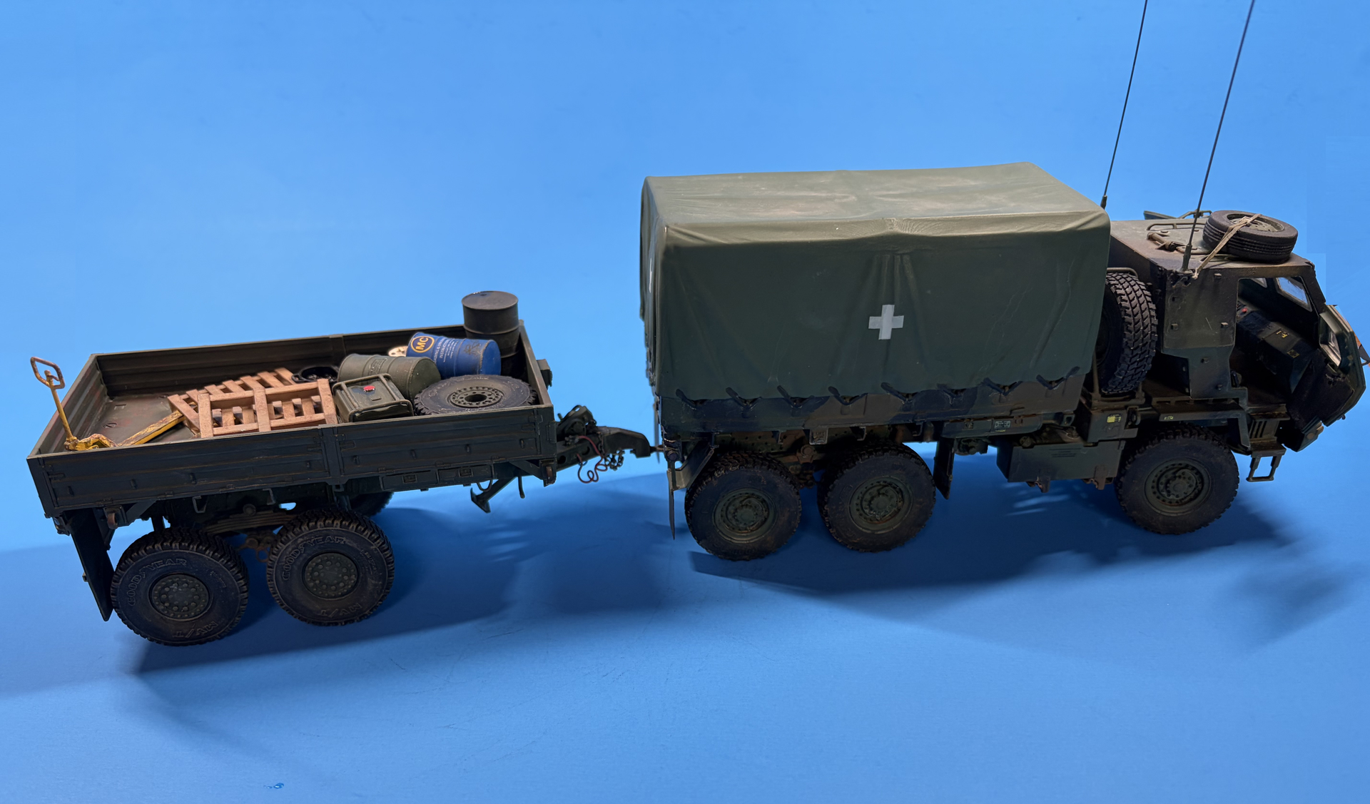

Here is how it looks connected to an M1083 FMTV, not the one it will eventually go with.
This was a fun little diversion and I was happy that I could build/convert it as I had envisioned.
Both look great together.
