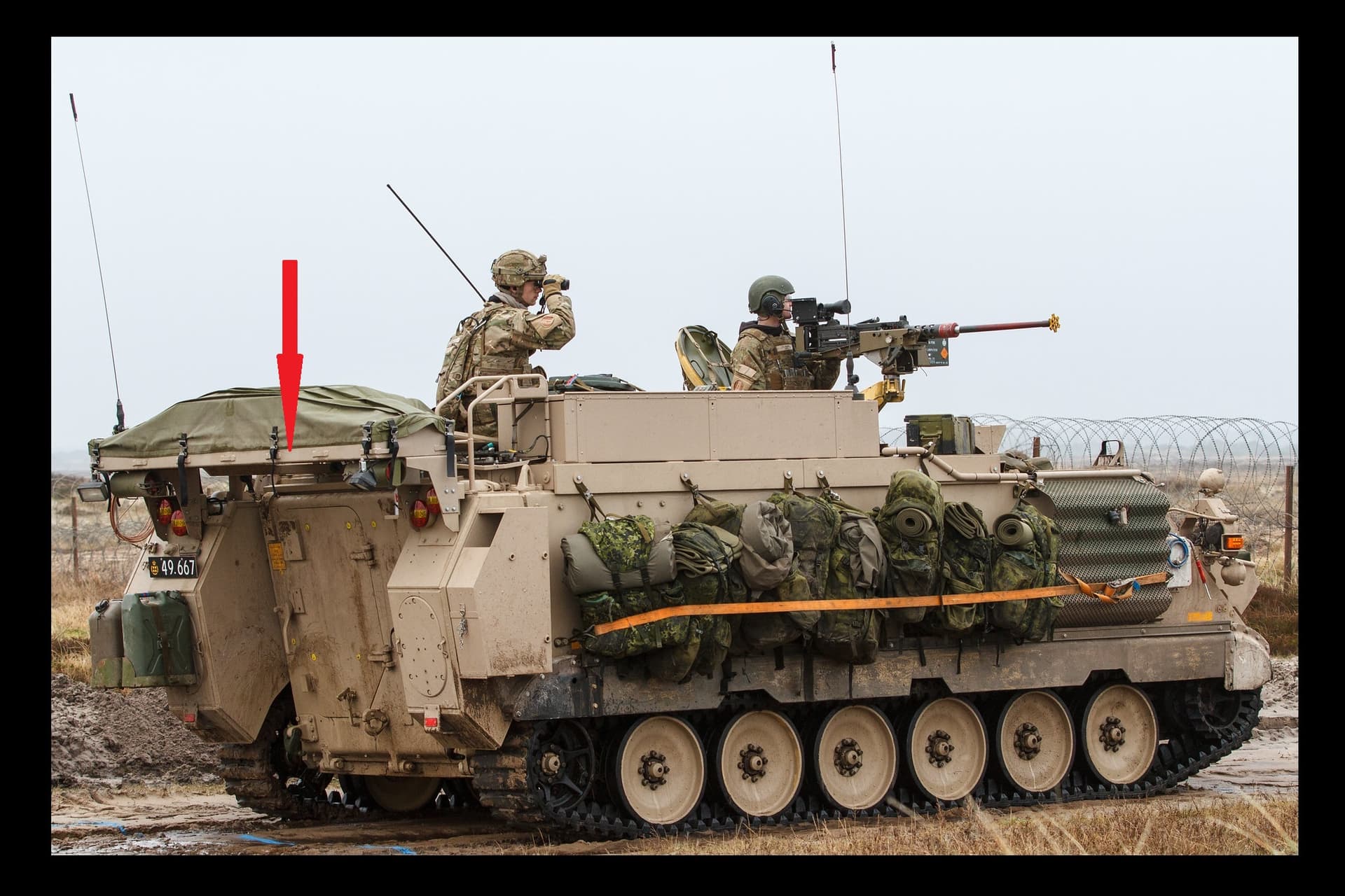

Photos of the Danish Amy’s M113 show what appears to be a full-width shelf attached to the rear of the hull (as marked). Is this simply designed to carry additional stowage, or for some other purpose?

It is a stowage rack, probably for a tent extension.

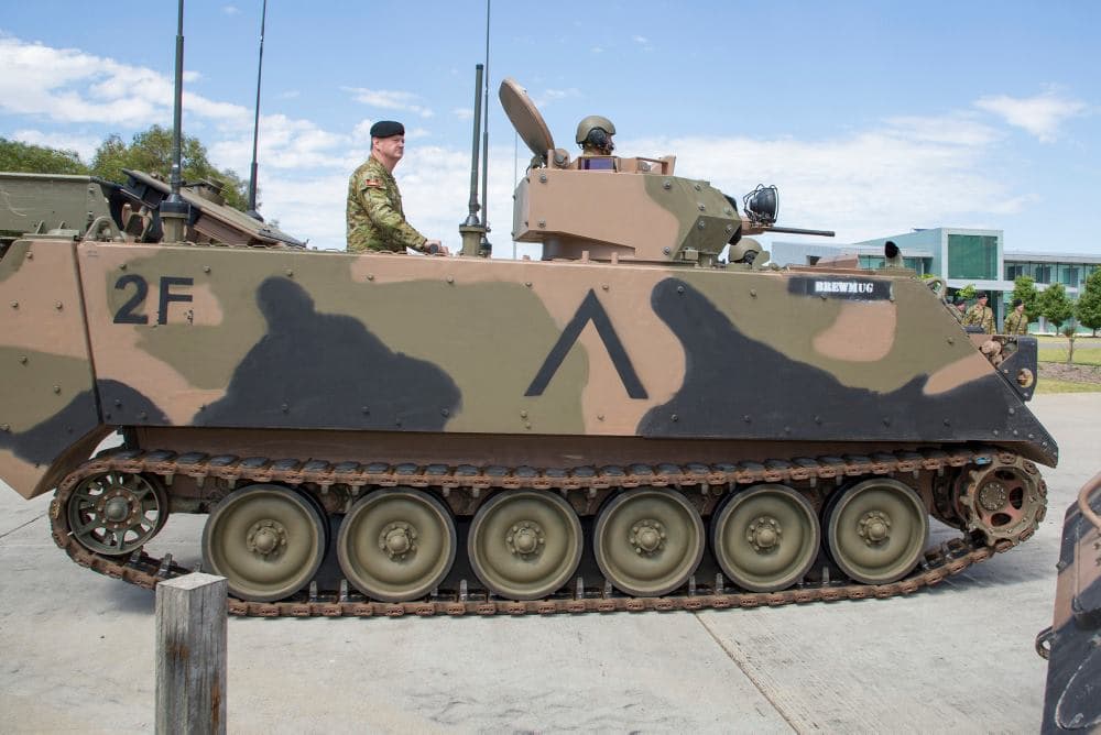

Also of note, that is a lengthened M113 with a 6th roadwheel. It looks similar to the Australian M113AS4.
It also has Soucy “rubber” band tracks.
