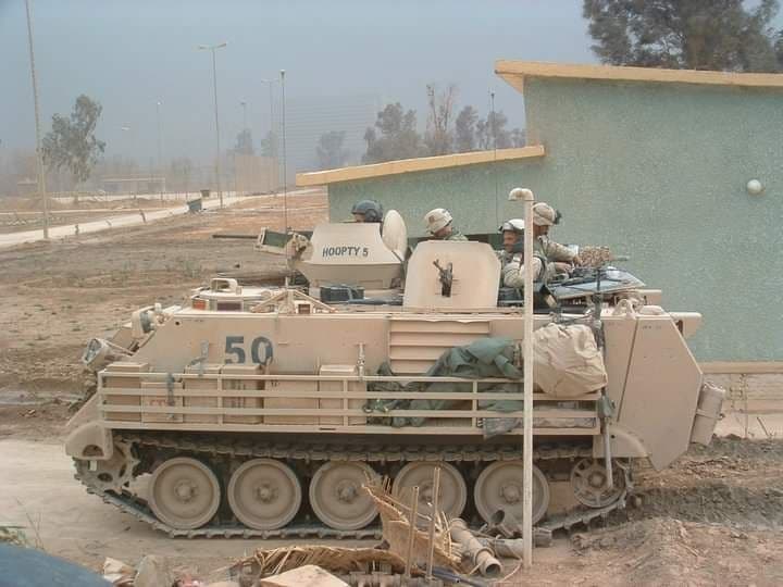

The racks were only used on 2 BDE, 3 ID M113s that were drawn form PREPO stocks in Kuwait during OIF 1 (Invasion, 2003). The Academy racks look nothing like the real ones though. The actual racks were made of all flat strips of metal.
The M113A3 kit has lots of updated parts, most specifically for the A3 version. It also offers more detailed parts for some of the common M113 parts as well. It is the latest version of Academy’s M113 kits and has the best/most details.
Except apparently that vehicle and the ones on Prime Portal. The framework for those is made up primarily of rectangular tubing. Two inch square tubing can be replicated perfectly with .060 x .060 Evergreen strip.
For the flat strapping (just the straps on the sides) I used .010 x .080 strip.
Right. My point being they are not made up of round tubing like Academy’s are.
Hard to tell from this photo, but it almost looks like those cargo racks were mounted using the bolts from the track shrouds…?
