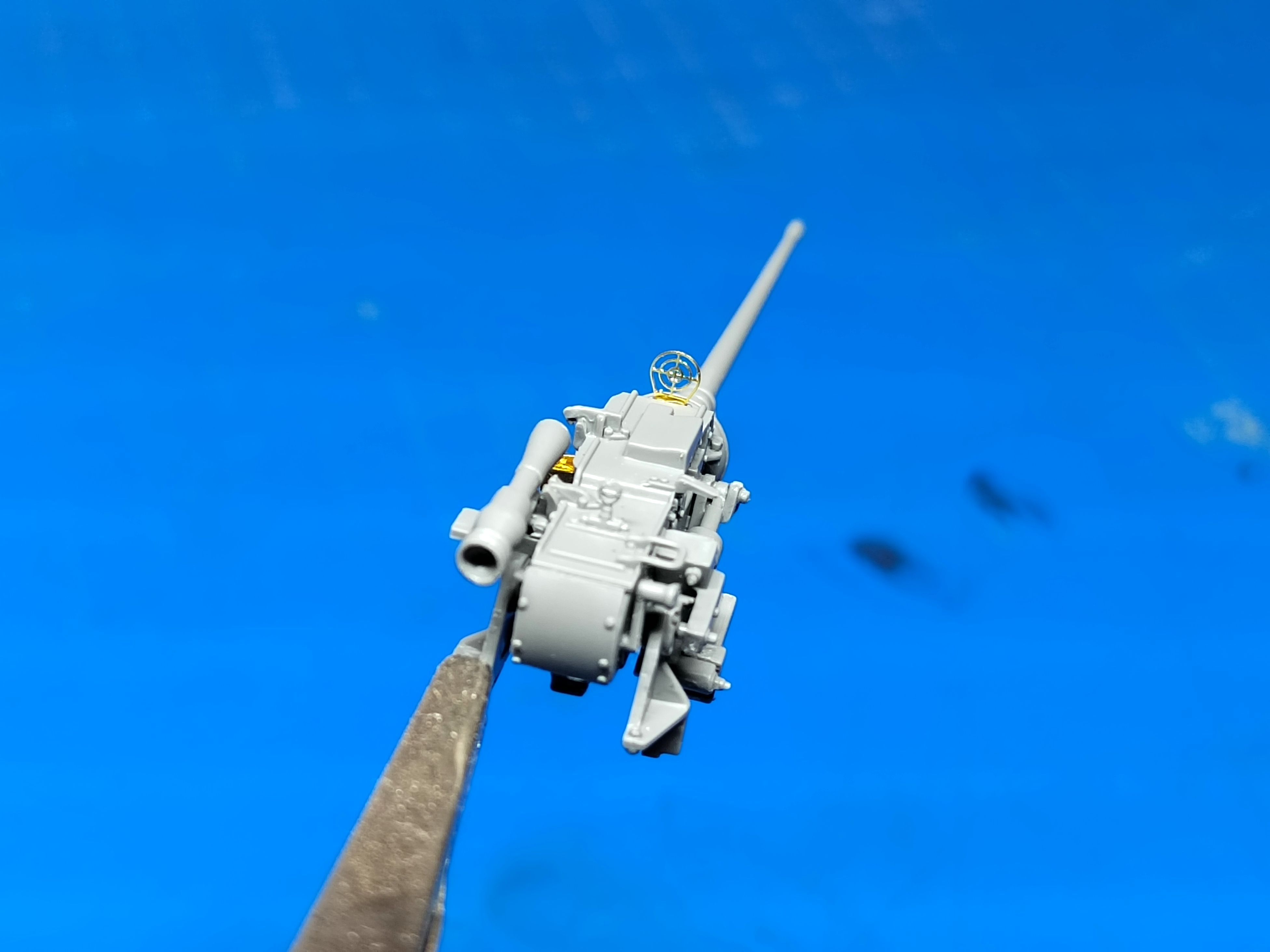

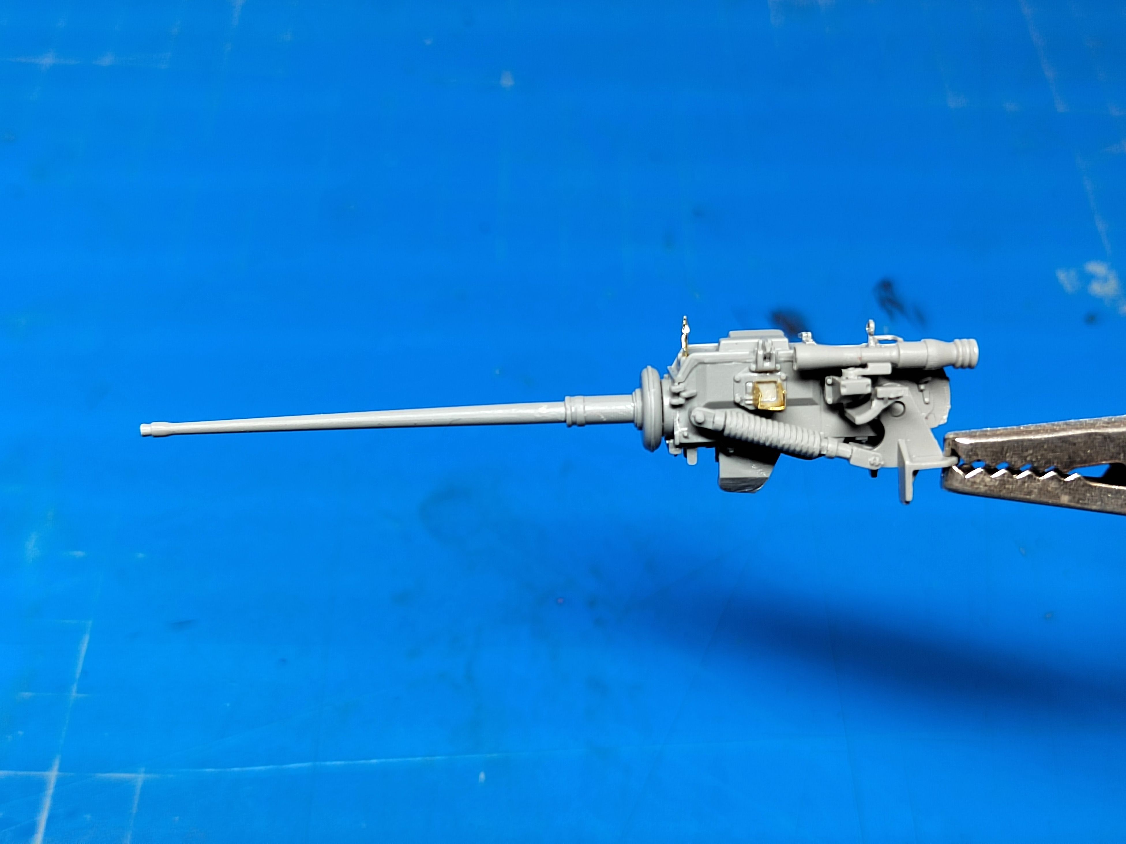

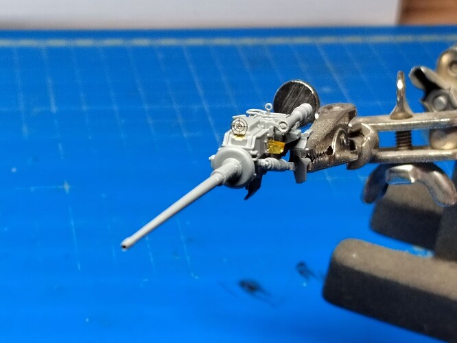

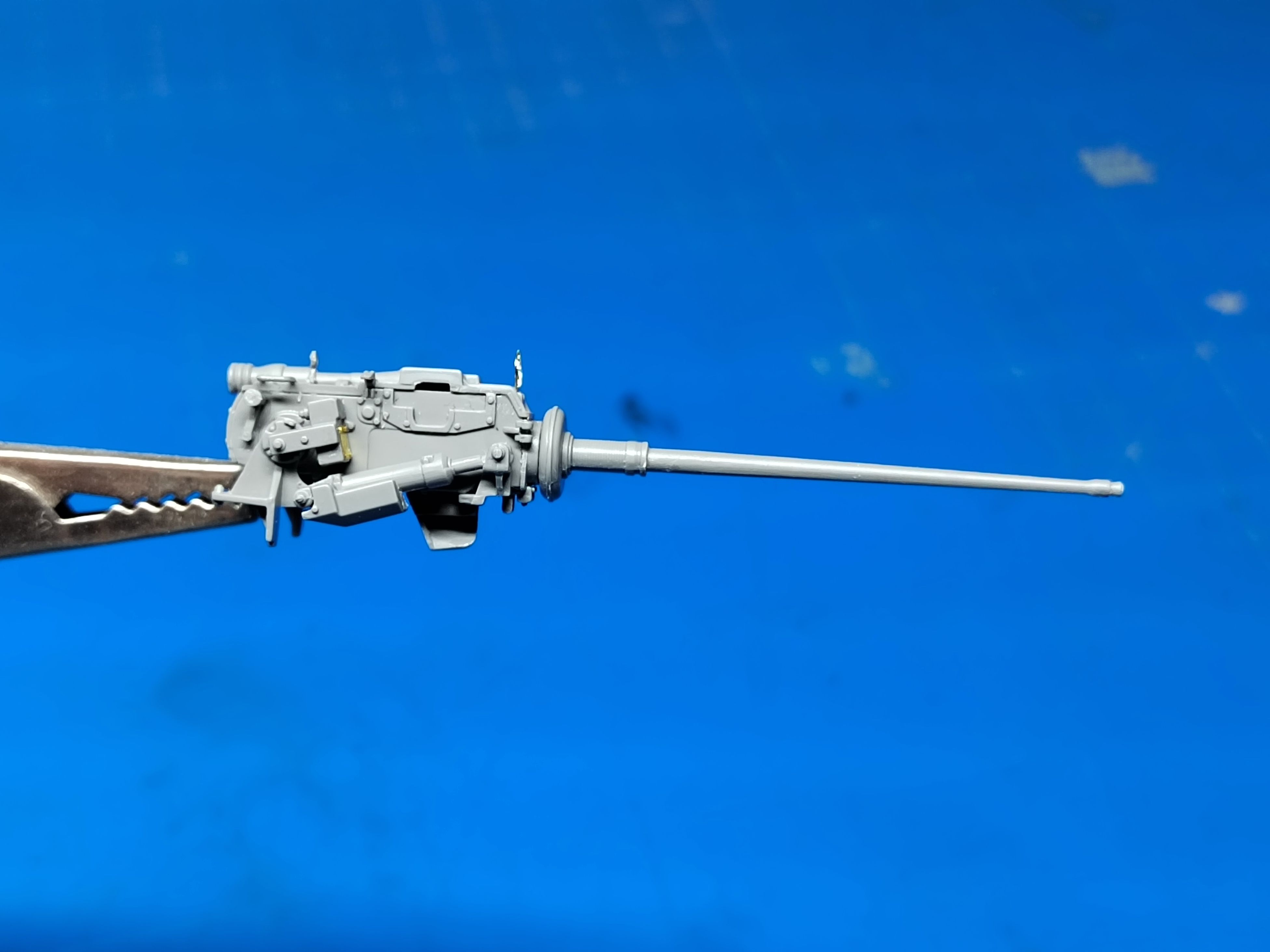

Despite the lesser time I had lately I managed to assemble the cannon.
I hollowed the muzzle, widened the eye-piece and modified the sight by simulating the glass at the front and hollowing the rubber protection. I advised to glue the feed chute with CA glue.

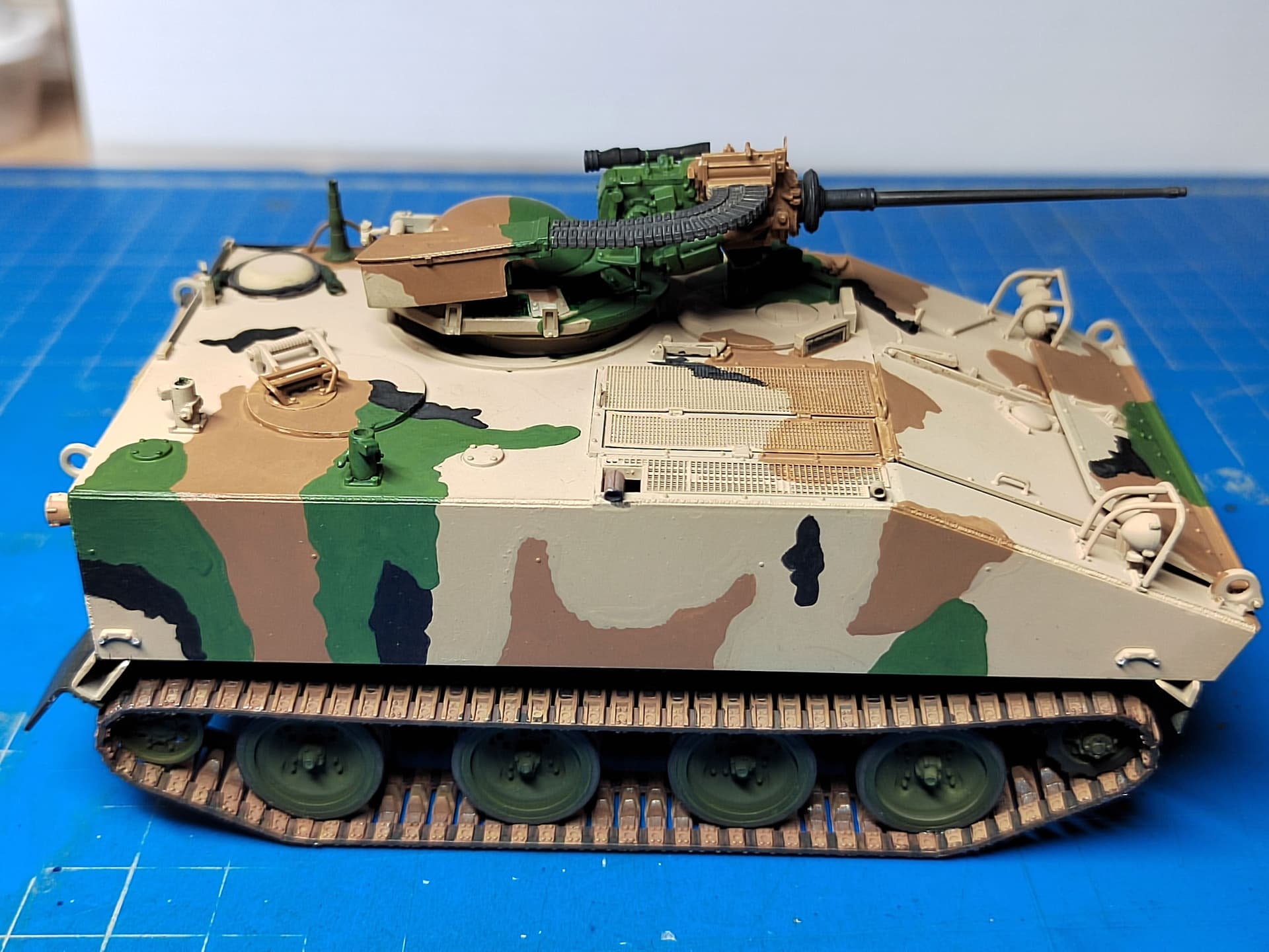

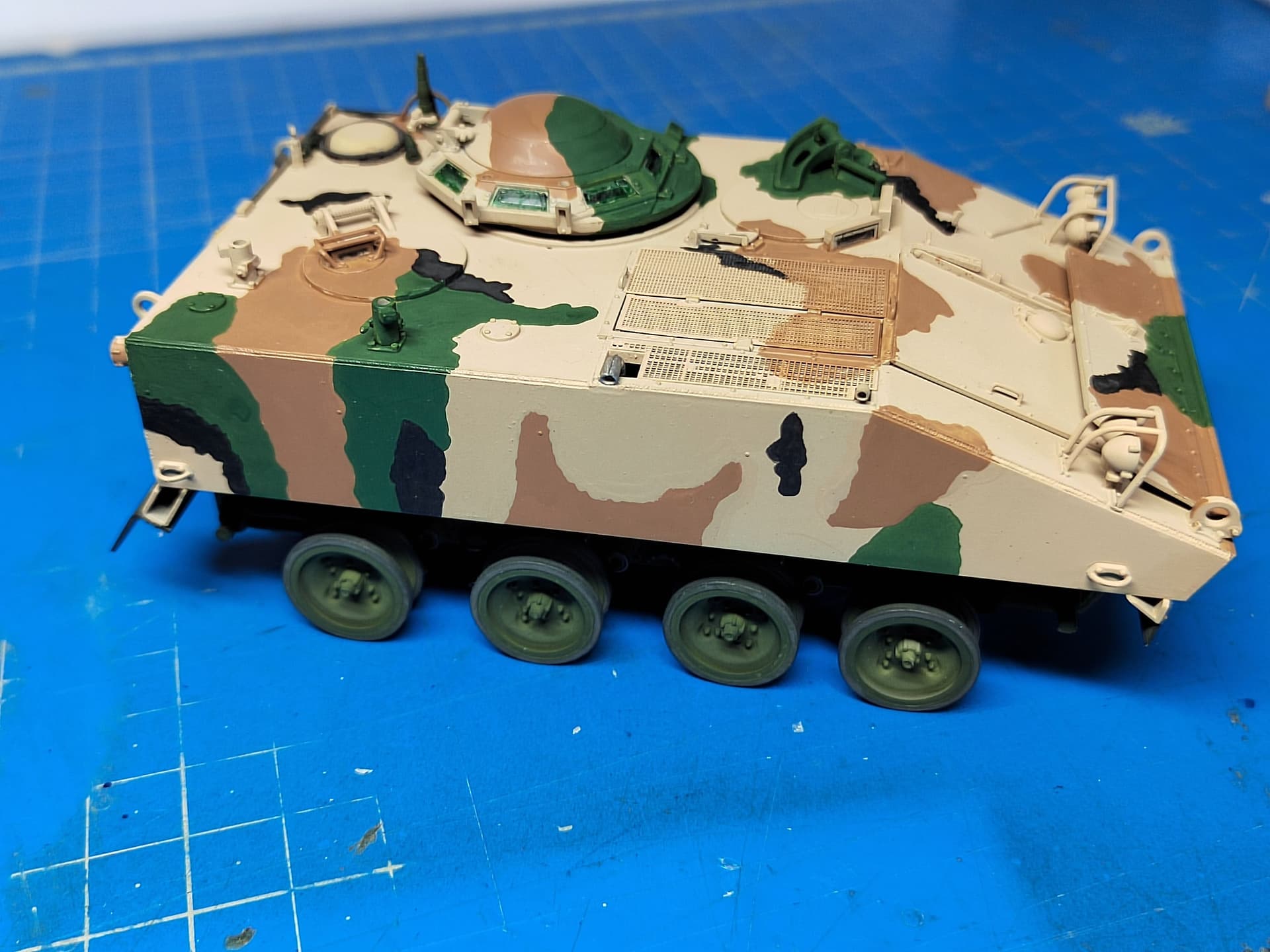

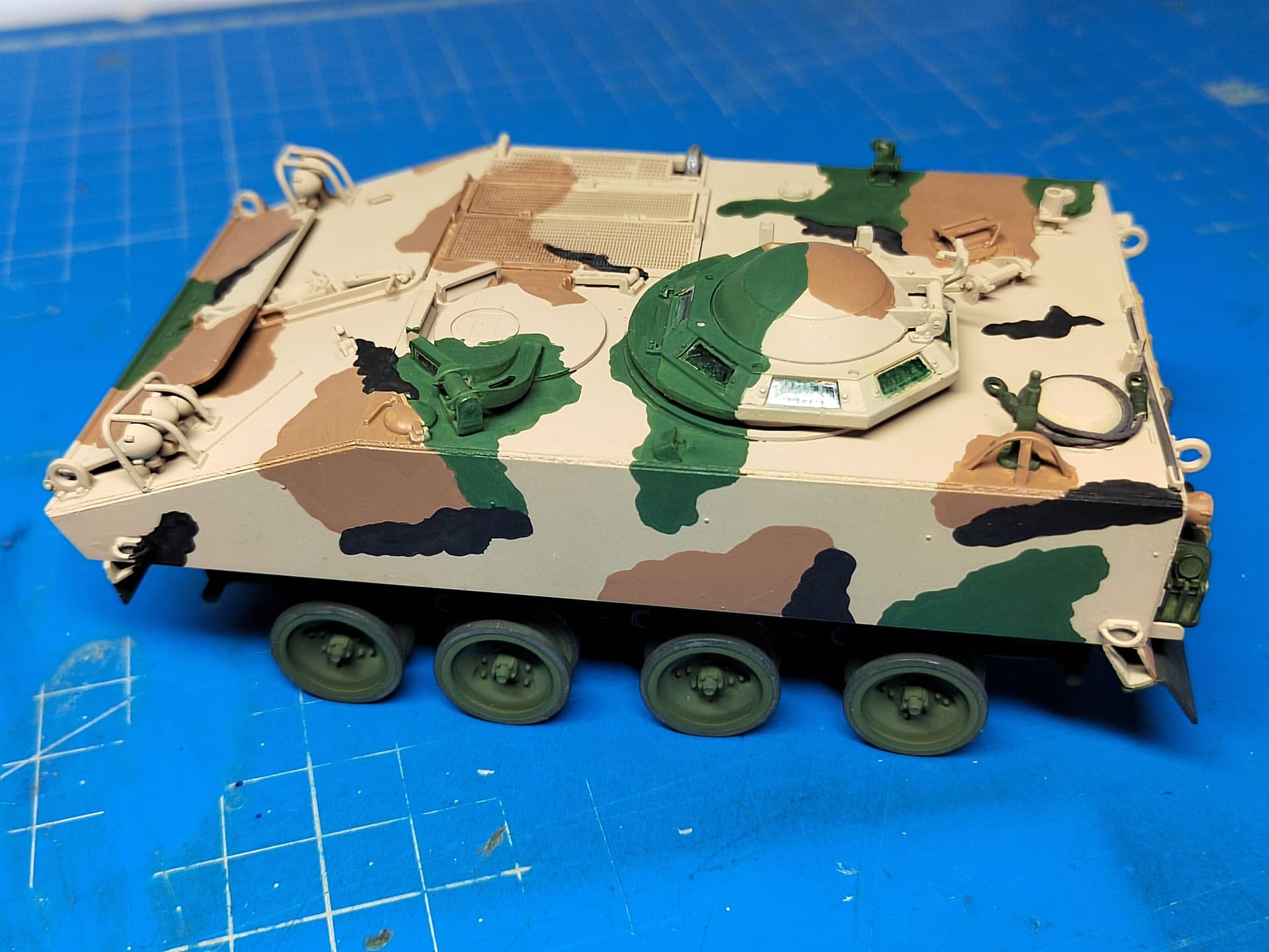

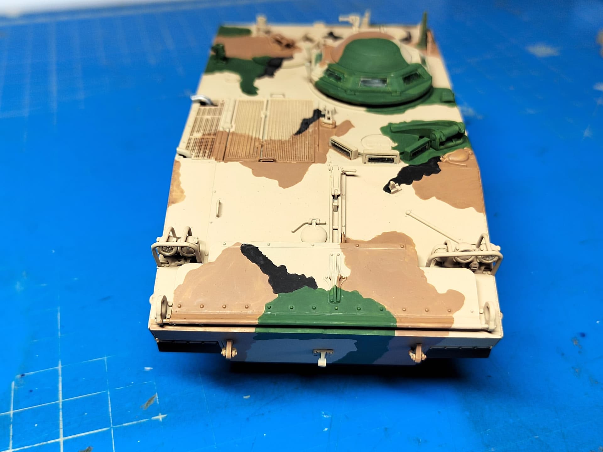

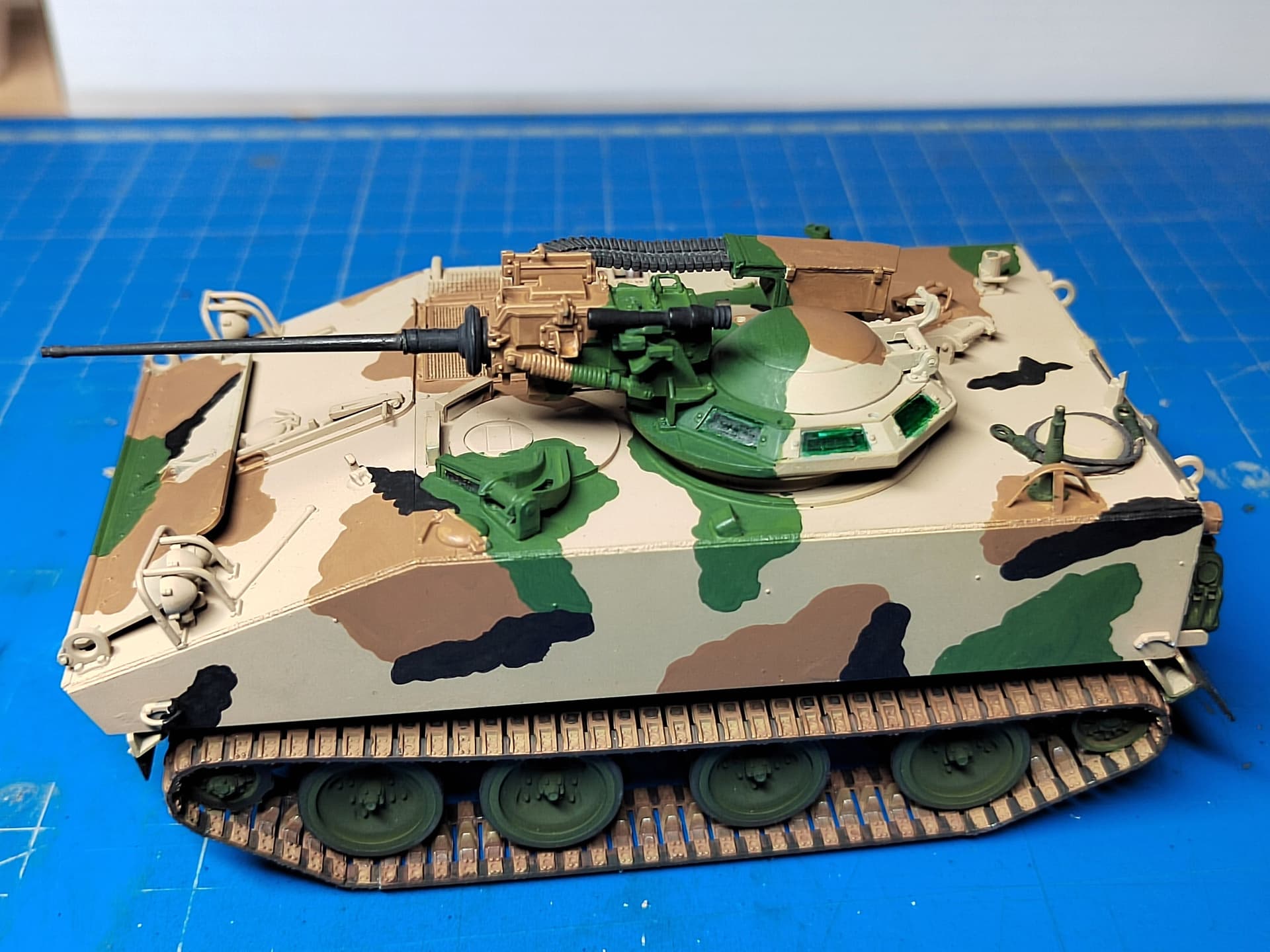

I have applied the camo after the grand-children left the house.
I chose one of the Takom Masster option, the one with the plain green running gear. As Takom do not give you a top view I invented the scheme trying to have it corresponding with the side color patches.
I used XF-78 wooden deck tan for the base color, XF-26 deep green for the green, XF-1 for the black and Prince August Vietnam US Tan for the brown. The running gear and the accessories are painted XF-58 olivier green.
I know this may be far from the manual but from the pictures I have seen of actual vehicles it appears that many crews did not bother too much with the manual.
Olivier
You have no idea how true that statement is!!!
My only comment is that I would say that the green looks a bit too dark. I might also add one or two smaller black “blobs” in the front/top area, particularly the RH vehicle corner.
Looks great!!
Not a paint scheme I have ever tried, but it looks nice. The kits built up really well.
Your build looks great,makes me want to get around and get one to build. Though if I do build one it will likely be a modified El Salvador variant.
Thank you for the comments.
Tom I could try to enlighten the green. Concerning the black patches this should be easy. However for the front I applied the scheme given by Takom.
Olivier

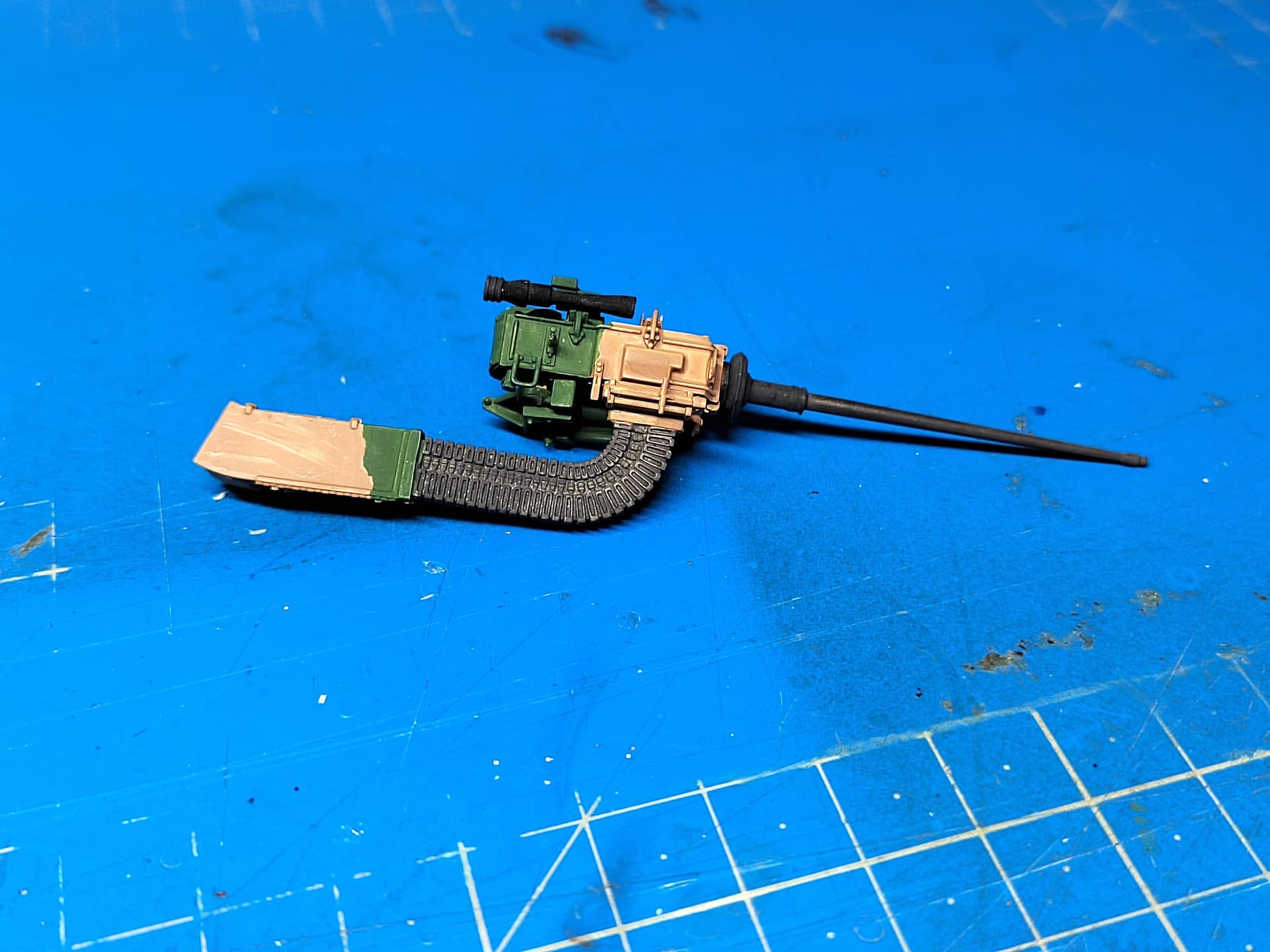

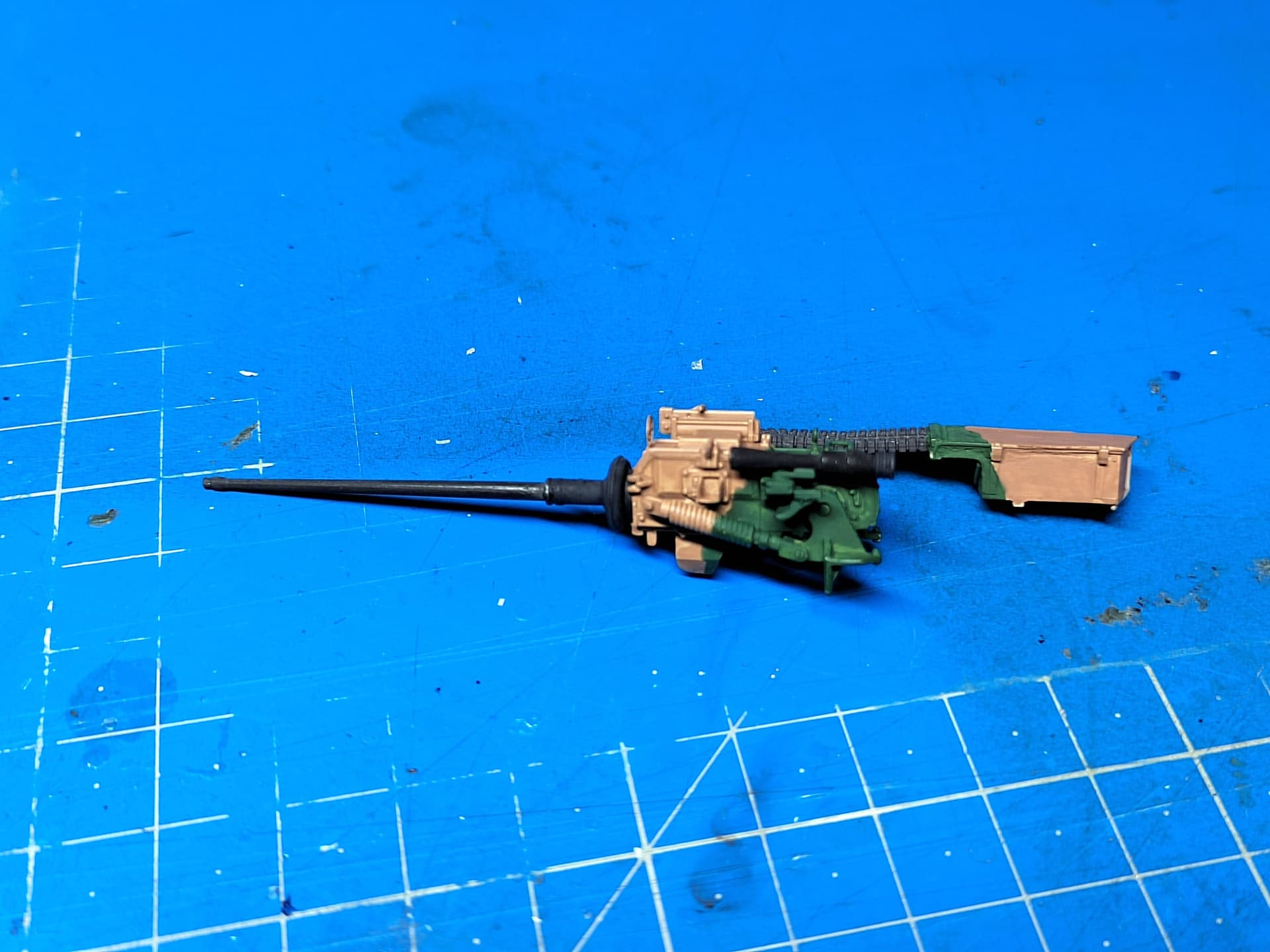

I’m in the process of painting the feeding chute. I have applied XF-84 dark iron as a base and intend to highlight the edges with a metallic color or maybe a graphite pencil. Concerning the round cases which are visible which color should I use?
Olivier
looks GREAT!
Green shade modified. I mixed some drops of XF-4 yellow green with the XF-26. I omitted to say the camo was painted.with a brush.

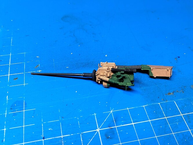

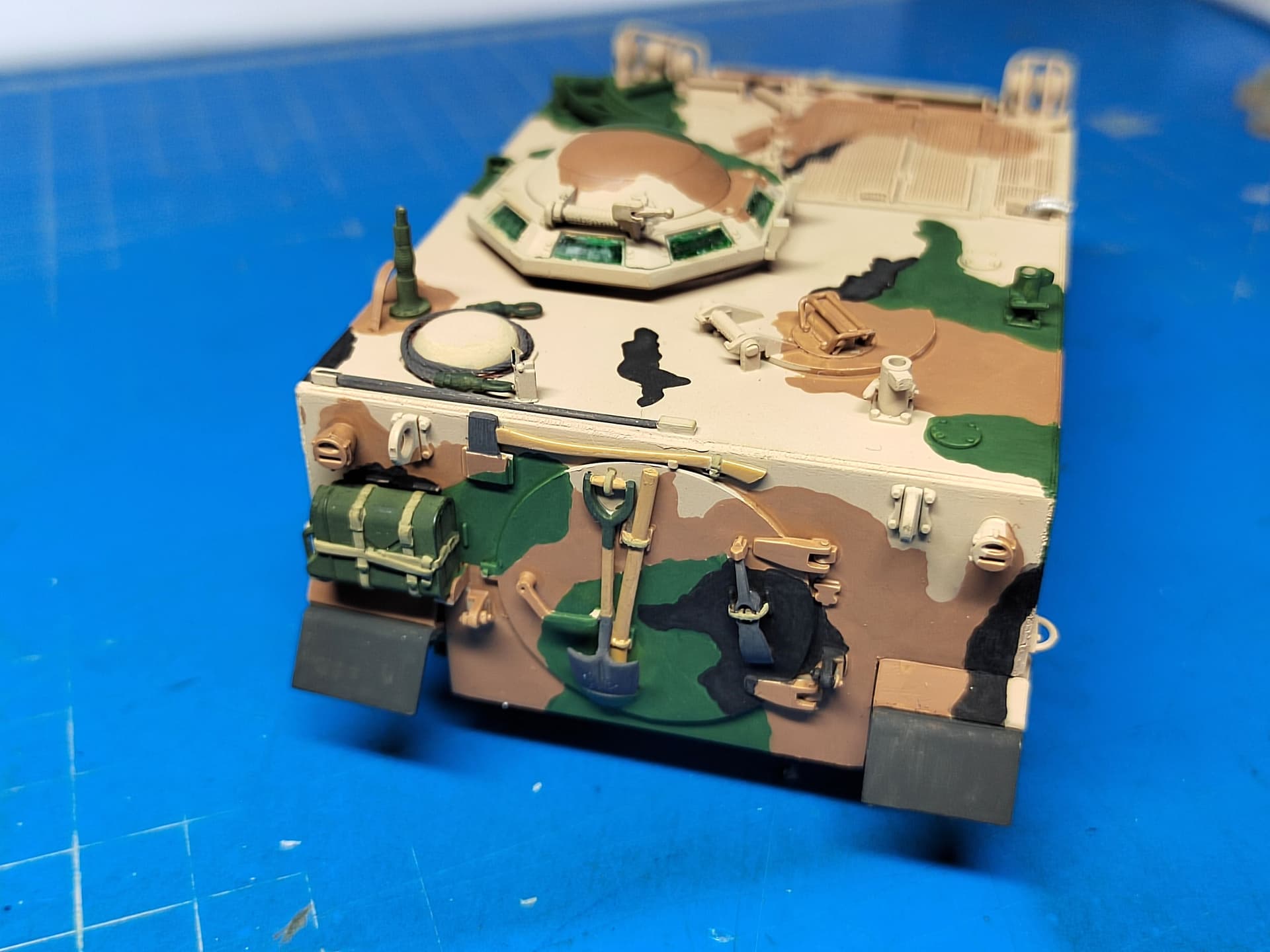

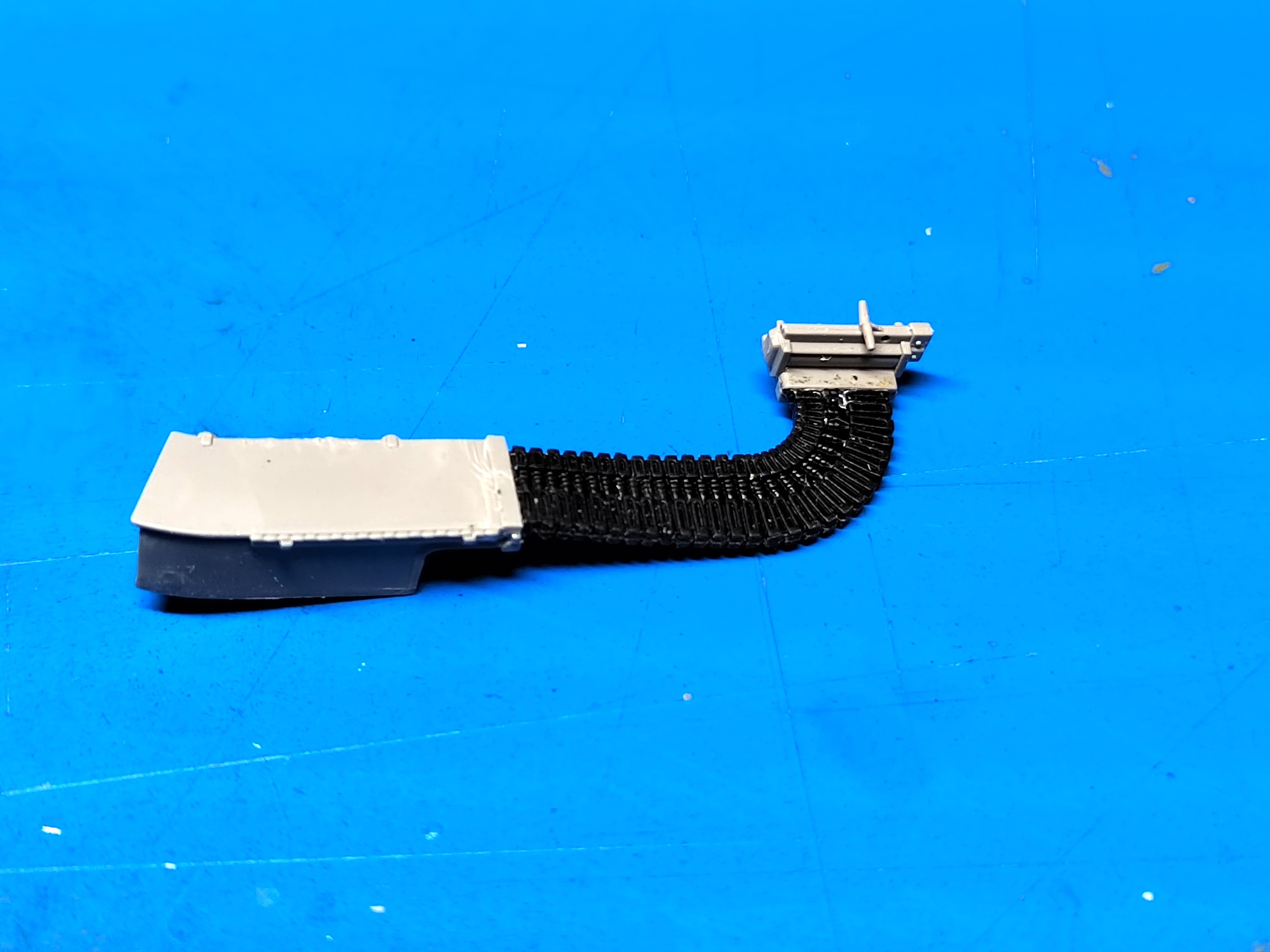

When I tried to glue the tracks I noticed I had glued the rear mudflap too far forward. So I had to remove them beforehand. Fortunately I didn’t break anything. The ammo box is not glued yet. The rubber ammo chute is too stiff. So I have glued the cannon supports first. When they are definitely glued, I will glue the box with CA glue.
Olivier
Dull brass, I think. I don’t think American 20 mm cases were lacquered or anything.
Correct. US made 2m ammo was mainly brass.

Really like the cam scheme on this, not one often seen but very unique :+1:
In the feeding chute would the metal links be on top of the belt? If so I’ll have to paint the links black.
This morning I tried to fix the ammo box. The chute appears too long so it doesn’t look realistic at all with very excessive curves. I’ll check my refs to see if Takom goofed.

Unfortunately the material used by Takom is too stiff. So if you try to glue the chute it makes a nasty angle and not a curve. Not realistic at all.
So I started to cut elements of the chute and try to connect the ammo box and the chute until there is a curve and not an angle anymore. It works but the S shape isn’t enough. I have probably cut one or two too many elements.
