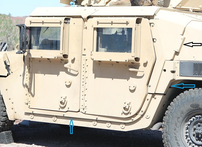

Does anyone know if there are any 1/35 sets for the Academy M1151 for the armored plates at the back of rear doors and on the rocker panels? There is also one over the fuel filler area. The armored plates are pointed out below.
I suppose these would need to be scratch built?
This is the original layout without the armored plates. You can see from the above photos that the newer armored plates are quite thick.
No, it’s additional armor. You have to make it yourself. Frag 7
Thanks! Looks like I will be scratch building it or at least try to.

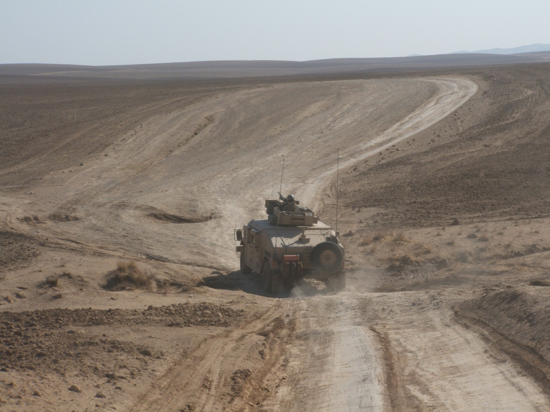

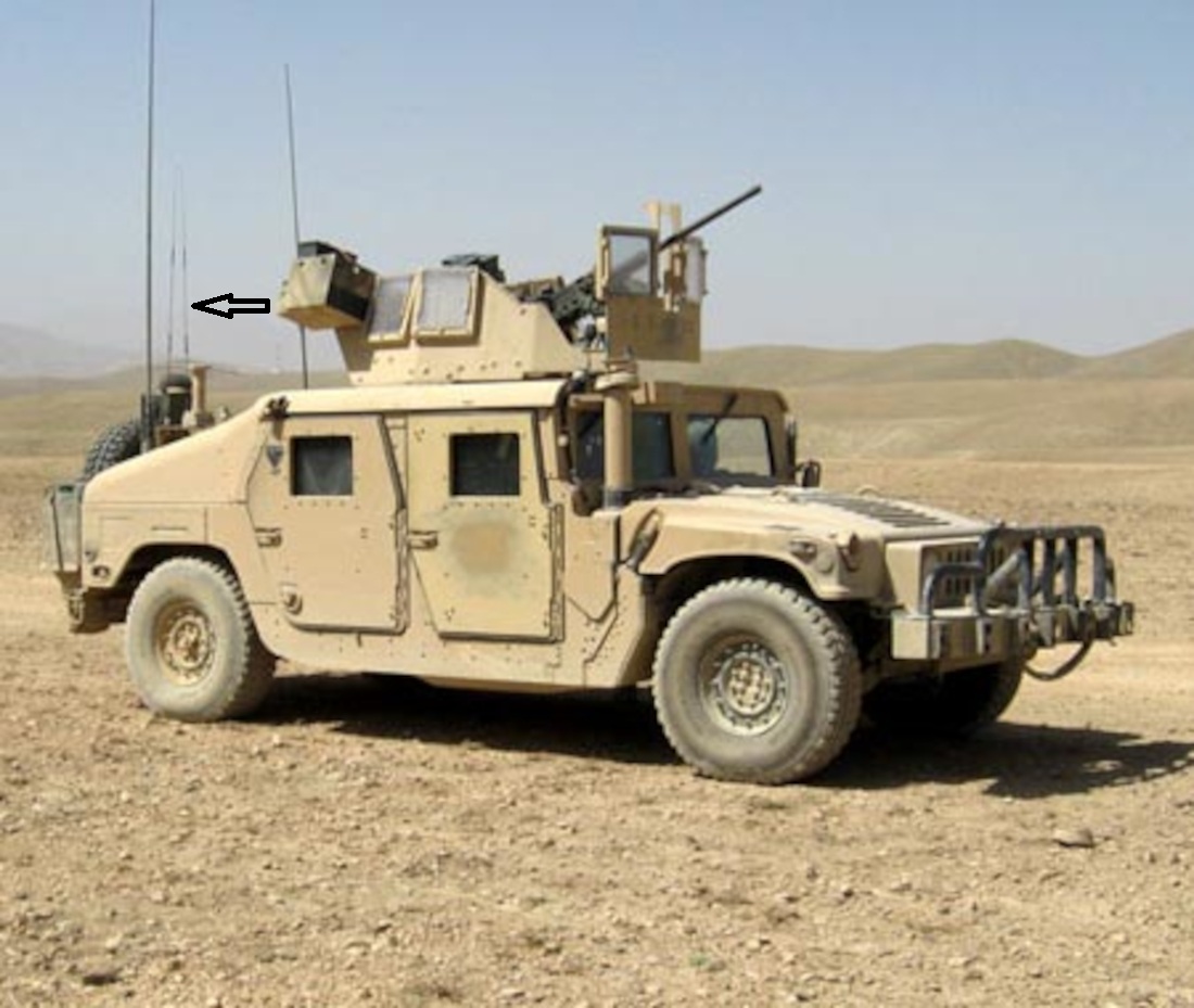

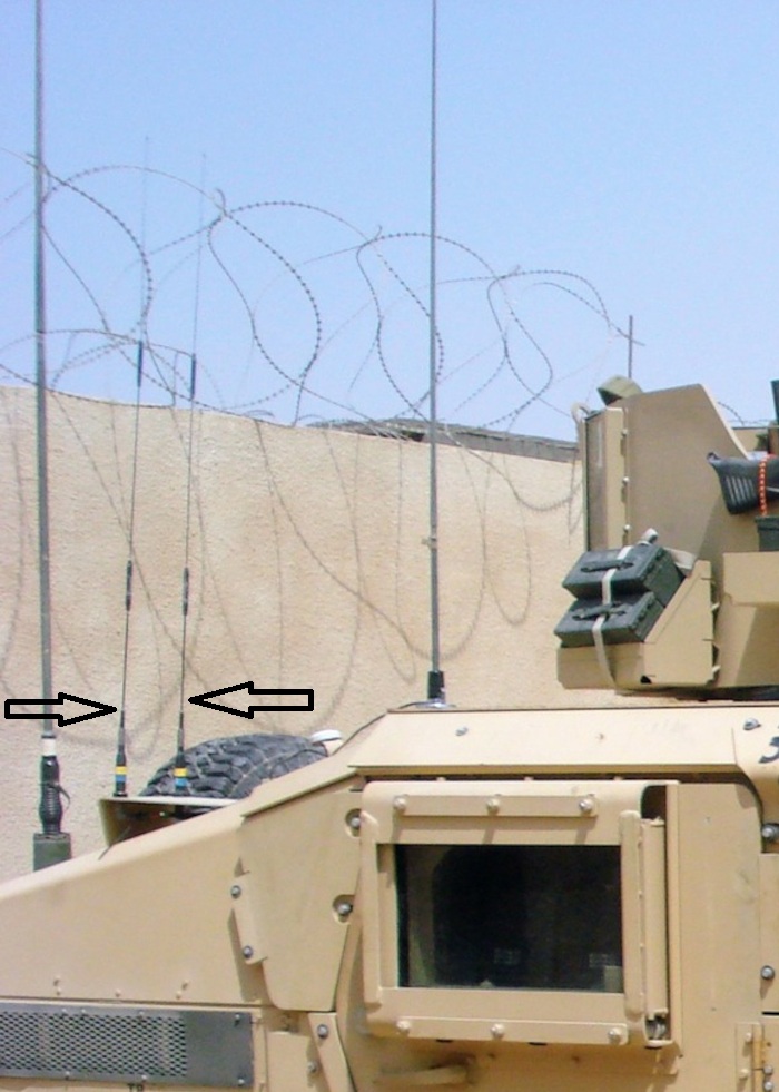

Can anyone ID the two smaller antennas on this M1151?
They are also on this M1114.
We had a system we simply called “the jammer.” Not Duke, or any other system - just the jammer. We only needed it on one gun truck on patrol.

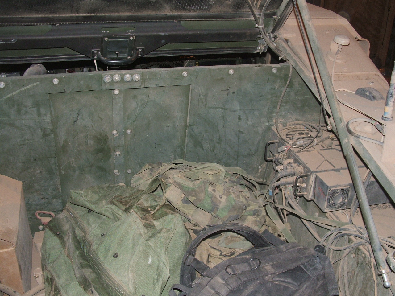

You can barely see one of the antennae here:
And both in this photo - they’re very faint:
Ah, I just found my best photo yet:
This may be a view of the actual unit: (99% chance)
Thanks! Great reference photos! I am planning to build an M1151 with those antennas. I have to find something in my spares bin thin enough.

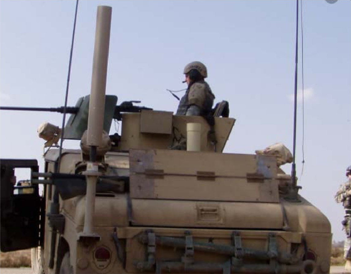

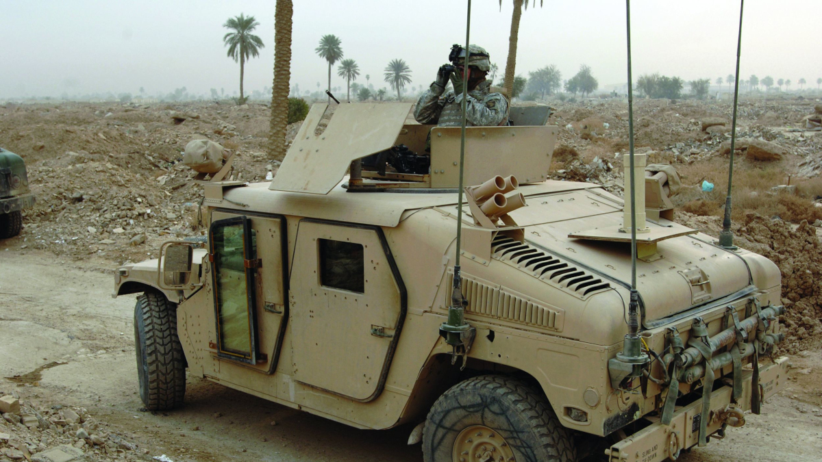

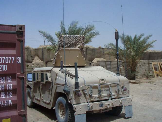

I found these M1114’s with interesting antennas as well. The first one has a short, fat antenna on the rear hatch that looks like a mini DUKE.
The second one has the same type of short, fat antenna and a DUKE.
The third one has two short, fat ones on the left and one on the right.

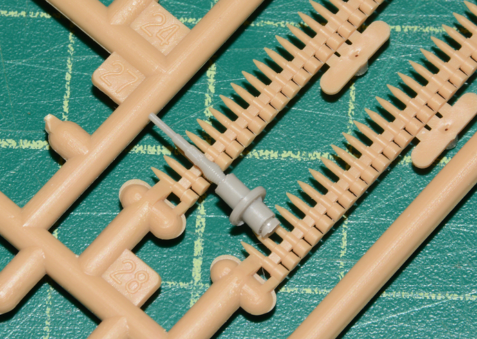

Yes, the bases are much smaller than the regular ones. I don’t have any brass -50cal casings though so I have to dig through the spares box for the bases as well.
I found some 20mm ammo belts from the Academy M163 that could work for the bases. I also found a couple Live Resin antenna bases. I could use the top part above the spring for the bases.

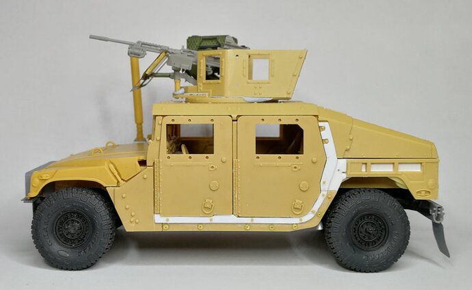

Resurrecting this thread. This morning I started on the FRAG 7 armor. I only got the one lower piece done so far which I will use as a template for the others as I will be making two different M1151’s with the FRAG 7. It still needs refining as this is just the basic shape so far. There are some angles needing to be cut on the center raised area. Of the two different ones I am making, one will be USMC in the NATO camo scheme and one will be US Army in overall sand.
Got some more work done on the scratch built FRAG 7 parts. They are only dry fitted for now. I still have to clean them up. For the left side, the curved area by the rear door is too high. I need to trim it down. Also, a lot more parts to do. The whole section behind the rear door needs to be done.
The right side curved area also needs trimming down to the correct height. I also need to do the armored plates over the fuel filler and just behind the rear door.
Nice to see some folks haven’t forgotten what scratch building means,.
Thanks! Those five parts took me two days and I still have a few more to do. Taking a break for the next couple days but will get back to it hoping by Friday or over the weekend.
I got back to working on the scratch built FRAG 7 armor earlier than expected as I wanted to get them done. I did two sets for two different Academy M1151 kits I am doing.
The discs are washers for the new bolts for the FRAG 7 armor. I had to remove the original bolts from the Academy kit and replace them with the new ones. The larger ones pointed out and the smaller ones above them.
The new washers glued in place. I need to add the new bolt heads next. I have the Meng bolt head sets so will be using those once I figure out the correct size to use or hope I have the correct size. The FRAG 7 armor parts also need bolt heads.
I assume you used to punch and die set for the washers. Looks good.
Thanks! Yes, they were punched out. This is the punch set I have but some are missing as my brother borrowed some and never returned them.
In this photo you can see the large washers on the rocker panels.
Dry fitting all the parts before gluing the Meng bolt heads on. I noticed the curved area by the bottom of the right side rear door has a slight gap. I trimmed too much off the curve. Not too much of a gap for me to redo so will leave it as is. This one will be in the NATO camo so hoping the camo paint will hide it and won’t be too noticeable. I have to test fit the second set I did for the other one I will be doing in overall sand. That one will be more noticeable if it has a gap like this one does.
Can you simply leave the door open?
I was going to leave it as is but decided to make a new one. It is only dry fitted so the straight edges don’t look as tight fitting as they should but once glued on they will be aligned properly. I also started adding the Meng bolt heads.
That’s always the best solution. Never “settle.”
I only scratched up a new part because I had some spare time so figured I would spend it doing something productive.
Last night I also finished gluing the Meng bolts to the FRAG 7 parts. The parts are still only dry fitted as I didn’t actually start building the kit yet. The parts still need some minor refinement before gluing to the kit so will concentrate on that over the weekend.
