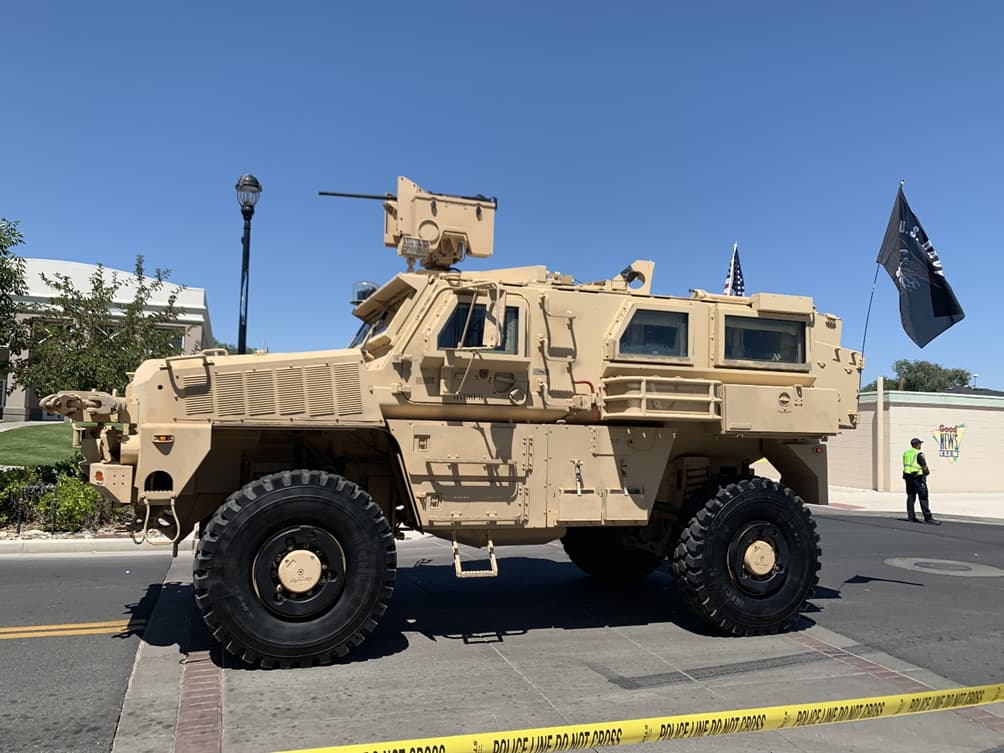

The model I’m building is an M1238A1 in use by SOCOM (Special Operations Command), like the one in the photo.
I will replace the CROWS weapon station with an M134 minigun with a shield, like in the vehicle that I saw in this video: https://www.youtube.com/watch?v=V2VNmhxnTQ8
The M1238 is the US designation for the RG-33, a MRAP vehicle, an evolution of the RG-31.

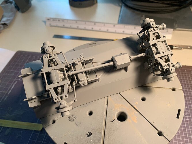

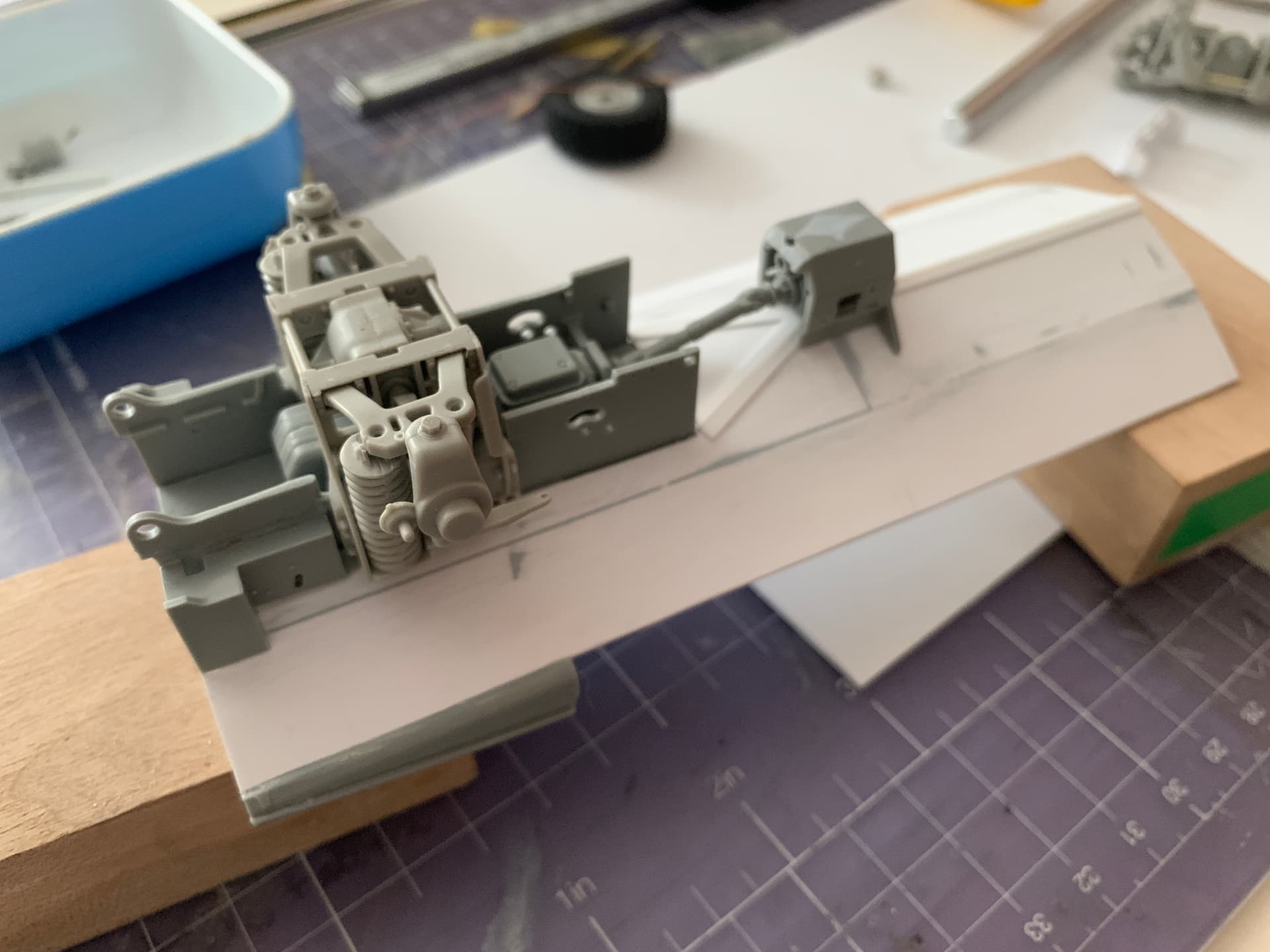

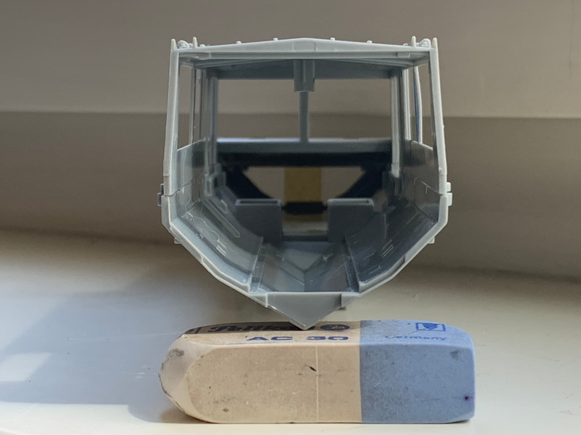

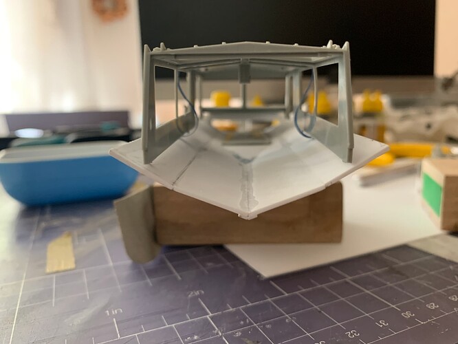

I started with the hull and drivetrain.
The RG-33 hull is much larger than the RG-31, so the hull from the Kinetic kit isn’t suitable.
I built the hull from scratch with plasticard, considering the overall length to be similar to the RG-31 and using the TAK-4 track for the width.
I then added engine parts and driveshafts from the Kinetic kit and the two TAK-4 units from the Mk.23 kit.
I added plasticard and performed some “surgical” work on the Kinetic parts to accommodate the suspension assemblies.

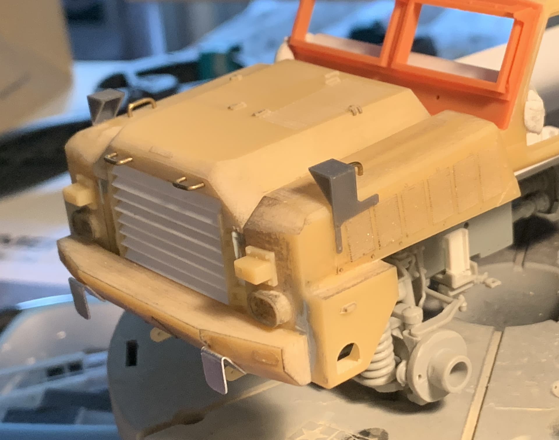

Here is the front hood with bumper and fenders.
I designed the main parts, in cream and dark grey color, and added scratch built parts in plasticard and metal wires / plates.
The only parts I used from the Kinetic model are the hood latches (in light grey).

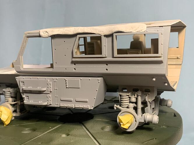

A quick update on the project.

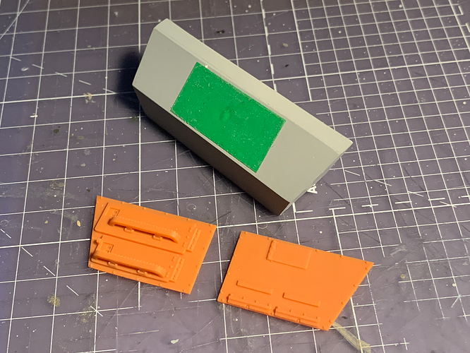

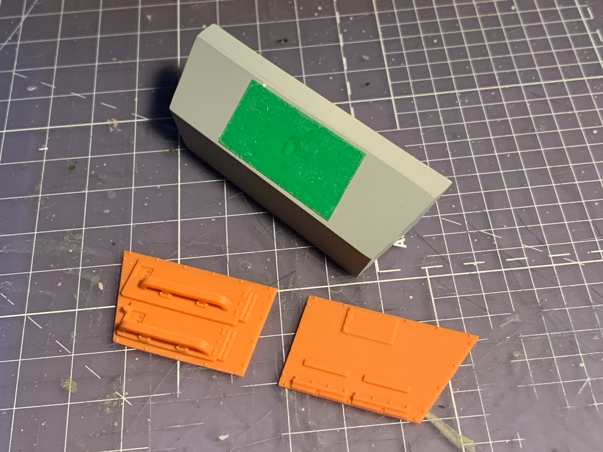

I temporary assembled the cabin and added the two big side boxes.
The side boxes are a mix of scratch build and 3D printed parts.
Front plates are 3D printed while the box bodies are made with plasticard, the old cut and glue process :slight_smile:

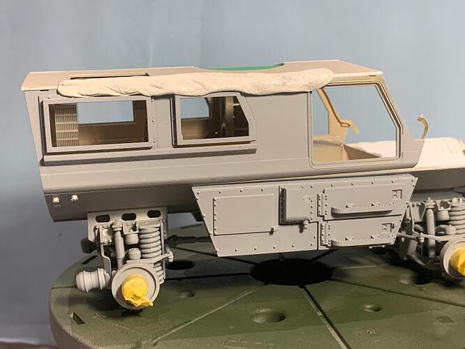

Model is back on the workbench.
Side and rear walls and windshield are now glued to the hull.
I also reprinted the front hood and bumper and re-assembled the many parts that make up the whole

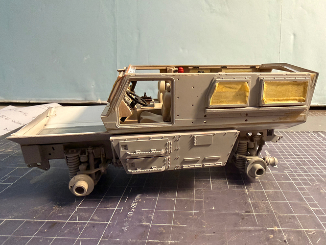

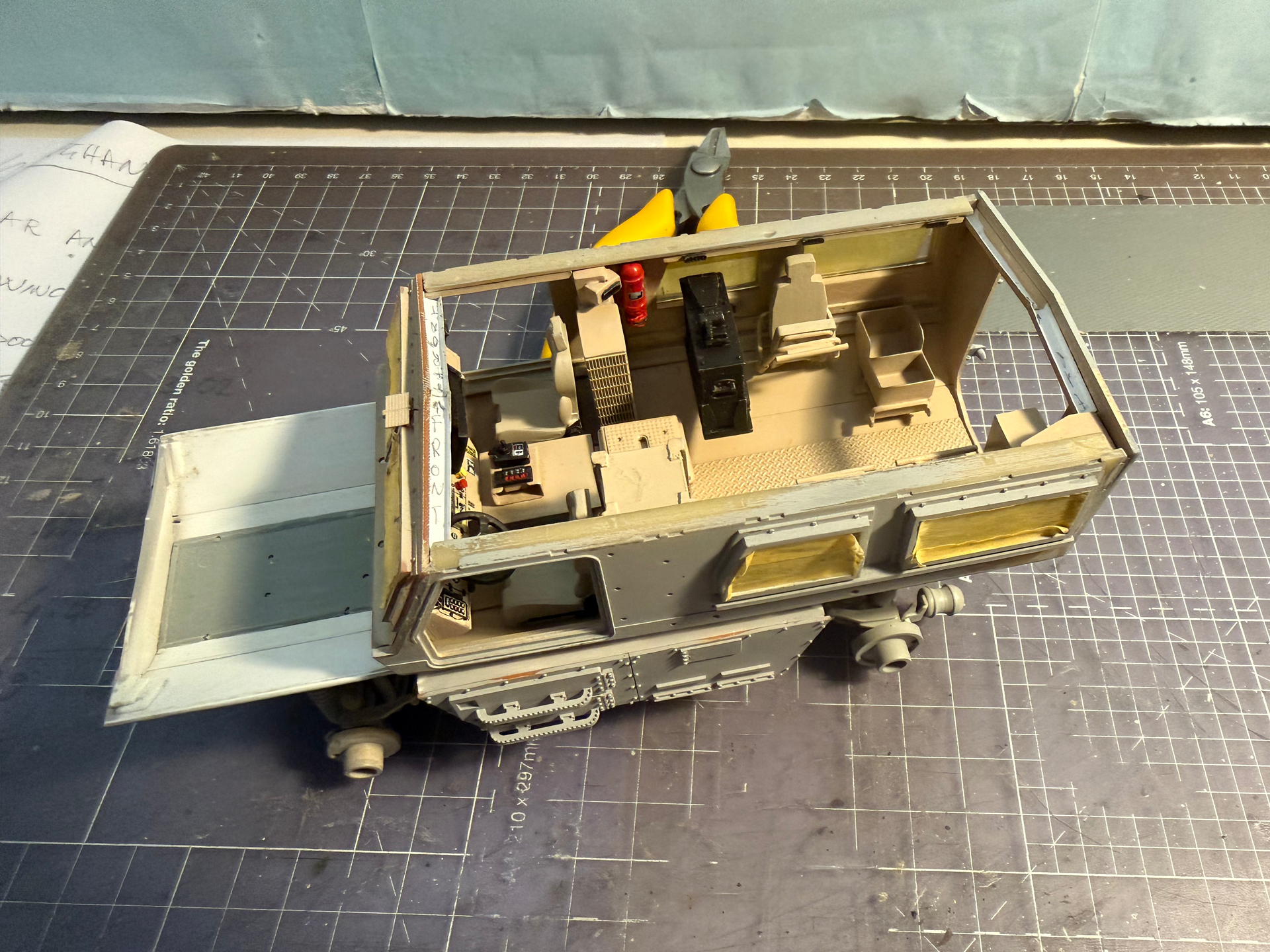

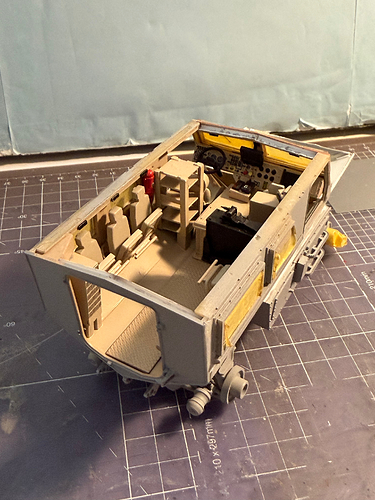

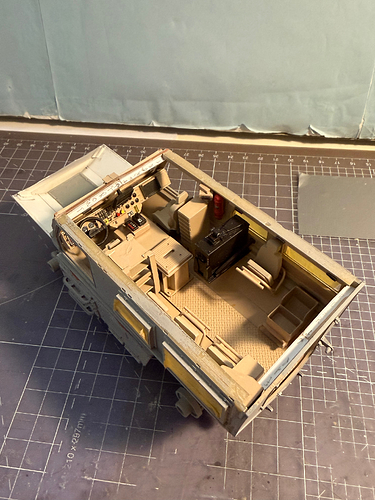

As if making this model wasn’t complex enough, I decided to include the interior as well.
These too are a combination of 3D-designed and printed parts, parts made with plasticard and wire, and parts recycled from other kits.
Looks great so far! Can’t wait to see the completed model.
I already printed the external boxes, the rear fenders and door and the rear steps.
As a next step I will attach them to the model.
Then I will address the roof that again will include a lot of parts.
