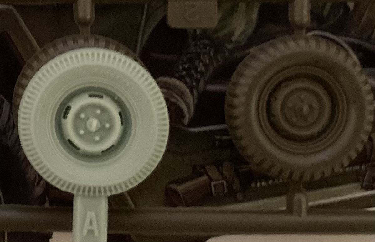

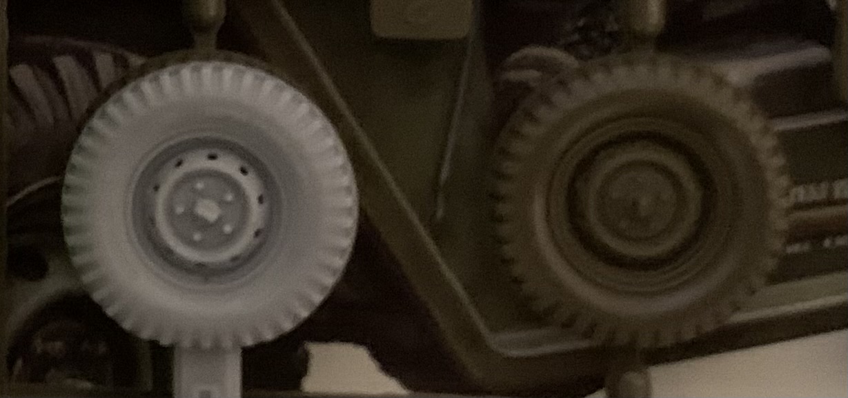

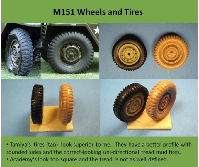

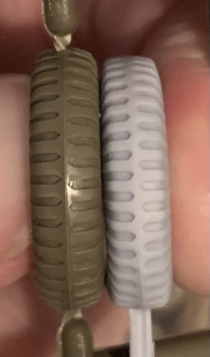

No problem. Here is a comparison of the different kit tires/wheels from my review article.

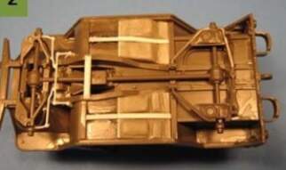

And the rear?
Found two different sets.
This is listed as early.
And this as late.
The worth is up to the modeler to decide.
Rear is fine on the Tamiya kits. Maybe a little compressed, but that can be fixed with a 0.030 shim under the spring. The Academy M151A1 still has an A2 rear suspension, but I know of no AM correction set for it. It can be scratched though.
