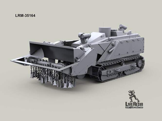

Live Resin also makes a kit in 1/35:

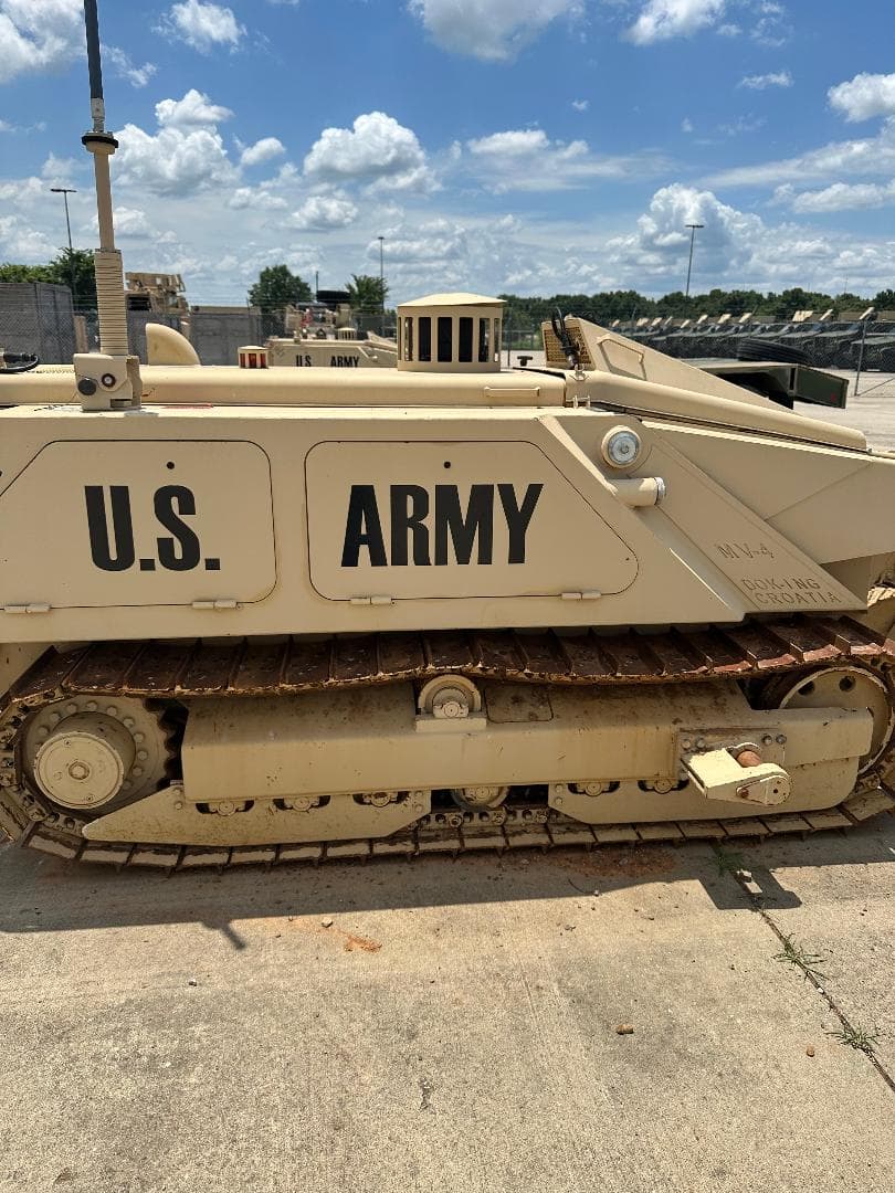

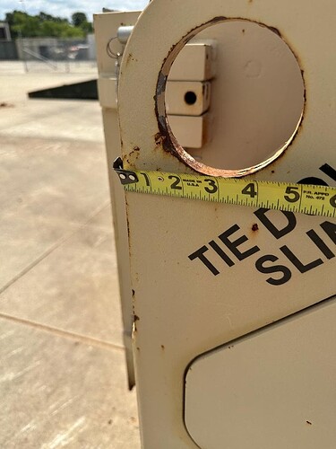

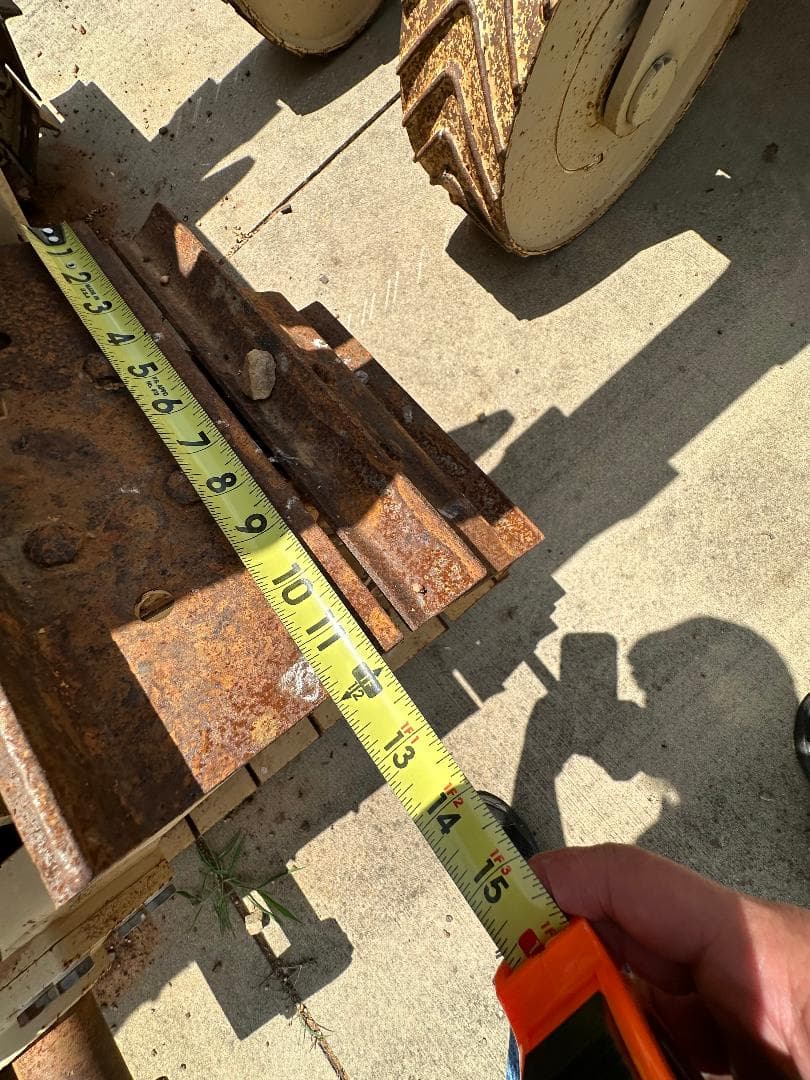

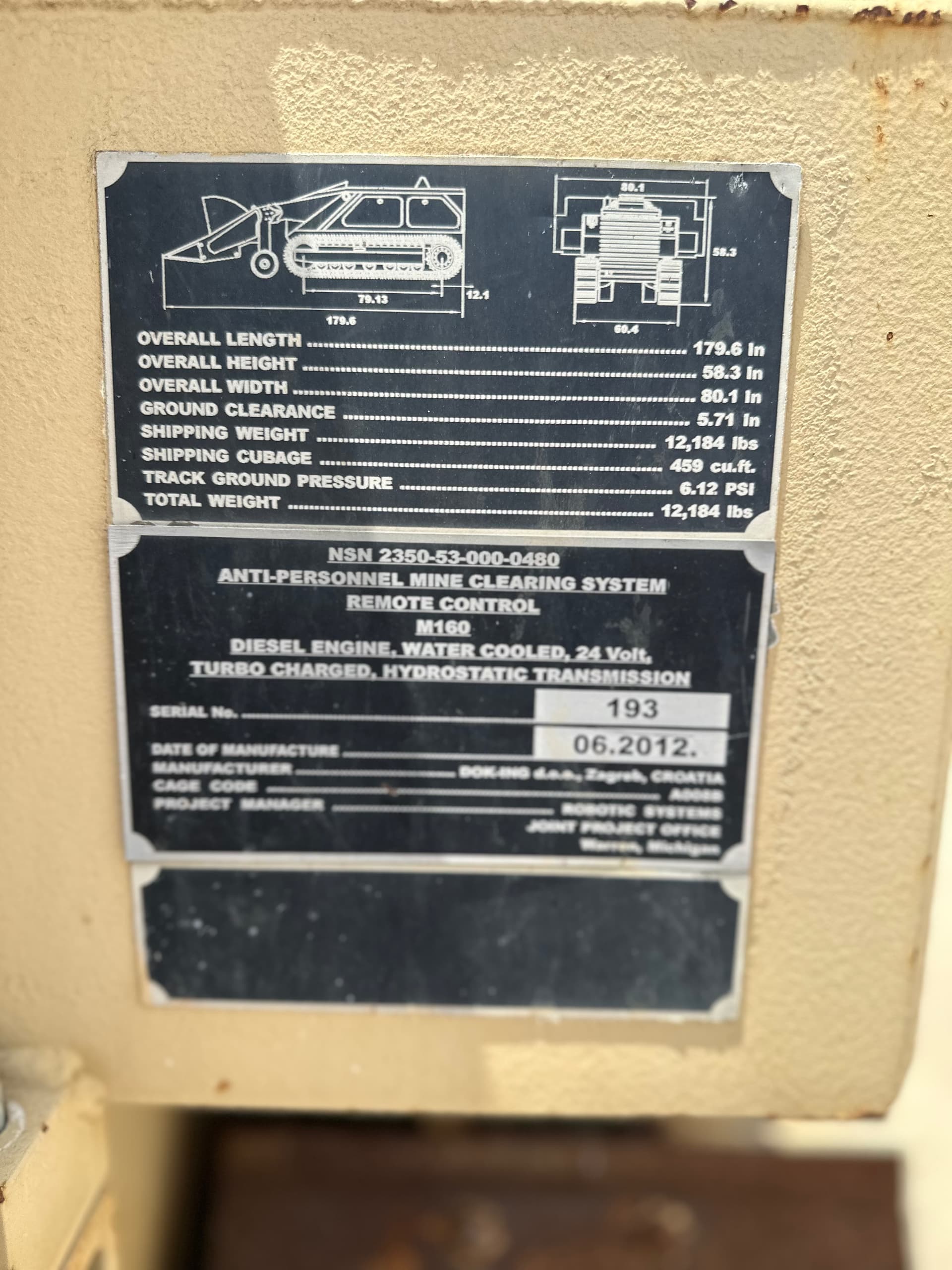

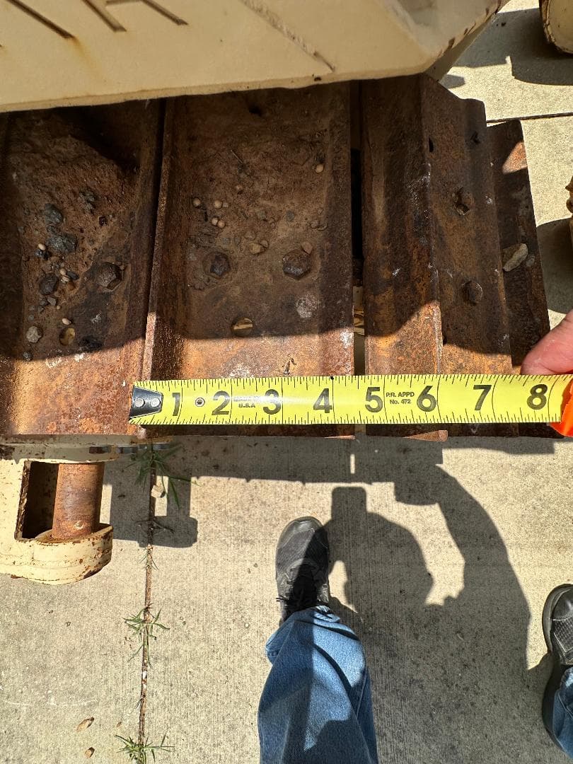

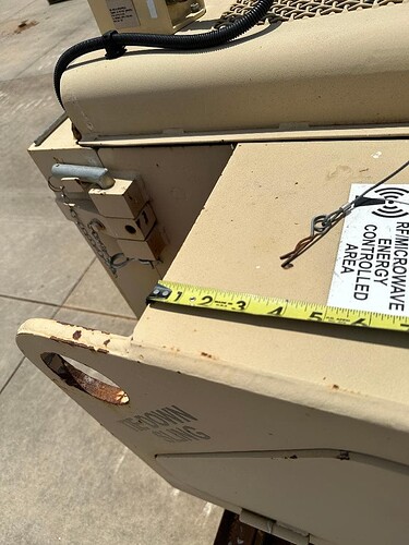

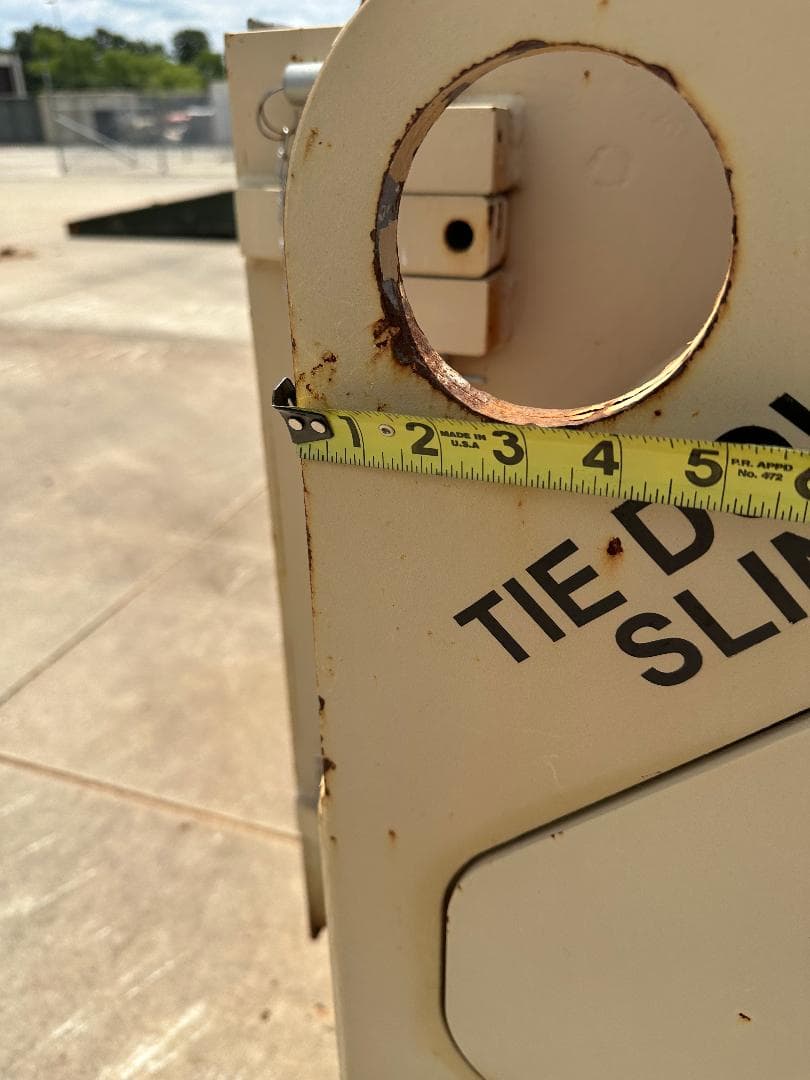

I would hate for anyone to think I would want to rely on just the data plate. I took measurements, 65 photos, and two videos.

Amazing pictures and thank you for your time and effort. I never knew the actual nomenclature of this beast we always just called them Doking. I think that was on a name plate welded to the back of them. As a route clearance unit, we had them but iv only seem them used in practice in the motorpool and never in actual use.
Dok-ing is a name of the Croatian company which originally produces this vehicle and a number of other robotic mine-clearing systems.
Mario
Sure is and I think that we might have been using them in some form of test situation. I don’t know this for sure but the engineers didn’t seem as excited to use this as they did the other robots we had. I think the time trying to load and unload this beast had something to do with it. It’s not a quick process and standing outside on route with all the bad guys watching was something we tried to limit.
And I think just a little wrong for route clearance methods. Perfect in a controlled mine clearing situation but not in all hell can break loose at any moment situations.
