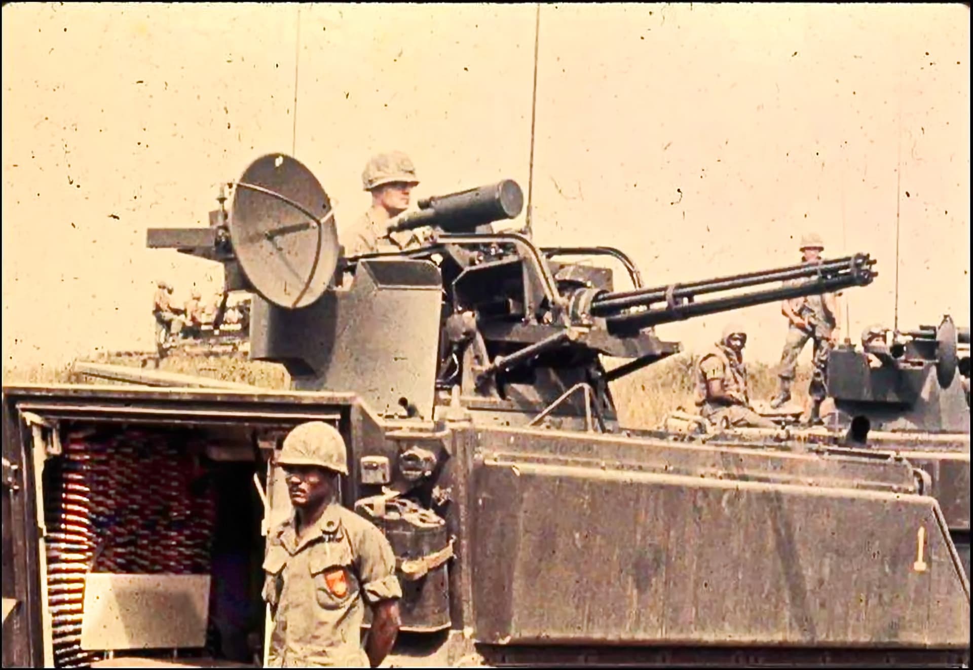

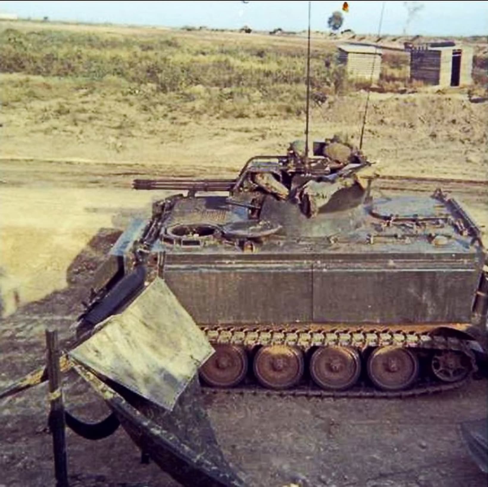

The M981 FISTV served only in NATO camo or overall Sand. The M163 Vulcan tracks had a long service life and wore multiple schemes, solid OD, Sand, MASSTER, various MERDCs, and NATO. Plus one offs like a local scheme in Vietnam and the experimental/developmental scheme worn by 5th ID in the mid 80’s.
The M163 was used/tested in Vietnam in limited numbers. It was in continual service and updated to A2 standards. It was retired after ODS in the mid-'90s. It was in pretty much every conflict during that time period in various camo schemes, including forest green, MERDC, NATO, and sand.

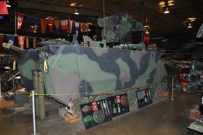

The M163 seems to pop up regularly during REFORGER exercises in the late 80’s in MERDC, but without the sand.

That was done a lot in the late 1980s, during the transition to NATO camo. Older vehicles painted MERDC using enamel paints were modified to look like NATO by painting out the sand/tan areas and often enlarging the black areas.
If you compare the top two photos, the black areas in the top one are much thicker than in the middle one.

Now that you mention it… I see lighter, apparently overpainted patches on the trimvane and on the lefthand side.

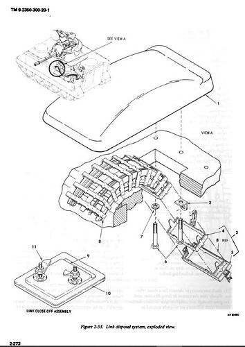

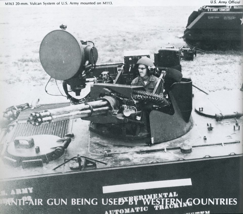

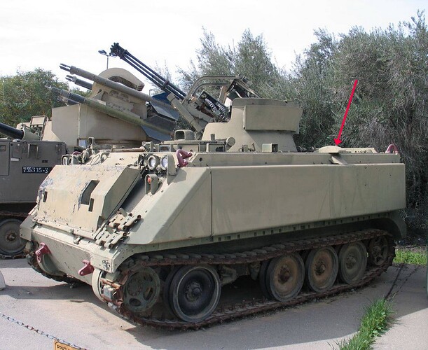

would only be if you were doing an early version of the M163 would you have differences like they had either and open dish or no dish at all fitted and also did not have the link disposal port on the right side
later version with disposal port
this trial version had a flat faced dish and also the left side armour on the turret was a different shape where it went back down on an angle before going up (just under where the feed chute is) they changed to that plate going strait back then up. this was because of the mounting of the gun was slightly different also like the bars coming up and over on the later versions that were added for stability and strength of the gun mount.
later version also normally did not have the night sight fitted
