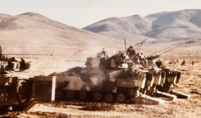

Bradley PTF. The Abrams to the left has the Lane Marking Kit for use during the breach. It dropped a marker every 10m IIRC.
Laagered up.

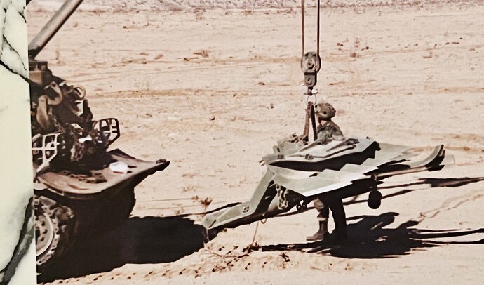

M88A1 ARV carrying a mine plow

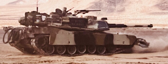

Mine-Plow MBT firing, with plow elevated in travel position. Straps fully retracted and everything locked in.
