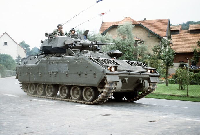

Looking good. The paint color looks right on.
I tend to agree with the OP - it could stand to be a tad darker.
It’s easier to lighten a color with weathering than it is to darken it. FWIW I went with straight Tamiya Field Gray, that can be lightened easily enough.
